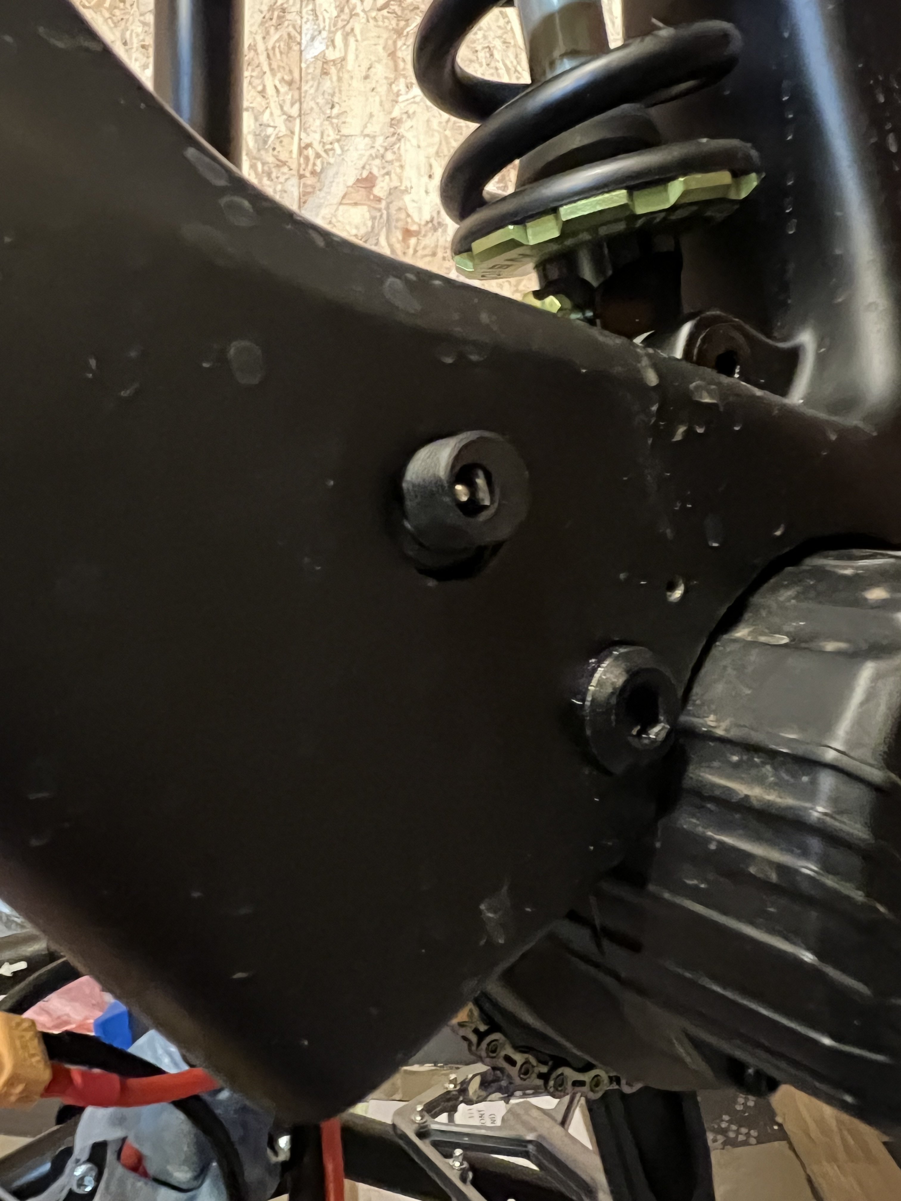

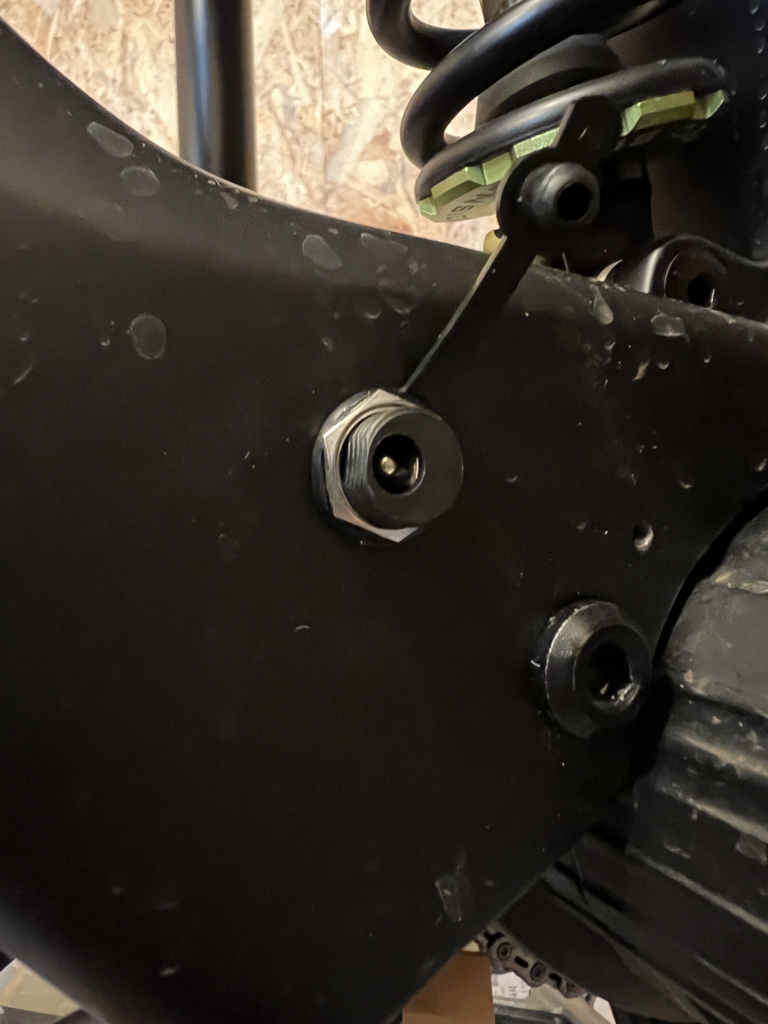

I've bought a jack charging port on Aliexpress : 5.38£ |Prise De Charge De Vélo Électrique Au Lithium, Connecteur De Câble D'interface De Chargeur De Batterie Li-on Pour Vélo Électrique - Accessoires - AliExpress
I did not try to fit it in the frame charging port yet, but it looks like it will fit!

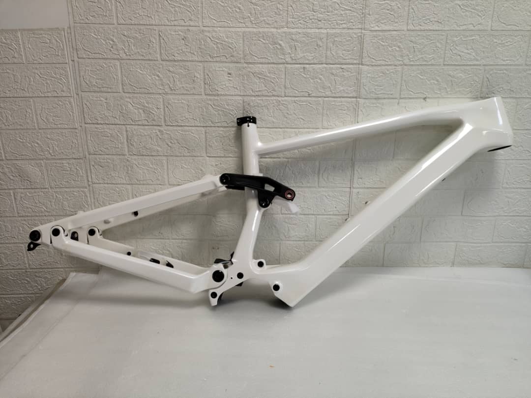

tell me when u try it, cause I buy Tantan E67 frame without Bafang battery. I think frame identical with Lightcarbon. Need to find the right charging port size.

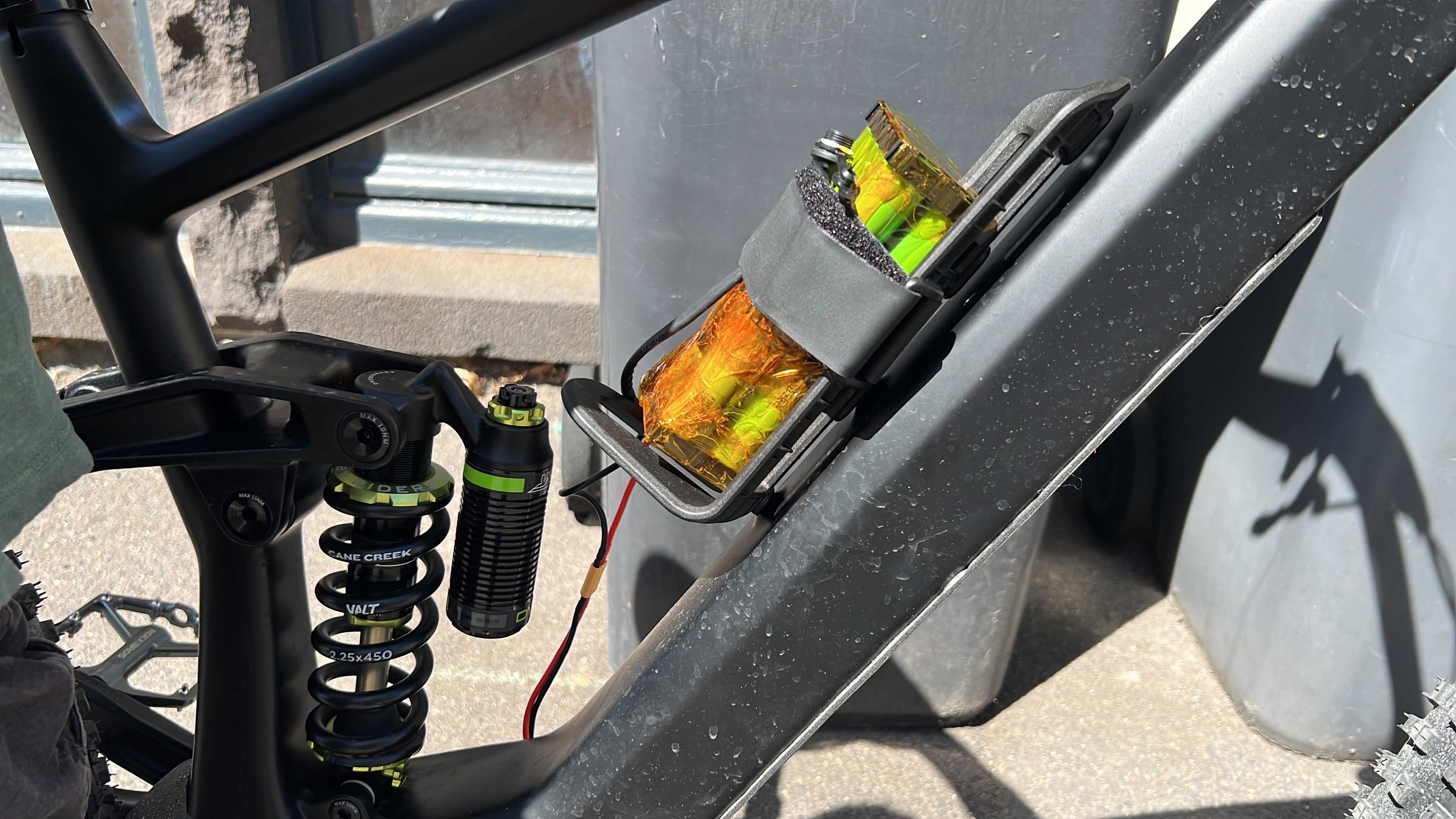

I tested my motor.
It’s a bit dirty, but it works 😂
I really need the besst tool, the assistance is active for a very long time after I stop pedaling.
I’ve tried eco and tour, I thunk it will be enough in 80% of the situations
wow, it is really small. Does it fit in the frame, or is it too wide? How much does it weigth?
What cells, BMS and charged did you go with?
How long is assistance active, after you stop pedaling? I don't think it is possible to tweeak this with the BESST tool, but I migth be wrong.

I tested my motor.
I did not weighted yet, but it should be around 800gr.
Not sure it fits in the frame, I’ve used the layout I used for the 12s, 6 and 6 (minus 2 on one side).
This is just to be able to test the motor and ride easy trails, I don’t consider it’s secure enough for jumps and big drops.
The bms is a very cheap with no temp sensor, it was the only one available in 2 days on Amazon.
The cells are samsung 50s. I don’t think the serial connections will be strong enough for the sport or boost mode.
I did not have the time to do a proper range test but I will try to do it by the end of the week.
Regarding the assistance, it does not feel at all like a Bosch, I need to double check but I would say I feel it for half a second after I stop pedaling

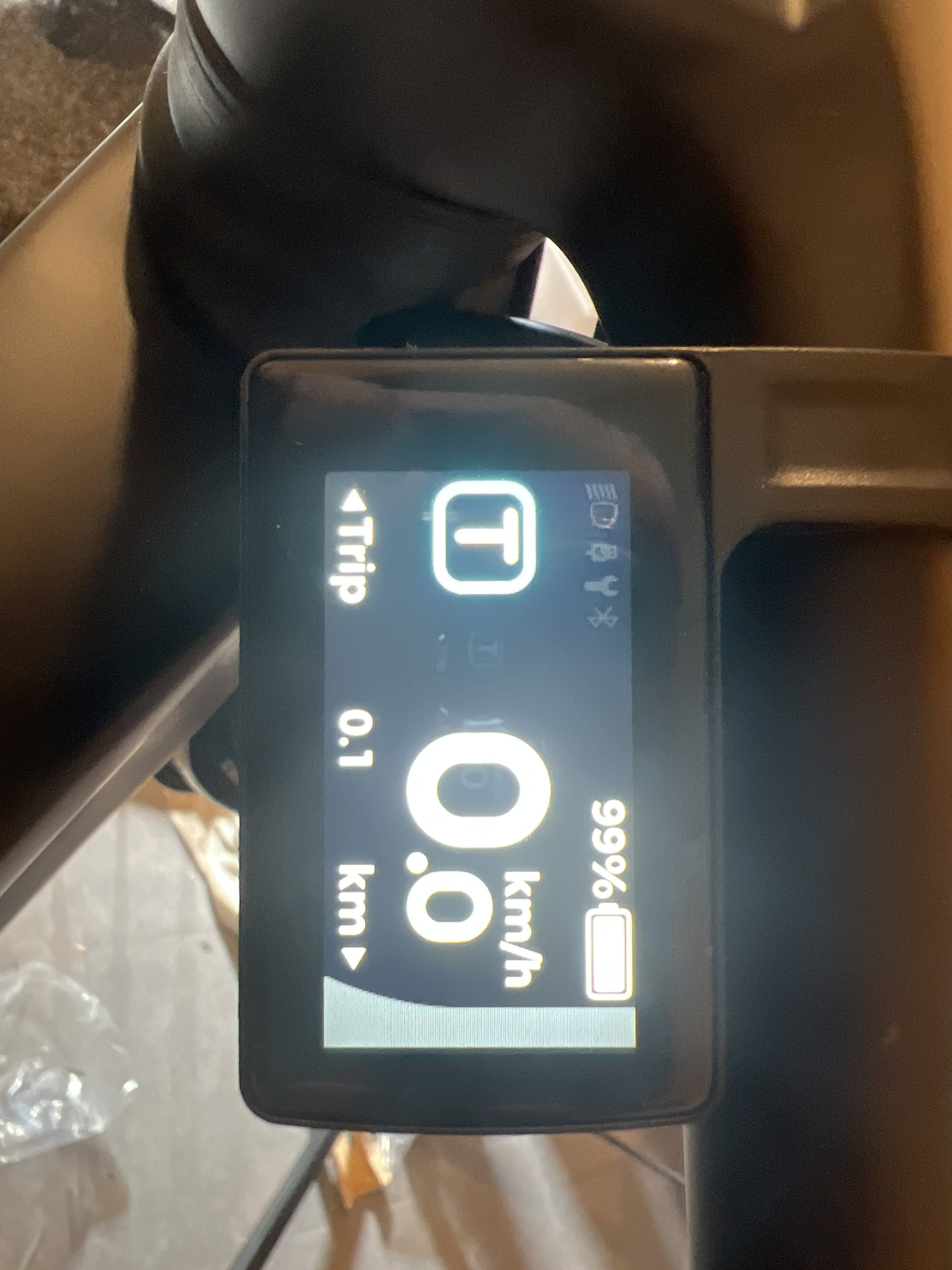

Tour is 3rd level, middle one out of 5? If I calculated correctly, it is 180Wh battery, rigth?
WIth full 360Wh battery, that would be cca 1000m of elevation. Nice
brbr
Dec 28, 2022
530
270
France
It’s second level of assist:
Eco
Tour
Sport
Sport+
Boost
Battery is 180Wh, tour delivers 200W of assistance
Sport jumps to 270W, I haven’t test Sport+ and Boost
