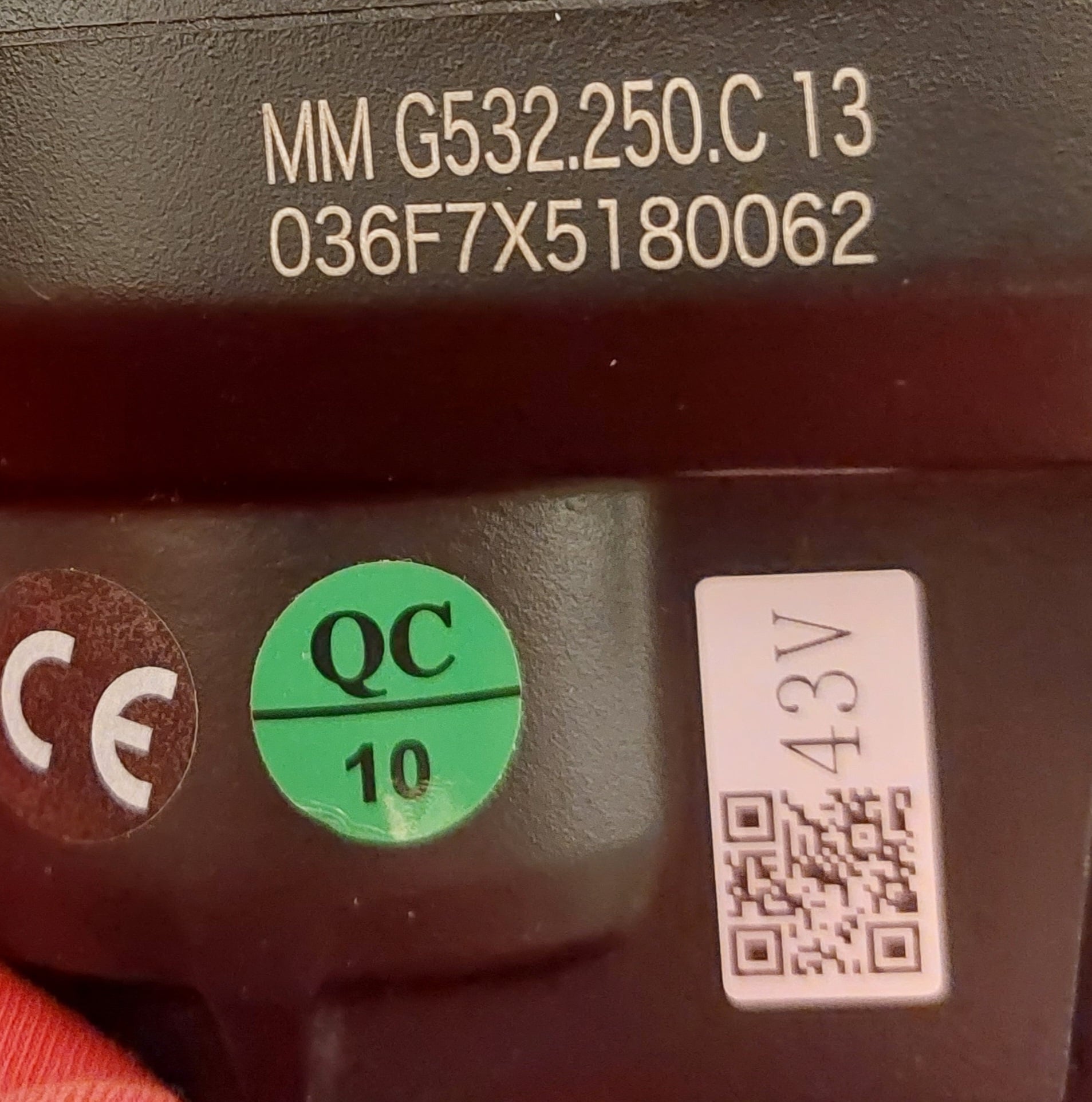

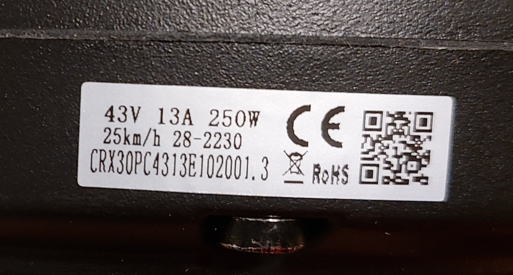

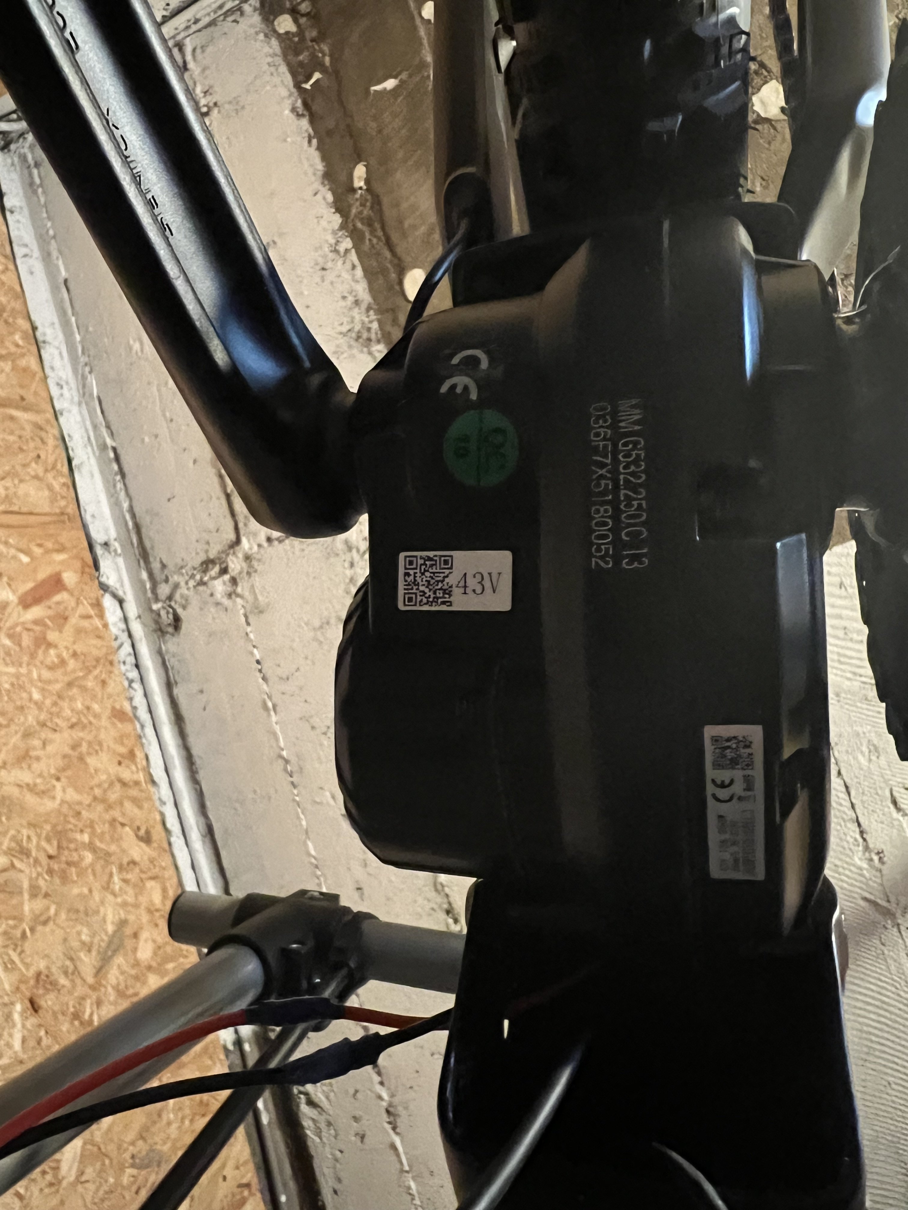

I just plugged my battery and I have error 07, it seems it is too high voltage. that's weird, I only have 12 cells, and my motor is 43V... maybe they are overcharged ? but with BMS and dedicated charger, I don't know how that could be possible
My M820 also has the 43V software, but only goes into error 07 from 54.9V. I'm planning a 13S battery

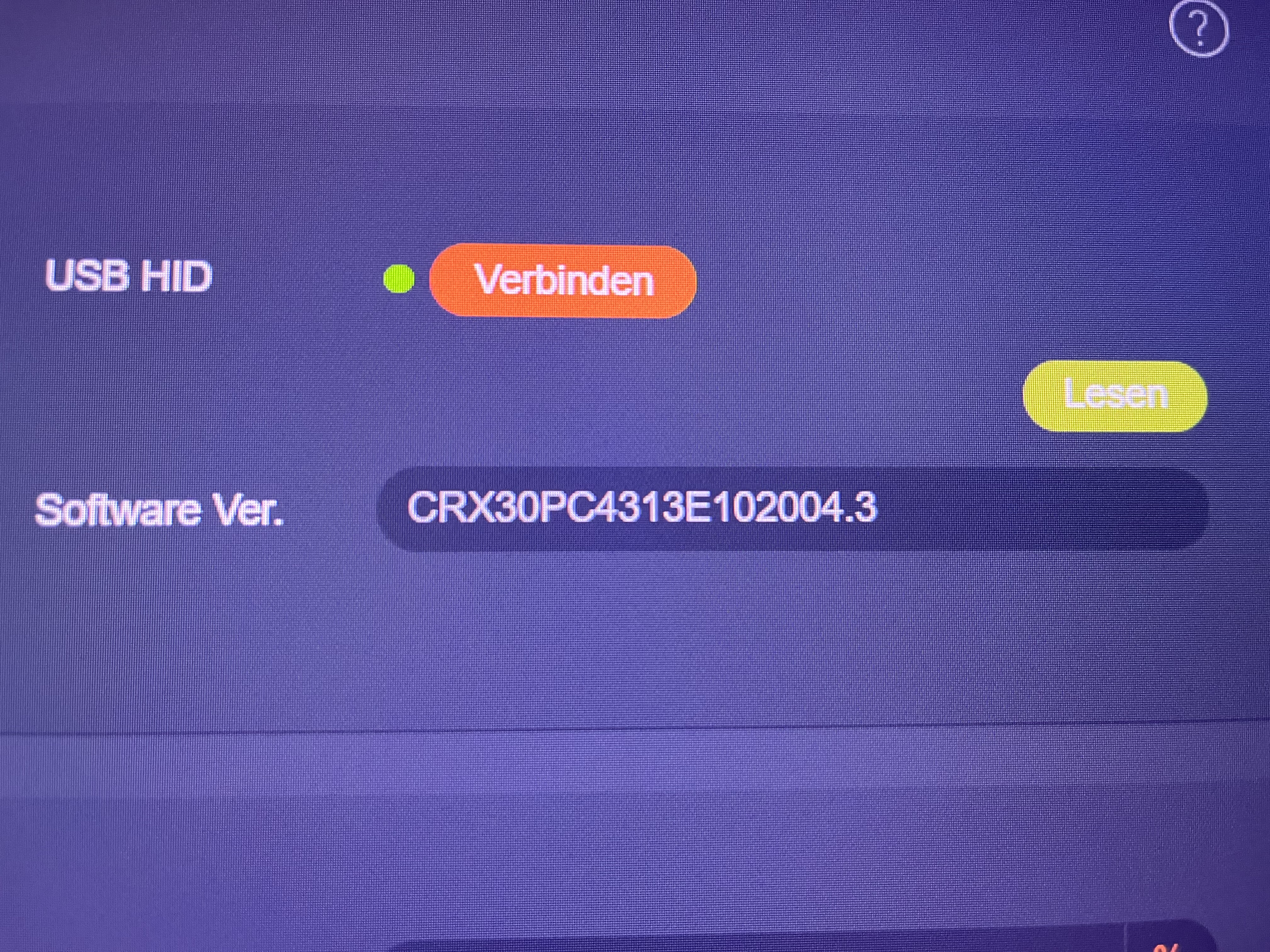

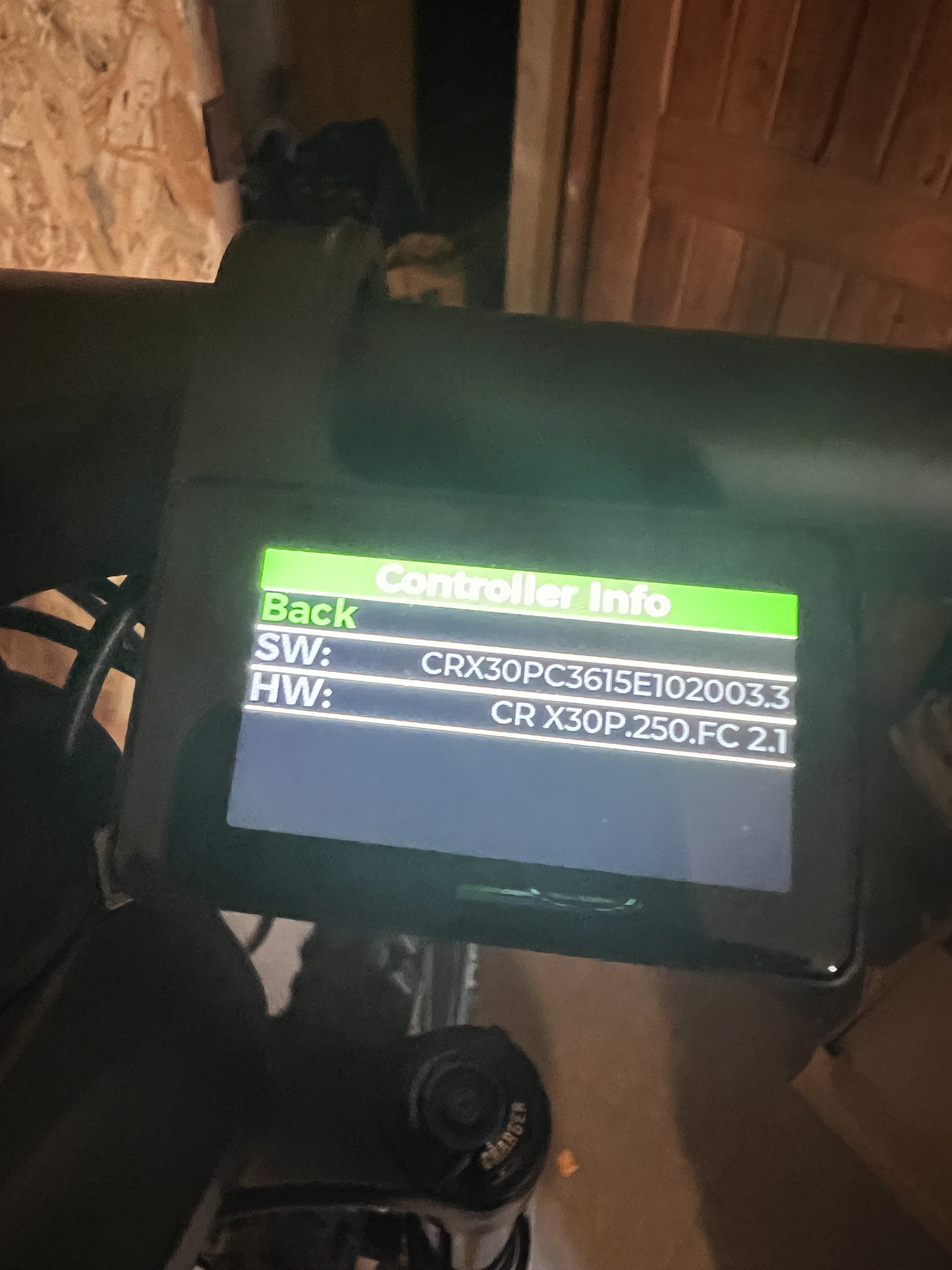

I don't have a battery yet to test. I do already have a besst tool, but because I don't have a battery, I can't read the firmware version.
Did you recieve any additional feedback from the seller? Is it possible to fix it with the firmware update? Will they be able to provide it?

She told me it was possible to update the firmware with besst tool
