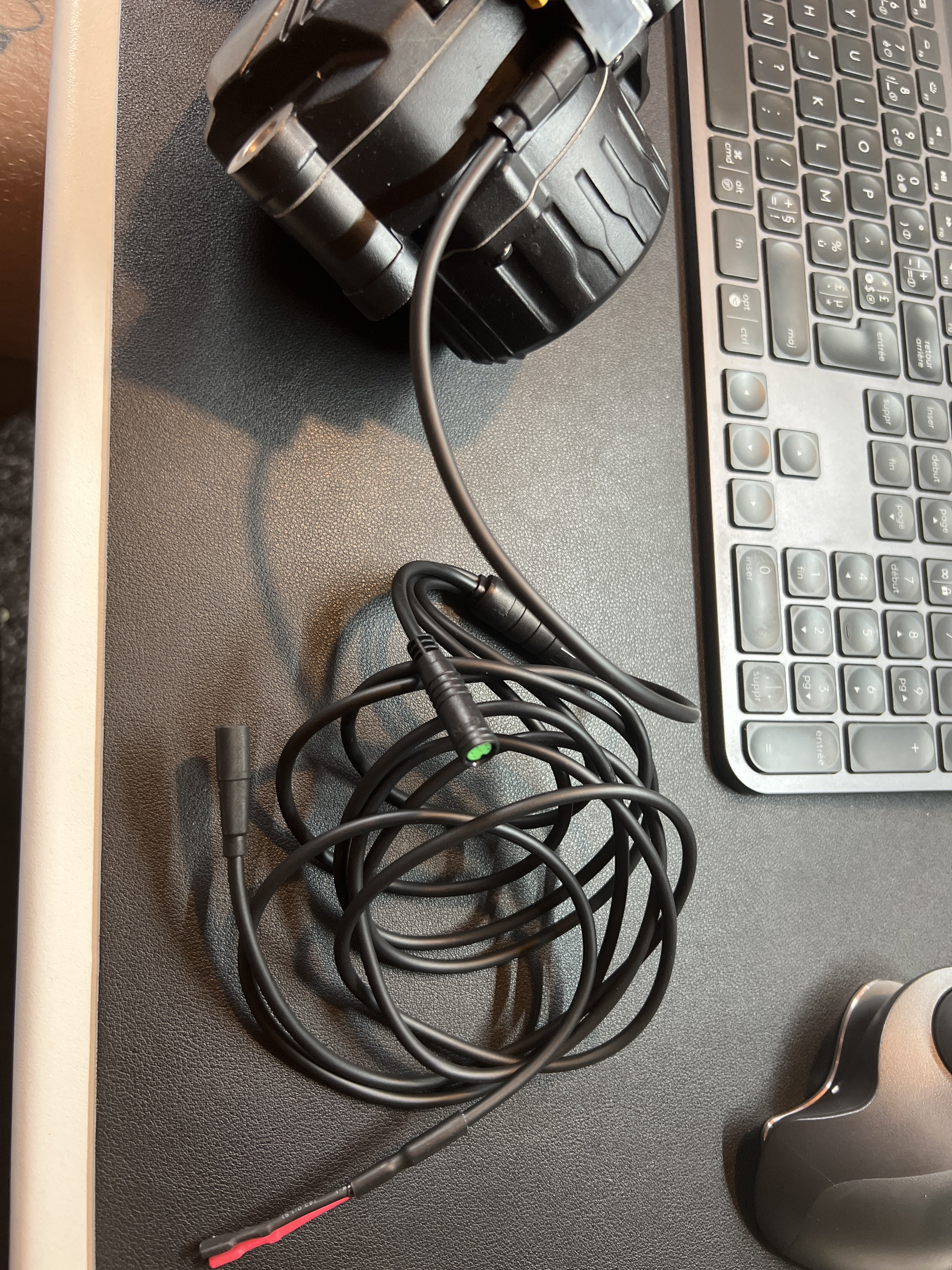

Only one problem, the speed sensor plugs don’t match with with a 8pin connector on the motor and a 4 pin on the sensor wire. Motor runs for a couple secs then trips on speed sensor fault as it isn’t connected.
Does anyone know if this can be overridden or the control mode changed with the besst tool, while I wait for the correct sensor to arrive?
My CEF50 has an adapter cable.
This one right?

This one right?
That also con’ects the display
My motor was supplied with a different set of cables. I have a 8pin next to the power supply which changes to a five pin into the handlebar display (I have no idea what happens to the other 3 pins?). The display then daisy chains to the switch.
On the back of the motor there is a 8 pin for the speed sensor which was supplied with a 4 pin speed sensor cable

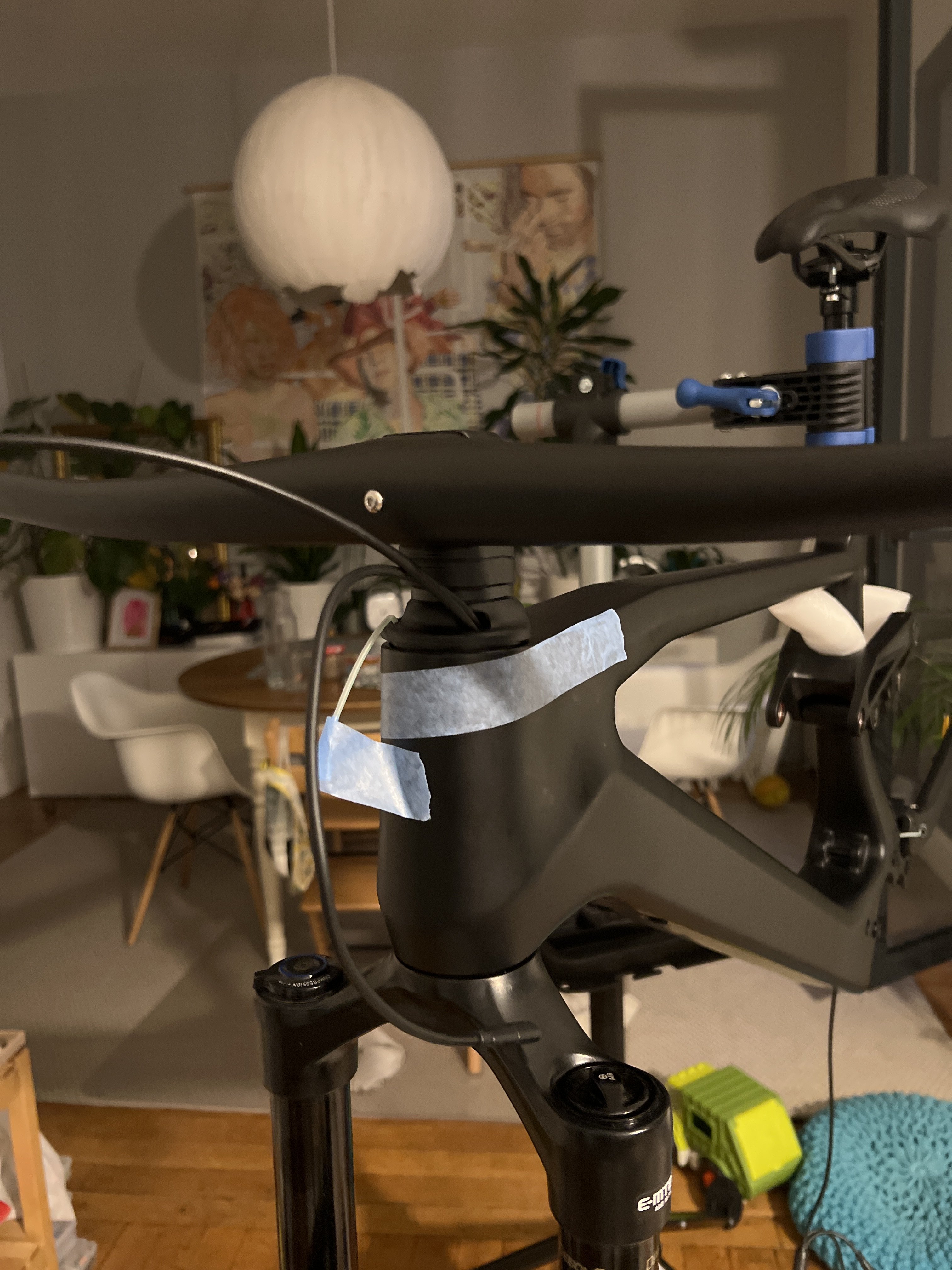

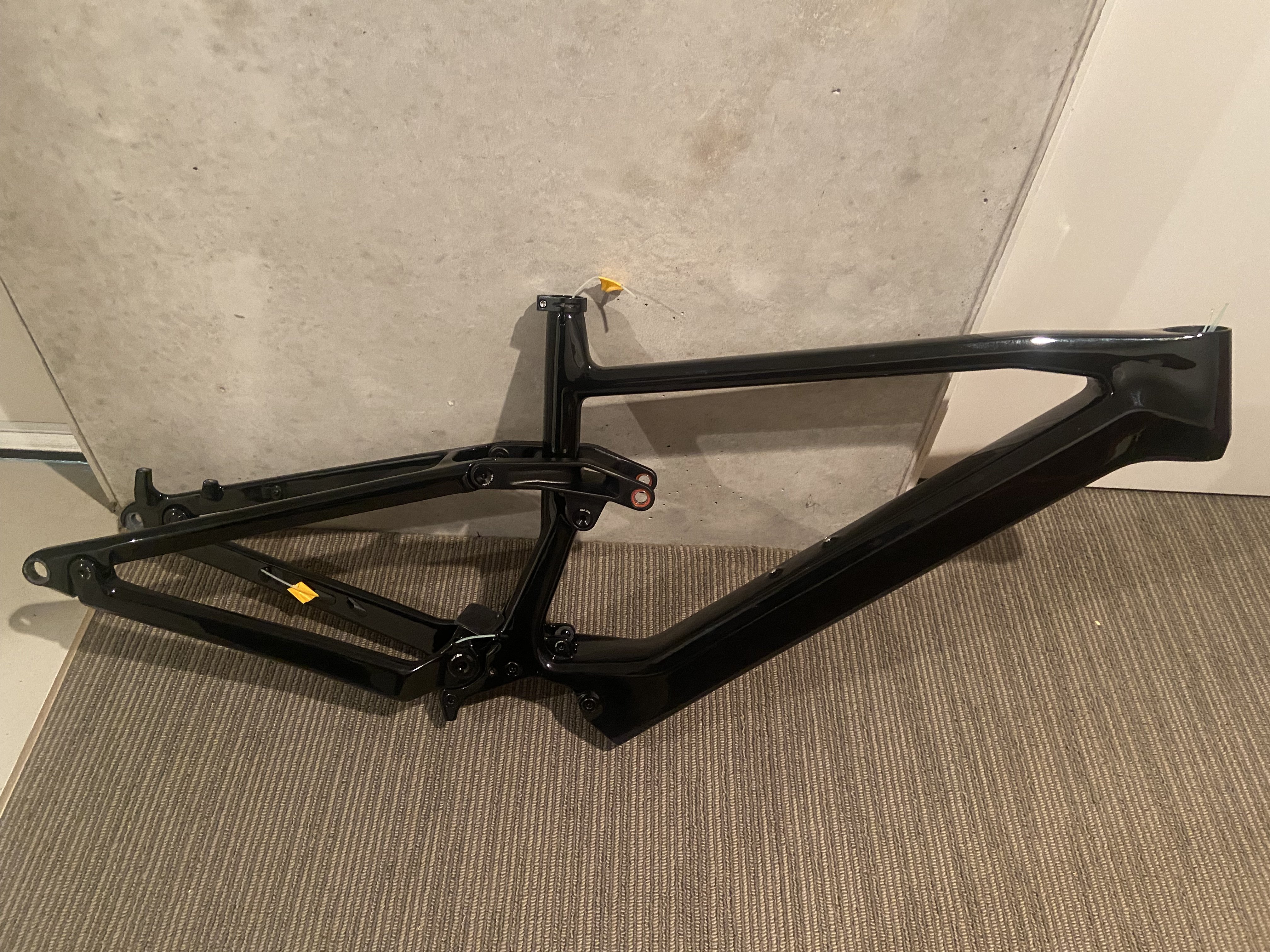

Finally received the frame!
I only have the upper part of the headset, it was the same for you ?
All shops are closed today so I need to wait tomorrow to get the lower headset bearing and cups.

@brbr my understanding is (without having the frame yet), that with integrated headset, you don't need lower cup. You only need the bearing and crown race, that will go on the fork.

Can confirm the bearing presses directly into the frame and the bearing sits directly on the crown race. No cups.
The bearing surfaces are angled to recess into the frame and match the crown race

I just realized I missed both upper and lower hardware for the shock… another hop to the shop tomorrow
Did you receive the upper hardware for the shock ?
I don’t find it in the box and it seems it’s specific to the frame, I can’t really find it online

The frame comes with the hardware for one end of the shock only. The other end needs a 22.2mm m8 bolt with spacers specific to the shock.

Upper hardware is frame specific with trunion shocks. it should consist of two bolts and two spacers.
I will double check on my side but I haven’t seen it. I’ll ping Jim if it’s not in the box :(
Edit: late build, tired builder… they were in my back pocket from the beggining 😂
