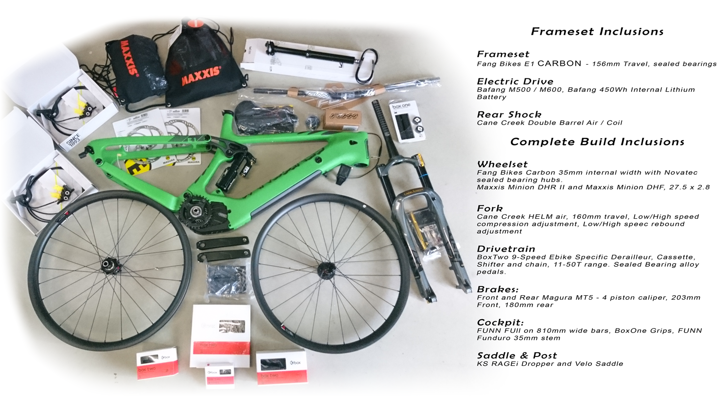

My complete build including motor, battery, pedals, 27.5x2.8" beefy Maxxis Minions was 22.6kg that's with the M500 and 450Wh battery.
Not a 'featherweight' but not particularly heavy I only notice it when I try lifting the bike over a fence.. so usually I go under the fence.

Any details on the frame and maybe a photo of the bike to see what parts you're using?

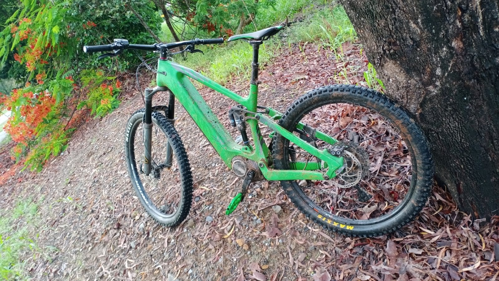

The Helm is NOT a lightweight fork. and everything else is not particularly light weight. but there you go.
In the bottom photo I am testing out a SR Suntour TriAir Rear shock, and seeing how a "Mullet" goes.. not bad.. but not so vastly different that I'm sold either way

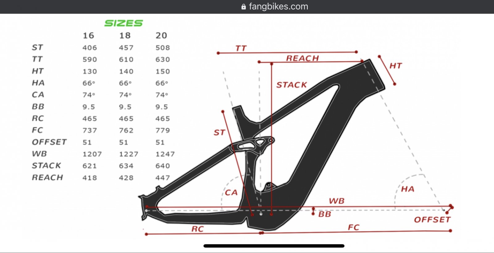

Thats a sweet looking bike. Id be fine without changing a thing. World wide shipping too. I cant find a geo chart on that site though. Also its only a few hundred less $ than the new megawatt
