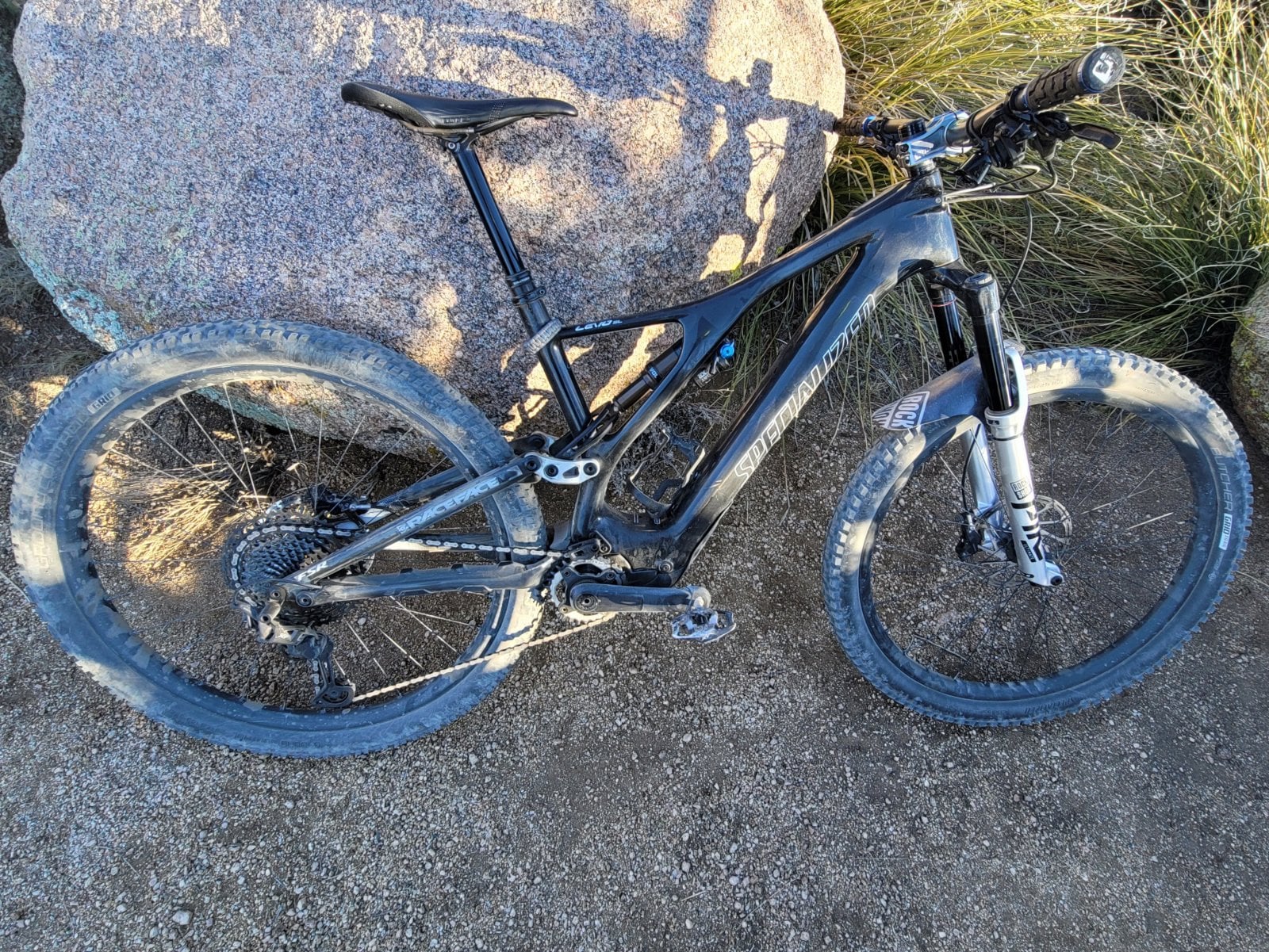

Sounds like you're enjoying the bike. How's the power compared to your previous Decoy? What kind of range are you getting?
There's no dispute that my bike cost a lot of dough. 39.2#
That’s an awesome bike and very light. I’m currently waiting on a part to complete my build before I shred. I’ll let you know though. My final weight should be around 43#.
