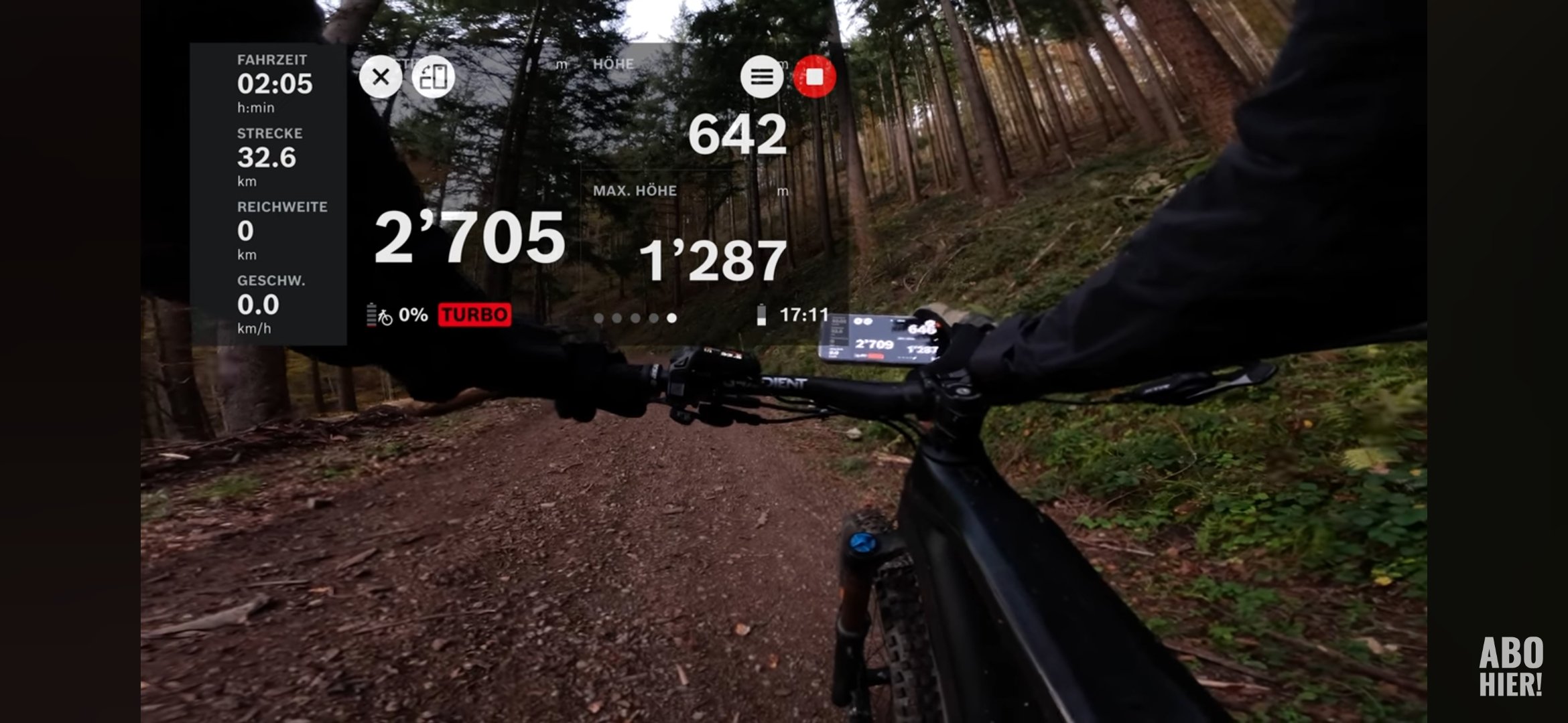

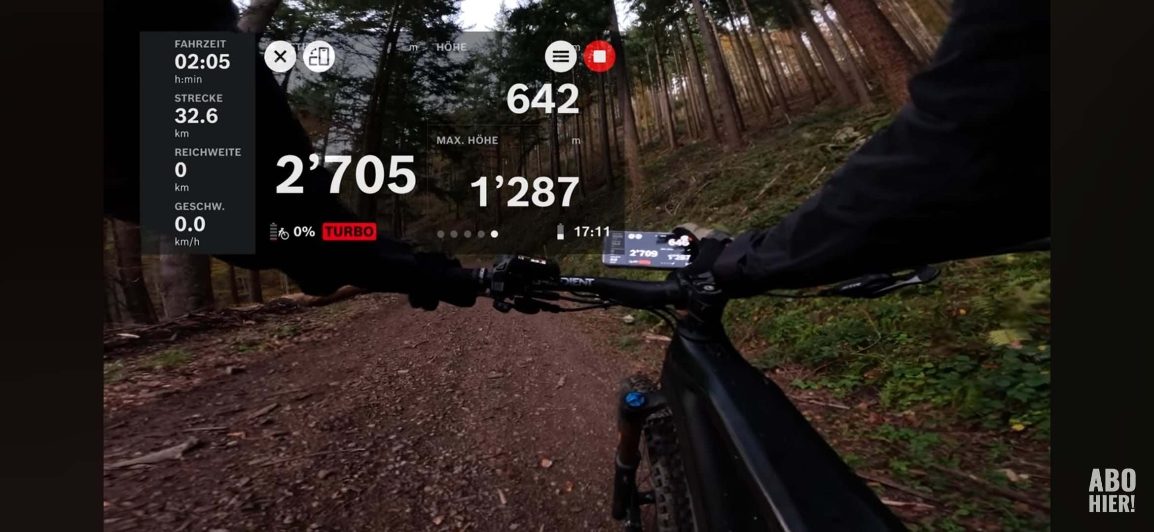

Hey just for comparison and a wider understanding how good systems are becoming. I think this is pretty impressive...what this guy on yt did:
New Bosch CX gen5 all in turbo mode,
The 800Wh +250Wh extender,
Time of 2h5min,
Average speed 15,5kmh
Average incline of 8,5%,
His ride ready weight 75kg,
Bike weight 23,7 kg(800Wh+250Wh),
Distance 32,6km,
Altitude gain 2705m.
What I liked is the fact that the main pack and the extender worked in dual mode(discharged simultaneously) until 10% remaining on the main battery pack.
I think the new Bosch is still a contender, despite it's low torque figures, there is more to see there I guess...the improved thermal stability(seen from lab tests) could imply to a torque bump in the future.
I am eager to see how the new Brose is in comparison.
