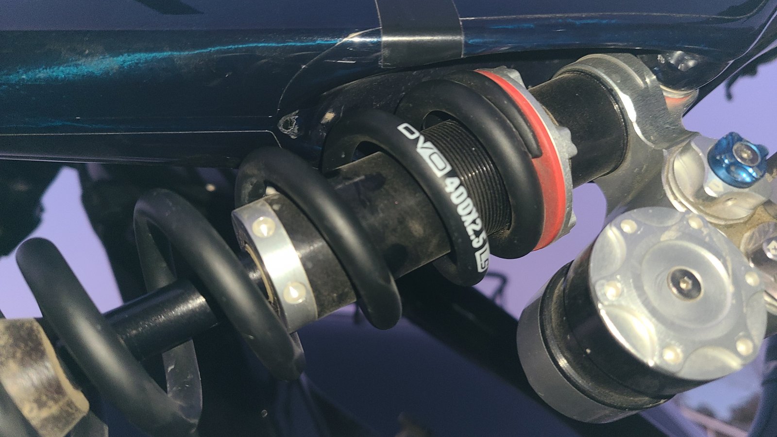

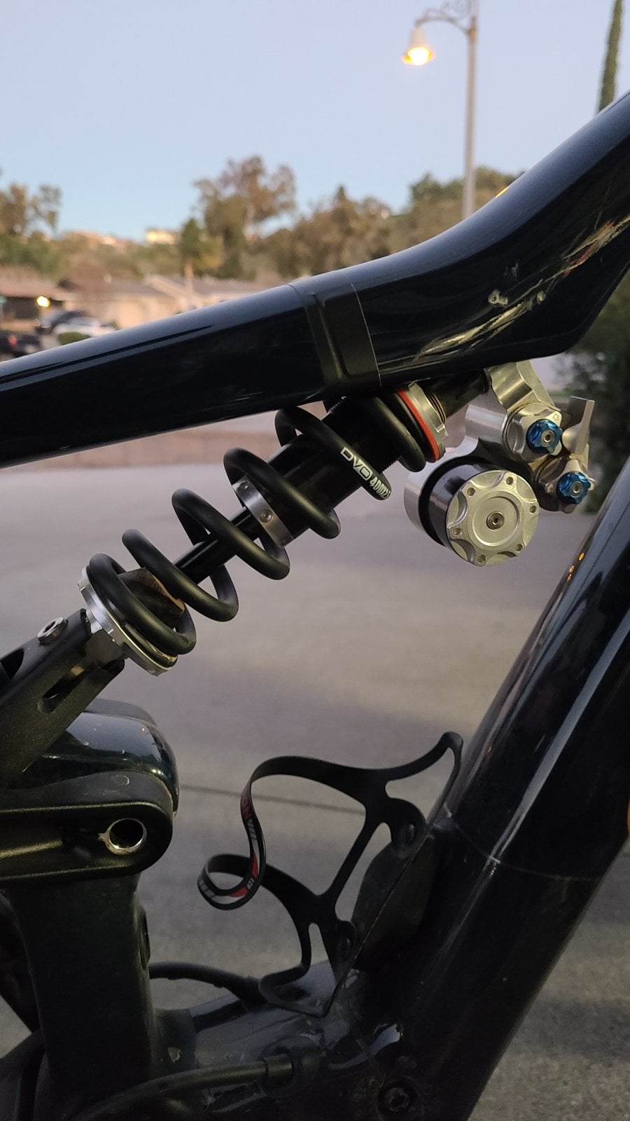

My friend converted his M10 Medium to mullet setup based on users feedback on this forum for a couple weeks now.
Front Fork Fox 36 160mm / Rear Shock Push Coil 160mm = 216x63mm (8.5x2.5) with one offset bushing (tail).
In the past couple rides, he started to hear some weird friction noise below the frame when going over some bumps - not all the time - and so did I when I took the bike for a ride. So we looked closer and found that the rear shock coil has come into contact with the frame when the rear triangle got compressed and has left some marks under the top tube. We are a bit concerned as wondering if it would cause any damage to the carbon frame.
Anybody has experienced with this issue and how would you resolve it?
Front Fork Fox 36 160mm / Rear Shock Plush Coil 160mm = 216x63mm (8.5x2.5) with one offset bushing (tail).
In the past couple rides, he started to hear some weird friction noise below the frame when going over some bumps - not all the time - and so did I when I took the bike for a ride. So we looked closer and found that the rear shock coil has come into contact with the frame when the rear frame triangle compresses and has left some marks under the top tube. We are a bit concerned as wondering if it would cause any damage to the carbon frame.
Yeah that would definitely be a concern to me, what's worse is I don't think there's any chance Orbea will warranty that damage.
I don't think it will have structurally permanently damaged the frame, but I'd certainly take that shock off of the bike.

As others said on fb Push Industry says only for L&XL frame on their website so I would remove shock or try a narrower spring than the DVO one
But won’t get any warranty as running longer shock than recommended

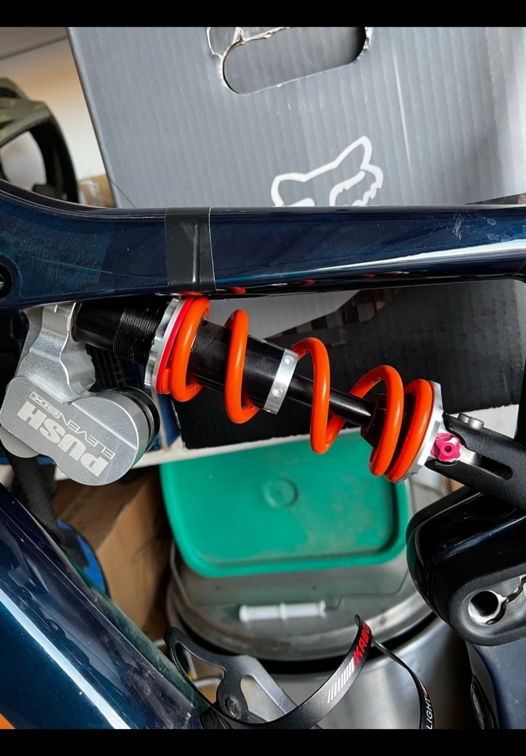

Thanks, can you provide the FOX SLS Coil model #? which size? I check and there are many to choose from.
So my friend added an offset bushing at the top along with a FOX SLS coil and the clearance (visually) seems to be better compared to before... see pic attached. Now let's see how it would perform on the trails...

No, just a regular 2nd hand Push 216x63 off Pinkbike. Push has no available model on its website for RISE Small/Medium
Yeah I have a 230x60 for a Rallon 11/6 and when I saw that they now supported the Rise I enquired about getting it reconfigured but they won’t do it with the v1 11/6 :(
