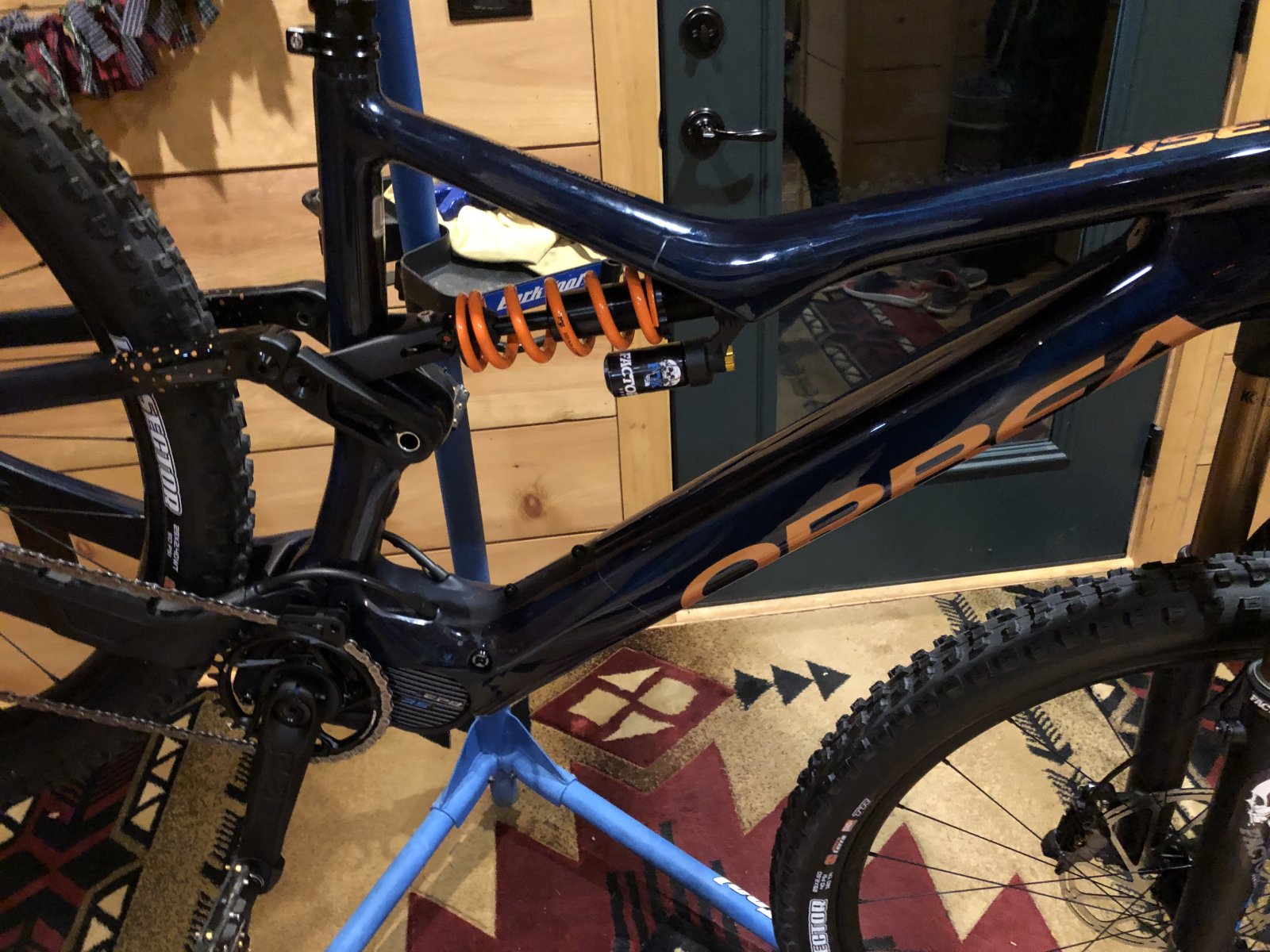

Just for info, am running a Monarch Plus RC3 @ 210x60 on my M20 rise that I had left over from and old 2016 Trek Slash, fits perfectly and have no issues with the back wheel buzzing either the frame or seat (am on a med) just looking at what other options there are at 210x60 and it seems not a lot :(

Looks about perfect to me! Let us know how that DHX2 holds up over time.
All my parts to swap have arrived, just waiting on the bike now. Ship date is now 4/19... plus customs... other holds. gahhhh!

Did you validate that the shock is ok following Information on
I’ll check when I get home. It looks like it’s fine if you run a 55mm stroke shock but is cutting it close for a 60/63mm stroke shock. The bulletin is saying further investigation is needed if you go longer than
About 69-70mm which is just below the maximum 72mm allowed by Fox for a 65mm stroke shock. On a 63 stroke, it would be about 75-80mm allowed so it’s more than good
