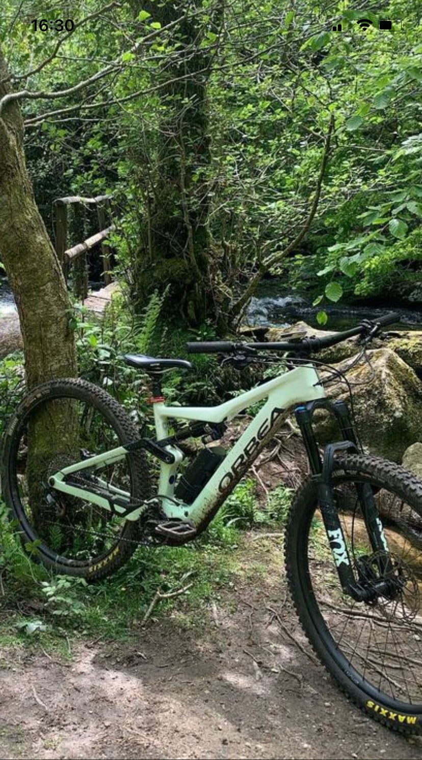

Back before I switched some bits over (and it was sunny)

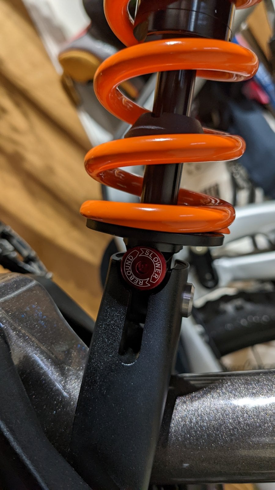

Installed a Bomber CR today on my new H30. I did NOT have to file or shave anything down for it to fit.
Unfortunately, because of weather (temp and snow) it will be awhile before i can test it out.

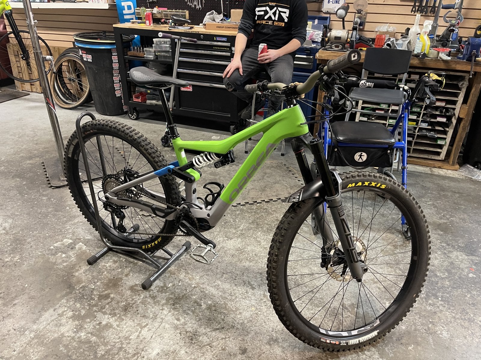

Having long stroked my ripmo AF, i have a bit of context for this bike. You dont want to just add travel for the sake of adding travel, if you keep the same eye to eye length and keep the sag in MM the same (which you should to keep kinematics as designed) then the extra travel is all happening at the top end. Unless you find yourself bottoming a lot you arent real gaining too much of actually usefull suspension where you live the most often. Theoretically it would lead to a more supple mid stroke since the air doesnt compress as much. You should ideally increase your eye to eye and stroke so that you can distribute that extra travel and down and up.
jbrown15
May 27, 2020
815
686
Chilliwack, Canada
That’s a Zeb! What is the travel on that suspension? These forums are opening my eyes to how much potential there is in this bike
that bike is currently setup with 160mm on the front and 140mm in the rear. Rumour has it Cascade Components might be coming out with a link at some point, which I think could give it 150mm rear travel. Just a suspicion at the moment. This bike weighs 43lbs, which in my opinion is completely justified with how it rides and feels.
