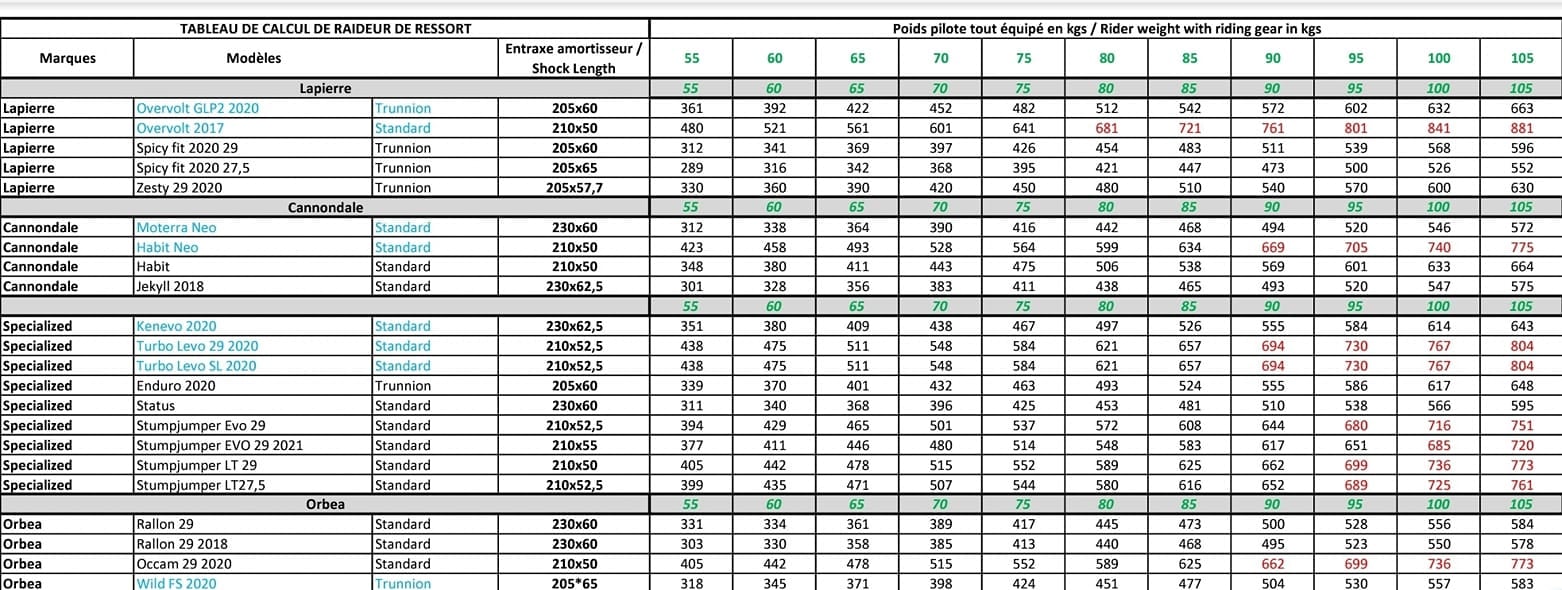

Really I don't understand the rise progressiveness... I know some guys with the storia ext and 450 spring with 85kg...548lbs is less than I need using ohlins ttx... Numbers of this table..
