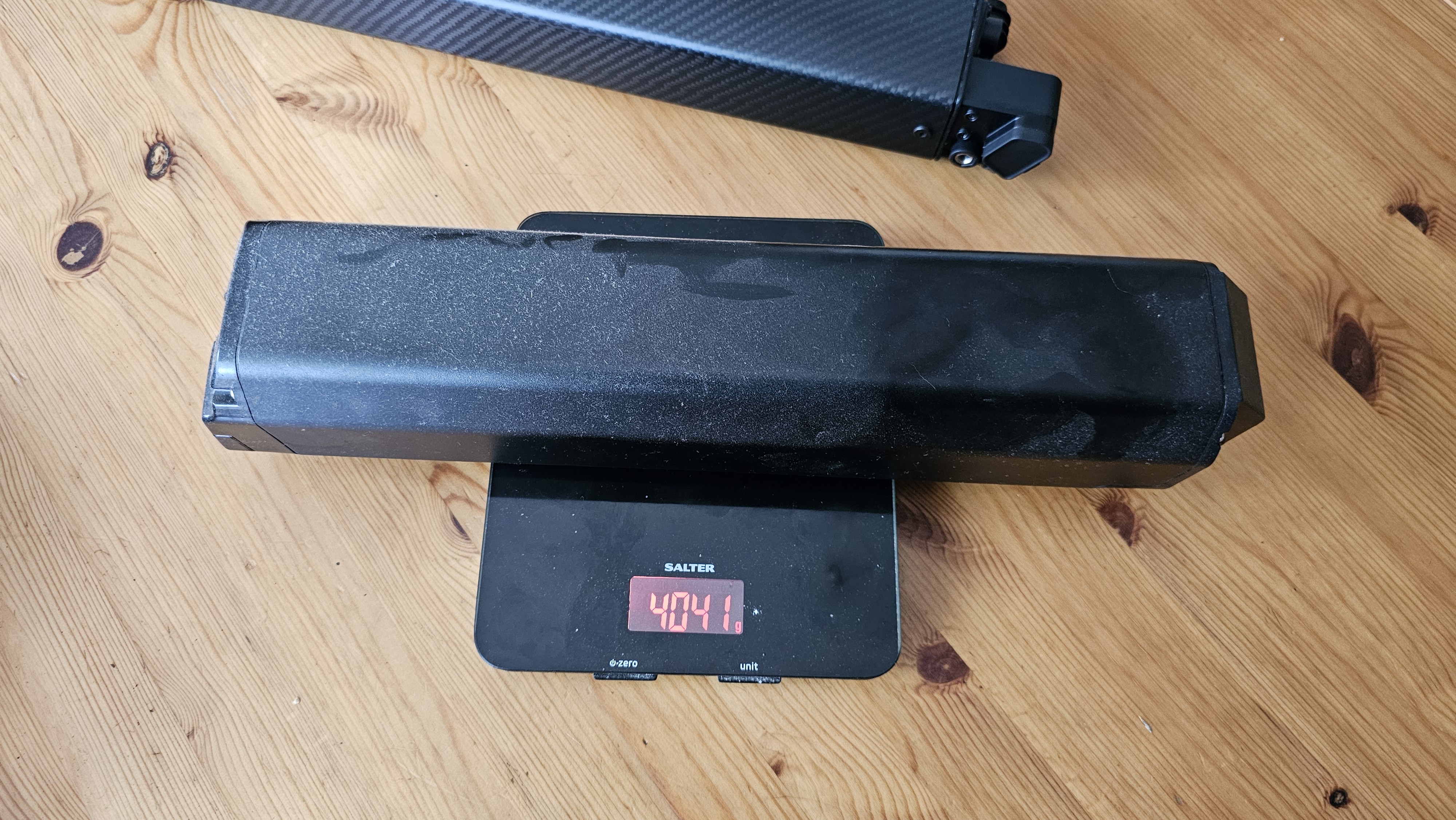

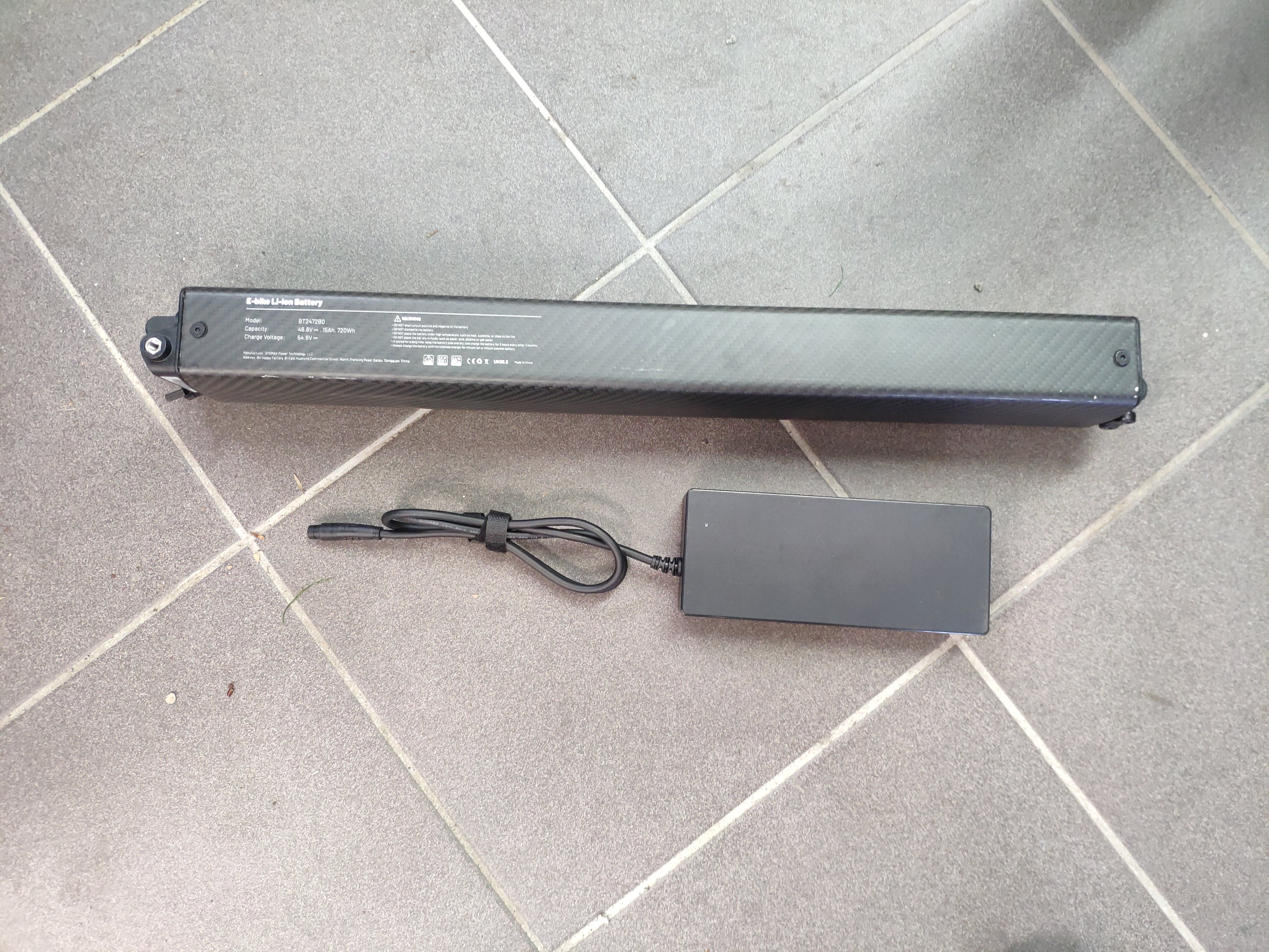

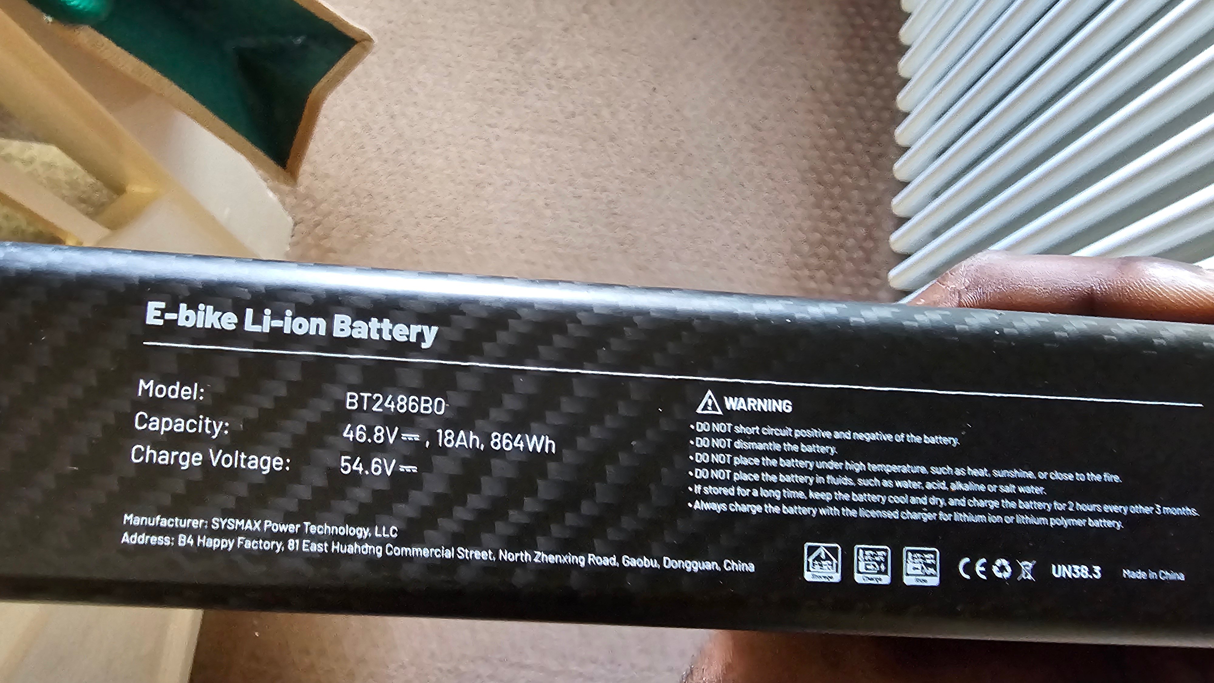

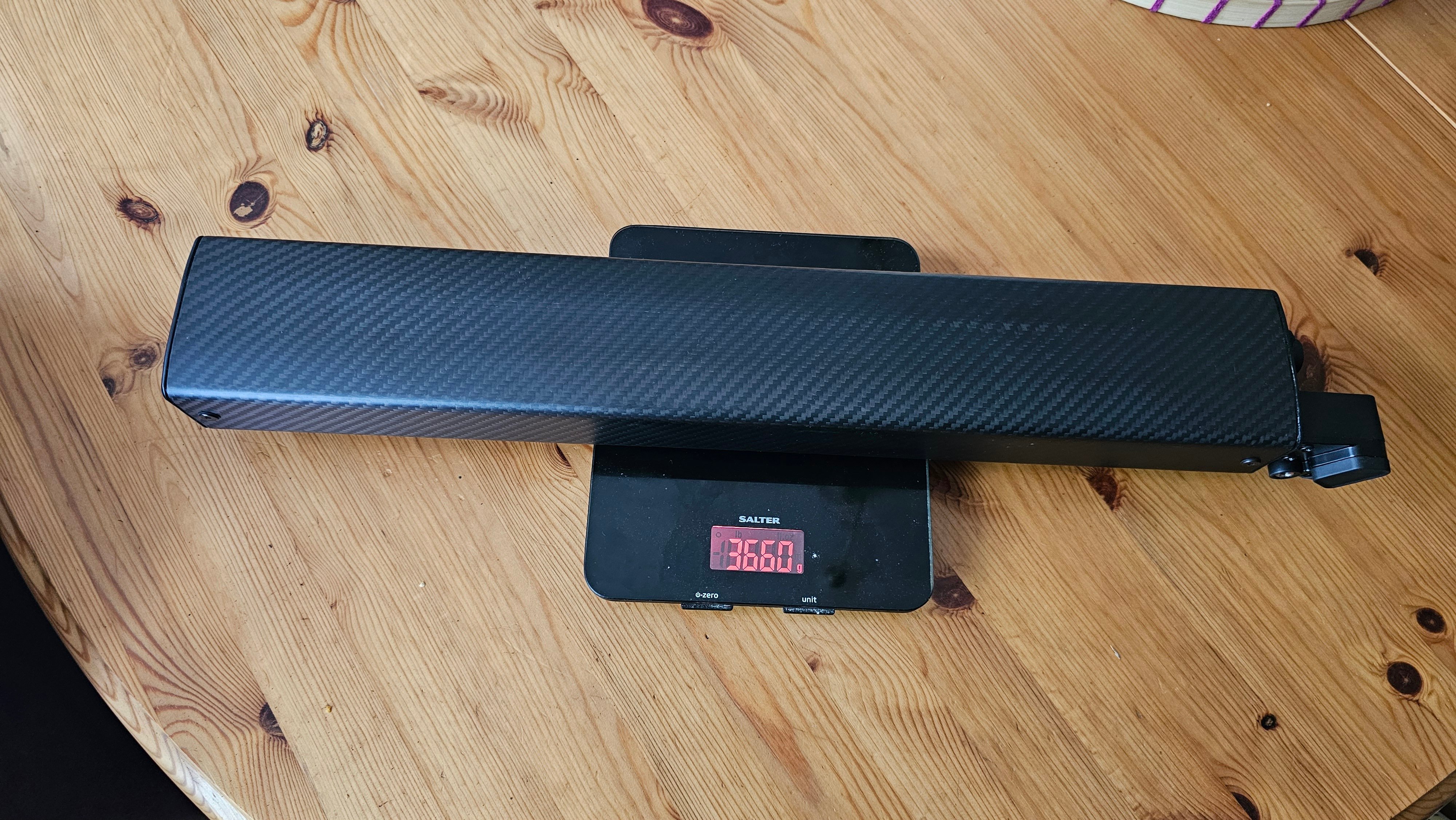

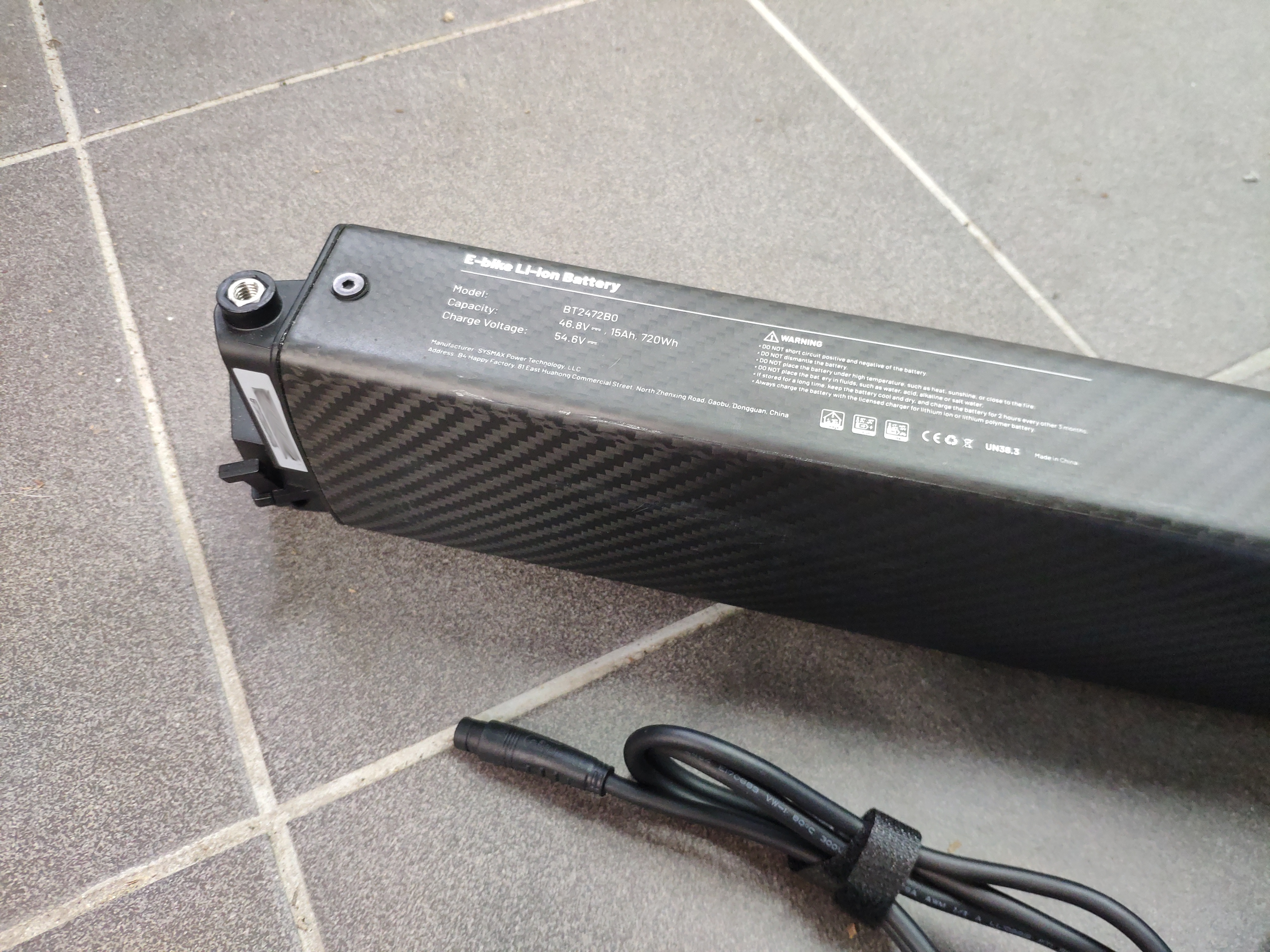

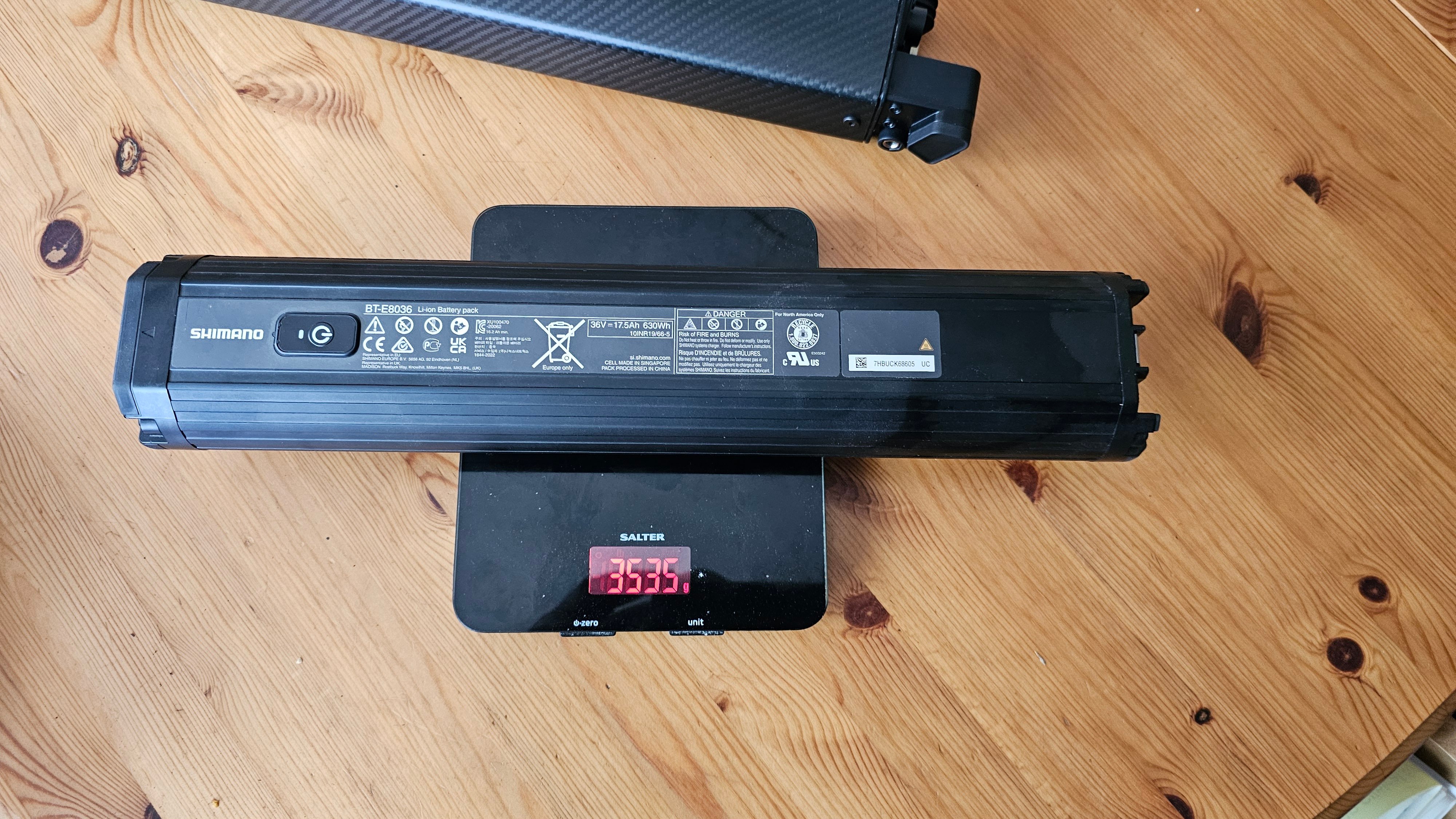

Seriously, why haven't other brands opted to use a carbon shell for batteries.
1 kg more between a shimano 36v 630wh battery compared to the 48v 864wh for the Hybridizer Sann.
And 400g lighter than the 840wh Dengfu E10/E22 battery.

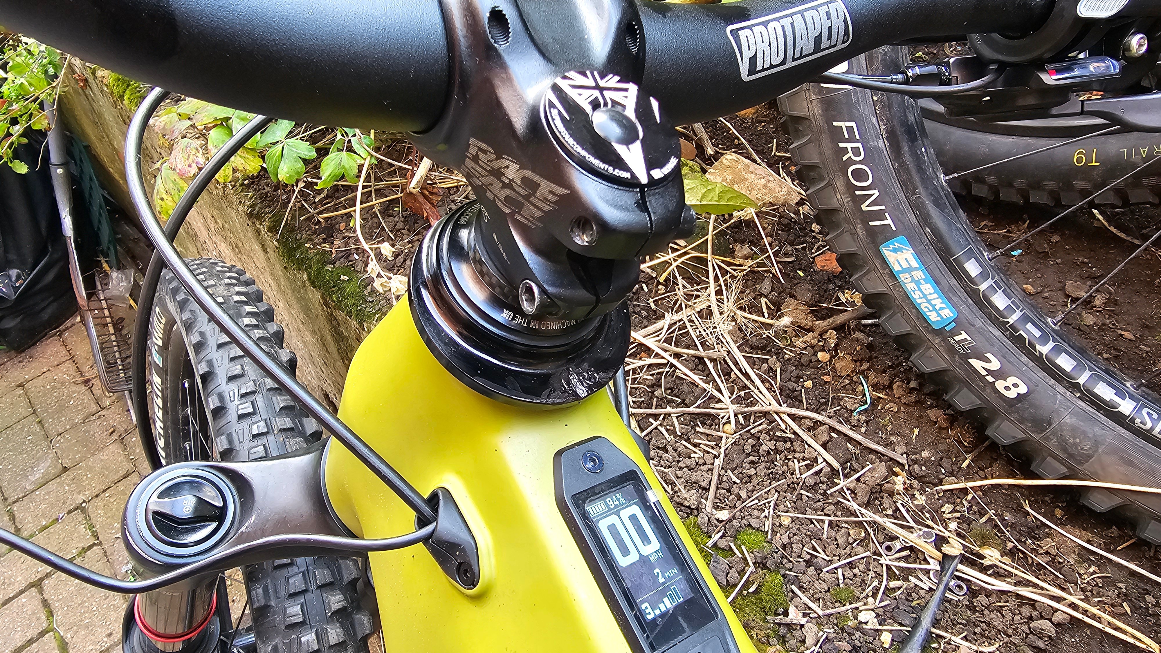

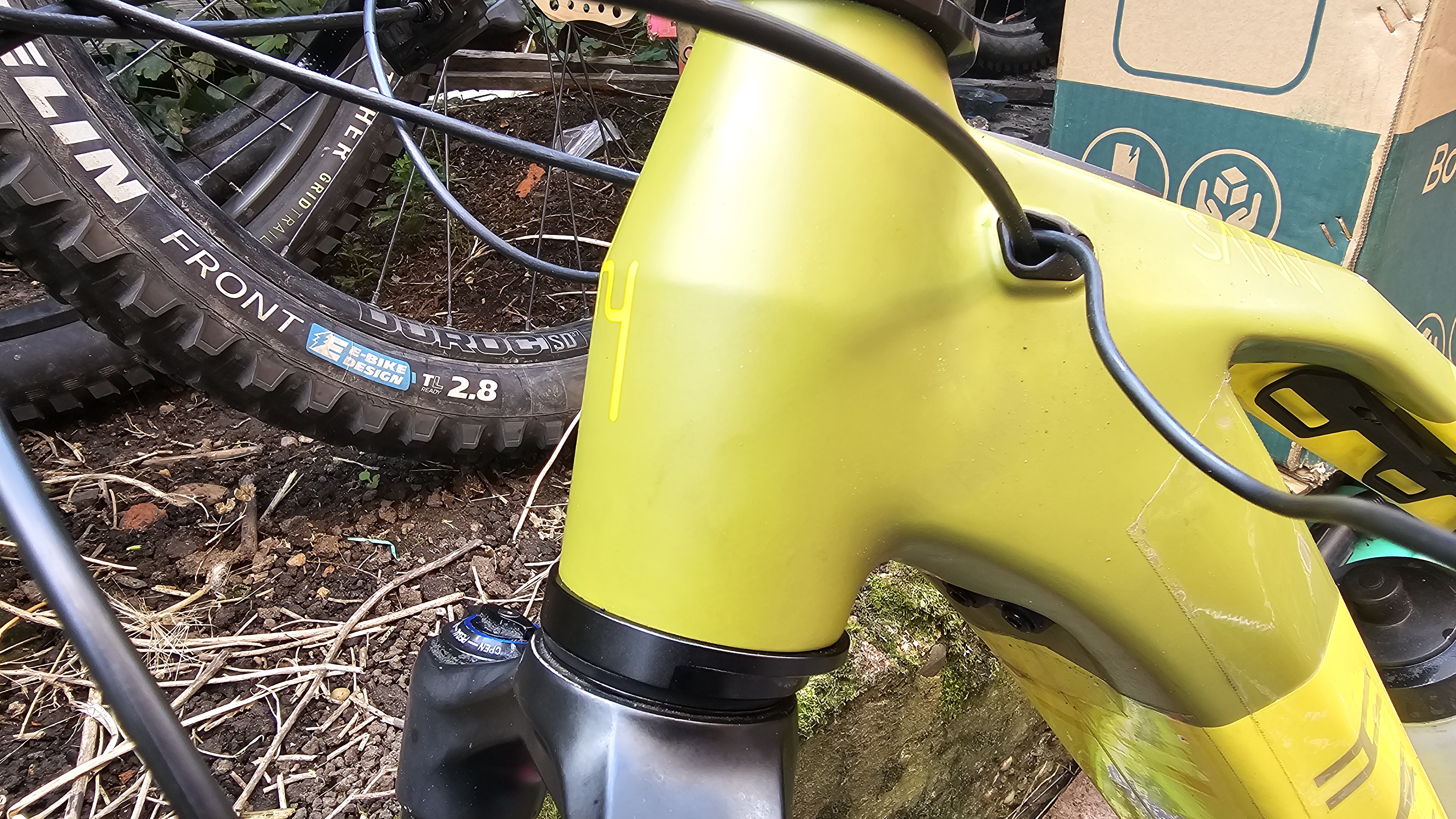

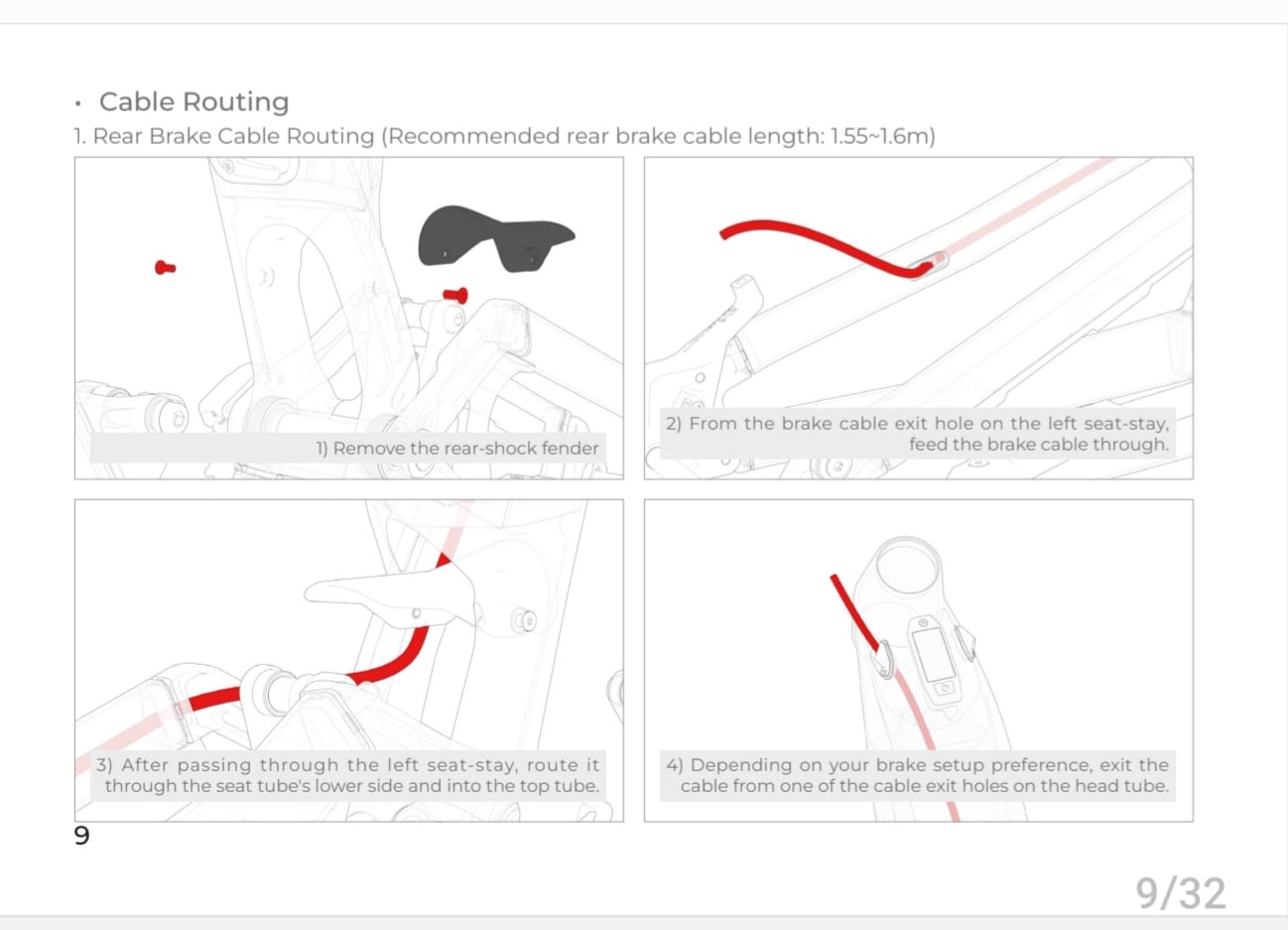

Has anyone else thought about running the rear brake hose through the downtube, instead of the top tube?
My fear is that I'm going to hear cable rattle constantly. Not to mention, I'm a UK rider.
So my preference of routing the rear brake would suit going out of the right side of the headtube, instead of the left.

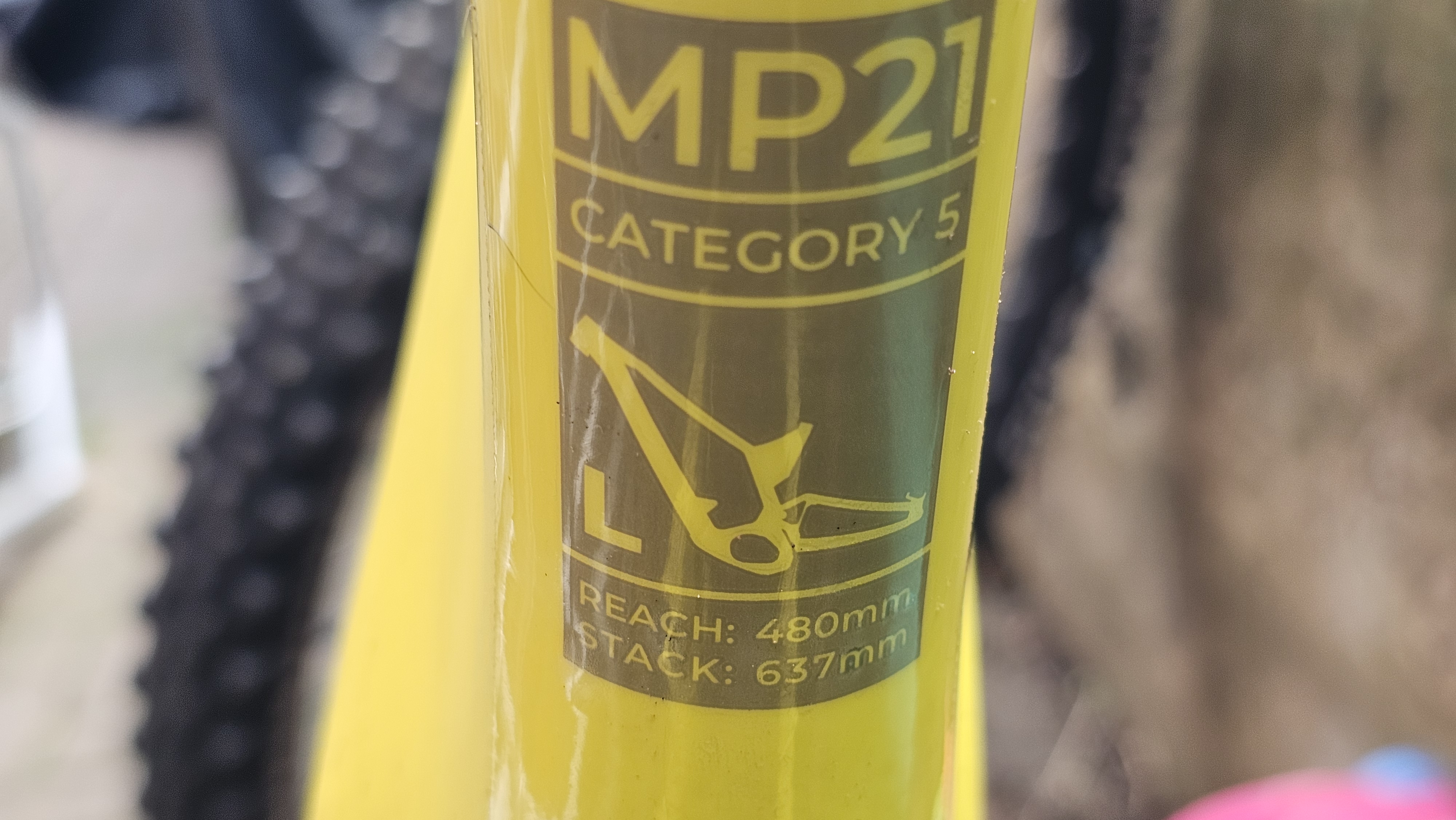

Hallelujah!!!

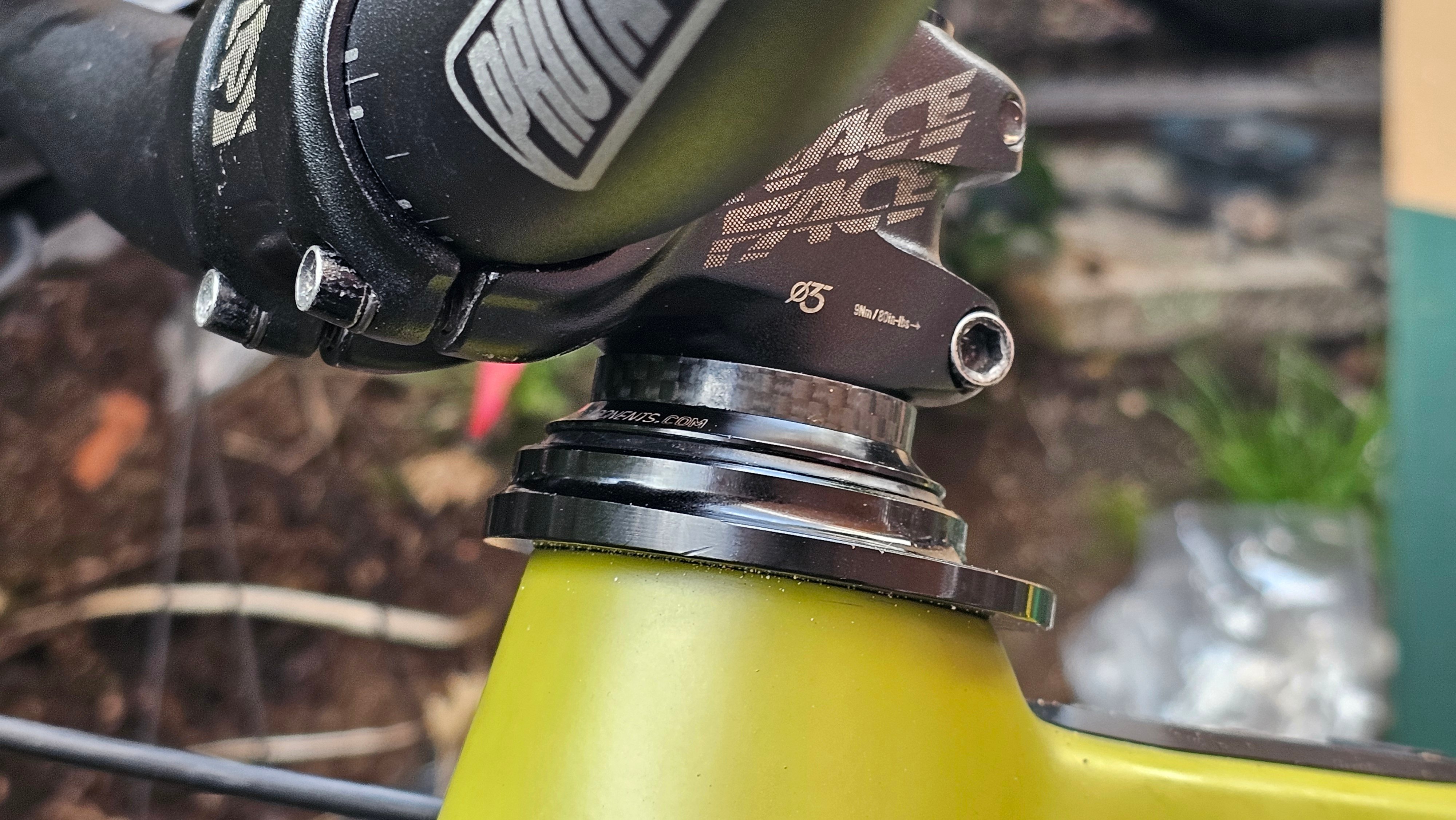

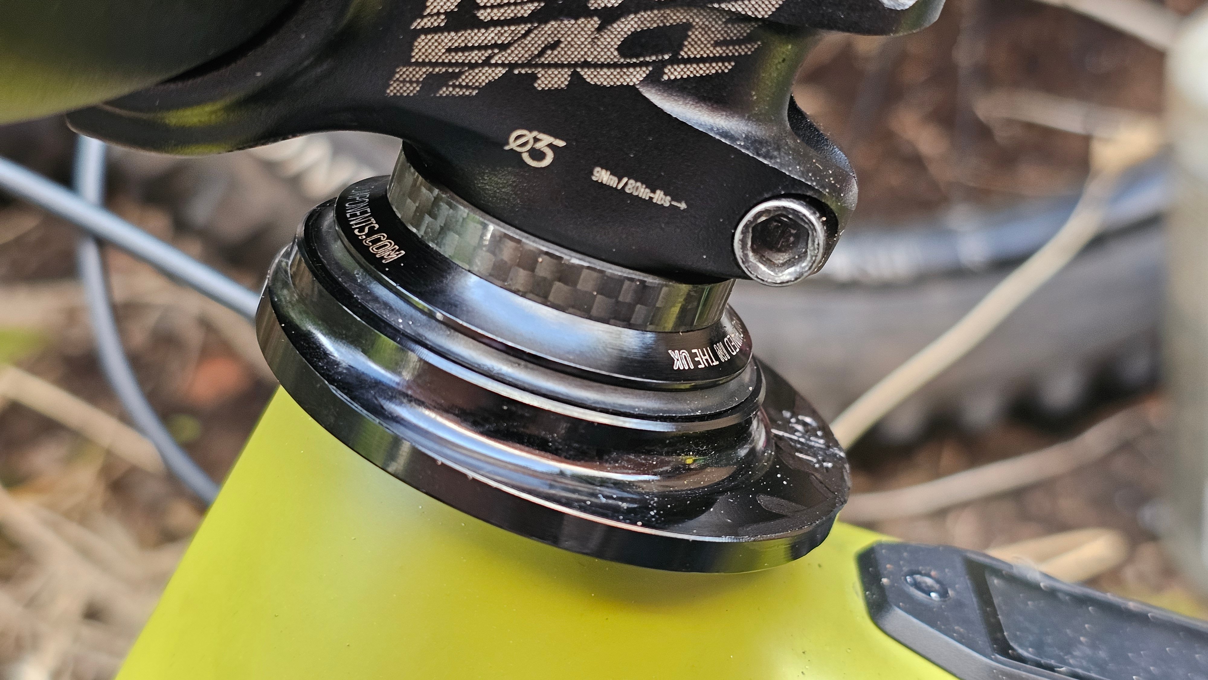

The reach adjust headset fits in the Hybridizer Sann👍🏿
Massive shout out to Superstar Components. They always come in handy for amending geometry for frames I build.
As you can see, the lower headset cup is perfectly seated into the headtube.
Same thing for the upper headset cup.

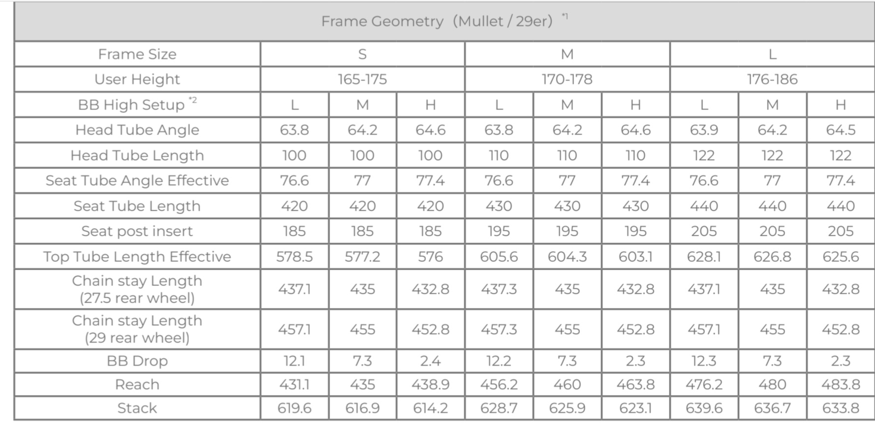

Naturally, the stack height has been altered. But that's OK for me, as the Large frame was on the smaller size for me at 6foot 3inches.
The outer cup of the upper headset is wider than the headtube. So aesthetically, it's obvious it's a modification.
But it has made a difference imo. Especially since the reach in the low position is slightly over 480mm.
It is a pity that Hybridizer don't have either an XL or XXL.
Especially since this is the first emtb to use a Bafang motor which is CAT5 rated.

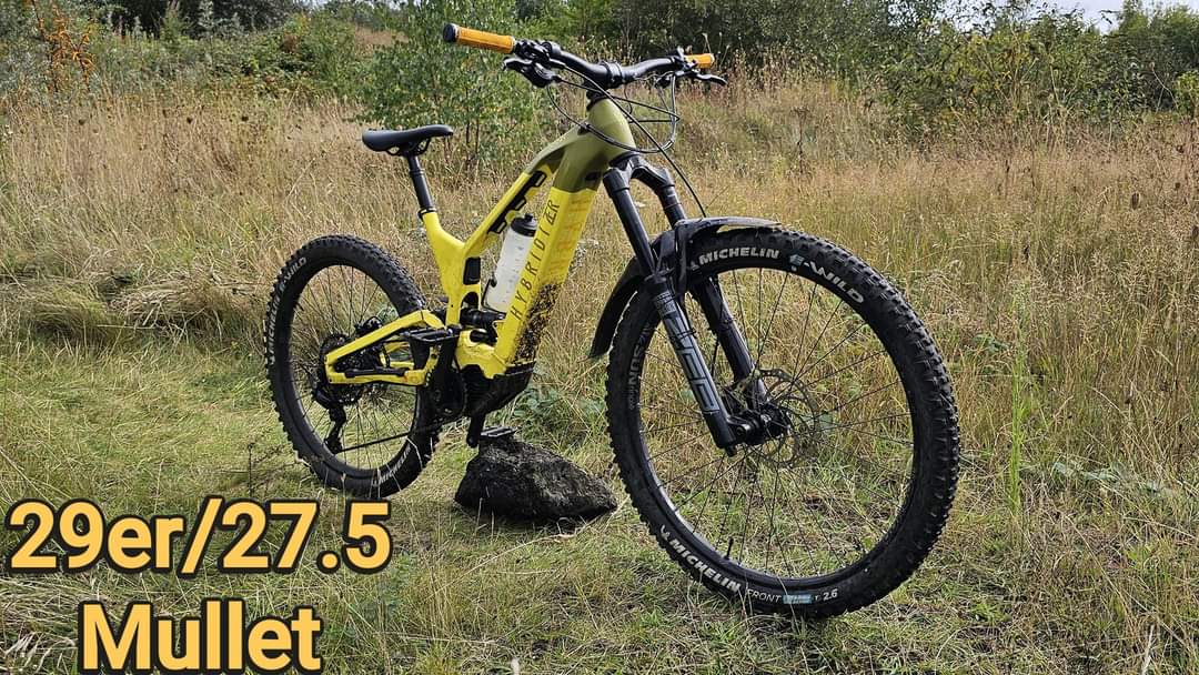

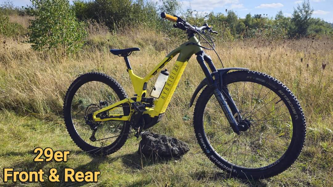

Hybridizer Sann in either MX setup or 29er
Personally, I do prefer it as a full 29er. Note the none-driveside crank position per each image to guage bb height change👍🏿
Looks good!
Went with mullet since those were the wheels I had plus the wife is 5'3. Also ran the suspension in the neutral setting. As a bonus, it did come with a 160mm crankset

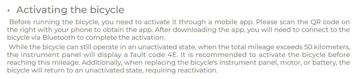

I discovered something very sketchy and untypical for Bafang. Hybridizer forces to activate the ebike, by downloading their chinese app. If you swap the battery, change the display or the motor, it will be deactivated again. This is super annoying when having multiple batteries or wanting to switch to M560!
What's even the purpose of this app? Gathering userdata for free? I see no advantage in using this app.
Thanks for pointing that out.
Can anyone confirm, that Bafang is basically bricking YOUR bike, if you don't install THEIR app?
If yes, I assume that is a "feature" of this new in-tube-display? Just so one knows what to avoid in the future.
Never downloaded anything or even considered it as i pretty much hate any and all apps. The Sann was ready to go when i got it, including a full charge.

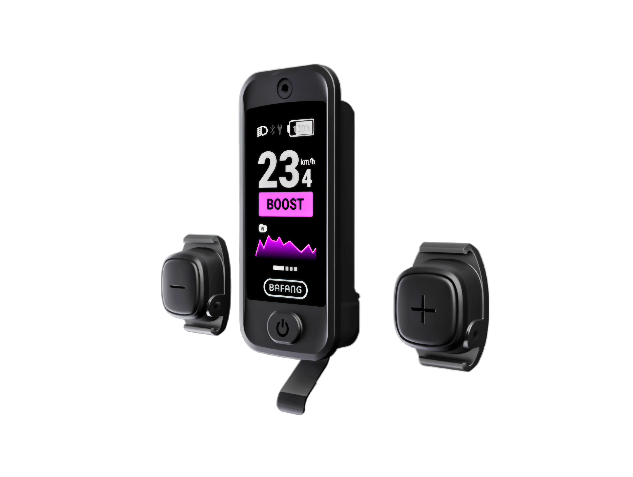

Technically, the downtube display and remote aren't Bafang displays. Unlike the dpc245.3 etc. It's Hybridizers.
I too made that assumption. The Besst Tool doesn't recognise it as a HMI.
In addition, the display can't connect to either Bafang Go or Bafang Go+. It only works on Hybridizer' dedicated app.
It's somewhat similar to the DZ41 display. It recognises the protocols.
The DPC030 is the "True" Bafang display for top tube frames. Which will connect to Bafang Go/Go+ and Besst Tool. If I'm not mistaken, this display comes stock on the Frey Dopamine 2.0.

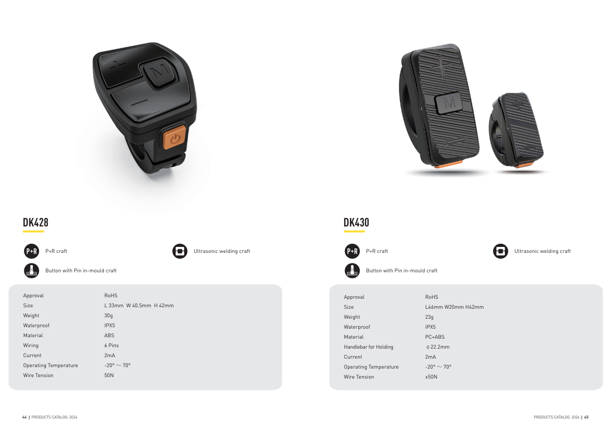

@Neeko DeVinchi this display is not manufactured by Hybridizer. The model is called Topology DZ45. See my post here. The brand Topology (which also produced the famous SW102) meanwhile belongs to Star-Union Wuxing and is listed here: DZ45 - Displays - Products - JIANDE WUXING BICYCLE CO.,LTD.
Btw you can swap the DK428 remote for a more ergonomical one: DK430. Unfortunately it can only be bought in bulk, not in small quantities. 😫 I was not able to source it...! The screenshot is from the attached catalogue PDF.
I was thinking about replacing my DZ45 with a Bafang DPC030.. I'm wiling to enlarge the cutout in the toptube, to make it fit. On the otherside I hate that Bafang is not allowing to show voltage instead of percentage as battery indicator anymore. I question whether doing a swap, is worth the effort, only for use of BESST GO+.
The Key-Disp KD186 also looks very promising.
