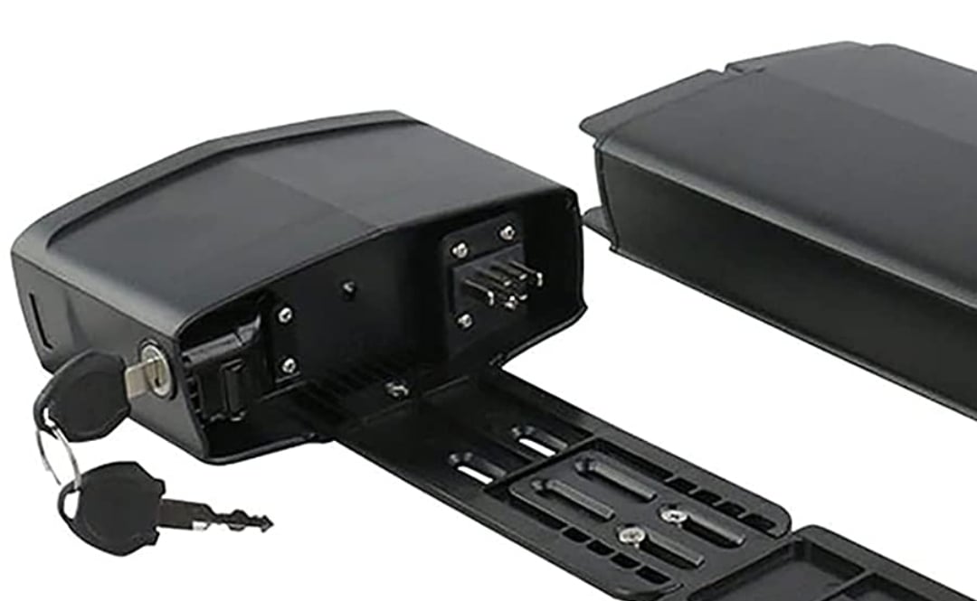

Question about battery connections!!
The ebike has a Bafag M300 Mid-motor.
I want to change my battery to another one that has more capacity. But the batteries that i found in the market have only two cabels (red and black) to connect the power. While my old battery has 4 extra cables in the middle (see photo).
Are they to turn on/off the back and front lights?
Hello.
I think it is the connection cables to the motor controller, through these the controller checks the state of the battery; I think you have to get a compatible battery, alternatively you could recell (sorry for my english) the battery by replacing the cells with more powerful cells.

@Laudix Thanks for answering
I found batteries that also have 6 Pins but I don't know how they will be connected.
(I mean the four wires in the middle)

No need for the other wires. Just for a more accurate battery status and range on display. Without the connection the bike stil functions fine. Range on display may be a little less reliable as before.

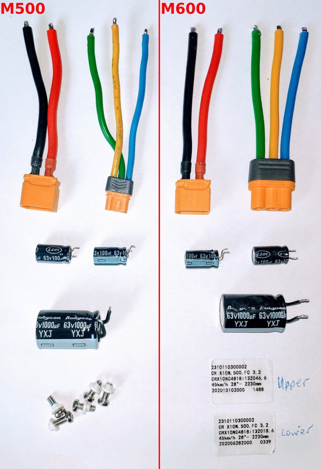

Sorry ... some things are not clear to me:
- what are the changes to be made?
- Which FW should be installed, that of the M500 or that of the M600?
- What are the benefits of this update?
c_pardo13
Nov 8, 2021
11
7
Andorra

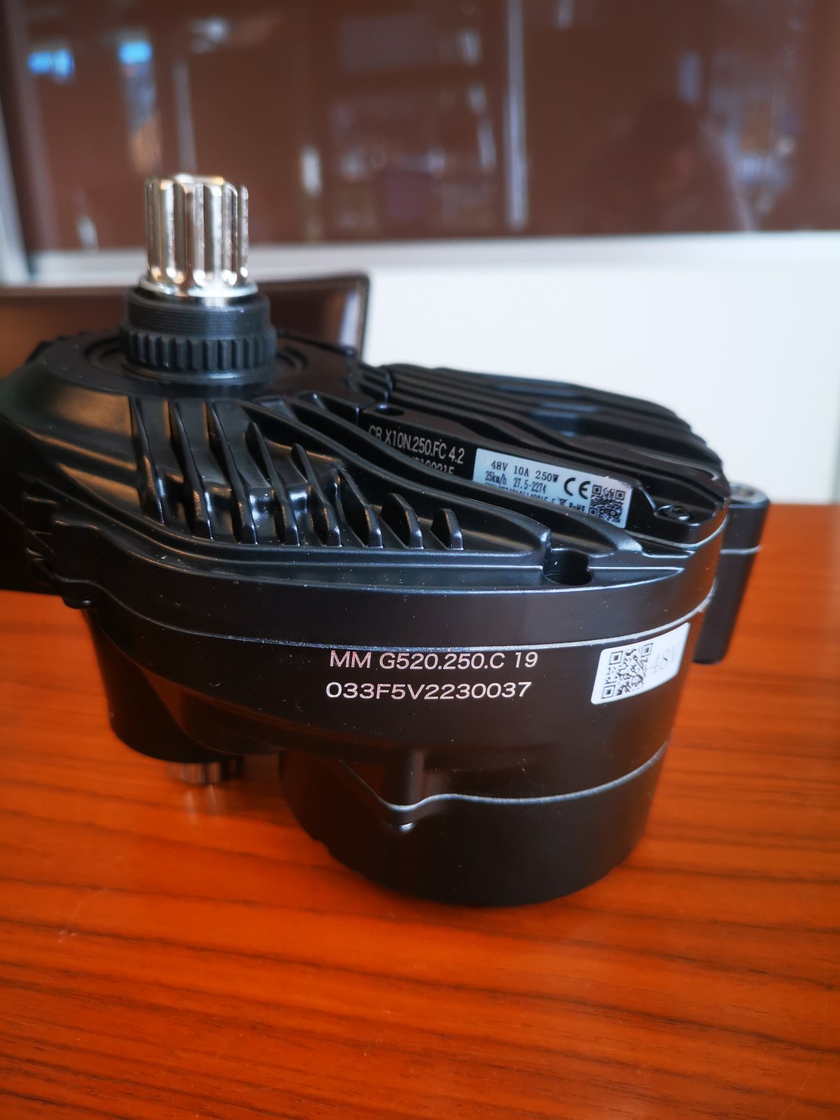

The changes to be made are interchange two cables in the connection to the motor.
The firmware to be installed are the M600 with your voltage. (I can do this with the BESST Tool).
The benefits are having more power (around 900W)

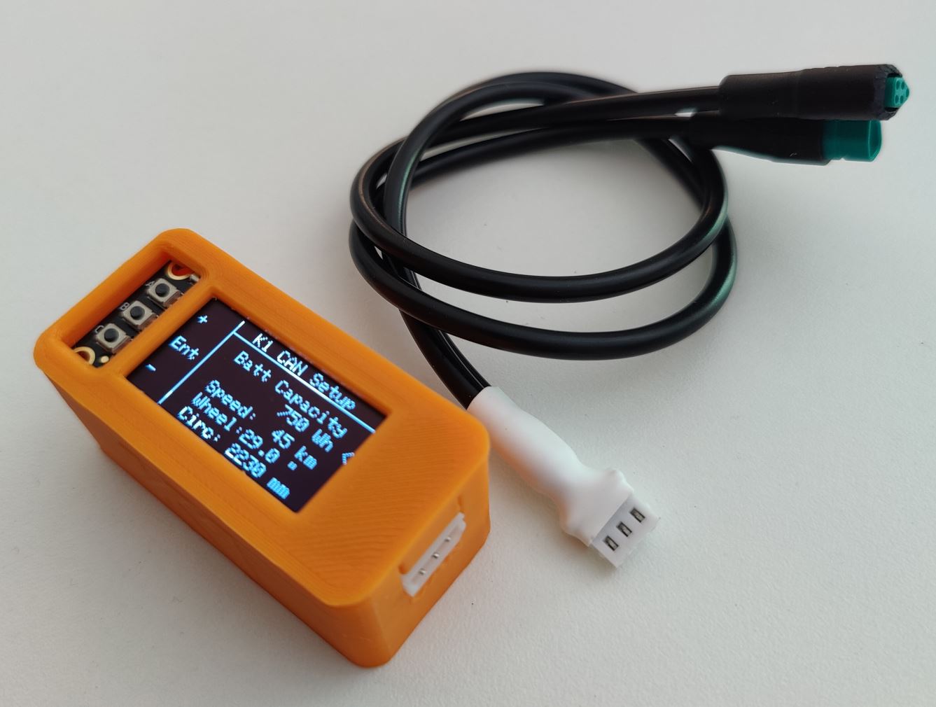

Hello ebikers.
K1 eBikes has designed small, portable and simple K1 CAN Monitor & Speed Unlocker - no need computer or mess with BESST. Works ONLY with Bafang motors with CAN bus (green connector to display with "house" shape 5 pin connector).
For more info check the following link:
https://endless-sphere.com/forums/viewtopic.php?f=31...
How to unlock speed:
https://youtu.be/6z3TzEqNWsQ
If you interested, send an email to [email protected], will answer any questions and will send user manual.
K1 CAN Monitor is determined for testing purpose only and is not waterproof.
