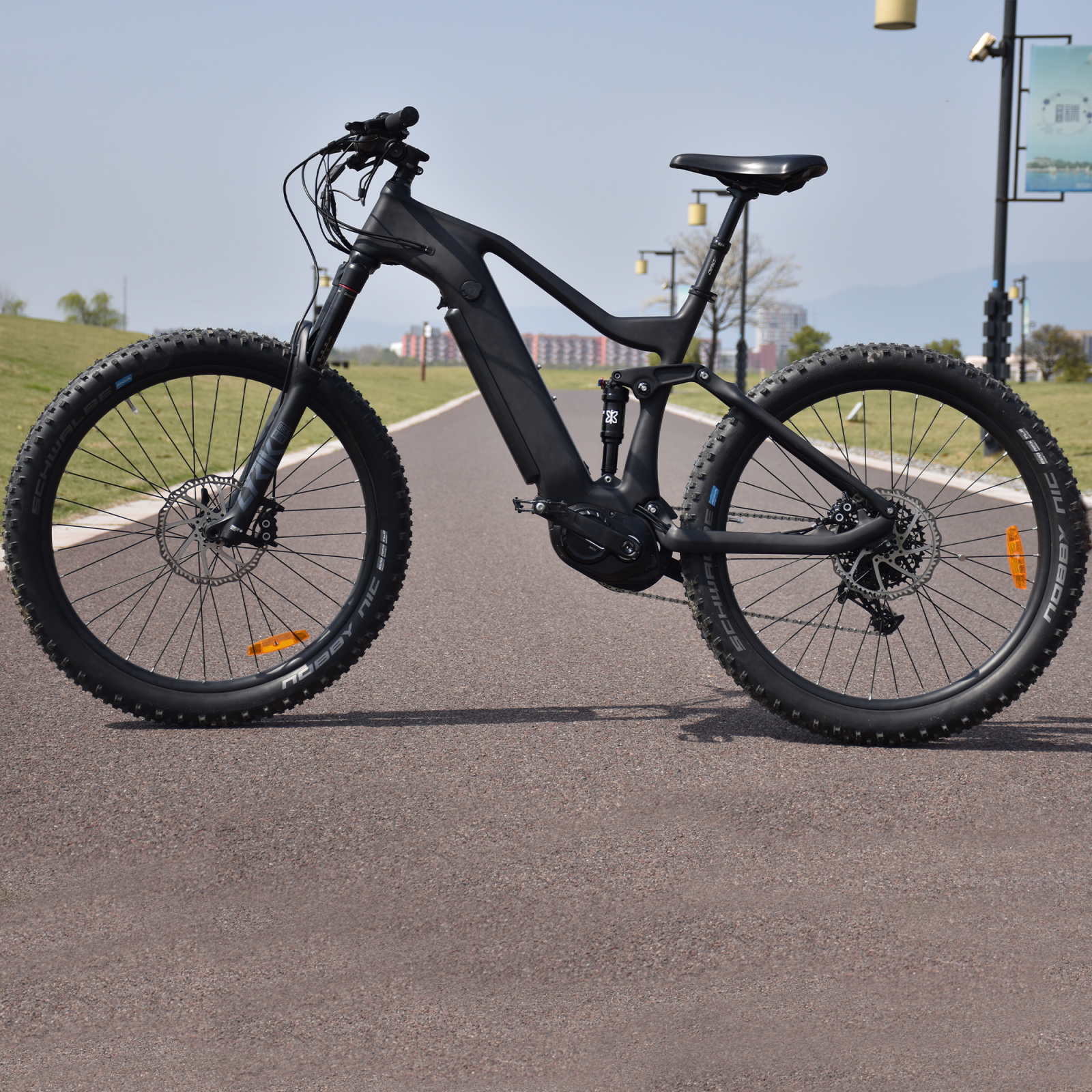

My CHEEB V2 will have it - looking forward to trying it out. Maybe it’ll match, or be stronger than then Bosch Gen 4!

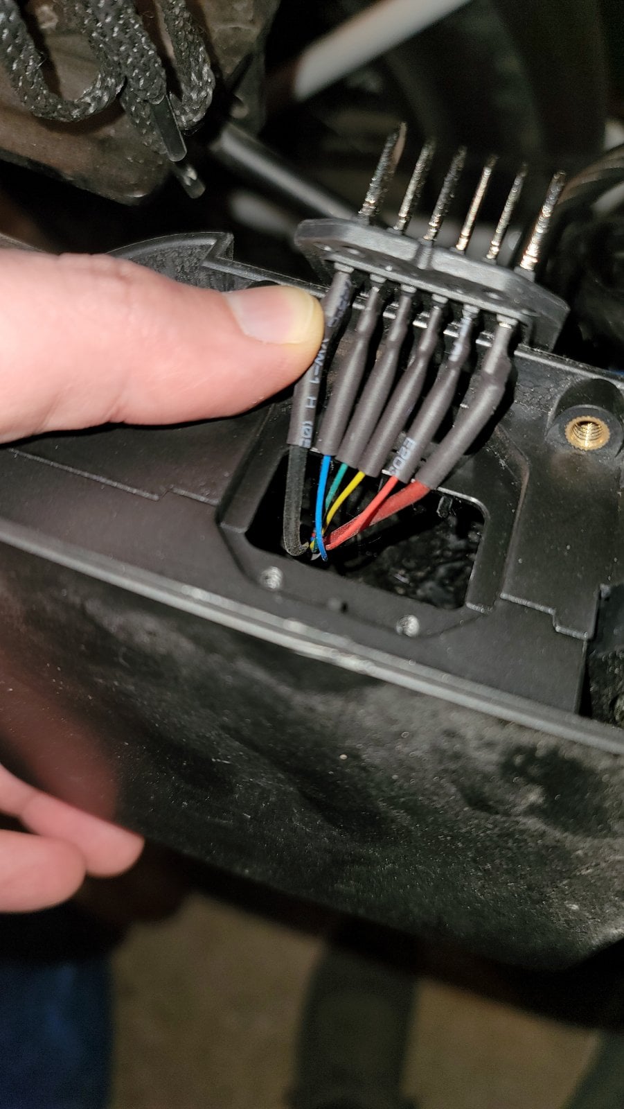

Question about battery connections!!
The ebike has a Bafag M300 Mid-motor.
I want to change my battery to another one that has more capacity. But the batteries that i found in the market have only two cabels (red and black) to connect the power. While my old battery has 4 extra cables in the middle (see photo).
Are they to turn on/off the back and front lights?
