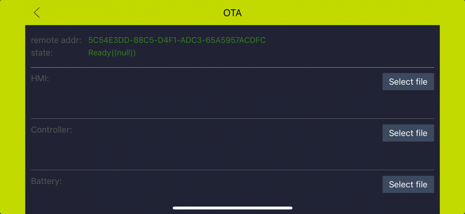

I still haven't got the BESST tool yet. I don't have a PC so it's a bit more of a challenge. I have been testing the Bafang Go app, and it appears to check for firmware updates online. It also has a Local option, but I don't know where it's looking for the files.
Any ideas? I've tried putting a USB memory stick into the display.
Kyokushin
Mar 28, 2021
332
195
Sol
Its not working both on iOS and Android.
on iOS you cannot pick a file. Android is one step forward - you can pick local file but there is no button to flash :)
