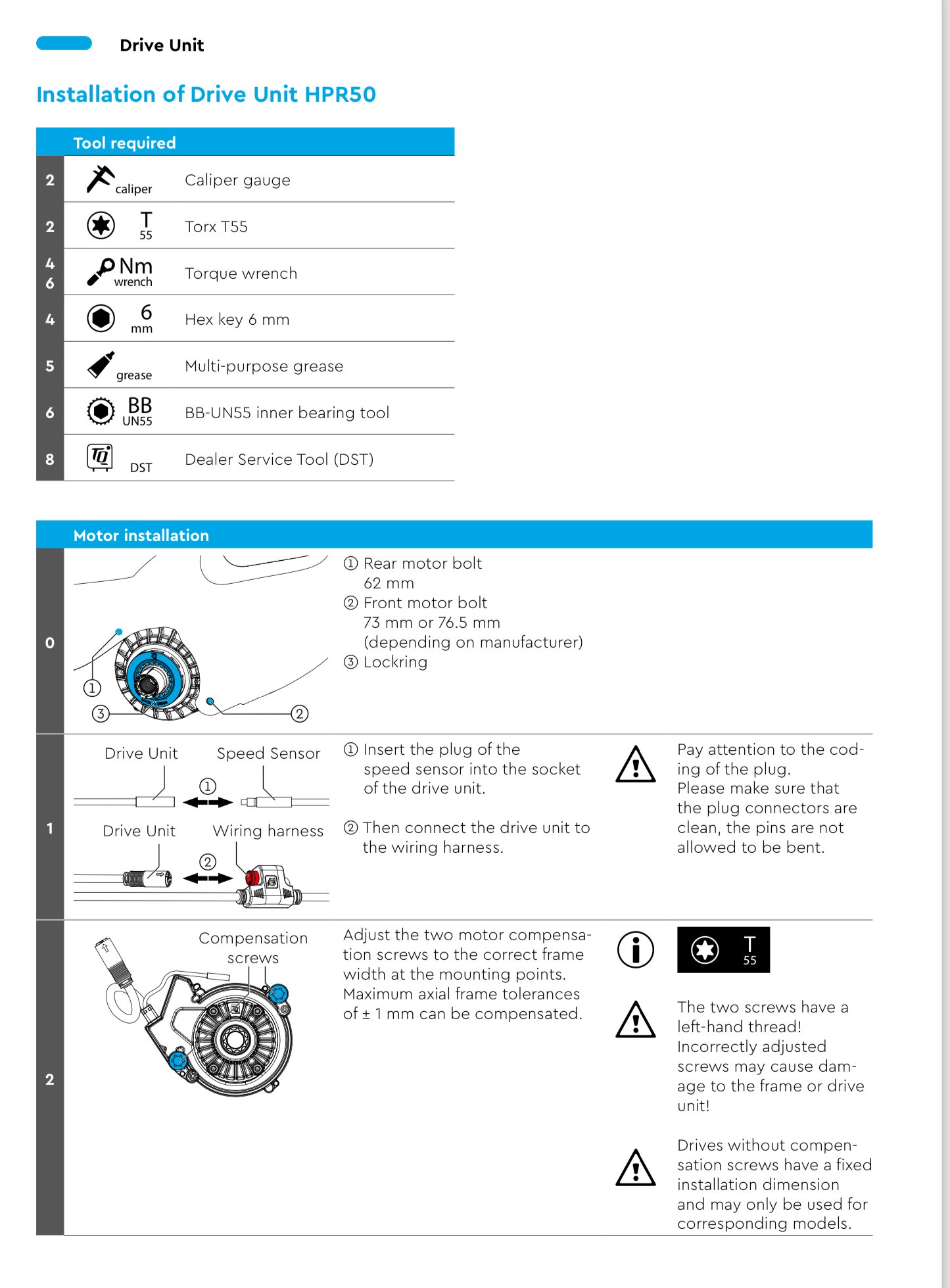

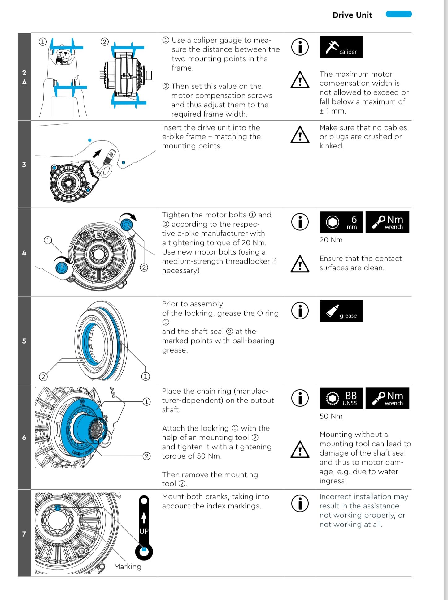

Now after 900km my TQ in the Lumen has a metallic ticking sound.
Not always, with the engine on or off.
Check the motor bolts , refer to the TQ service manual for more details
