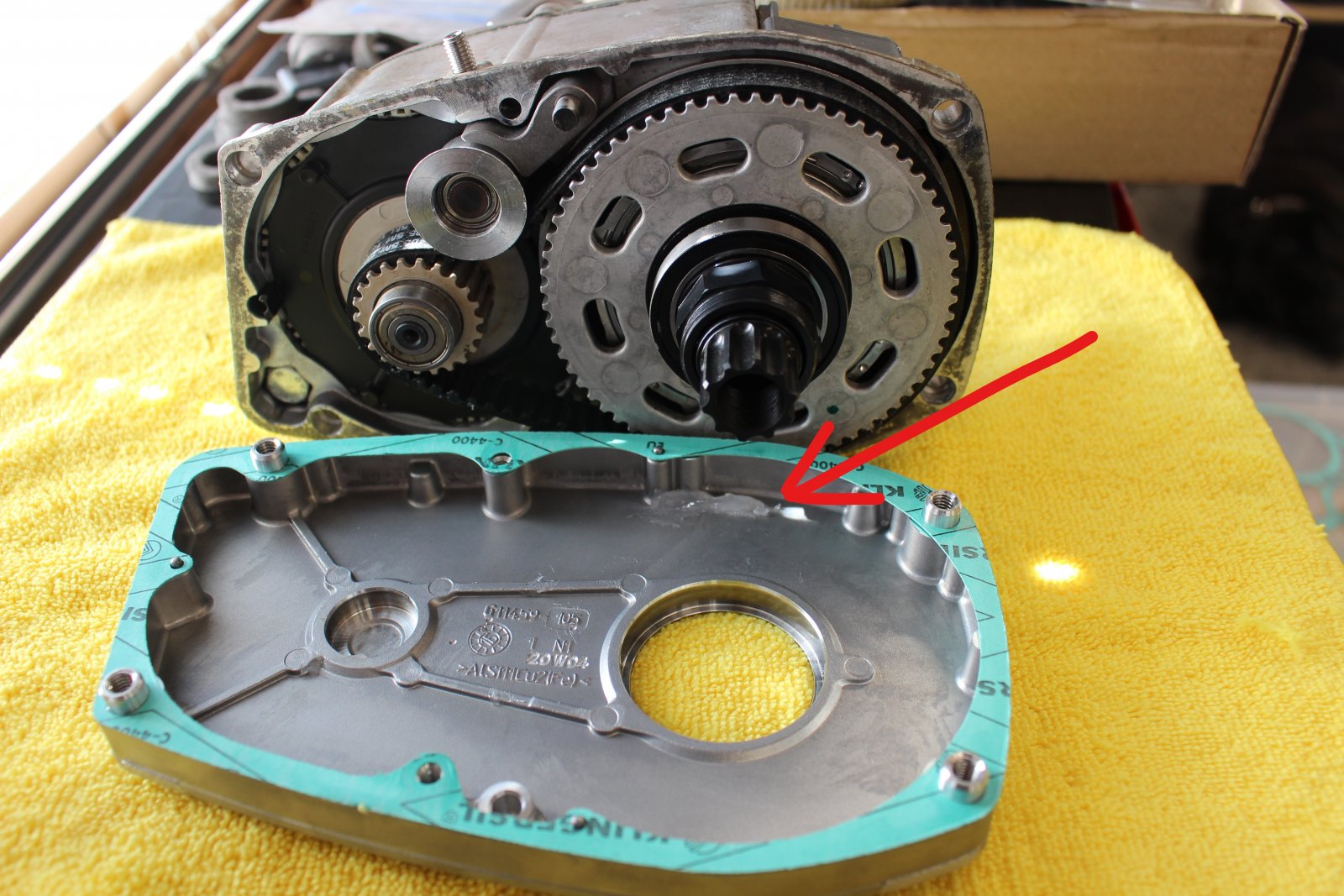

3, The grease found in the belt area is a type of Vaseline used to lubricate the belt when it is new. There is not enough grease in the planetary gears to actually leak anywhere?
This is not what I've found in the many of motors ive seen. (see pics) it's everywhere and the plastic dish is useless to stop it.

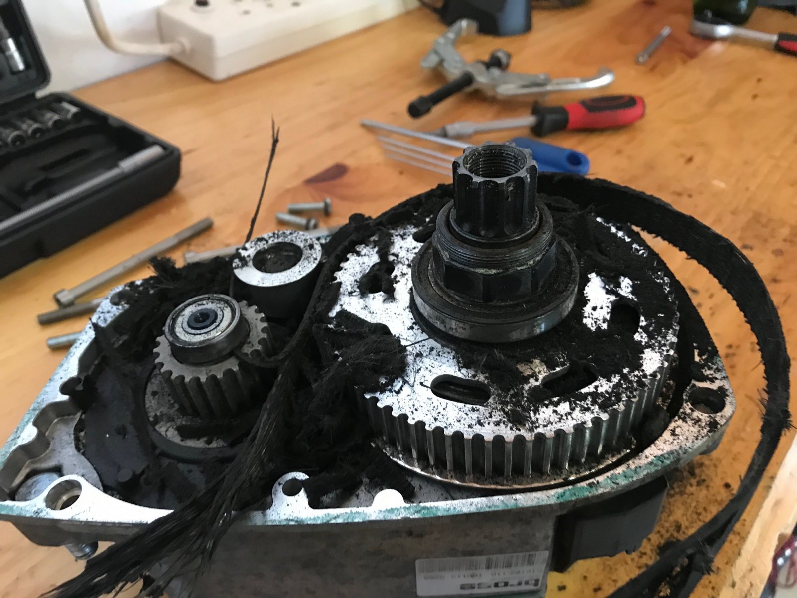

5, The drive belt itself is manufactured from continuous strands of carbon fibre and is virtually stretch resistant. Carbon fibre is not generally affected by hydrocarbon, silicone or lithium based greases or oils.
No its a standard Gates 5M belt you can buy anywhere its glass fiber, see pic

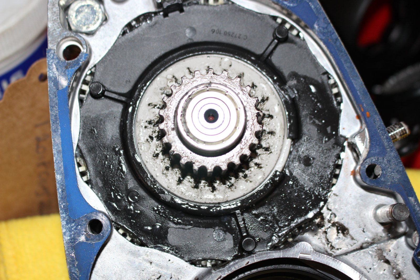

Sorry, I can’t find your pic of the grease? (open toed sandals in a workshop! ?) I have added two pictures, one from a new motor showing the clear Vaseline that has been removed by the belt tensioner and an older picture showing the same Vaseline after it has spread around and been contaminated by carbon dust from the belt.

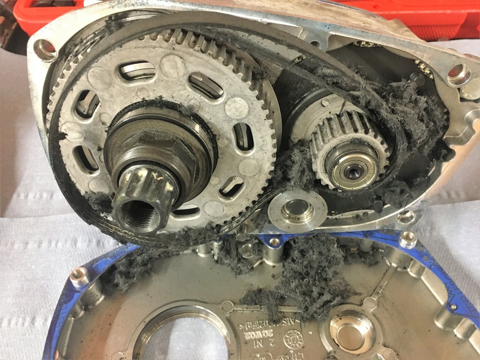

This is exactly what I thought a couple of years ago. I bought 40 Gates belts and was assured by the supplier that they were identical. I sold them world wide and over the next few months most had snapped or stripped! I have attached two photos below, 1 shows a fibre glass strand Gates belt (you can see the white strands in the belt. The other photo shows a genuine stripped belt, you can see the carbon strands and black dust. Gates finaly confesed (I have the email if you would like it) that the belts I had bought were not the ones they manufacture exclusively for Brose. NOTE: This belt has now been upgraded and caries the Brose name and part number now and not the Gates name.

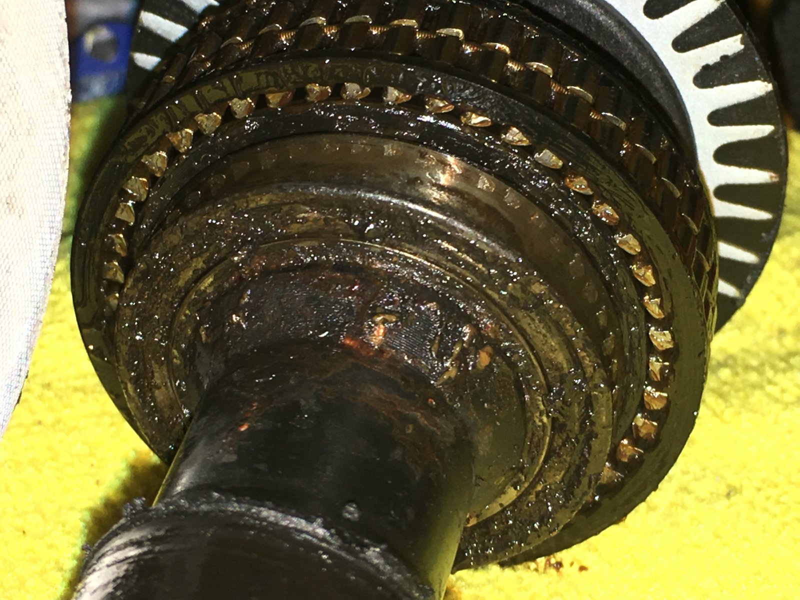

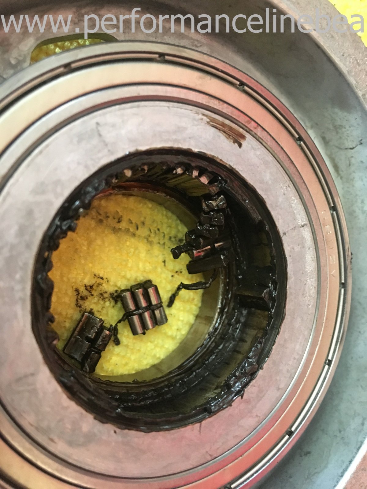

A sprag clutch bearing has many little cam like feet called sprags. These little sprags are housed between two components, in the case of the Brose motor one is housed between the crankshaft and the torque sensor and the other is housed between the torque sensor and the large drive belt pulley. This alows the drive pulley to disconect from the crank and vice versa. The housing of each component provide the inner and outer race for the bearing. The cams are also contained or held in a "cage" this keeps them all where they are supposed to be.
In image 2372 below, you can see the sprags and the "cage". When this bearing starts to fail the small spacers that hold the sprags in place begin to break-up and once one falls out the sprag has enough room to be able to flip over. This is all the cracking and popping people hear. Also, if a sprag gets jamed on its side you will hear a shill whine, like a stripped belt. Once a few of these sprags flip over its normally the end for the bearing and it can no longer keep everything tight enough to jam the crankshaft solid for propulsion.
Unfortunately, Specialized have no control over these bearings because the motor is made by Brose.
