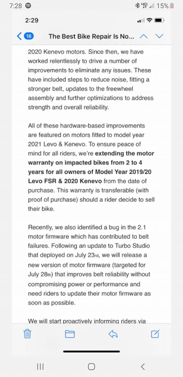

I am new here, I'm a first time Levo owner of 4 weeks and I already a blown motor - 160 miles.
Today, my local bike shop informed me that all 2019 and 2020 Levo and Kenevo bike worldwide are to be recalled, software updated and the warranty will be extend to 4 years from date of purchased.
You will be informed through you mission control app when you connect your bike and that you need to contact you local bike shop for an upgrade. I understand it's just software and not a motor upgrade.
I also found this on FB that I have posted around that confirms the LBS is correct. Certainly peace of mind!

My app telling me contact dealer re firmware update.

This message is supposed to be from Specialized
Official release Specialized Bicycle Components Italia S.r.l.
Milan, 29/07/2020
The best repair for a bicycle is not needing it: New Guarantee extension and Firmware update for all Levo FSR 2019/20 and Kenevo 2020 models.
For every cyclist, the best thing is not to need any intervention on their bike: this is our goal. If one of our bikes abandoned your riders, who counted on us, it doesn't fit so we'll fix things. Period.
Our job is to make bikes that offer cyclists absolutely the best in terms of performance and reliability. Specialized Turbo Levo and Turbo Kenevo have kept this promise with hundreds of thousands of cyclists along millions of km around the world. Innovation in Specialized will never stop. When we find a way to improve a bike, we do it as soon as possible. We constantly make dozens of small improvements to our bikes and apps, and this allows us to offer cyclists the best, often before it's available elsewhere.
Some time ago, we noticed a reduced but unacceptable number of technical failures, which affected some engines that equipped Levo 2019/20 and Kenevo 2020. beforehand.
Since that time, we have been working tirelessly on a series of improvements that eliminate any kind of problem. Among these were interventions to reduce noise, mount more resistant straps, modify free wheel assembly and introduce additional optimizations aimed at improving robustness and overall reliability.
All these improvements to components affected engines mounted on Levo and Kenevo's 2021 models. To ensure the serenity of all cyclists, we have extended from 2 to 4 years the warranty on the engines of Levo FSR 2019/2020 and Kenevo 2020. models. This guarantee starts from the purchase date, and is transferable (with the relative first purchase test) in case a cyclist decides to sell his bike.
Recently, we have also detected a baco in the firmware 2.1 of the engines of the models on indicated, possible due to problems affecting the transmission belt. Following an update to Turbo Studio, released on July 23, we will release a new version of the engine firmware (scheduled from July 28) that improves the reliability of the belt without compromising power or performance, so update will be required of engine firmware as soon as possible.
From July 31th we will activate through our social media channels to inform our riders about this new firmware, its benefits and the connected extension of warranty. Our goal is to avoid excessive crowding in stores, so we plan to send such communications to customers, initially through Mission Control and later by email. Don't hesitate to contact Rider Care for any clarification that may be necessary in the meantime.
Thank you for your constant support and dedication.
Mike Sinyard – Founder and CEO
2020. Specialized Bicycle Components Italia S.r.l
