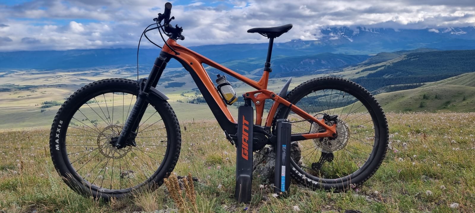

Hey, everybody!
I confirm after the update and three cycles of charging to 100% , there is no need to remove the battery anymore.
Whether this update solved the problem with overheating of the motor, I can not say for sure, my friend now on a Giant Reign in the Altai mountains, he had this problem, I do not know if he updated, there the connection is not very good, this place is remote from internet connection.

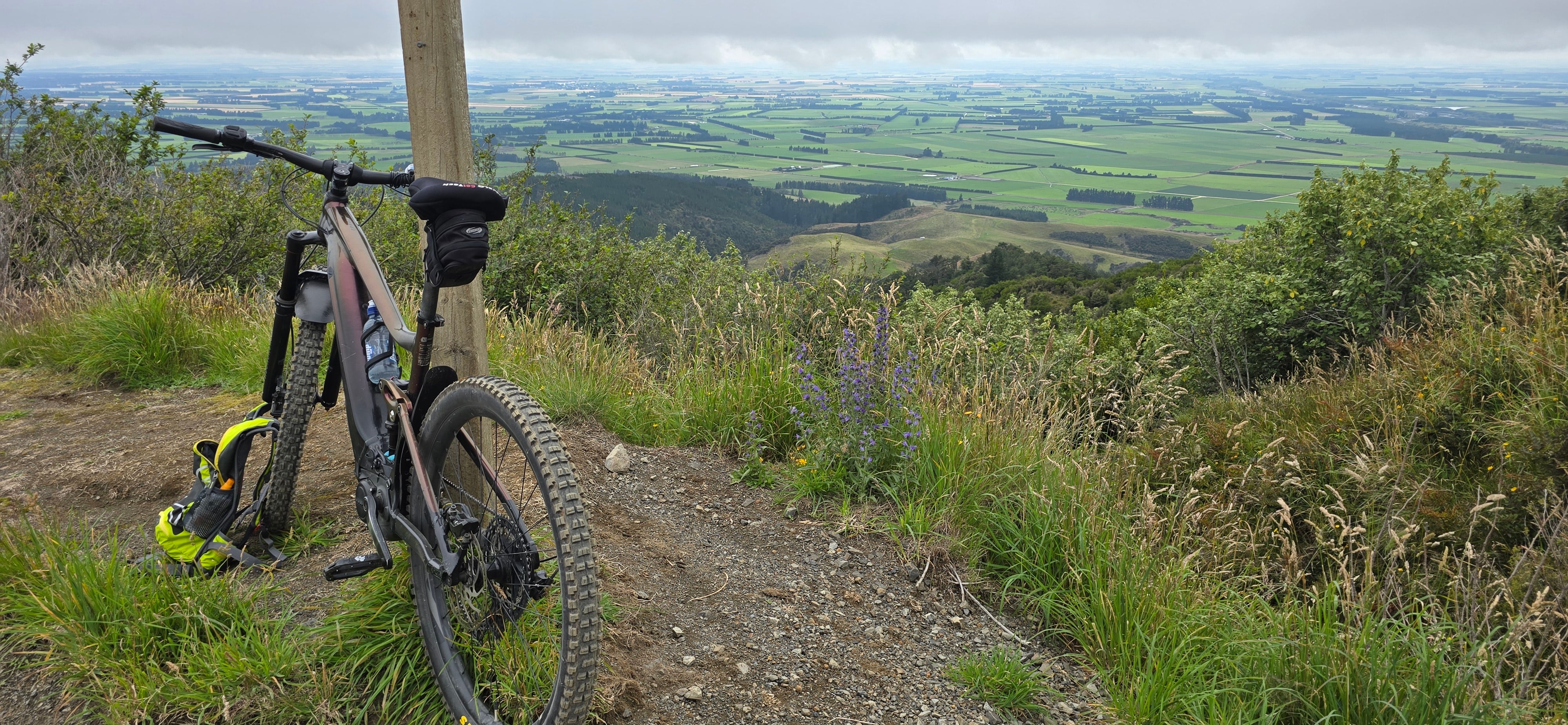

I bought a second hand 2021 Giant Trance X E Pro 3 that was the patrol bike here at our local mountain bike park. It has had a hard life over the 2500 km it's done. It had the auto switch off issue and after that I was normally not able to switch it on. The control LEDs would just flash on and off. Only way was to remove the battery, wait a bit and the put the battery back. Sometimes that would not even work.
The power button on the controls were very worn, so I replaced the MY21 controls with a new one. The Ride Control App updated it on the first connection after that. After this I took the motor with all the wiring out the bike. The pins on the bike's discharge connector had a bit of wear, so I put spacers in under the connector to space the connector about 1 mm deeper into the battery. I cleaned all connectors in the wiring and the battery thoroughly before re-assembling (I am an electronics engineer with experience in military missile development) with small cable-ties holding each of the connectors together. Everything seemed to work ok thru numerous tests. After fitting everything back in the bike it ran fine for 6kms but cut out when I crossed over a railway line on my first ride after this. I could switch it on and it has not done that again. Even after 20 kms of rough terrain. However that once off did not give me full confidence that it is fixed. I had the bike cut out on me resulting in a hard 42km ride back with no assist before I did all this work.
Interesting thing tho is my battery firmware does not relate to anything I have seen on the internet. My 625wh battery firmware comes up as 0B001400 on the Ride control app with the hardware as 2019-something. Battery condition is 92% with 93 full charges. Taking the bike in on Friday to have the firmware updated and waiting for an 800wh battery from overseas.

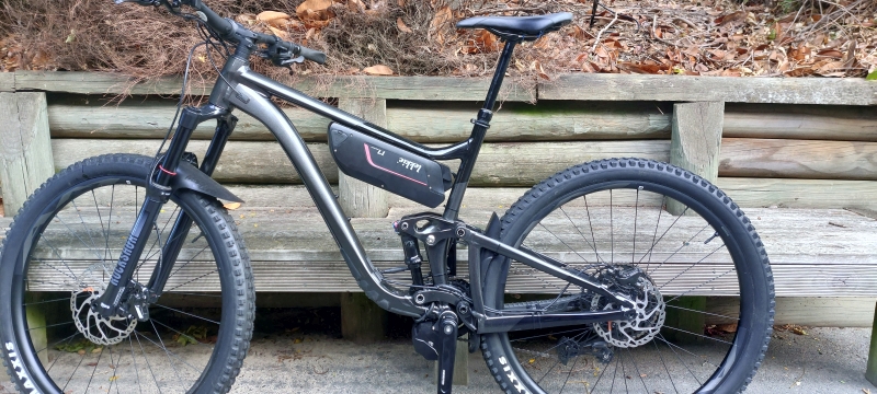

As a side note, I also have a 2023 Giant Trance X analogue bike that I put a CYC Photon motor and a 540wh battery on. This is a good 6kgs lighter than my 2021 model. The ride is quite different (more analogue) but I like both, each has pros and cons.

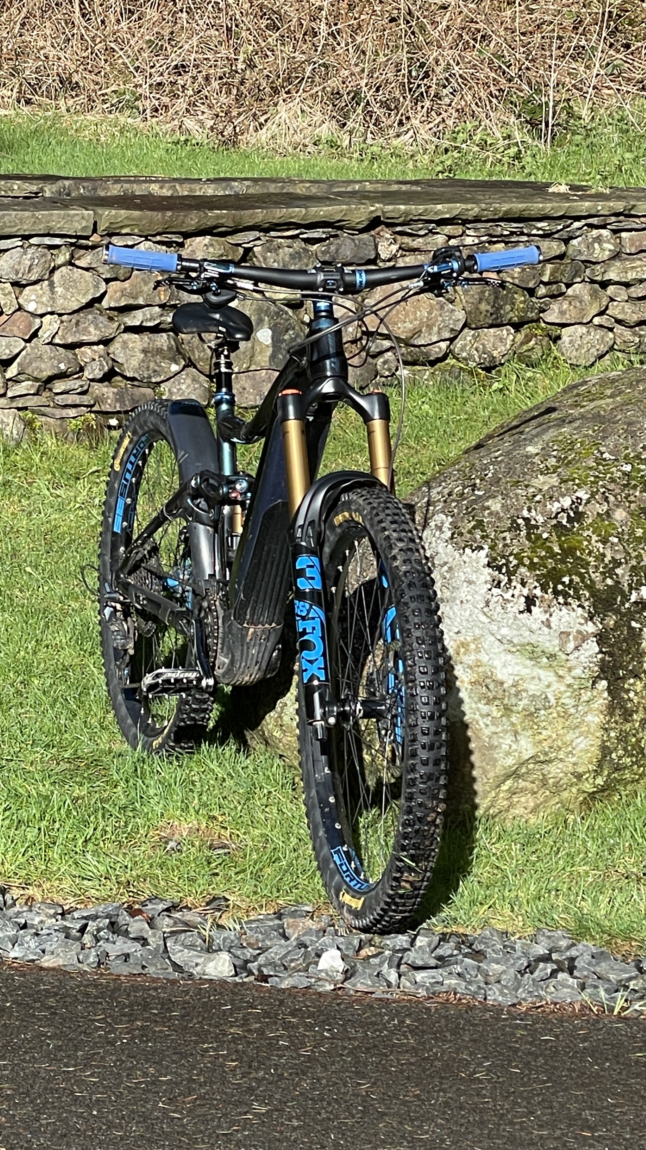

Just thought i would pop a fresh status update on here:
Bike is still ridden every weekend and still to date has never failed since that battery firmware update.
My pal Phils is the same and he rides more then me.
Thats 3 full years of trouble free riding in all conditions.
(Including snow)
Shes even had some upgrades like the MY24 Fox 38 and X2 to cushion my often very poor landings at bike park wales and Glentress! LOL
There is not a shadow of doubt that the GIANT / Panasonic battery firmware caused me that 2 years of trouble and money.

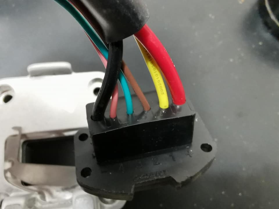

I certainly hope your problems are battery firmware related and these can be resolved. I replay my story of a similar issue from Sep 2022:
My tale of woe which I hope is now over. Back in late July I was riding up the Colonial Knob summit track when at the 9km point I experienced the dreaded sudden off! The RideControl switched itself off, no fault lights, so I removed the battery and refitted it numerous times, no improvement, no fault code lights, the RideControl would not switch on again, so a slow ride home. I took the bike into Giant Wellington.
They replaced the RideControl under warranty. It took about 2 weeks for parts to arrive in country and fit. After collecting the bike, I was prepping it for its first ride in the garage on the workstand and with it switched on, another sudden off - again no lights, no fault codes. Battery removed and refitted, no improvement. I replaced the battery with a new 800Wh battery that I had just purchased and not yet tried, initially no improvement, then following further battery removal/refits normal operation resumed. A couple of short 5km rides with the 500Wh and 800Wh carried locally without fault.
Next day - Another attempt to ride from home around my Colonial Knob loop, at the 11km point RideControl yet again switched itself off, same, same. I continually tried to switch it back on whilst slowly riding home. Normal ops resumed on the downhill return at the 13km point so I carried on. For the remainder of the ride (17km) including 2 x 250m climbs on Porirua Tip Track and Old Coach Road Track it all operated OK.
Different batteries made no difference so it didn't look like that, RideControl replaced so it wasn't that, I took off the lower cover and pulled apart all the connectors, dry, clean, and no corrosion so not that.
Another ride on the flat the following day - at the 6km point RideControl yet again switched itself off. This was on pavement, no hills, no load to speak of. Very frustrating! More frustrating though was on the return at 12km point I tried the RideControl again and found is was working OK. Not for long though at 13km it switched itself off and would not switch on again. Bike returned to Giant Wellington.
Another long wait, but the guys there are great and extremely thorough. This time they discovered that the Motor to Battery Cable had a fault, another couple of weeks wait for a replacement part and fit. Specifically the fault appears to be in the back of the battery connector where the wires enter the battery terminal fitting, it appears that it is not uncommon for moisture to penetrate this area and corrosion to form. They had another bike with a similar problem in the shop and it was fizzing in this area. It looked like the back of the connector where the wires entered had been dumped in salt water.
So 3 good track rides now, two big climbs and one flat without issue. I'm keeping my fingers crossed.

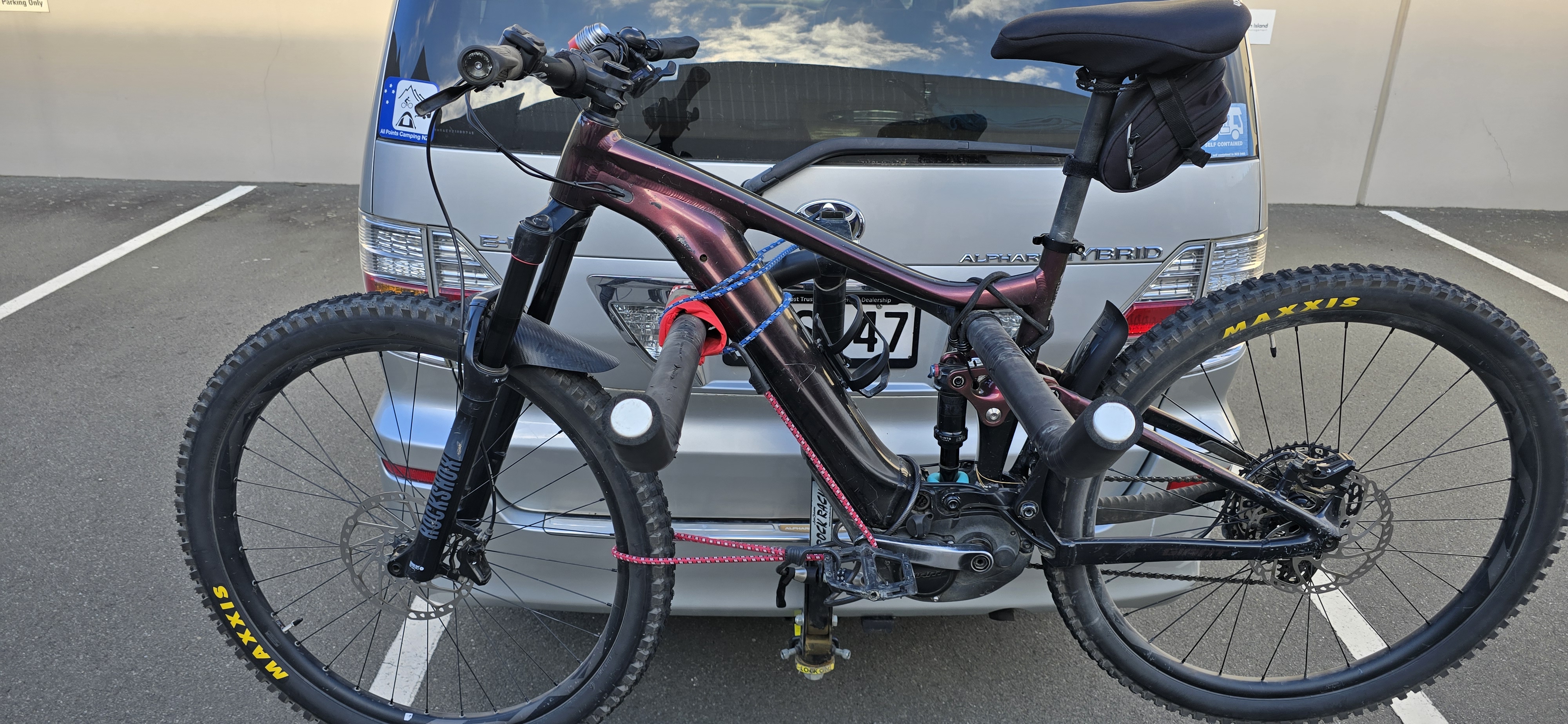

Well firmware update did not fix it. It had a good test at Mt Hutt bike park. Went up 365 meters in 5.8 kms in 40 minutes no issue on assist level 1 and 2. It was steep. However at the top I switched it off while I was having a breather and a bite and it would not switch on again. Frustratingly it refused to switch on for the rest of my time at Mt Hutt. On my way back home I tried again and it switched on.
Back home it behaved and switched on everytime. I swapped the 625wh battery for the new 800wh one I had just got. All looked well and i went for a ride, pretty level stuff. After 5kms it switched off by itself again, on assist level 1. After that it would switch on for a minute or so and then switch off. Tried it a number of times and now it would not switch on at all. Lights flash quick and faint but no switch on. Back to the shop it seems.
