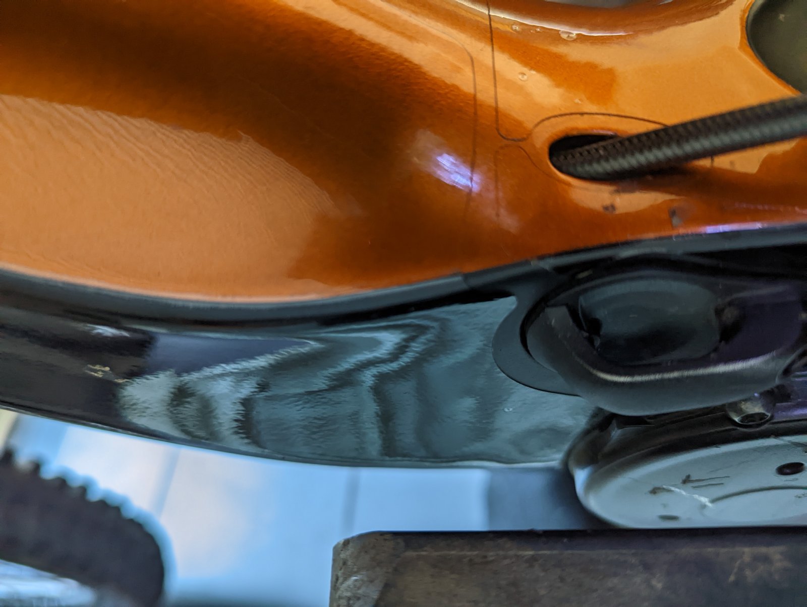

It's still not confirmed it's anything but paint damage
Taken to shop today and it's fucked.
100 percent cracked.
You could run your fingernail easily in one direction and it would catch in the other proving there is a step /height difference.
LBS agrees and has started the warranty process.
As much as I absolutely live this bike I have purchased a Norco range vlt c1 as I have no longer have faith in the design.
Kinda blows the old aluminum doesn't fail theory out the window. Just tapping this area with your finger you can hear how thin it is.
I will bit keep this bike whatever way it goes.
Sorry guys to be the bearer if bad news but this looks like a shit storm for giant!

Also further to other comments this may bike has had exclusive black diamond park laps hence why it's clearly the worst looking of all pics.

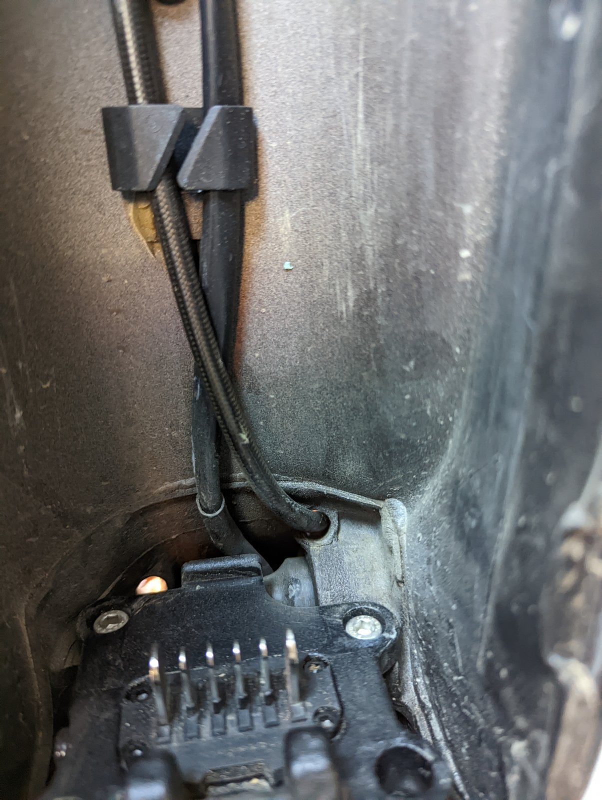

Interesting why some have and some don't. Mine looks fine and likely do more bike parks on it than anyone and a big amount of miles. Spoke to a bike shop yesterday who has sold over 40 of them, not had any report this yet. Maybe a bad batch? What country and when did people who have seen this buy their bike?

Would you mind taking a pic of your bike in that area?

See below

Yeah, no damage at all. I go dyfi bike park twice a month on double and triple black diamond tracks. Plus other parks in between and then my local 3-4 times a week. So far it's fine. Im 6"2 and weigh 95 kilos kitted up so it gets plenty of stress 🤣

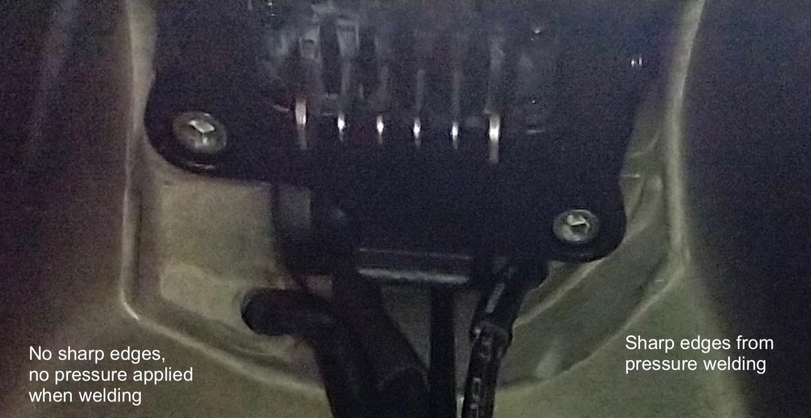

If I compare the inside picture @Kevjob51 who has a smaller crack to @Endorium without crack and mine it looks like the two latter ones have clear signs high pressure being applied to the welding seam to weld the frame pieces together. On the other hand @Kevjob51 pressure welding seam does seem to lack the pressure dent at least on the cracked side of the frame.

Here in the picture a short explanation of what I meant above when saying that other side on @Kevjob51`s bike may not be welded too well…
