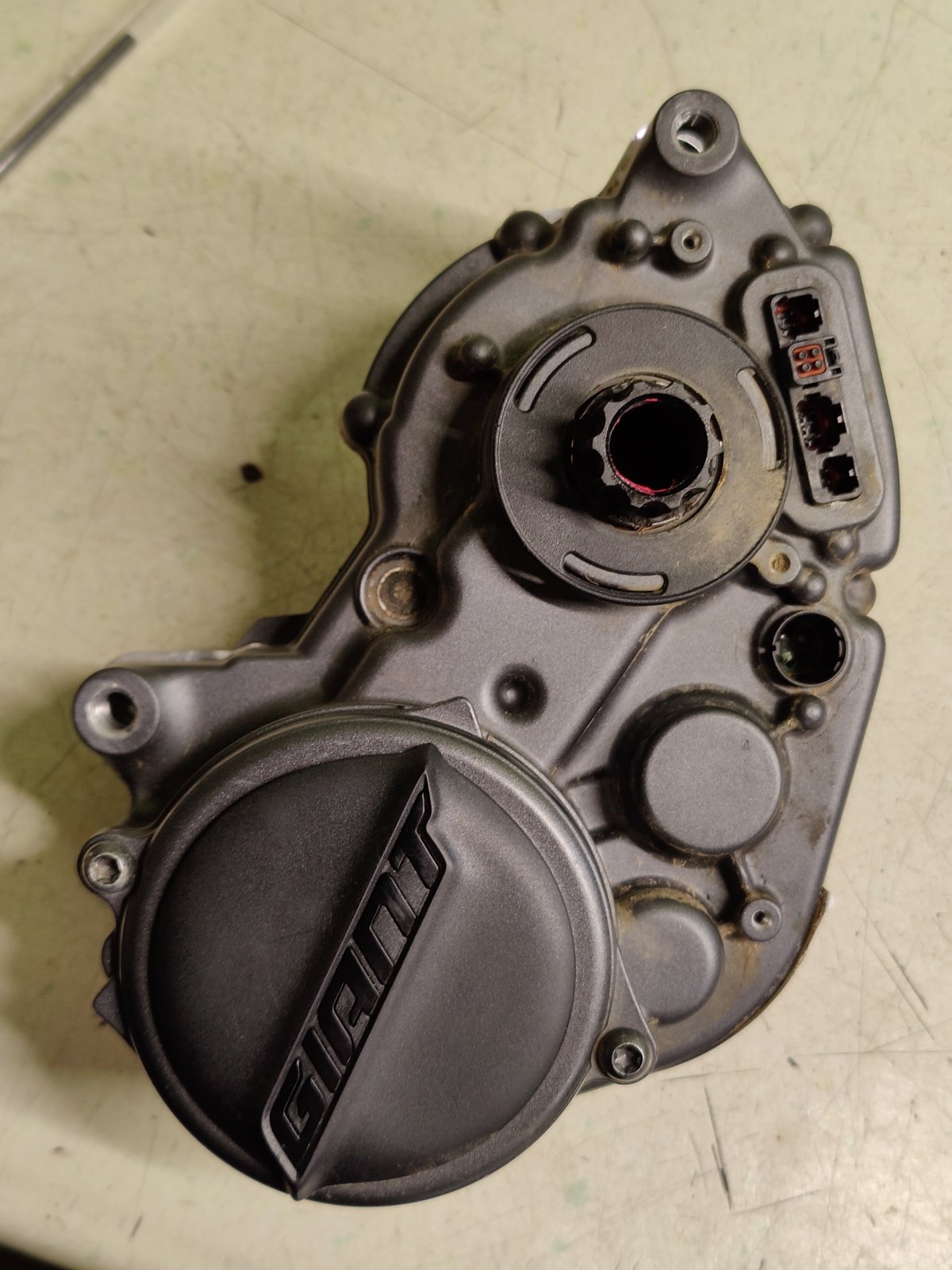

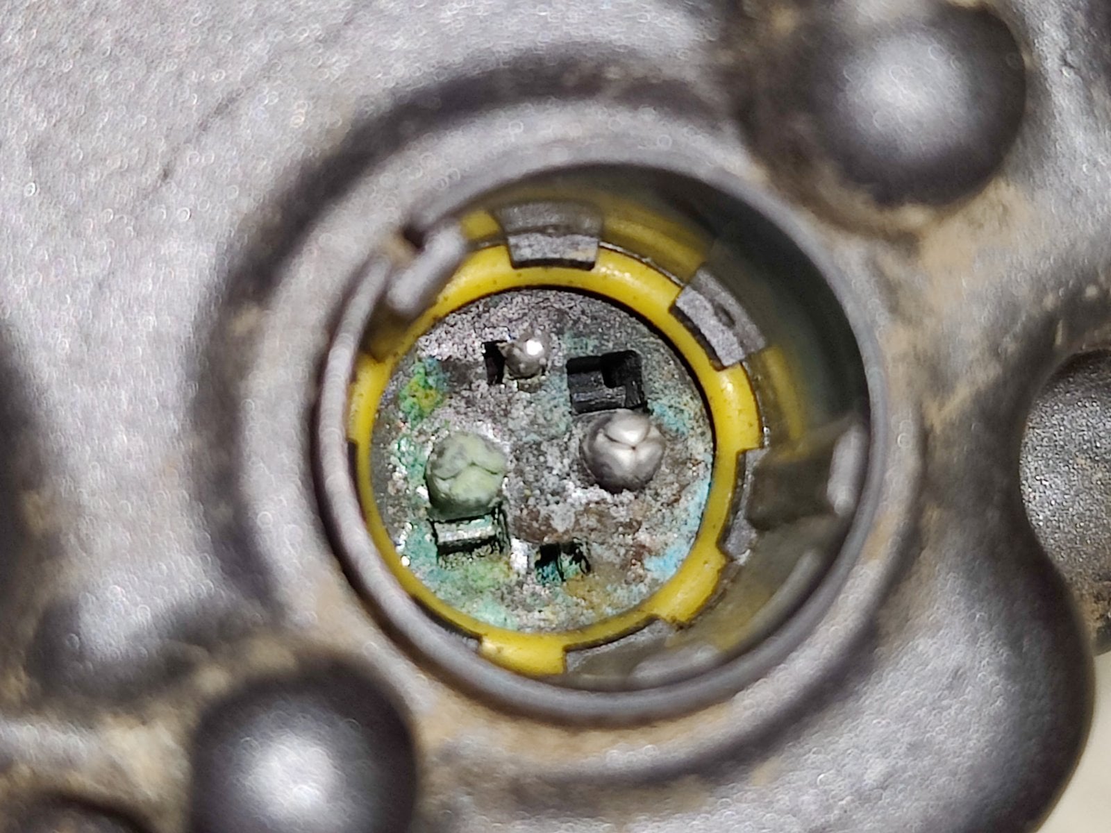

Very few.
Not been jetwashed either.
Not sure yet if the connector O-ring has allowed it in, if has got in via the wire grommets, if it's capillaried in through the wire itself from an outside connector or if it's got into the motor through a bearing or the vent and just corroded the power connector because it's at the bottom of the motor.
Trouble is, they won't allow us to pull it apart to find out, and their solution is to "clean the contact and return the bike to the customer", which is going to work for what, a week at best.
This isn't just a Yamaha/Giant issue, all motors have water ingress issues.
I'm working on a solution for all compatible motors, maybe to offer a conversion kit in time.
I Can't divulge too much information because I might patent the idea yet. It's not actually a new idea, it's a new application of an old idea.

Hmmm it looks like perhaps the motor was underwater for a bit… do you ride through creeks or water at all ?
It just rain here, a lot. The dirt is mostly abrasive too so everything gets killed.
Bike and motor manufacturers should come here to test and develop stuff, not California and the Algarve. Shimano came here once because they couldn't believe the wear rates on mechanical stuff, and their visit directly led to them making changes to improve durability.

Is there any grease application needed for a new bike to help keep the water out? Or not effective…
John Cap
Jan 29, 2022
28
41
Greece
perhaps a good practice would be to add some touches of dielectric grease on contacts, connectors, etc on these bikes, before getting them out
Rickster
Feb 19, 2022
369
538
Ok BC Canada
Absolutely not, dielectric grease is an insulator.
Err maybe there’s a lot more to it then that…
“Contrary toInternet rumors, advertisements, and articles low viscosity silicone dielectric grease will NOT insulate pressure connections. Silicone dielectric grease will prolong connection life as well as, and have just as good conduction performance, as a properly selected metallic powder grease (conductive grease). On the other hand, and improperly selected "conductive" grease can actually cause connection problems.”
Complete article, Dielectric Grease vs Conductive Grease
cappuccino34
Nov 24, 2020
530
331
Helmshore
You use it if you want to.
You're not allowed to use it in aircraft, is what I know, because they crash and people die when things don't work properly.
I'll take aircraft engineers over turntable engineers. :)
Evolution Stu
Jun 30, 2019
463
457
Blackpool. U.K.
You're not allowed to use it in aircraft.
Add motorsport engineeers to that. We wont go near the stuff on low voltage connectors as a rule.
We use it in super high voltage shunts where we need to stop it tracking though, which, incidentally, is what the stuff was originally developed for.
A solution was needed to stop HT volage tracking down plug leads when engine blocks got wet and this stuff came about from that. I recall Lucas OIls were one of the first to come up with this easy to fit solution that allowed you to coat the lower innards of the spark plug boots and solve the issue. It eventually became known as "Tune Up grease" in the industry as we painted it onto HT lead innards during a tune up.
Anyway...
Dielectric grease is absolutely an insulator / waterproofer but it should certainly be noted that it can still work in good electrical contacts because the spring pressure from the contact wiper drives it out upon connection, so essentially removes your error for you. The contact patch should remain grease free and still work as lots of E-Bike owers will have proven.
Try it again in a few years time when the connectors have lost their tension though and see how the connection fares with a dielectric material between the contact points.
If you want to use a quality electrical grease, I personally first clean with Electrolube CGS (Strips) and then lubricate with Electrolube CG70. You wont find better.
