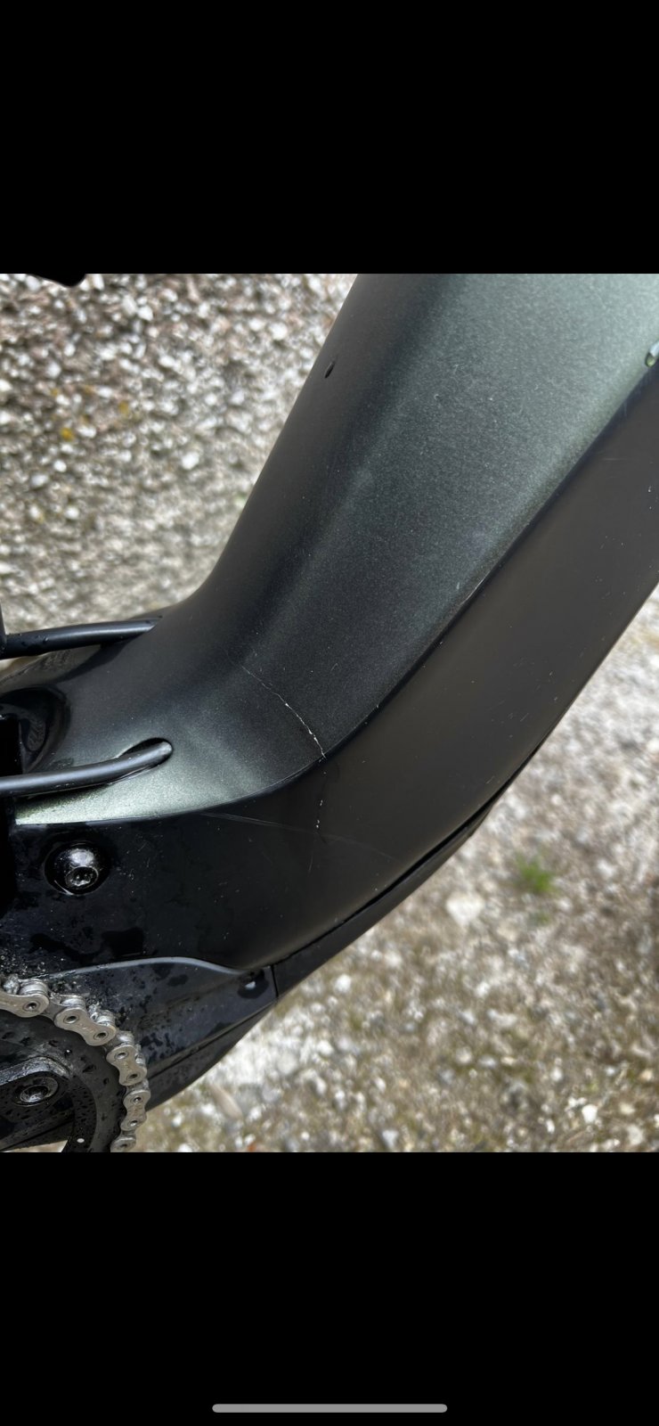

So it is still welded, but they have ground it flat?
What about the plate welded on underneath? Is that instead of leaving the weld proud?
The plate underneath has been welded on to hold the battery connection plate....and the weight of the battery.
I have no idea how these smooth tube connections are being done. It looks like a fillet brazed joint but as far I know you cannot braze aluminium but that is how smooth tube joints are created on steel bike frames. The frames must be robot "welded" or whatever jointing process it is, on a production line, so I cannot see the production line doing any grinding down of TIG welds. More to the point, to do so merely weakens the weld.
There is a process called fusion welding which I believe can achieve a flat "weld". It basically consists of melting each face to be jointed and then pressing them together under pressure. Whether a version of that is being used I have no idea!! Whatever the process is, it seems to be failing. Someone mentioned the junction of the down tube and the part of the frame carrying the motor housing is not under a lot of stress! Wrong.........the BB area of a frame has to resist the twisting force of the cranks.
Yup. I don’t know if it’s a weld, a bend, or anything else. But it looks exactly like a fracture. And even if it’s only the paint, then the distortion of the metal in that small region would be substantial, suggesting a susceptibility to early fatigue.
Until Giant addresses what appears to be a pattern of failures, I’d steer away from purchasing this bike. And if I had a bike that had that crack, I’d be wary of riding it on anything rugged.

All the pictures including the one a bove suggest that the down tube is welded at the site of the cracks to the frame section that carries the motor housing. Giant appear to have done an "Orbea" on the 2022 models with that weld (flattened the weld...which in my opinion weakens it). I far prefer the very visible weld in the picture of the red Reign above..........you can determine the quality of the weld. So I would guess that joint between the down tube and motor housing frame section is starting to fail. The crack is caused by movement on that joint. It may be superficial to start with but likely to get worse.
"done an Orbea" should be the new normal :)
But Orbea doesnt "flattened" the weld in that place, only in the top tube and in the seat post. I wonder why...

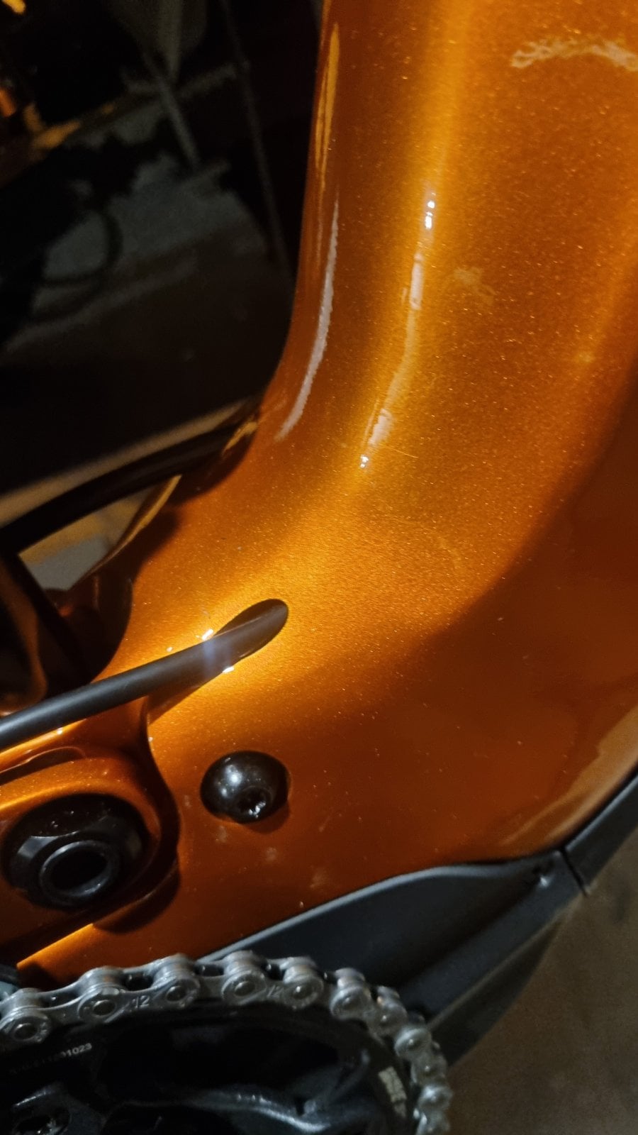

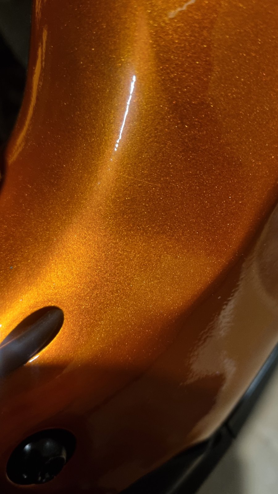

Hi eberyone,
I attach a Pic of my wife's brand spanking new trance 2022 with paint cracking in the area.
This is as of yet unridden.
Also my personal reign which has taken 645 hours of bike park abuse and is on its second wheelset and never been washed also showing this marking with no issues so far as noise etc.
When I first posted some pics after my second or third ride in this forum relating to the my coil spring conversion.
Tomorow my shock someone has commented on that 645hr old photo and pointed out the crack.
For sure there is something that could be done but I'll be without a bike so will conduct a minor investigation
I'm not worried at this stage that it's serious though

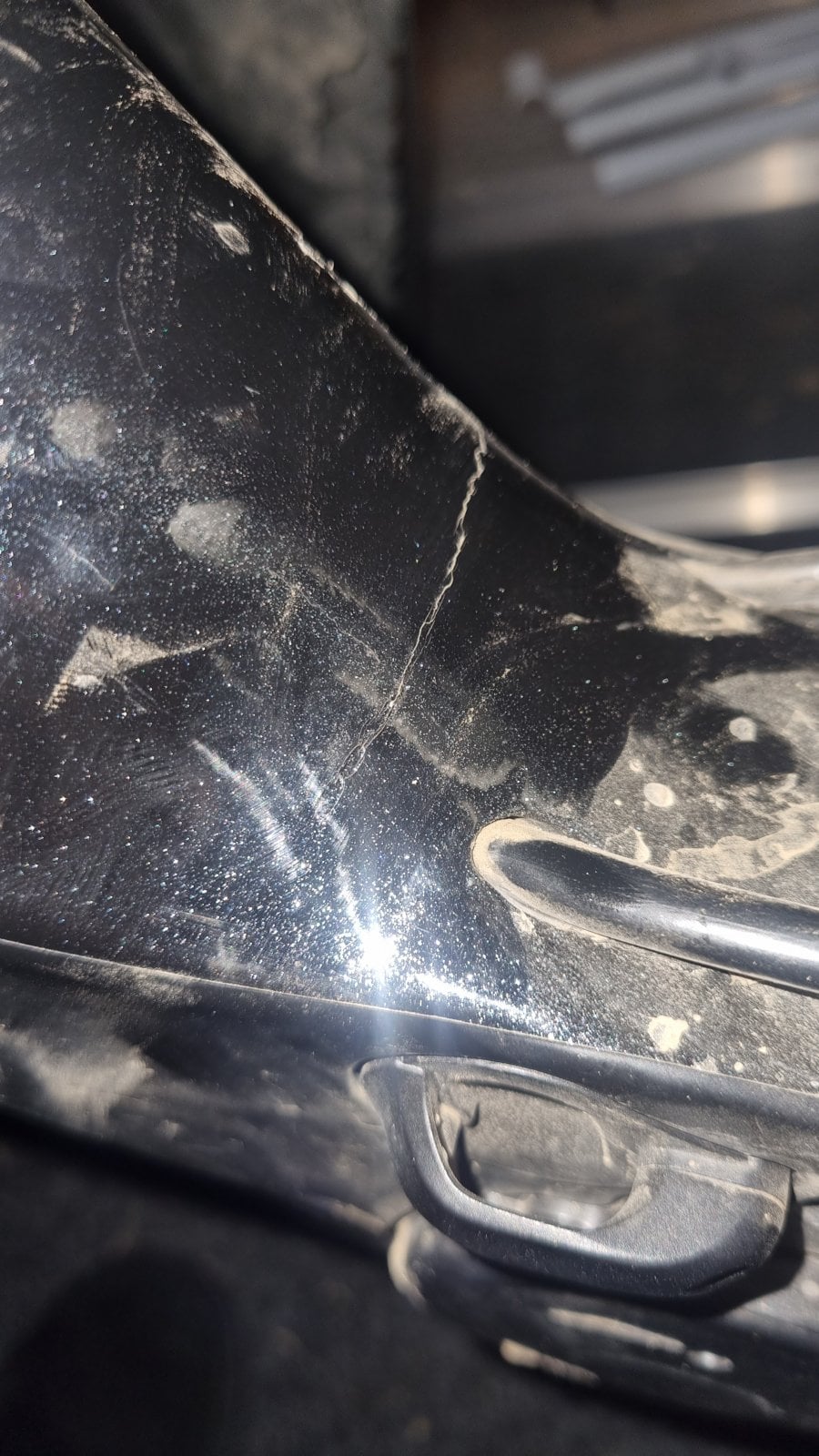

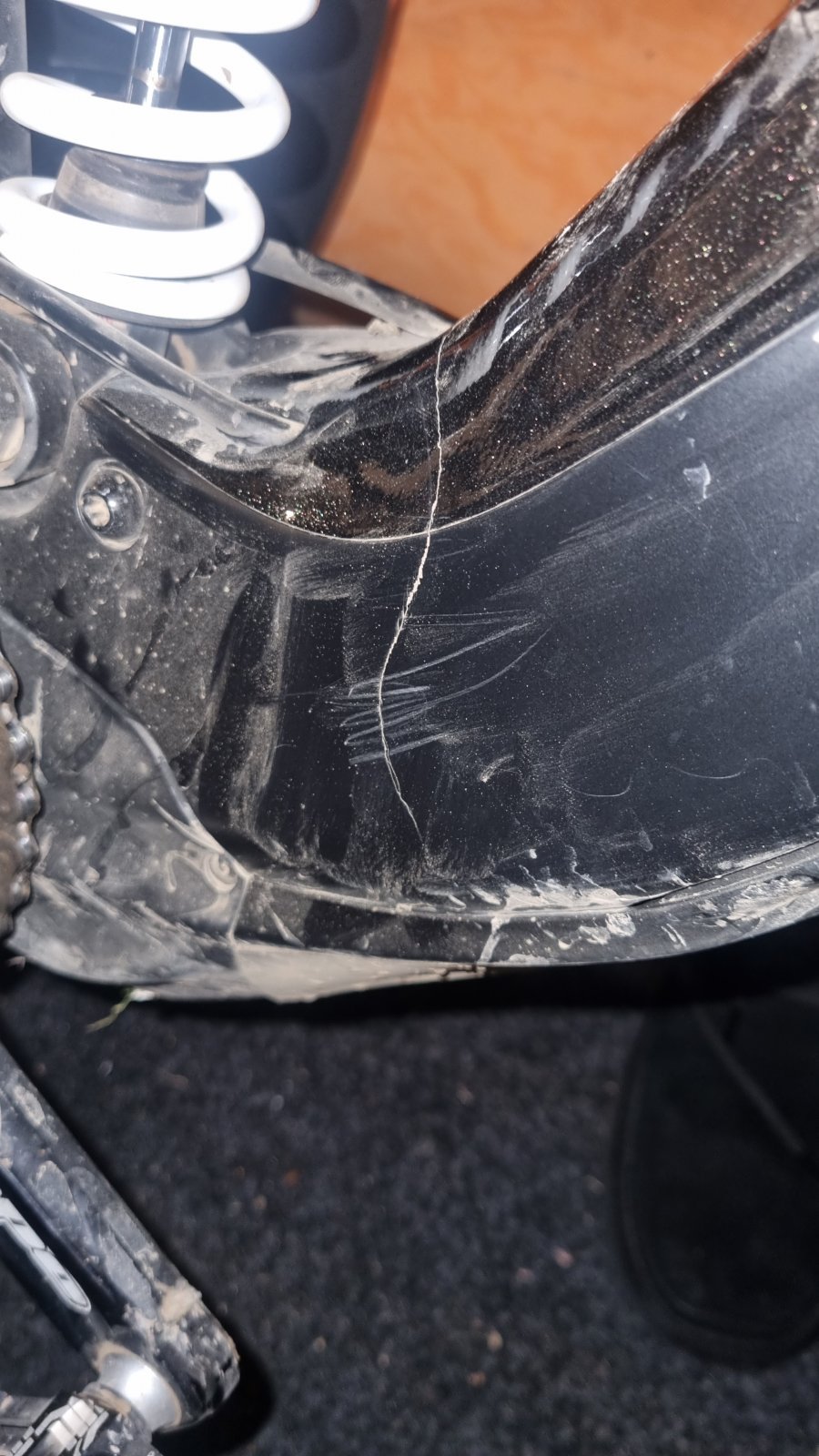

Holy hell that crack is HUGE. I would not be riding that bike anymore, decent 4-6 foot drop and I'd say you may end up with some alloy somewhere you don't want it.
This is getting very concerning re: Giant cracking, if you look closely at all the pics they look to start from the middle of the downtube and all crack towards the drive side.

Thats 4 different coloured bikes including 2 different models that all have "paint cracks" in the same place. I know you want to give giant the benefit of the doubt here but there is no way all the pics on this post are just "paint cracks".

What coil are you running now? Same one or different, the spring looks white in that pic.

Hi guys.
H
View attachment 88606 Has anyone come across this on the new 2022 giant reign with the frame cracking? This would be near the bottom of the down tube near the two small holes for the gear and brake cables?
Any info would be great.
This is my mates bike only 5 months old andI checked mine today and I have the start of a crack also in the same place!!!
So what did Giant say?

We see on other frames that area has a weld on it. So at some time in the stress modelling, theres been an indication of movement which was addressed by having a welded join.
So if its flexing at least and not stiff, something is eventually going to give.
Sure maybe not, might be within acceptable movement parameters, but usually when materials flex, that is the area of weakness and more often than not a point of failure

I can confirm that the suspected crack in the frame I mentioned above has been deemed a crack in the weld & the owner has a loaner frame from Giant until the new one arrives.
