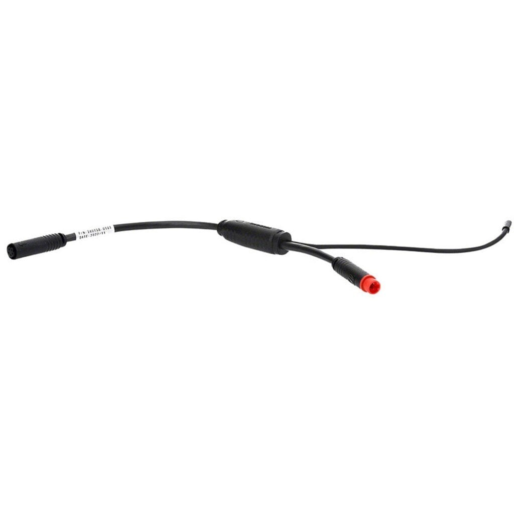

There are no connectors for lights on the motor. TQ offers a smartbox which needs to be mounted near the display inside the top tube. The smartbox goes between the main motor harness and the display. It then provides a number of short cables and two of those can be used for lights.
The smartbox will cost about 110€. You’ll need one or two short cables with the special connector TQ uses on the smartbox cable ends. These are offered by Lupine or Supernova for 20€ each. After mounting the box and cables inside the frame you need to see a TQ dealer and have him activate the two light connectors, probably for another 20€.

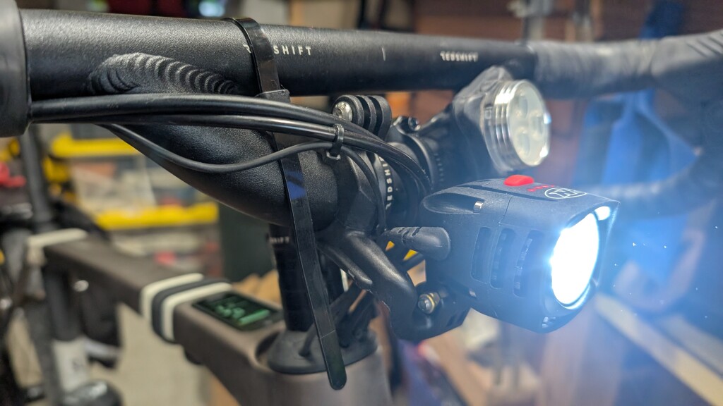

For night rides I use a stem mount light , a helmet mount light and a seat post mounted red taillight. These are all chargeable with a mini-usb and can be easily removed when not needed. I don’t rely on internal wiring or the bike battery.
Some helmets now have red taillights.

1. Check eBay and see if you have any good options there. I don't know where you're located, but within the US I can get a smart box for less than 80USD.

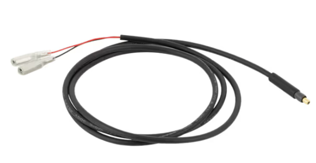

2. If you're handy, you can just cut off the light connector from the smart box and splice in your own. You don't *have* to use their odd connector.
That is good advice - I hadn‘t thought about that.
