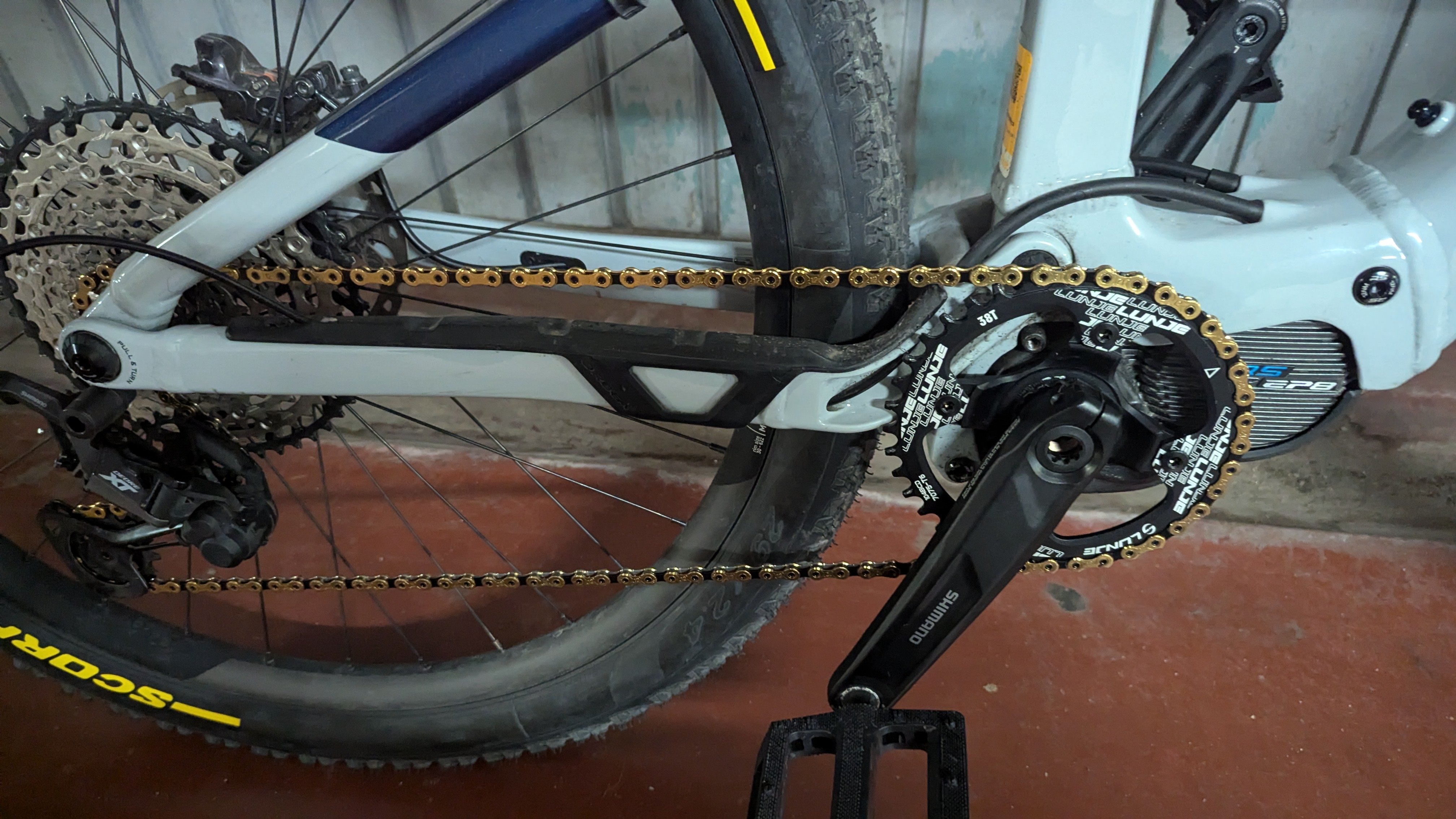

And I have a 19kilo gravel bike with a debrid engine ananda 80nm
and a VTT with ananda M100 (110/120/130nm!).
And I can tell you that the ORBEA is twice as powerful and pleasant! it's a real killer!

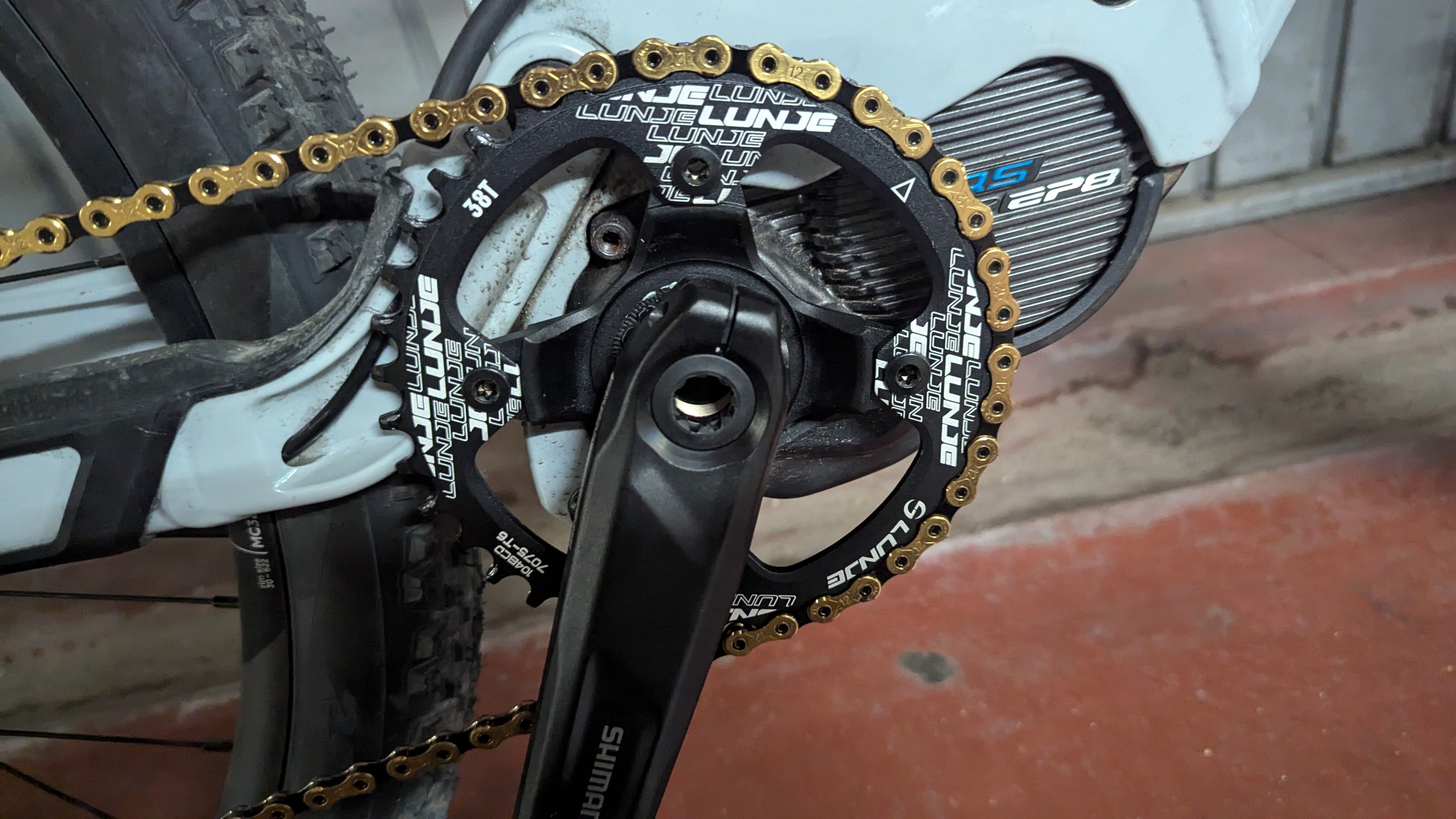

The only hitch is the damned 32 tooth chainring.
okkkk we can put a 34toooth (limit)
But the orbea rise with a 38 tooth chainring would be a motorbike :devilish:

I have 38T 🚀

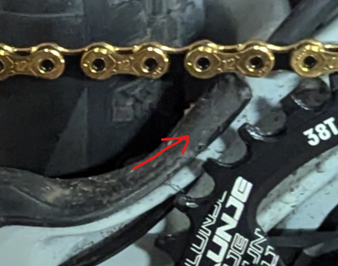

53mm in 38 teeth
and it doesn't touch your frame?
did you can post a photo? please

Please take care not to create confusion due to completly different bike models!
The bike shown on the picture above is a bike with the much older DU-E8000 drive unit and so this bike has another geometry than the new Orbea bikes with the EP801!
So maybe this chainring with 38 teeth will not fit to a newer Orbea Rise bike with DU-EP801 drive unit!

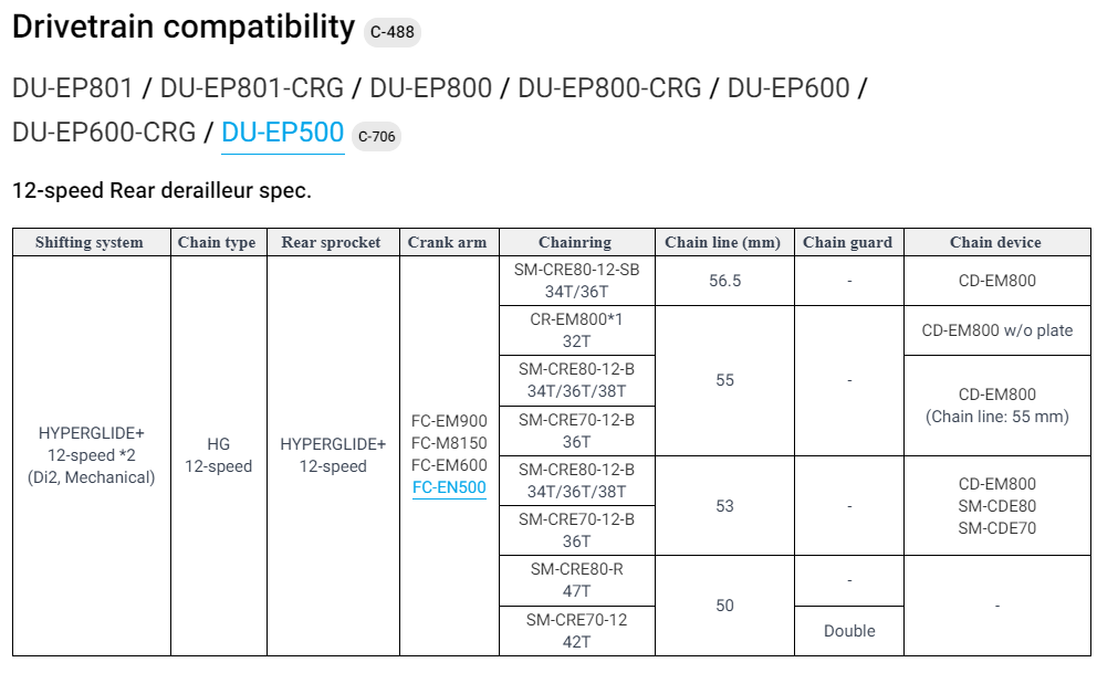

Always check the Shimano Compatibility Chart. Bigger and Smaller tooth chain wheels can have different chain lines. So whilst it does appear there is some variety allowed. Depending which one you get, it can impact your chain line, and thus have cross chaining issues.
I am a shift perfectionist, so I stringently stick to Shimano guidelines.
It's pointless going a bit faster, only to create poorer shifting and chain alignment issues, which will impact your ride far greater.
