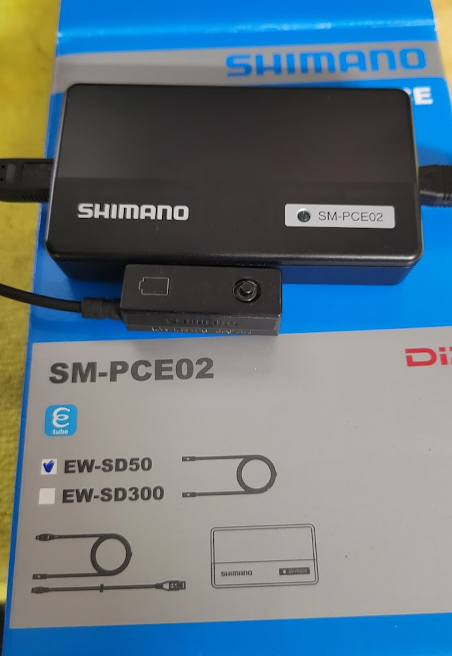

I did it with my EP801RS and it works great.I use windows version of STunlocker with a license. I connect to the bike at the EW-E100 junction using the PCE02 module. This method avoids all of the firmware issues when using only BT. I am able to customize the "Power and Torque" settings in the screen shot in my previous post, I don't think this is possible using only a BT connection. My question for anyone that might know is will this work on the EP801rs as well on 2023 model Rise? Works perfectly on my 2021 EP8.
I connect as shown below to bike, this is an extra EW-100 I have just for an example
