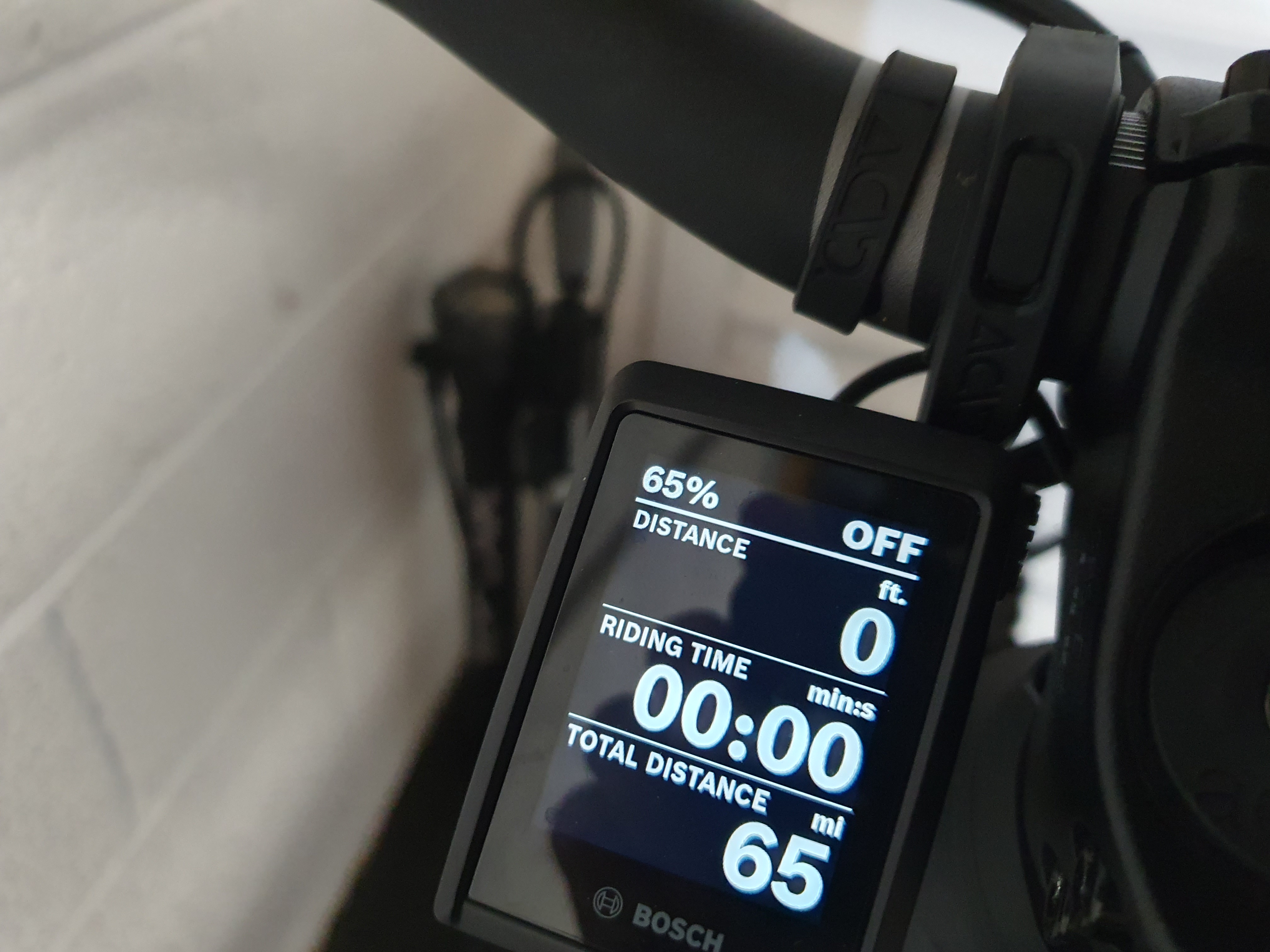

How to safely charge the battery to 100% without risk of overcharging/overheating
How to charge the battery to a required percentage (ie: 60% for storage purposes)
Apologies if this has already been covered in this thread and/or is already common knowledge. I'm using this method along with my charger plugged into a simple plug countdown timer to help minimize the risk of overcharging the battery (due to a charger fault or whatever) when charging to 100% and risking overheating/fire and also for hitting the storage charge recommendation of 60%. The recommended storage charge for a lot of batteries is around 60% so if you want to achieve that without some kind of an intelligent charger then you can use the example below:
Battery Capacity = 750wh
Required Charge Percentage = 10% (If your battery is at 50% and you wanted to increase it to 60%)
Charger Output = 144W (My charger is 36V 4A, so 36V x 4A = 144W)
Time to Charge (Hours) = (750wh x 0.1) / 144W (So that 0.1 is the 10% charge that I required, so if you want 20% charge then change that to 0.2)
Time to Charge (Hours) = (75wh / 144W)
Time to Charge (Hours) = 0.5208
Time (Mins) = 0.5208 x 60
Time (Mins) = 31.25
My example above is for a Bosch 750wh battery and standard Bosch charger which outputs 36V and 4A with the battery being at 50% charge and me wanting to increase it to 60%. I have tested this and it has worked fine for me so far, now I know my charger takes roughly 30mins to charge 10% I just set my plug timer and switch it on. Adjust the figures to suit your battery, charger and required percentage increase and it should all work out. If of course you happen to have the same battery and charger as me then you can save yourself the time by knowing that around 30mins charging = around 10% charge.
***Obviously it isn't recommended to leave your battery charging while unattended while you are not home***

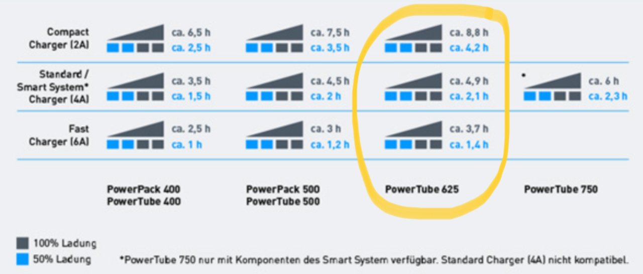

I've been using the charging table that Bosch published in their Battery Guide (below). Helped me quickly estimate how long I need to charge my bosch batteries for a given charging goal.
So with my Powertube 625Wh and a standard 4A charger, it would take 4.9 hr to charge my battery to 100% and 2.1 hr to charge it to 50% from full discharge.
I found that I get about 20% charge per hour. This seems consistent with @RipGroove's precise calculations.👍Of course YMMV.

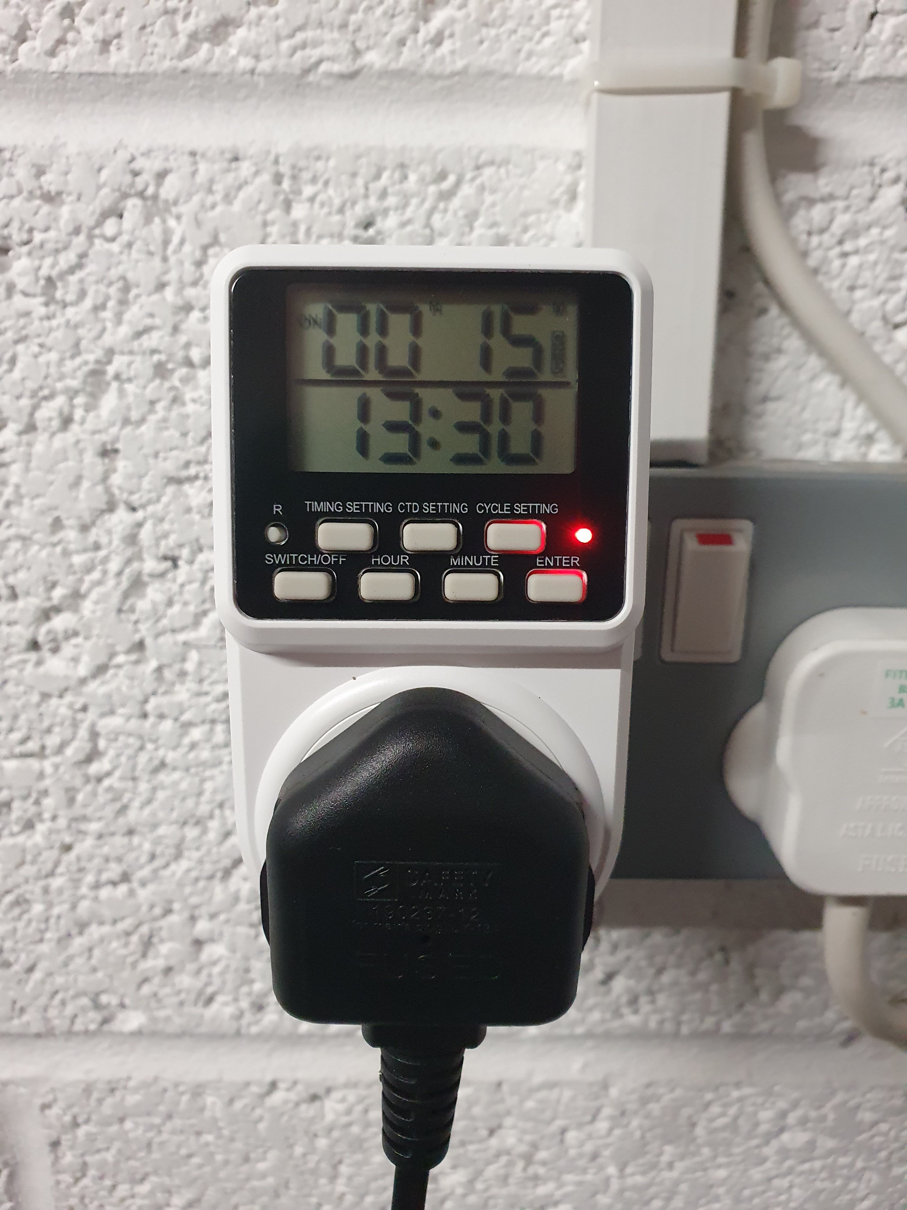

This is much more controlled than using a timer arrangement.
The £14 timer I have is extremely easy to use and means you are still using the original charger (keeping whatever methodology it uses to charge the battery). And I have perfect control over exactly how much charge I want to add and it shuts off automatically.
This is literally all I have to do:
Walk up to bike
Press CTD (Countdown)
Press the Hour and Minute buttons to dial in how much charge I want it to charge (30mins = 10% charge for me)
Press Enter
Walk away
It's literally like using a microwave, it even beeps when it's finished if you want it to and I can dial in exactly how much charge I want technically down to less than a single percent.
The one single downside is not being able to change the amerage rate that it charges at as that is fixed by the Bosch charger, but that's it, even if I could change the amps down to 2 I probably wouldn't bother anyway because you'd be looking at an hour's charging for just 10% charge on my particular battery and I'm sure if used correctly (ie maintaining good charging practices) the Bosch chargers 4.0a is perfectly fine and safe and maintains a decent battery life.
With a bit of thought and a cheap timer I can't see how a third party charger would be any better. I'm not expert though so 🤷‍♂️
15mins dialled in for adding 5% charge
And after its shut itself off after 15mins the bike has exactly 5% more charge than it did have (from 60% to 65%)
I can't see me needing any more control than that tbh.

@RipGroove, great feedback on your charging method! Thanks for the details!
So, once you figure out your battery charging rate (% per hour), the use of an electronic timer makes a lot of sense! :)
Do you happen to have a link to the programmable timer outlet that you're using?
That's the one I have, it works perfectly and seems to be well made but any simple timer that has a countdown mode will work.
It was £13 something or other when I bought it a while back.

I worried about that when I first got bike. I went away for a month at a time and a few times it was left fully charged . Same with running it till its nearly flat I do that as well. Doesn't seem to have done any harm im still getting same range .
RipGroove
Jun 3, 2022
375
189
Glos/UK
Yeah that would bother me tbh. I've heard of people knocking up DIY solutions to discharging batteries with fans and bulbs and things, be nice if there was an official plug and play device that did it but even better if the energy could be used for something useful like light or heat.
