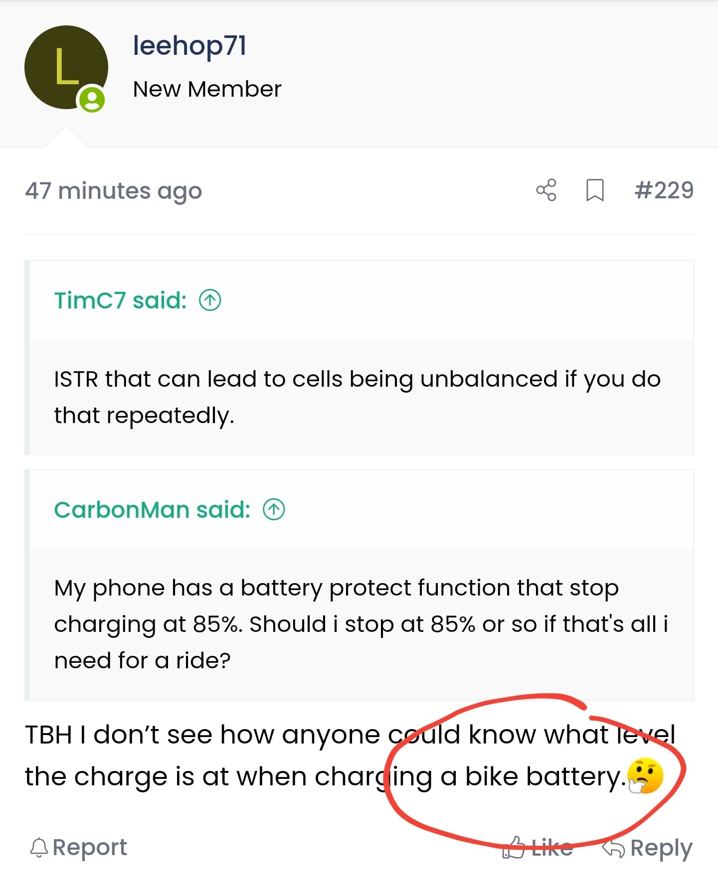

TBH I don’t see how anyone could know what level the charge is at when charging a bike battery.🤔
Trial and error - easy to check % with STunlocker and then see how much extra after an hour charge. I always boost mine to ~60% for storage and usually get it close enough.

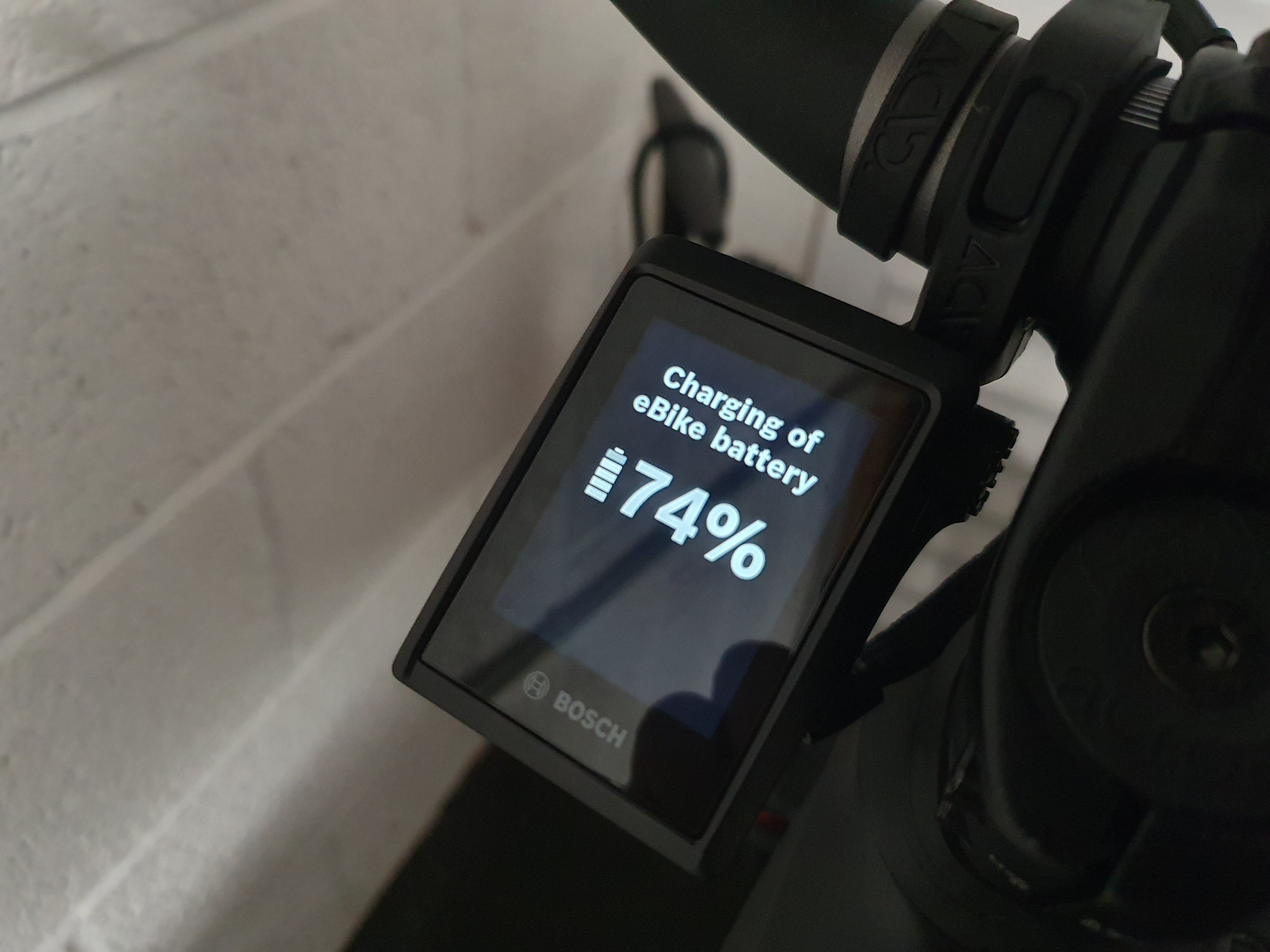

Mine shows the percentage of charge while charging. If yours does not then as others have said just check the percentage before and after a certain amount of charge to see how much it's gone up in that given time and use that for calculating how long to charge it for when starting at any given percentage.

Does your bike not have any LEDs or anything that show the percentage of charge while charging? The last few bikes I've had have all had some way of seeing the rough charge percentage by way of LEDs or some kind of bar meter where each block represents a certain amount of charge.
