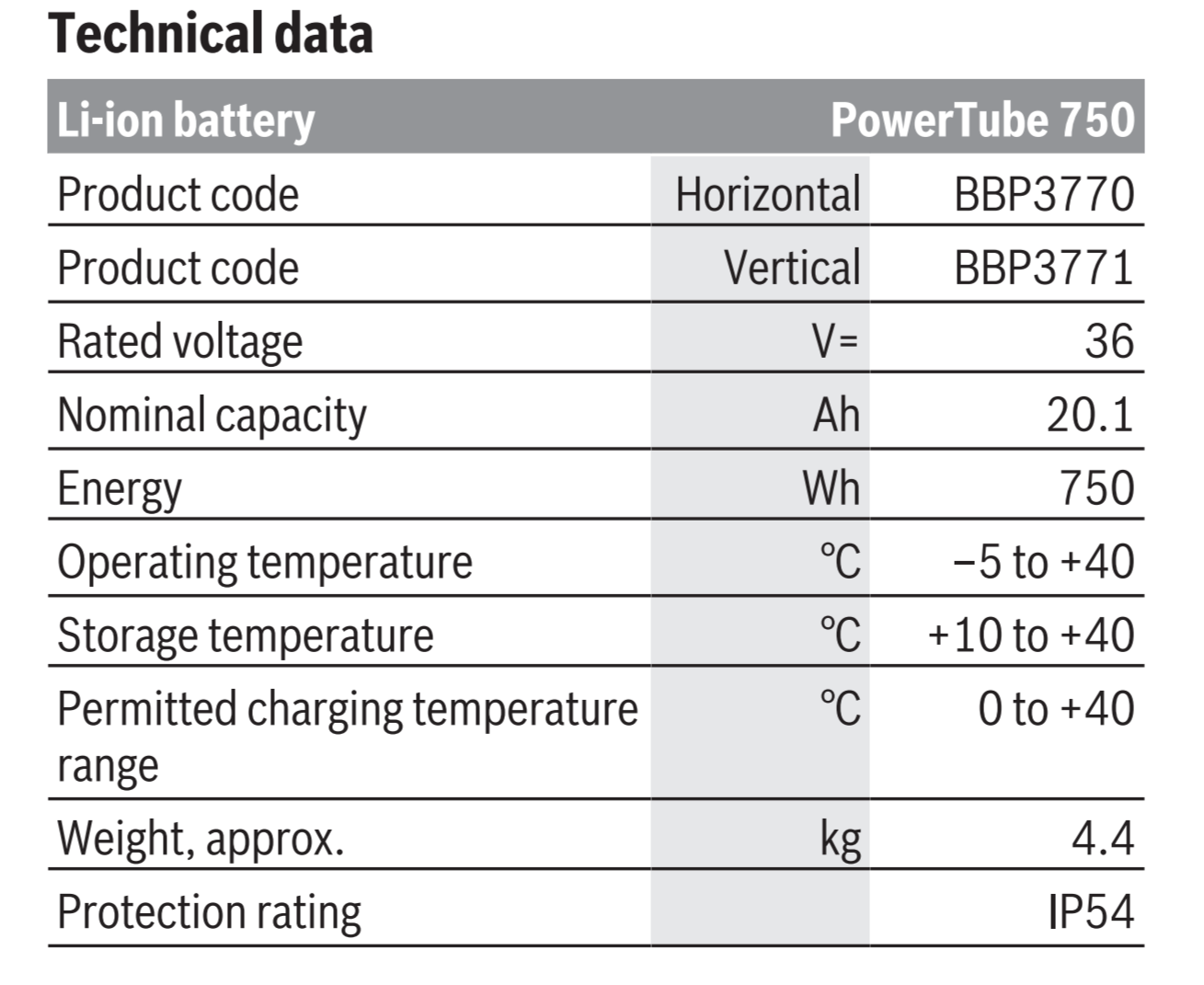

Concerned about riding in rainy weather this fall, I was wondering about water ingress on my ebike battery (and motor) and how to best protect them from water damage πŸ’¦
I found out that the IP (Ingress Protection) rating of the Bosch Powertube batteries as defined by the IEC is IP 54.
Meaning that the battery's ingress protection is :
(5) Dust protected
(4) Protected against splashing water from any direction against the enclosure
Would an IP54 rating be sufficient for riding under intense, heavy rain, which would be more than just water splashes!
Should the battery and electrical connectors be protected with some kind of waterproof cover to prevent water ingress damaging the bike? What's your experience? :cool:

Should be absolutely fine. If an integrated battery it shouldn't ever see splashes as protected by the bike frame.
There also aren't any moving parts on the battery which is generally the challenge when sealing items. Even if there was water ingress to the inside of the battery, I would expect the electrics to be conformaly coated (lacquer over the eletrics) which would waterproof the parts susceptible to damage.
