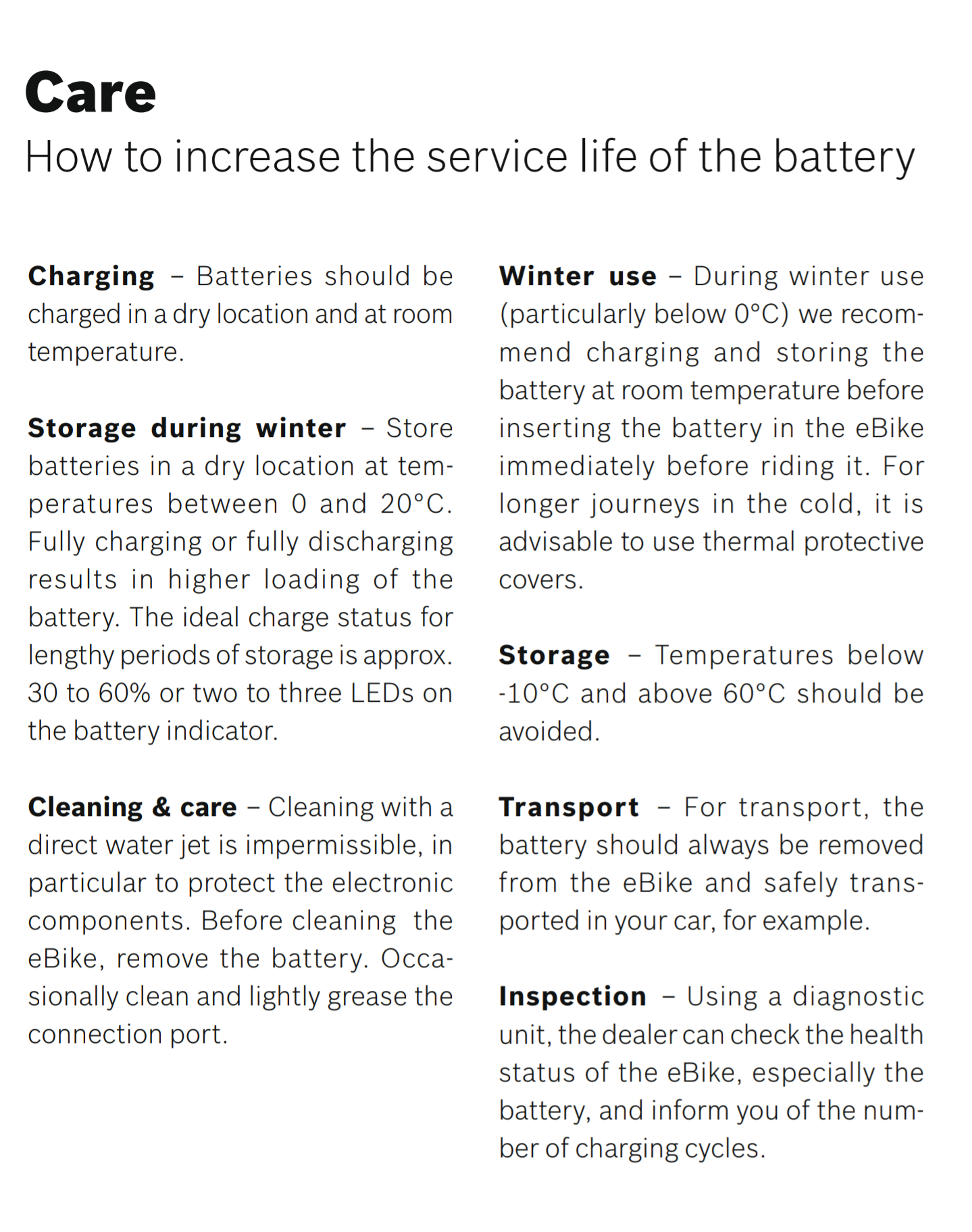

Yep this is consistent with what I've been reading. I just found the guidance below in the Bosch Power Tube instruction manual that came with my spare battery (BBP290):
  • Technical data - Battery operating temperature: -5°C to 40°C
  • The battery has a temperature monitoring function which only allows it to be charged within a temperature range of 0 °C to 40 °C
So if I read this correctly, once the temperature outside goes beyond 40°C, no more e-bike riding! :eek: Is that right?
I'm wondering if other bike/battery manufacturers have the same thresholds and limits when it comes to battery operation temperatures.
What are the risks though to ride my ebike in temperatures above 40°C (104°F)?
Low. It might degrade the battery very slightly faster, but it isn't going to explode!
That's reassuring. Good to hear! I'll just look for shaded areas and avoid direct sunlight on the battery.
Interesting enough, the battery care instruction guide from Bosch (below) mainly covers winter usage, but nothing about "global warming summer use" or how to maximize battery lifespan and range under the scorching hot temperatures we're seeing!

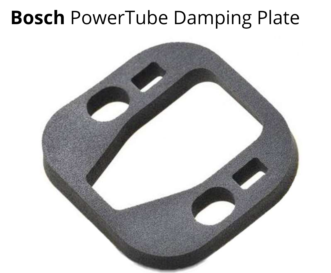

I found more details on the foam padding (damping plate) that sits on the socket of my bosch battery connector in the downtube. The manufacturer part# is 1270015683.
This foam plate seems to be doing the job because when the battery is mounted, it's all nice and tight betwen frame, connector and battery. I never felt any battery vibration during rides even when going downhill on rocks and roots.

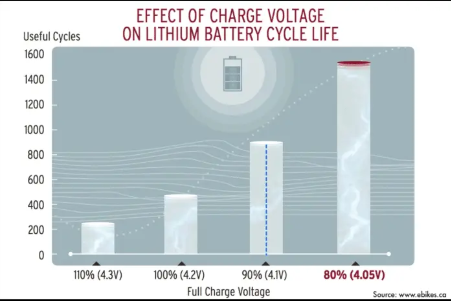

As an example, below is a chart showing the number of useful cycles you could expect from e-bike batteries based on charge voltage (full charge %). This may be an oversimplification, but when more charge voltage is applied overtime, less useful cycles can be expected from the battery.
Hence the battery charging guidance and best practices many have brought up in this thread(y)
