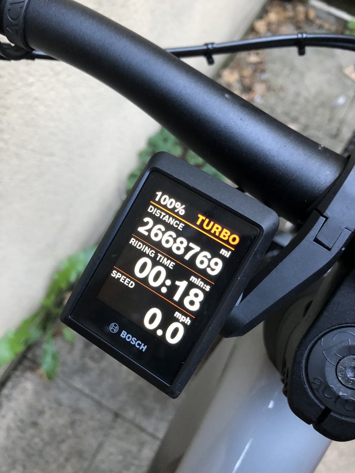

Bosch Smart System Desrestriction - SpeedFun!​
I bought this as a guinea pig, it has no reviews and the company is relatively unknown, but it was half the price of speed box 1.0 so I took my chances and it actually arrived with clear instructions and seems to be, so far at least, a viable option for anyone who has the same issue with the new Bosch smart system:
SpeedFun tuning ebike Furious Evo for Bosch Smart System 2022
2 day delivery from Italy. Super easy to install, best of all it works! Tested for about 30 mins avg speed 20.4mph, top speed (down a small hill) 42.5 mph. That's more like it, well happy! Doesn't feel dangerous at all, just feels more natural and how the bike should be, if any warranty issues arise you simple just remove. My advice to anyone reading this, probably best not to connect to the app as this is how Bosch will likely detect it. I haven't downloaded the app at all because of this fear. I took a risk on this, being a bit of bit of a guinea pig for this relatively unknown company on a device with no reviews at all. With limited options on the market and for half the price of the speedbox 1.0 I can confirm this is so far so good! Will report back if any errors occur.

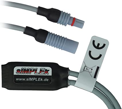

I bought the Simplek pro Stealth Edition ( sIMPLEK have a serious reputation in germany apparently) can't wait to test it ! If it's doesn't work well i think i buy the speedfun because its 2 less expensive
Do you need an activation everytime you start the smart system ?
And i think yes majority of error is with the Bosch app flow, I will uninstall it too when I receive the module
I keep you in touch with some 524001 error &
simplek-pro-tuning-modul-bosch-smart-system-bes3

Really really cool review mate ! thanks for this !
Thanks Naagra. No there was no activation needed, just plug in and go. No cool down needed either like the speedbox 1.0. The simplek looks good! I never saw that one. Yes please keep us outdated on how it goes! I wish you luck :)
I looked at their website, but it’s only in German. Do you know if it’s compatible with the Bosch wheel rim magnet speed sensor?
Hope it's going well ? any error so far ?
The simplek doesn't work well sadly, i'm in process to find an solution with them because the Stealth Pro create big jump speed in the display and the motor cut several second it's weird and annoying ...
Here a video of the problem :
sIMPLEK Pro Stealth Problem
Hey mate,
Sorry to hear you're having issues, I have only done about 60 miles so far but no issues as of yet, its really enjoyable atm so praying no errors pop up. Will definitely post here if they do!
In your video I can see how its cutting out, looks super annoying. The speed fun is quite accurate up to about 12 mph then after that it's anyone's guess. I've started to ride without without the kiox 300 always attached just to help with battery and I find it a bit too bright at night, there's probably a way to dim the screen a but I haven't figured it out yet.
I hope you manage to get your simplek issue sorted or at least a refund!
Thanks for the info, I was looking at this solution, but I was a little suspicious about the price. Speedbox costs twice as much and reviews aren´t very possitive.
Does it show real total kilometers after the ride (ODO)?
Could you report after longer time if there are any errors? I´m planning to buy some tuning chip in early spring for next season.
