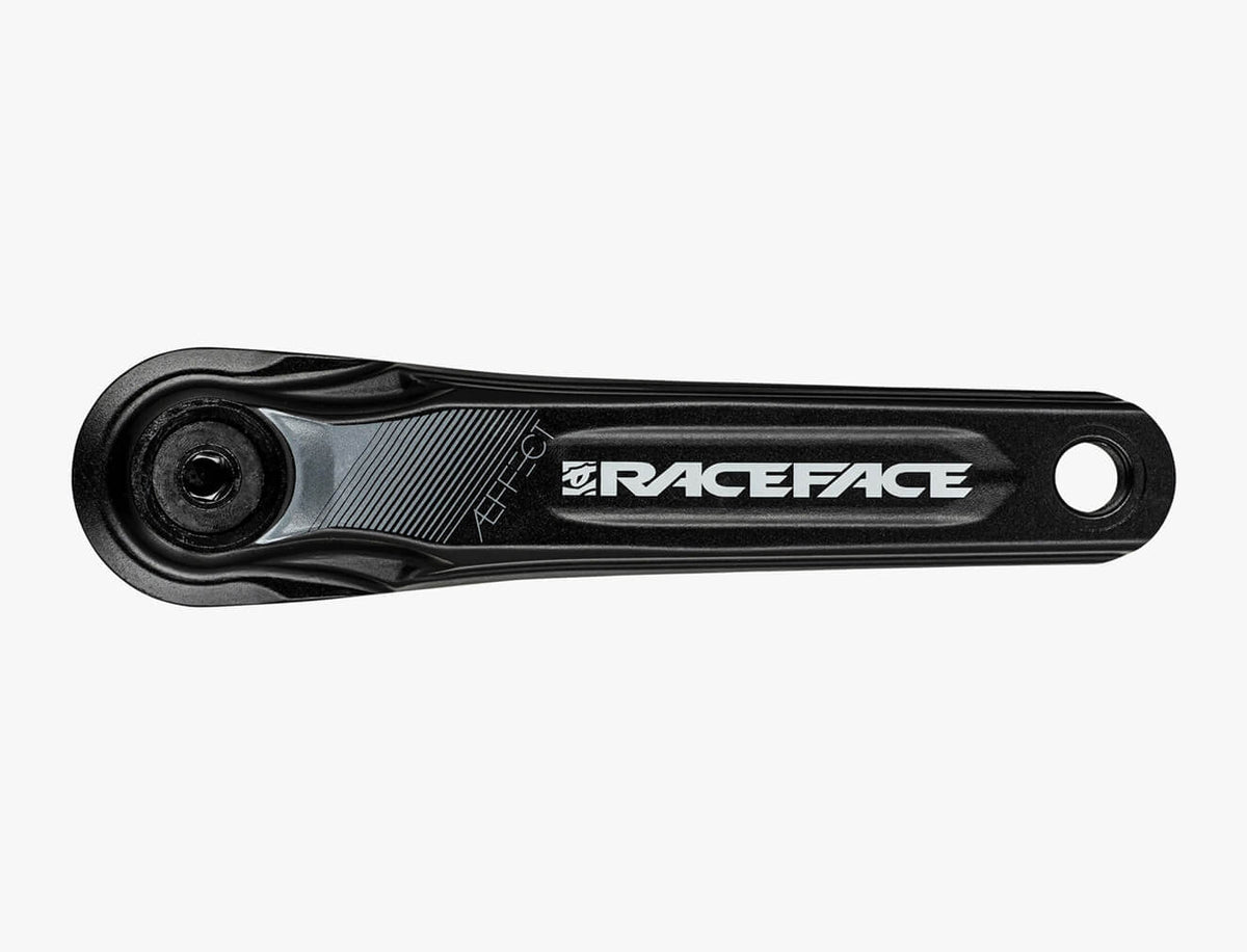

Raceface Aeffect cranks is another recommendation @timal 👍🏿
timal
Sep 21, 2022
26
23
australia
thank you Neeko, unfortunately they are out of stock and only 170mm, no 150/152mm

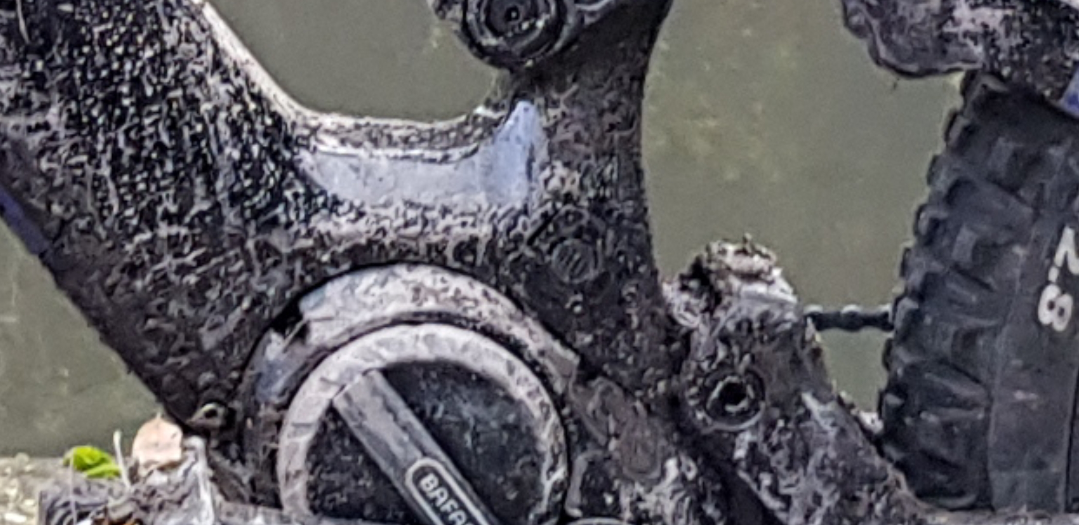

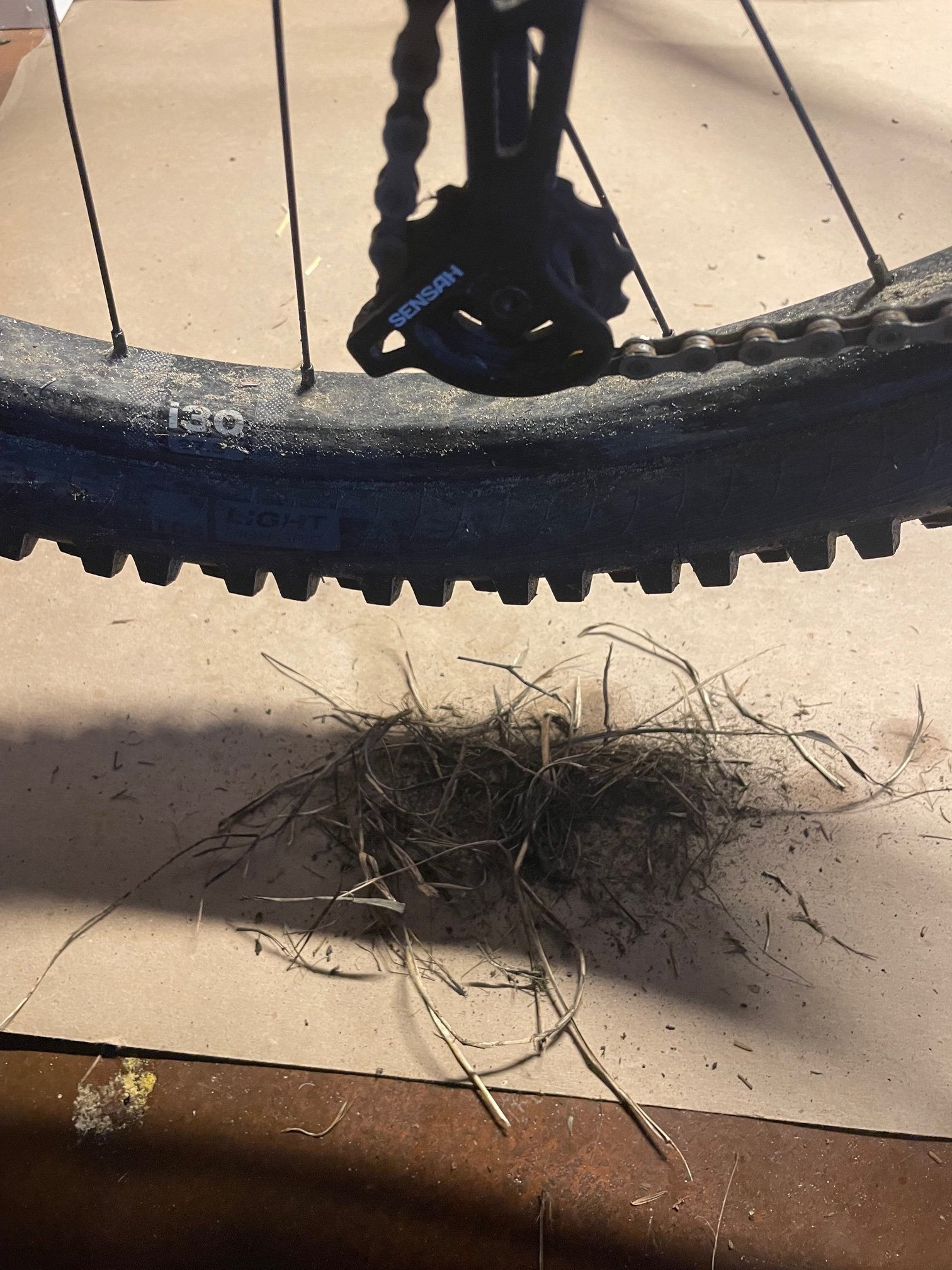

So after a couple hundred miles on the WTB HTZ wheelset am reporting them to be a success.
Can't really get all the scientific because I am not that guy but what sticks out to me the most is how little they deflect off roots and rocks. Either that or the custom Race Face ARC 35 wheels I had on before were awfully flexy?
In a way it makes sense on a FS bike with this much travel to not have to depend much on how much "compliance" you are really benefiting from? So a wheelset that is built to be stout as hell can be firm and let the suspension do the work. Sure they are not all that weight conscious but neither is my bike, or me for that matter. And let's face it with an E22 weight is not as important, even rotating as it has plenty of snot to move things along.
Also in honor of the winter months I fit them with a 2.3 fr/2.6 rear @ 18psi as I find thinner tires to be better for the terrain here which is a mix of rooted forest track, logging roads and sand trails. But so far they have not made me feel sketched in any situation that I have put them trough so I am calling it a win.
Got a good deal on a mullet set of ARC's with DT hubs on offer!
Now if they would just get a decent hub/hybrid gear thing going that would hold up I could get rid of having to clean out my der cage.....

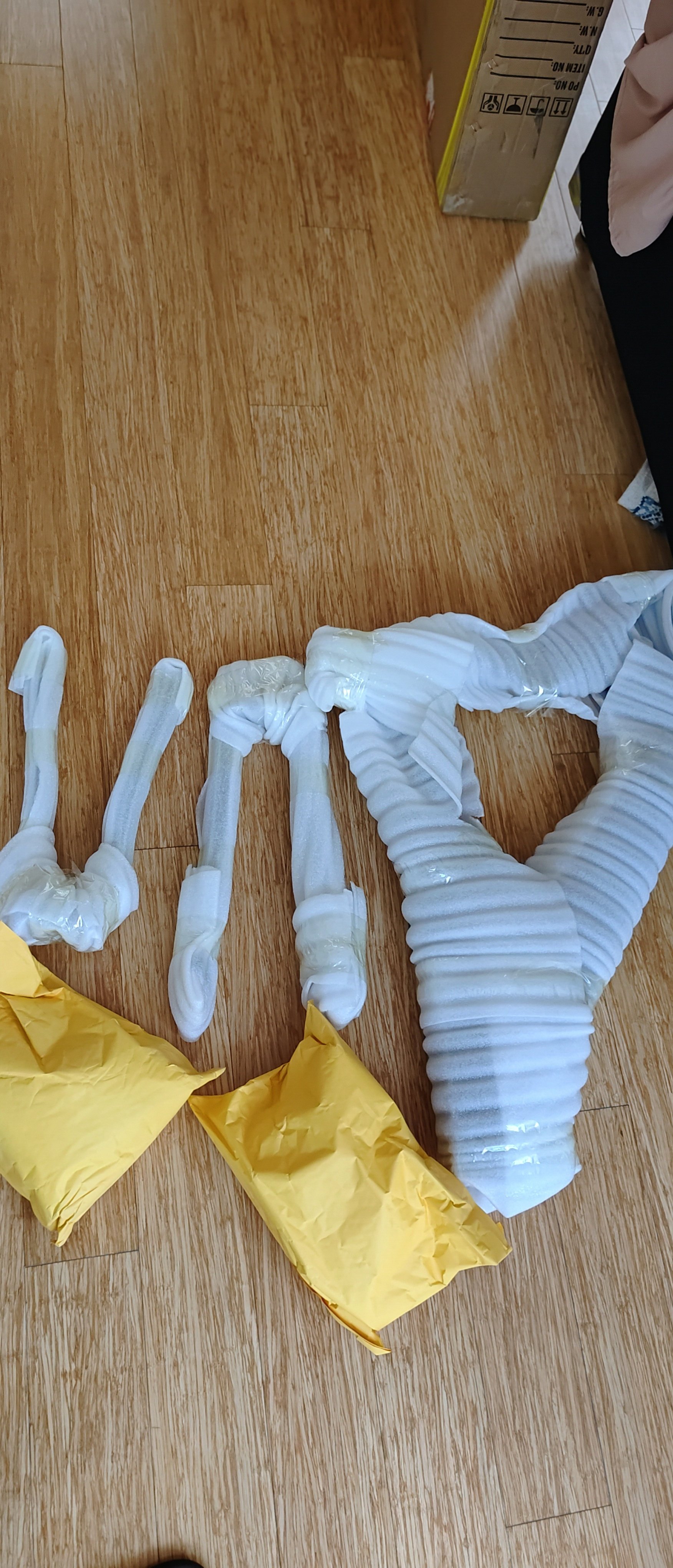

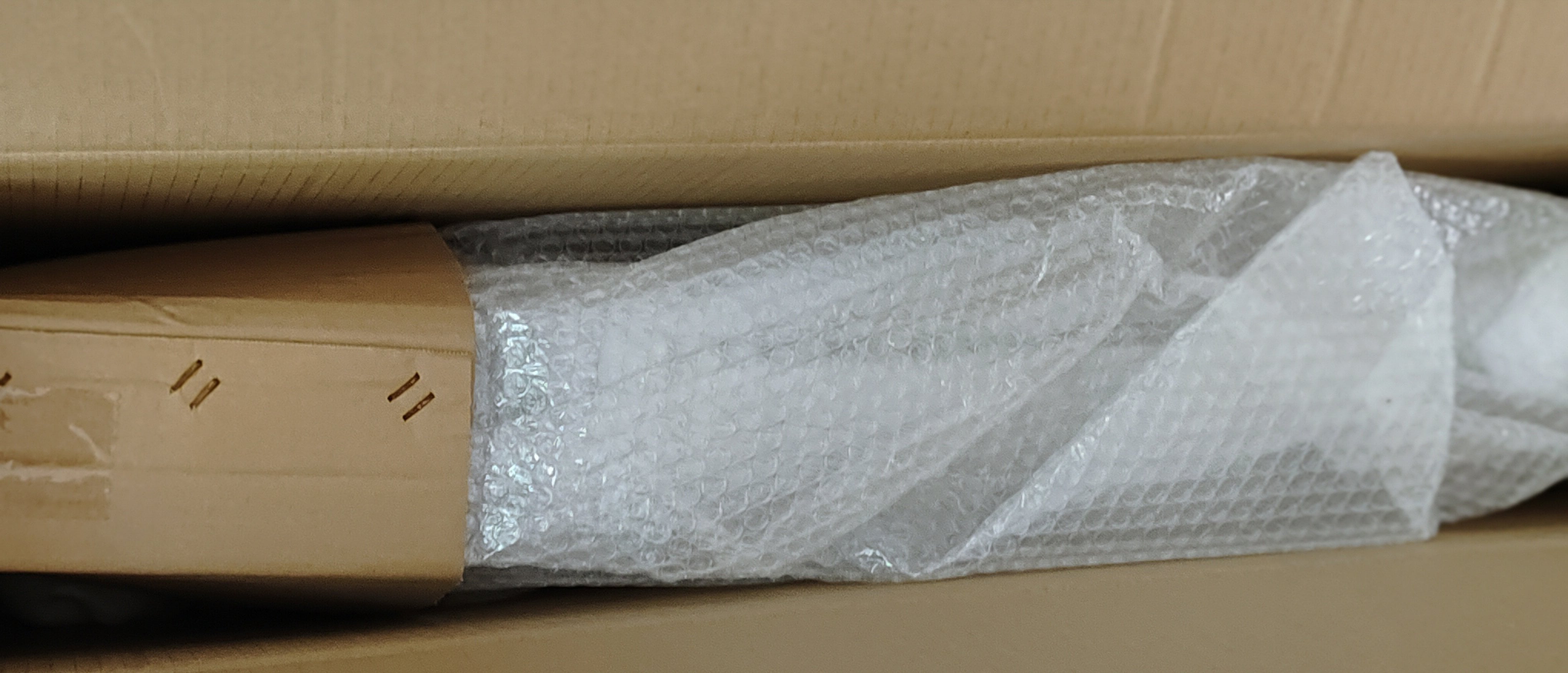

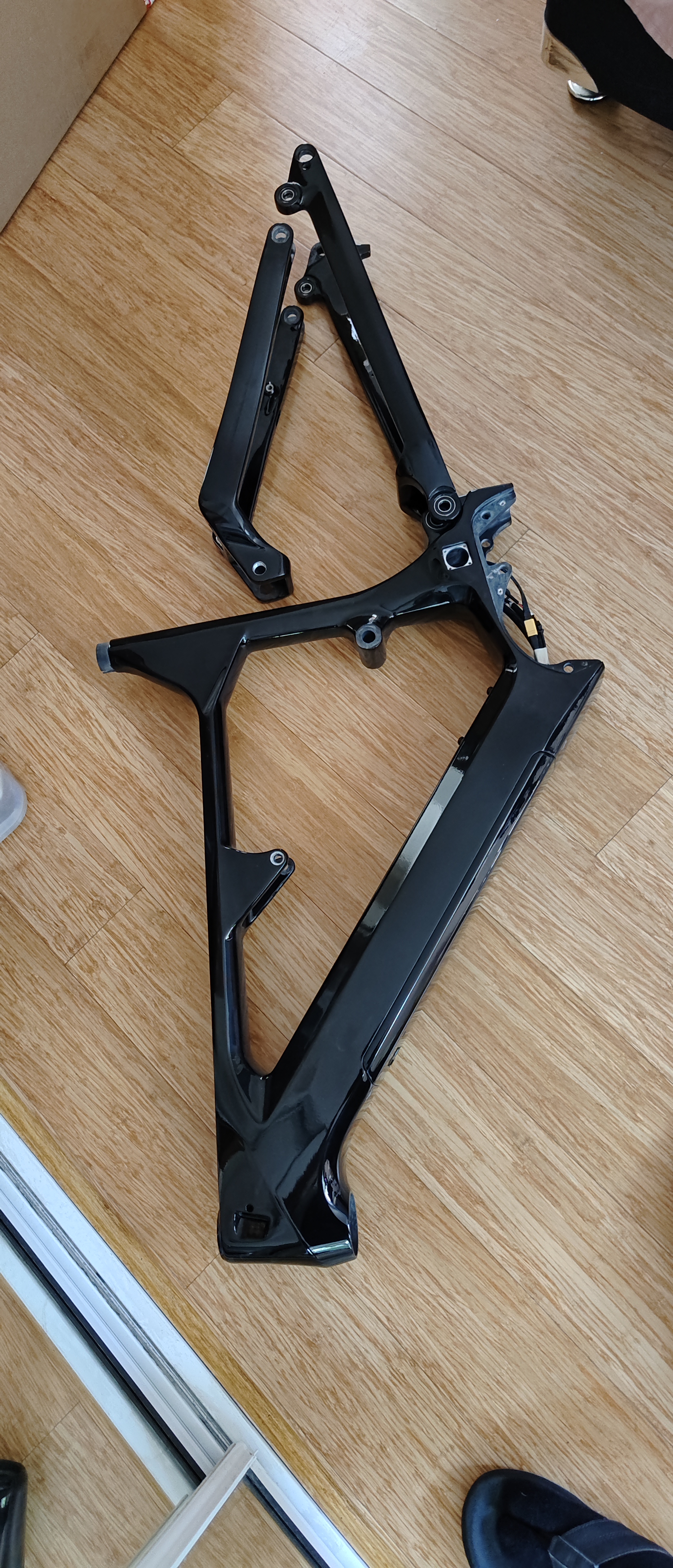

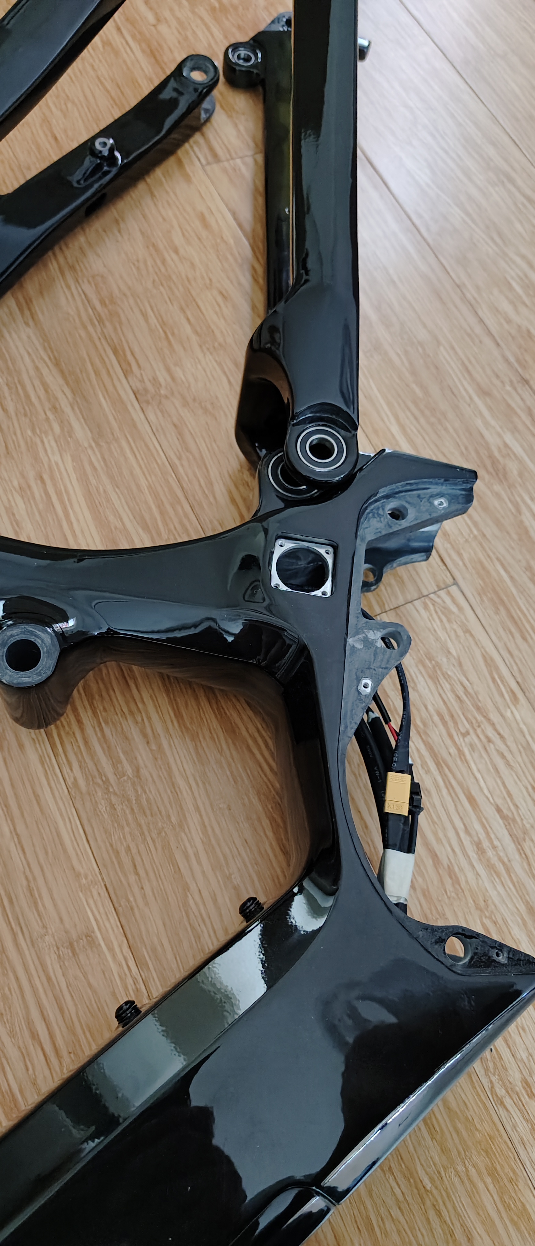

Hi guys, I received my frame today from dengfu factory. And let's be honest, it is impressive in real! I picked the glossy version and it looks perfect. I only have one issue, I got no manual or guidance to put back all the bolts washers and rubber seals that hold the swing arm. How did you guys managed to deal with that? Thanks a lot for any support.
IMG_20221110_145542.jpg IMG_20221110_145632.jpg IMG_20221110_145741.jpg IMG_20221110_150308.jpg IMG_20221110_150315.jpg IMG_20221110_150325.jpg

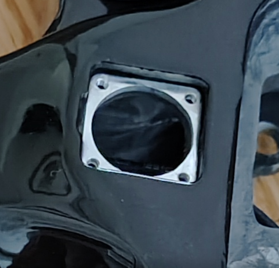

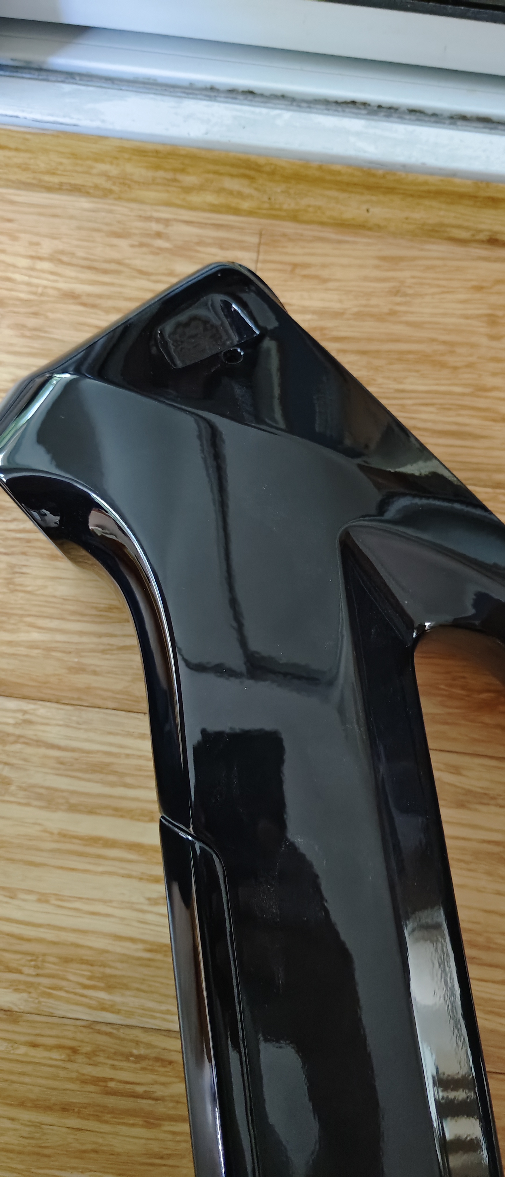

This is the part of your frame that interests me the most
Looks to me like someone convinced DengFu to get rid of the dinky DC plug and go with a Rosenberg type connection for the charge port. This is a move I am currently considering because of the fact that it would allow for charging at higher Amps, I use a Grin Satiator that I can customize up to 10A, that I never would trust to the DC barrel type.
I looked online for somewhere to buy a Rosenberg system but they seem elusive. I sent a request to the manufacturer to see if they could help with a supplier but no answer yet. I figure it won't be that hard to convert but also considering abandoning the stock spot and moving the charge port to the non drive side upper down tube across from the switch/battery lock? Haven't really looked inside there but should be enough room? Work in progress......

Don't go there with the Rosenberger connectors, incredibly expensive for what they are, huge in size, have far too many nooks and crannies for mud and dust to accumulate in and the biggest pain is they are magnetic. I have a working workshop and as fast as I clear the connector from metal filings ( I really do not know where they come from ) there's another bunch hanging off the charger plug :rolleyes: .
I bought mine off the UK supplier for the Fazua charger I built, I just searched Google with the part number and they came up as suppliers.
Neeko DeVinchi
Dec 31, 2020
1,042
1,387

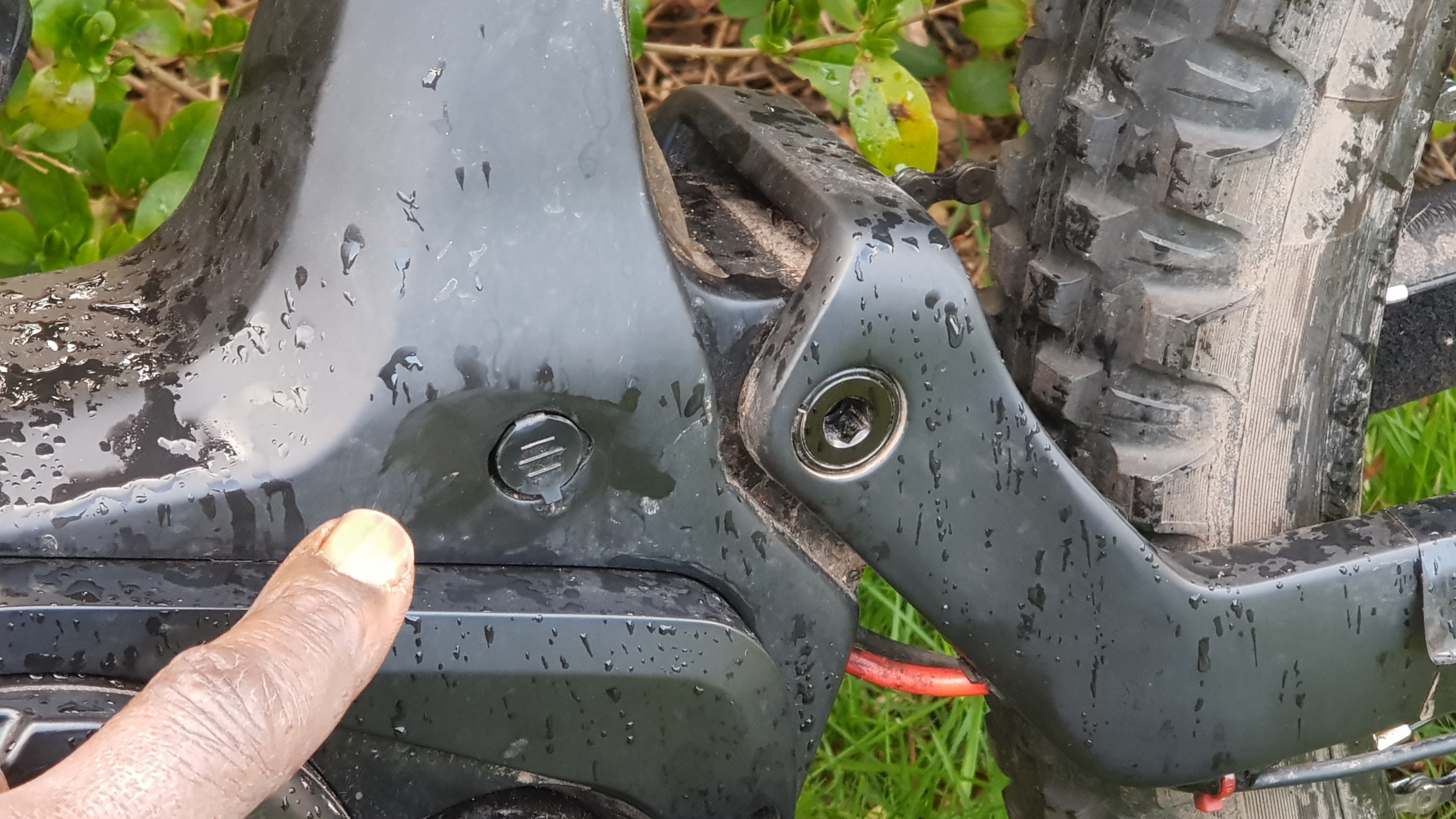

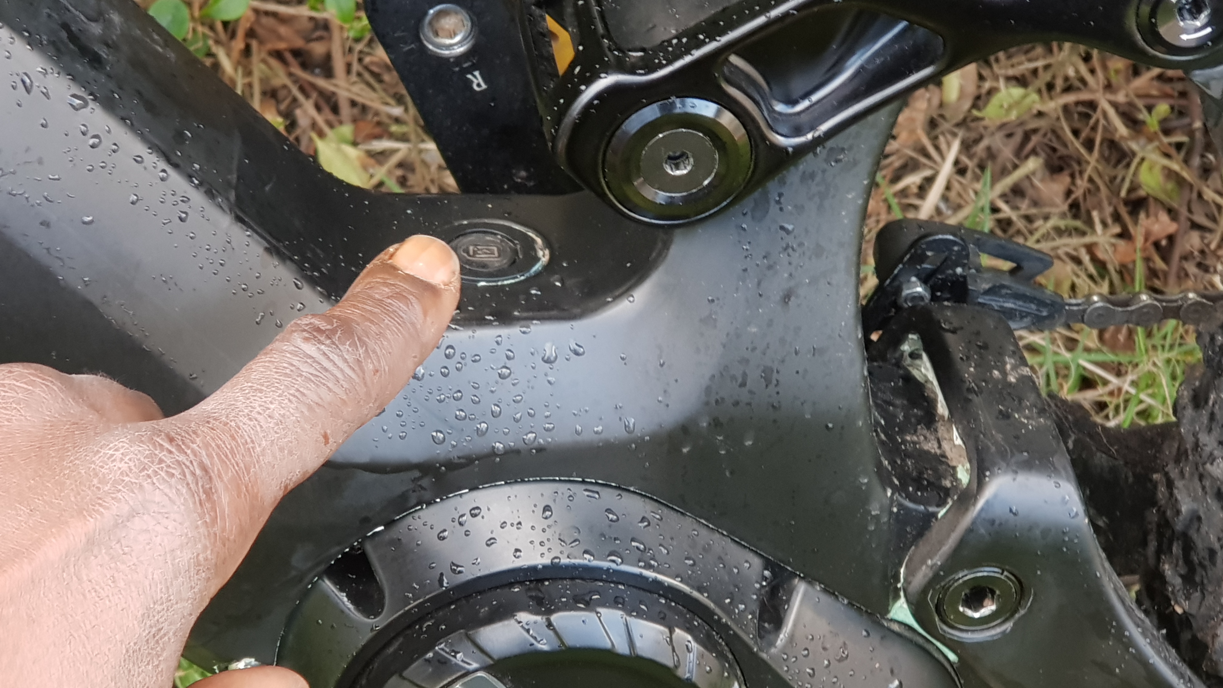

I have asked Dengfu about the charge port variations between certain E22 frames as well as E10 frames.
The reason why Dengfu have opted to run the charge port location on the none driveside (above the motor/along the seat tube), is purely for cosmetic reasons. They explain that having the charge port located above the motor mount area on the E22, would interfere with the bottle cage. Thus, they paired both the E22 and E10v2 with the same position. Coupled with the fact that both the E22 and E10 (and E23) share the same battery designs and form factor, Dengfu explained that distributors and dealers won't have to order a specific part unique to a particular frame.
As for the cut out of the charge port location, Dengfu explained that this is following from the choice of the respective distributor. A distributor can opt to have a particular style of charge port, in conjunction with a particular charger style.
Referencing my E22 purchased from Carbon Cycle, they opted for the standard 5.5 x 2.1 mm DC barrel connector.
Same thing goes with the E10v1.
Its difficult to make out on the v2 E10,
But the charge port cut out does indicate the choice of either a 5.5 x 2.1 mm DC barrel connector, a 3Prong Female Head 8mm x 2mm or an XLR Male 18mm x 5.5 x 2.1mm could have been used.
Or the Rosenberg style 😄

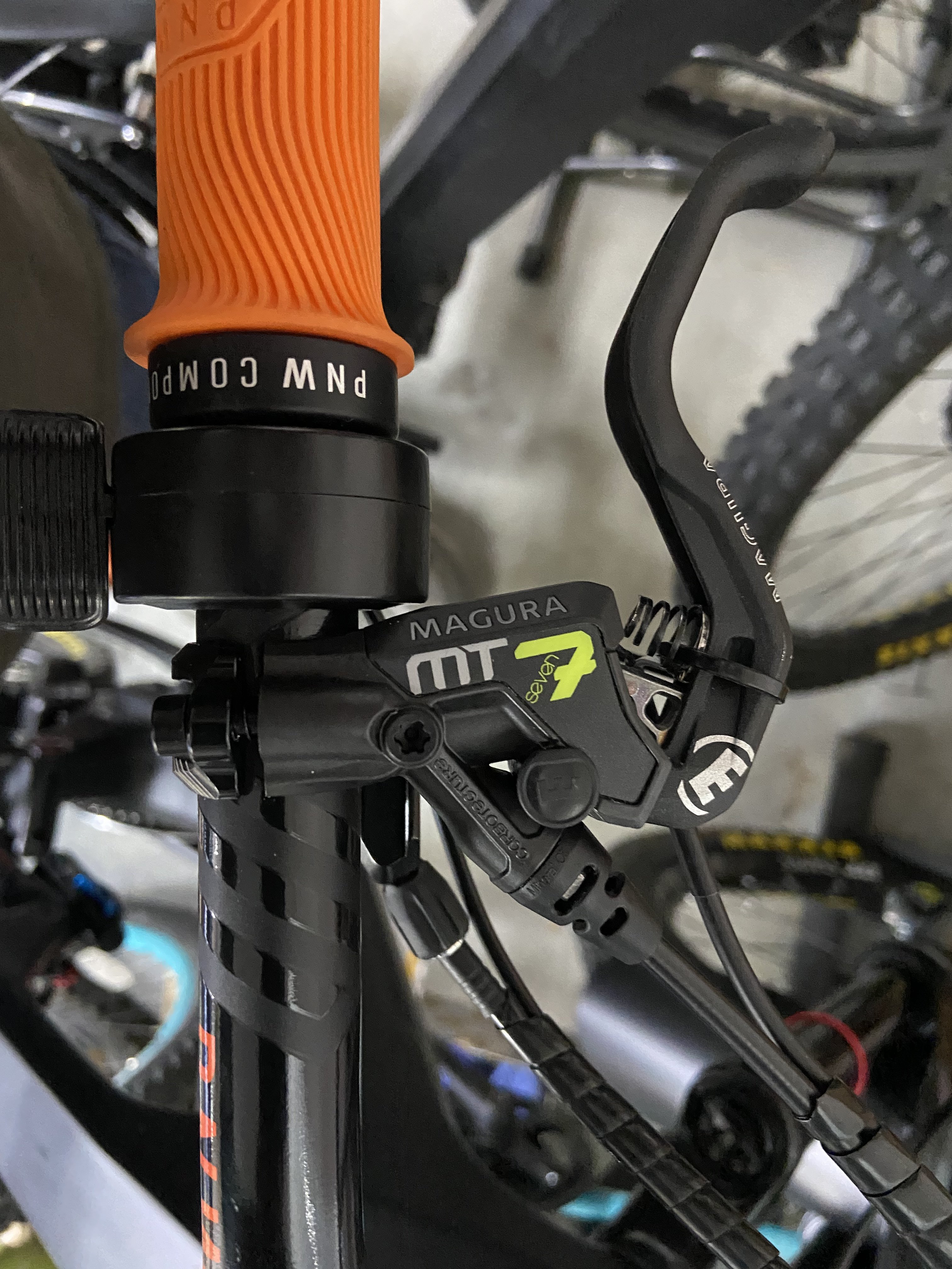

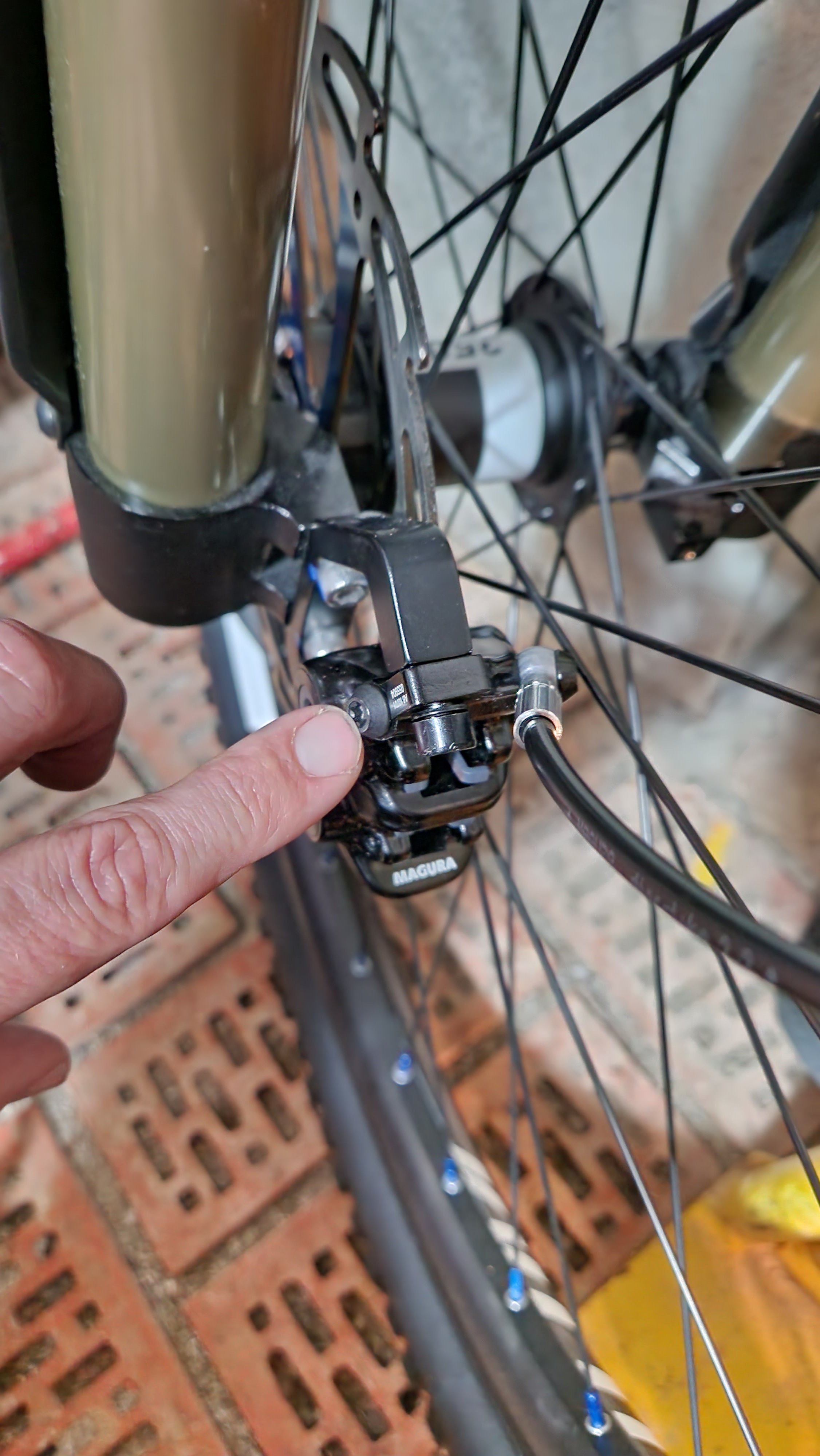

I installed my front wheel with magura brakes and the bolt which connects the hose to the caliper is very near to the spokes, there is cca a good one mm of space between them. Perhaps is it possible to put the hose on the left side of the caliper (where my finger is pointing) or is this hole only for servicing?

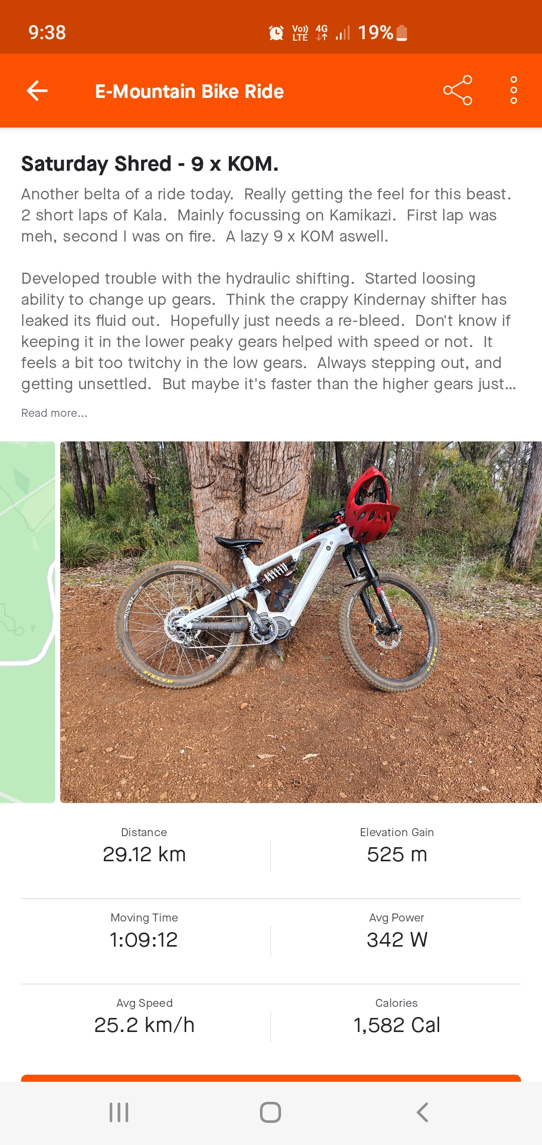

Man I am loving this bike. Everytime I ride it, it's KOMs. I got 9 on this ride. And this is at one of the most popular MTB trail networks on this side of the continent.
Stupid Kindernay Shifter has stopped shifting up gears now aswell. Think the fluid has leaked out. Hoping a re-bleed will fix it.

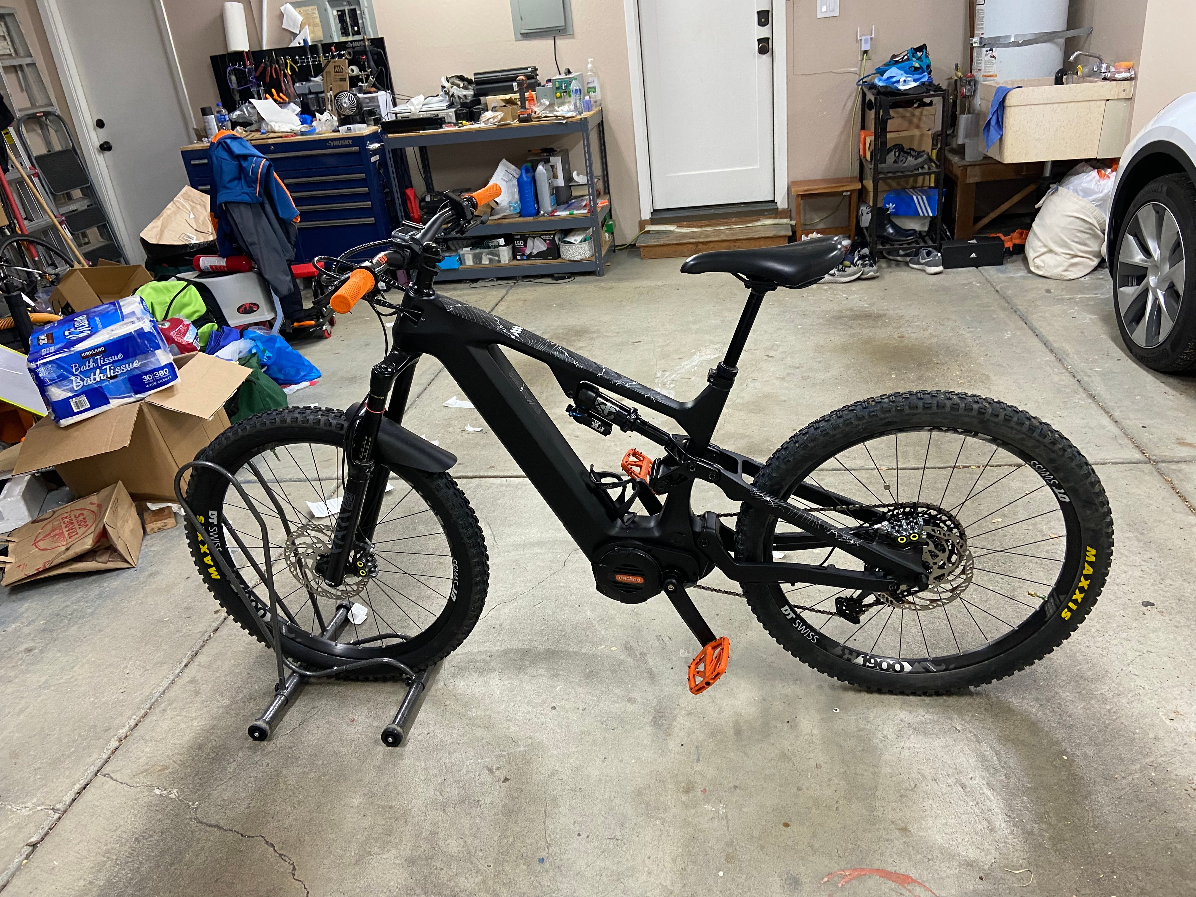

Trail maiden ride on Sunday with the boys. 20 miles trail ride with a lot of climbing and some downhill single track. It worked great. My buddy’s new 2022 turbo levo had a snapped chain, mishap repair causing chain drop toward the spikes, then a tumble causing damage to the thumb remote (No longer working), problem connecting to the phone for setting changes etc.

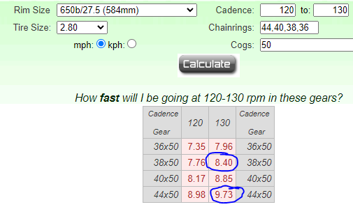

What chainrings do you people run for trail riding?
I am looking to be able to have a good climbing gear but also to be able to hit ~50kph on the flat if need be.
I am learning towards 38-40t in the front, which will be paired with 11-48 at the back. To my understanding this setup should be sufficient for even the steepest climbs provided higher PAS levels(≥1000w) will be used.
What is your experience on this?

Use the standard 44t

Isn't 44 a bit of an overkill? What's the benefit of having such a huge chainring? Seems like this would not be ideal for climbing...
I've been curious about this too. I'll bet its alright with the fancy schmancy kindernay transmission and its 543% range plus the ability to adjust that range via the rear sprocket selection.
The only reason I've chimed in is to make sure we get a measure we can compare in the real world.
my bike at max rpm in first gear
38f 50r = 8mph
check out my video including a very steep climb and descent! I am in 2nd gear for most of it.

I used the 44t before I had the kindernay. I used it with a 11-50 9 spd and it was the perfect ratio.
With the kindernay, 44t front, into 22t rear, I never ever use the lowest gears. I generally use the middle gears or higher gears. Which works out to overall gear range of 2:1 or higher.

It's the standard size chainring for the bike. And it works out to be a really good size for standard wide range groupsets.
You really don't need any smaller at the front when you have the bafang ultra.
You can still climb with the 44t, it really doesn't shift the gearing that far that it makes it unrideable.

Also the kindernay vii is only 427% ratio range. Which is less than all the common wide range 1x groups these days. So front chainring sizing is slightly more important. There is no way I would use any smaller than 44t at the front if this bike. (Coupled with a 22t rear cog into the kindernay)
