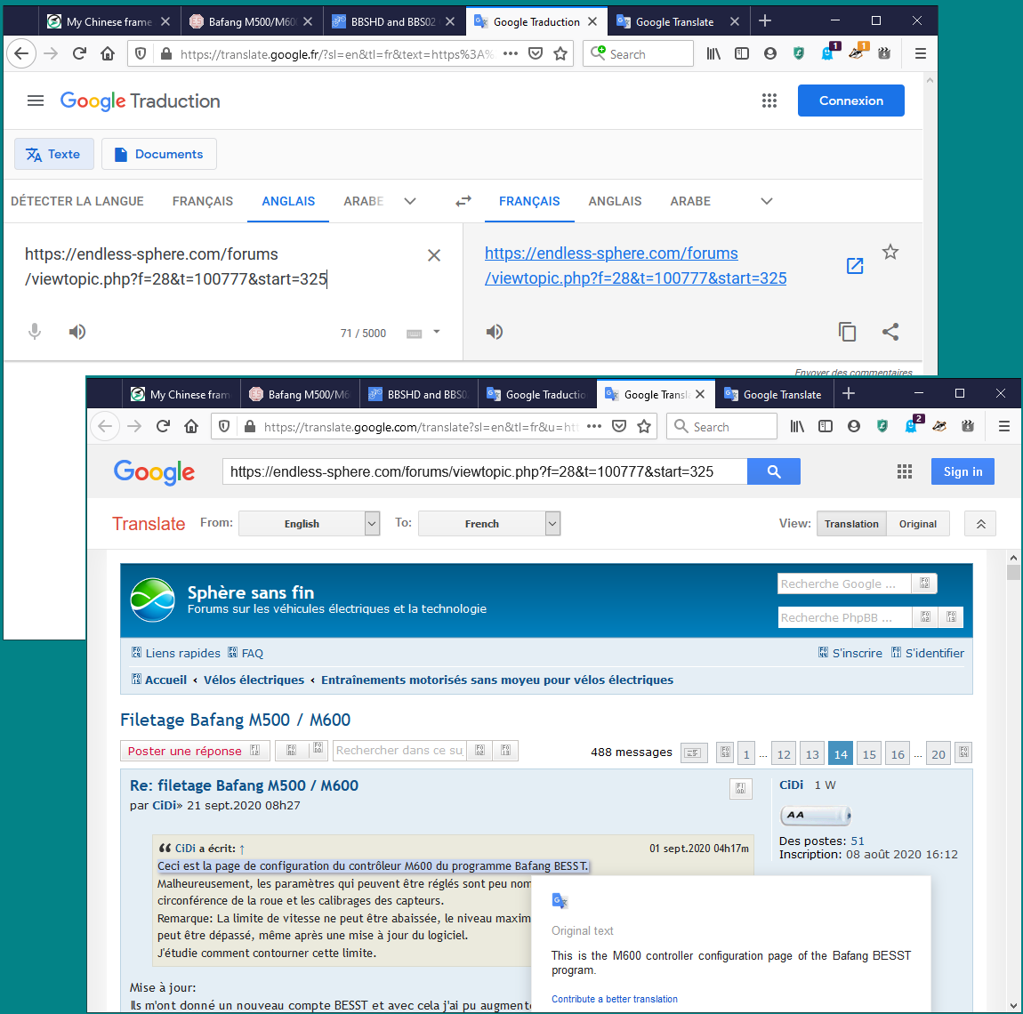

thanks i read it, due to my poor english i have difficult to understand all
Read it via Google Translate. Works also for this site :) and may clarify the text.
