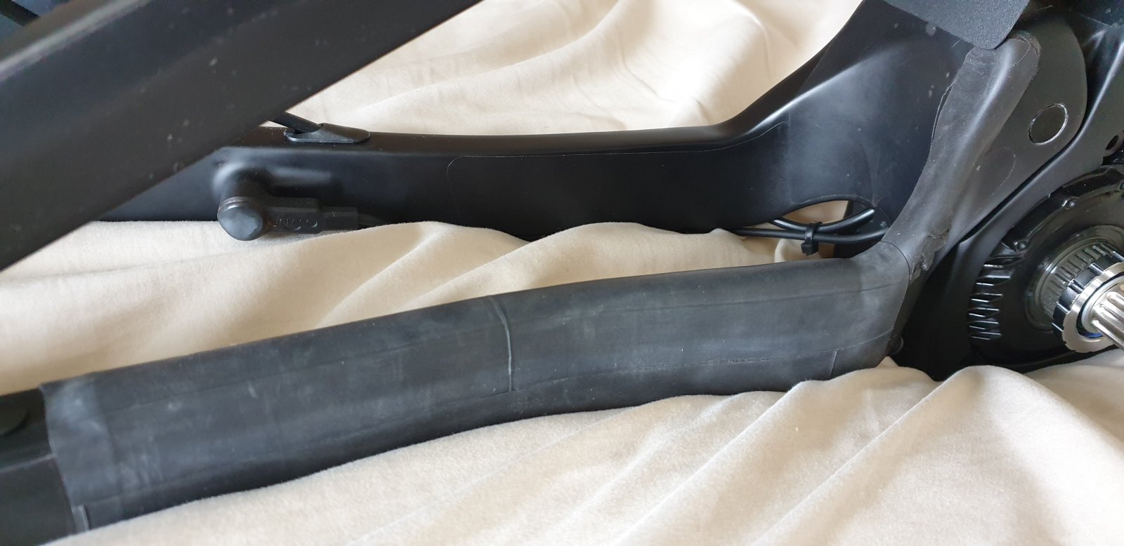

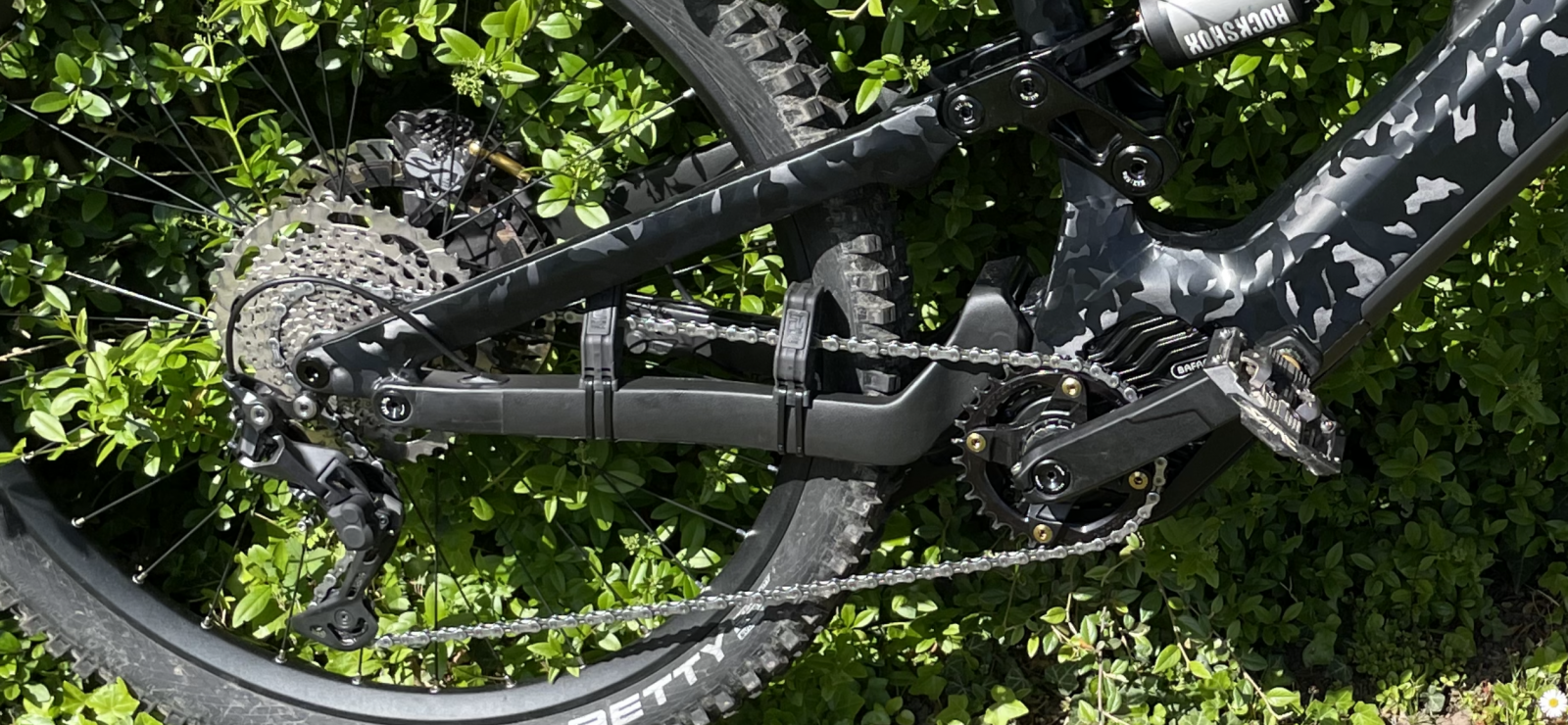

Anybody have a recommendation for a chainstay protector for the E10?
This is what I did.
3M mastic tape along the top of the chain stay and then I slipped a length of inner tube over the top.
The mastic tape is very 'pliable' (especially if you heat the area) and sticky.

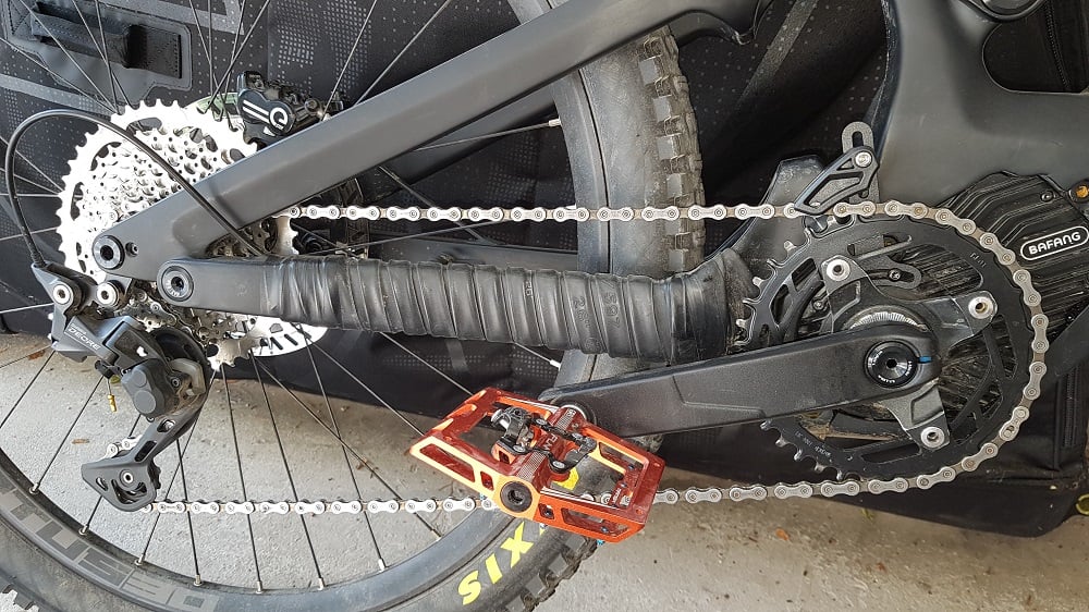

i have use this one (in colour of my frame)
and apply strong tape on part after axis (necessary, lot of impact of chain here)

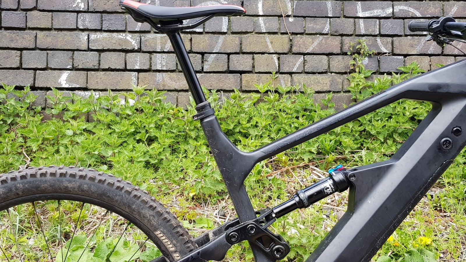

Hi everyone Has anyone tried 210x61 shock absorber? At the worst I could put a shim under the rubber pad but I would like to take advantage of the greater stroke
thaeber
Jan 26, 2021
888
769
Bruchsal, Germany
Use at least one offset bushing to increase the installed shock length to 212mm. Compressed length would be 151mm then. Without that, the bridge between the seatstays may touch Your seattube when fully compressed.

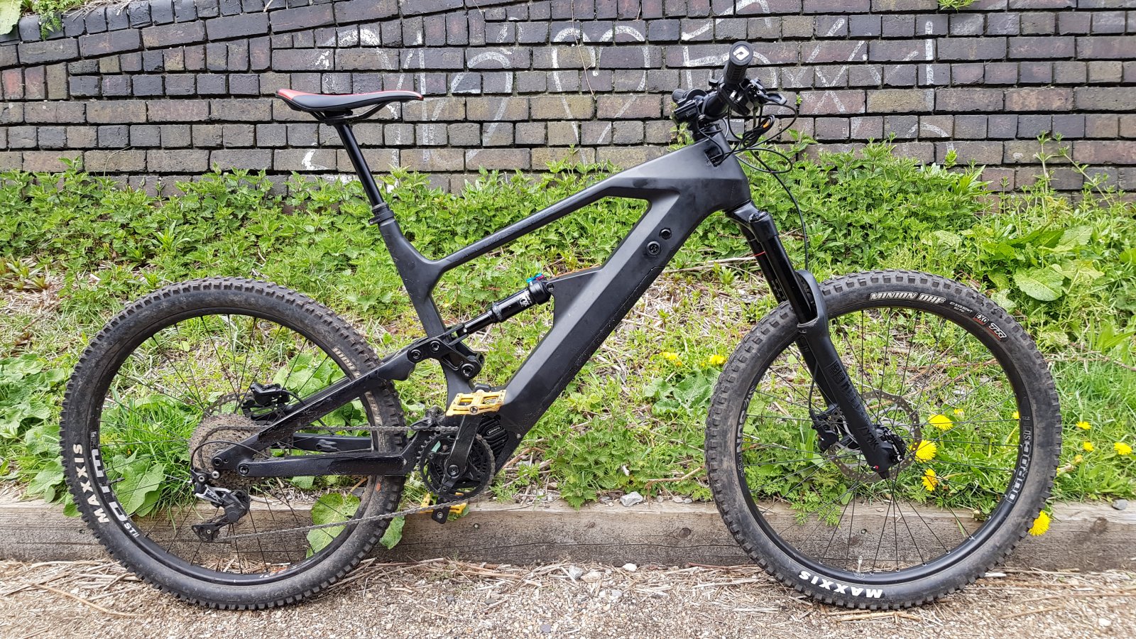

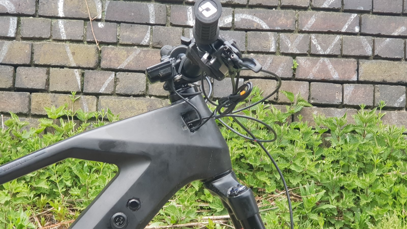

Not sure if anyone will find this useful for the 1st generation E10 frames but
Superstar Components Slackerizer fits into the headtube of the XL. No fiddling around with either the headtube or headset was required.
Allowing me to retain a seat tube angle whereby keeping my default riding position somewhat over the bottom bracket (motor).
Difficult at this stage to guage whether steering has improved or remains the same.
But it's an option to consider if over-forking or a mullet setup isn't having the same effect compared to other emtb frame platforms 👍🏿

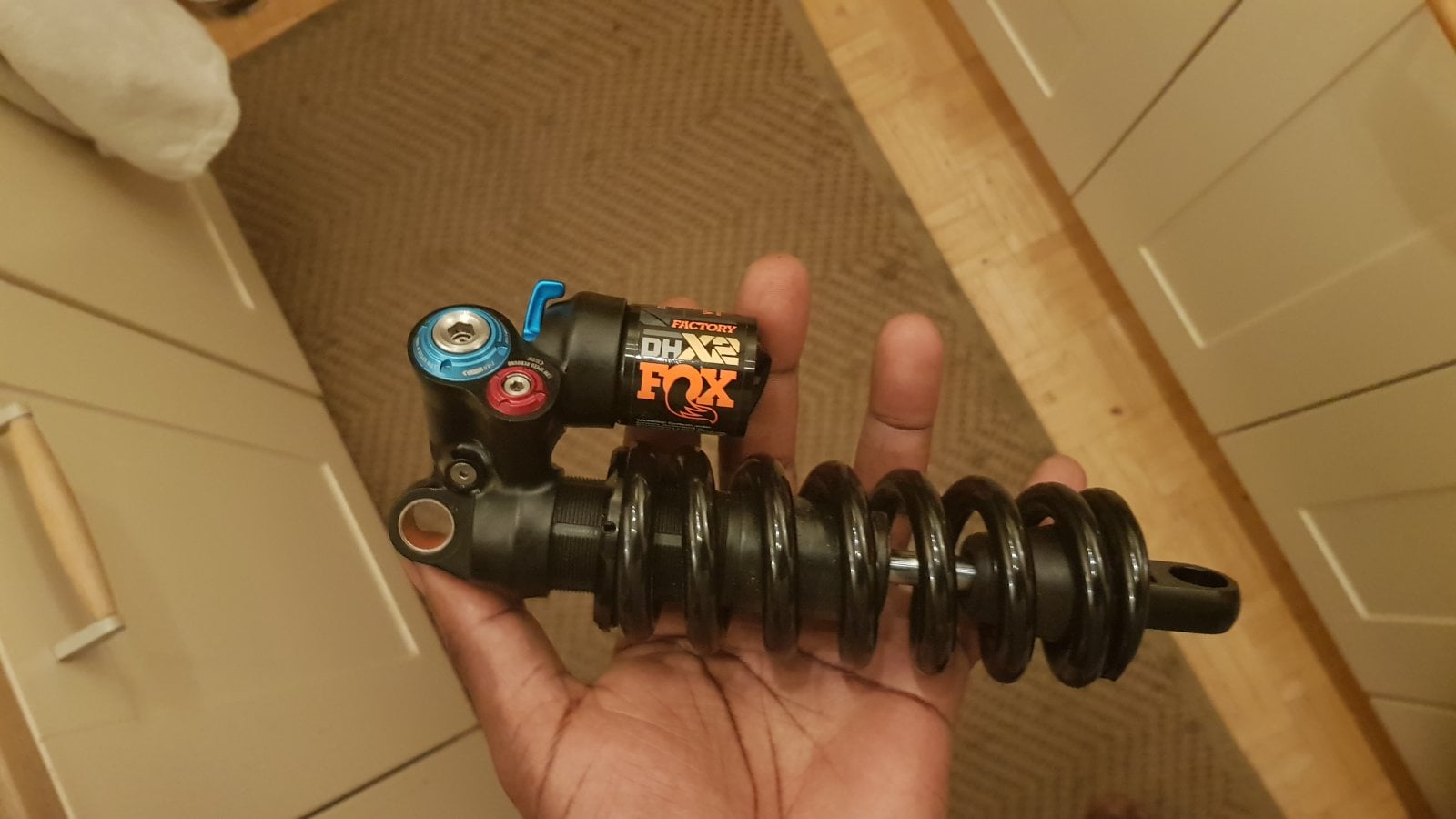

Re. the shock, I do like the idea of the 210-60 that Neeko is running, but, based only on the videos he posts alone, it is hard to know if his E10 has seen some serious downhill action.
Apologies, Neeko, if I falsely jumped to conclusions... 🙈🙃
Neeko DeVinchi
Dec 31, 2020
1,042
1,387
It's cool @Snotgobbler 😅
Truth be told, my E10 has been at FOD on a few occasions. And hasn't skipped a beat or caused issues.
But I will stipulate what I said in my video, "your decision to over-stroke the bike WILL void the warranty".
My second E10 (E10v2), will run a conventional 210x55
This shock basically 👍🏿
