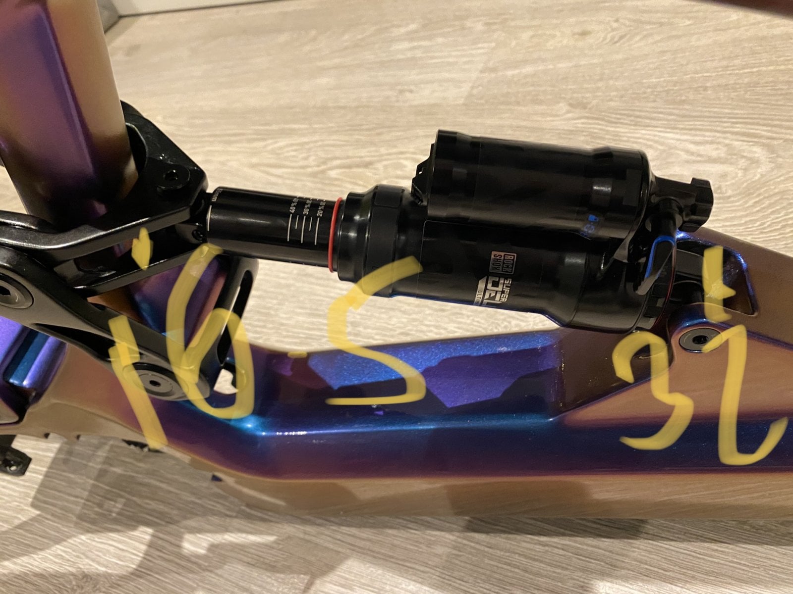

I received my Fox Float Evol rear shock. It comes with the two mounting holes axes in parallel. On the E10 frame they should be perpendicular to each other. How do you make the rotation ? shall I just force a bit on it ?

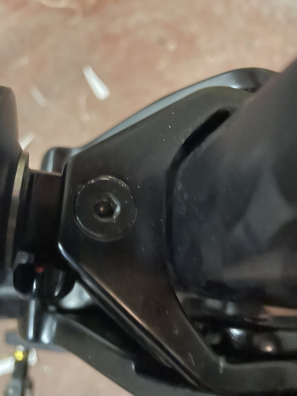

I checked the previous threads, just need to material off 2-3mm of the hinge for installing 216x63mm shock
please advise if any other issue need to pay attention ?

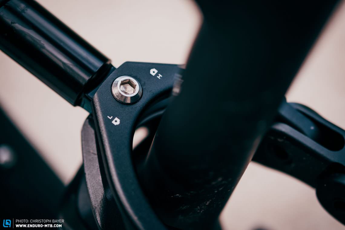

thaeber
Jan 26, 2021
888
769
Bruchsal, Germany
thanks!
No thats all. You only have to rework the upper part (see picture) of the yoke, the lower part doesnt need any rework, no contact to the seattube with 216 mm shock.
