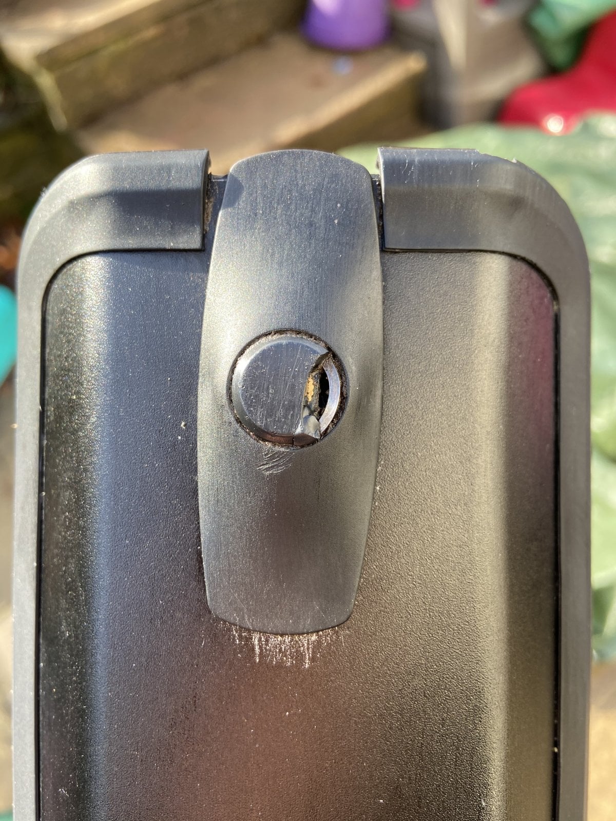

Any ideas on this ? Think decathlon will sort me with a new battery cover ? This will be dead in a few days :(
