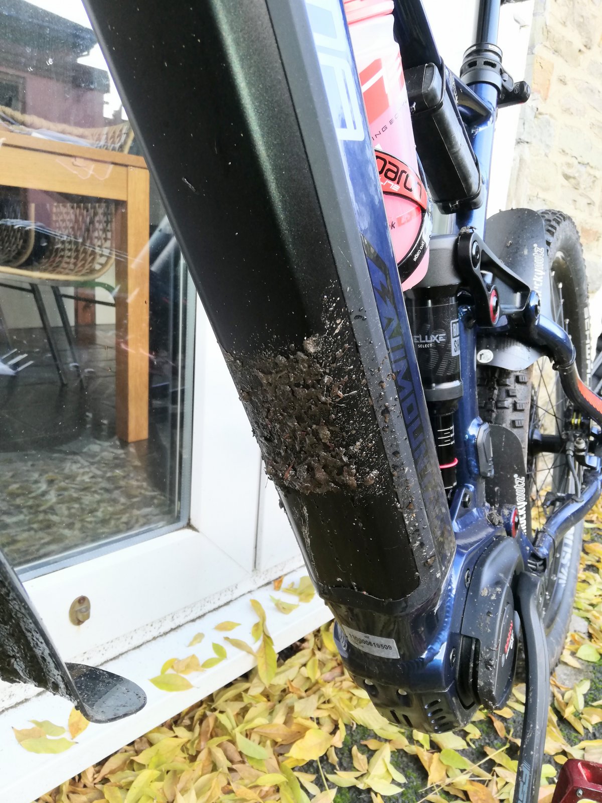

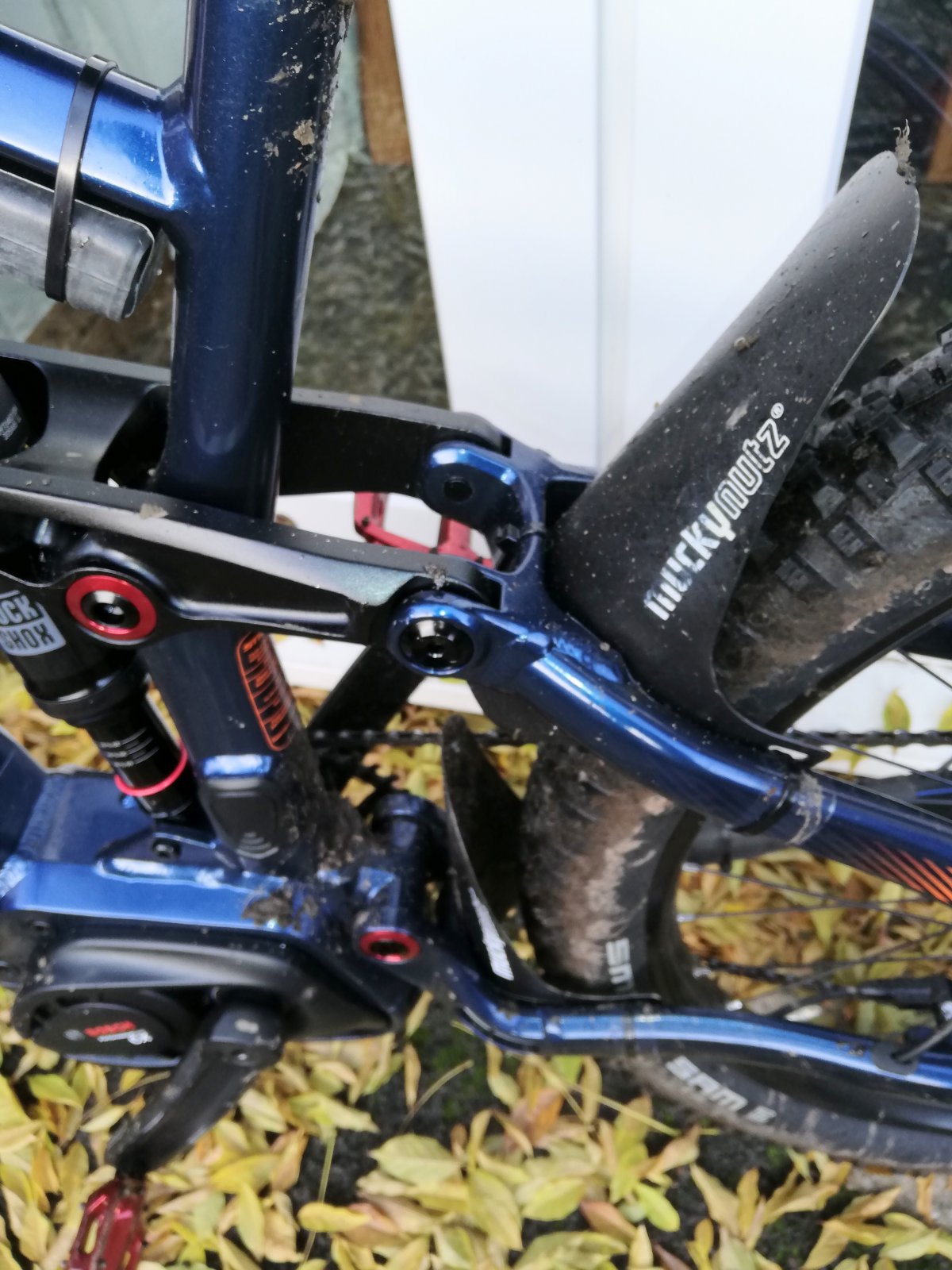

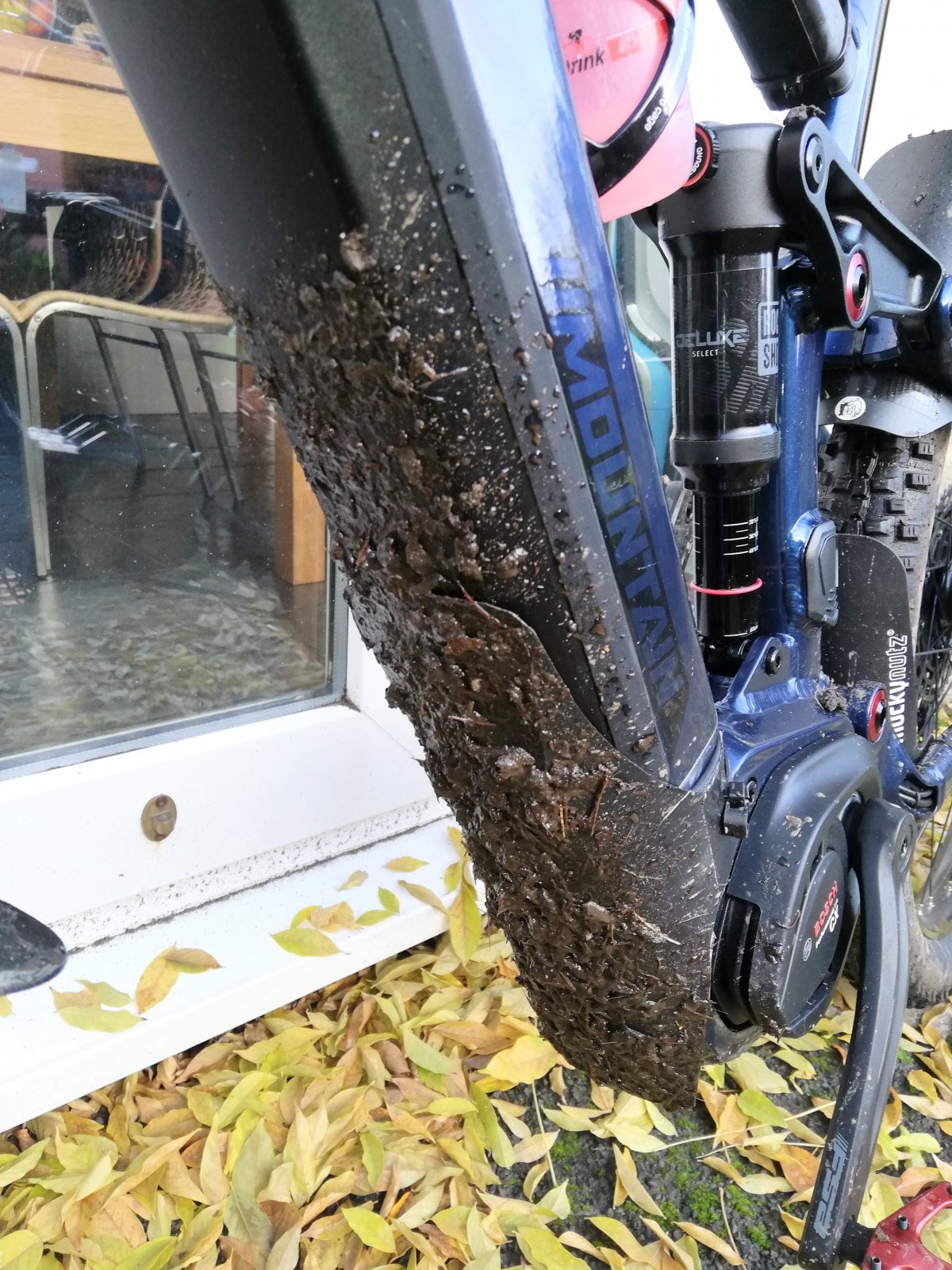

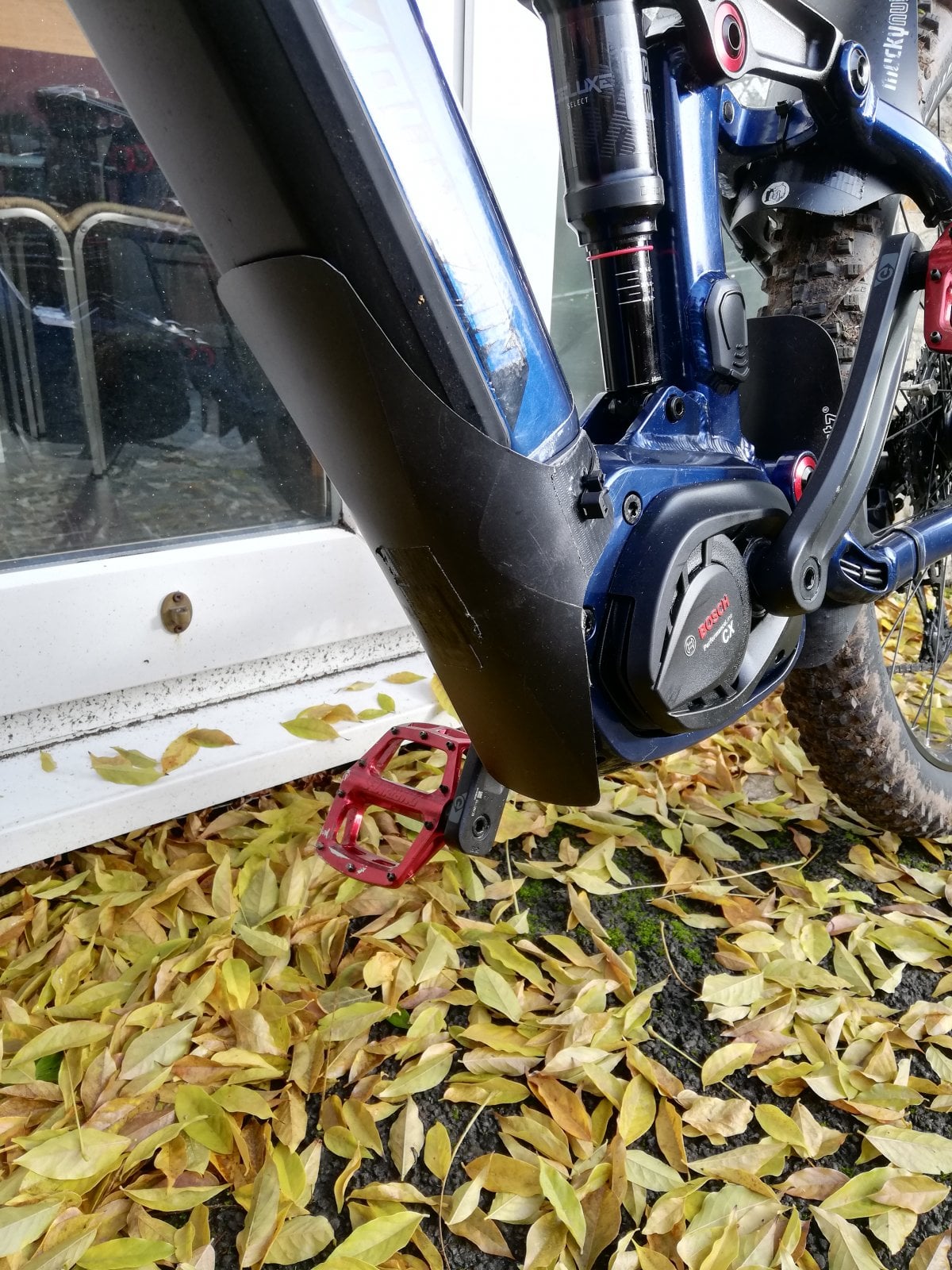

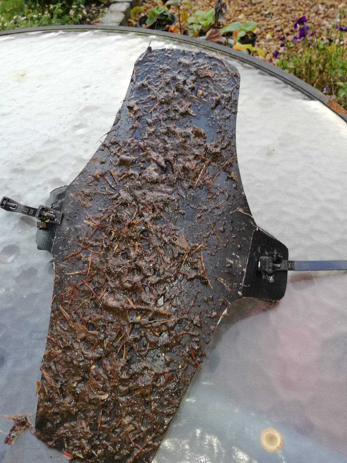

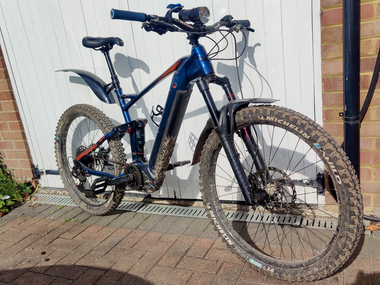

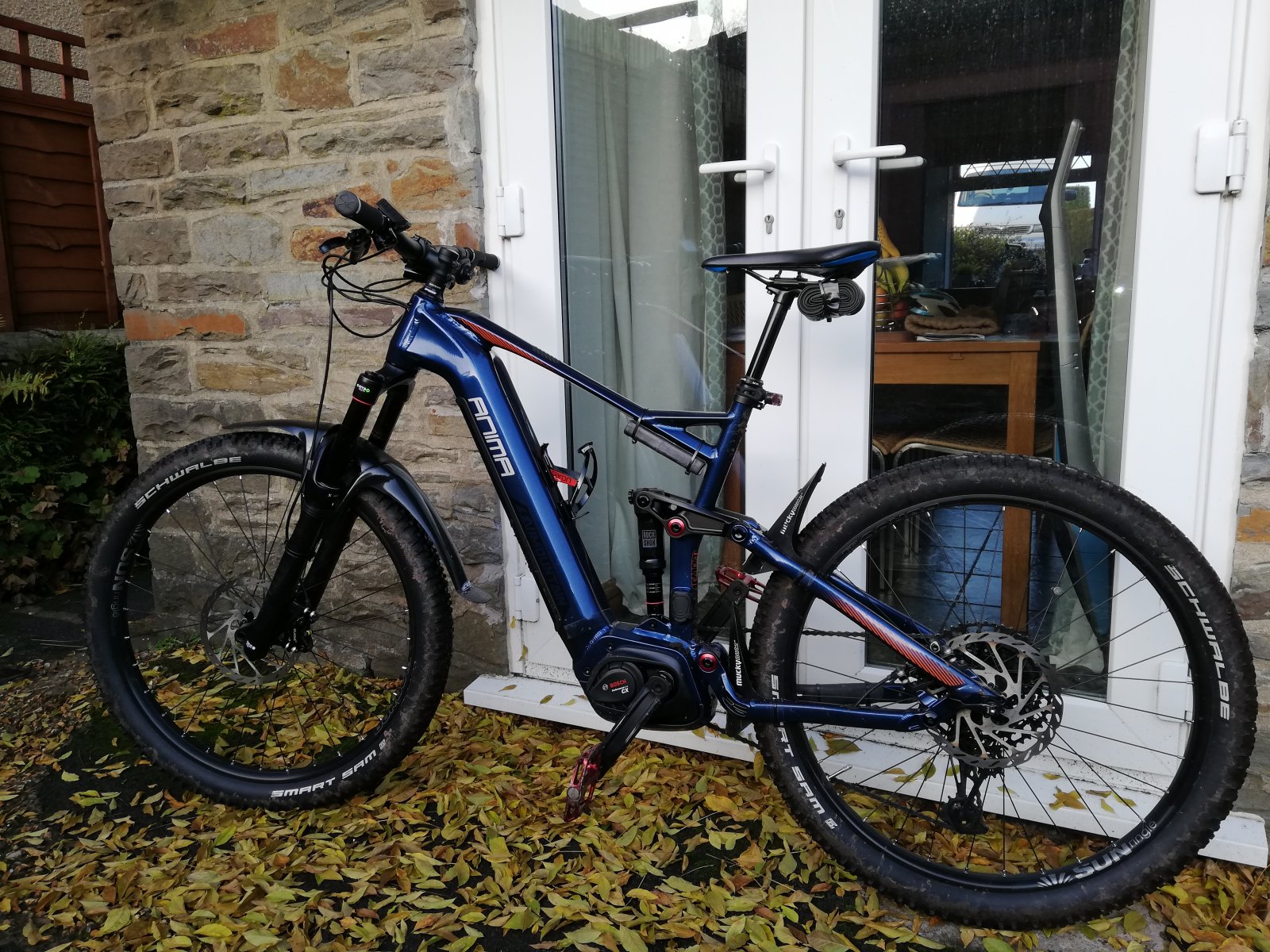

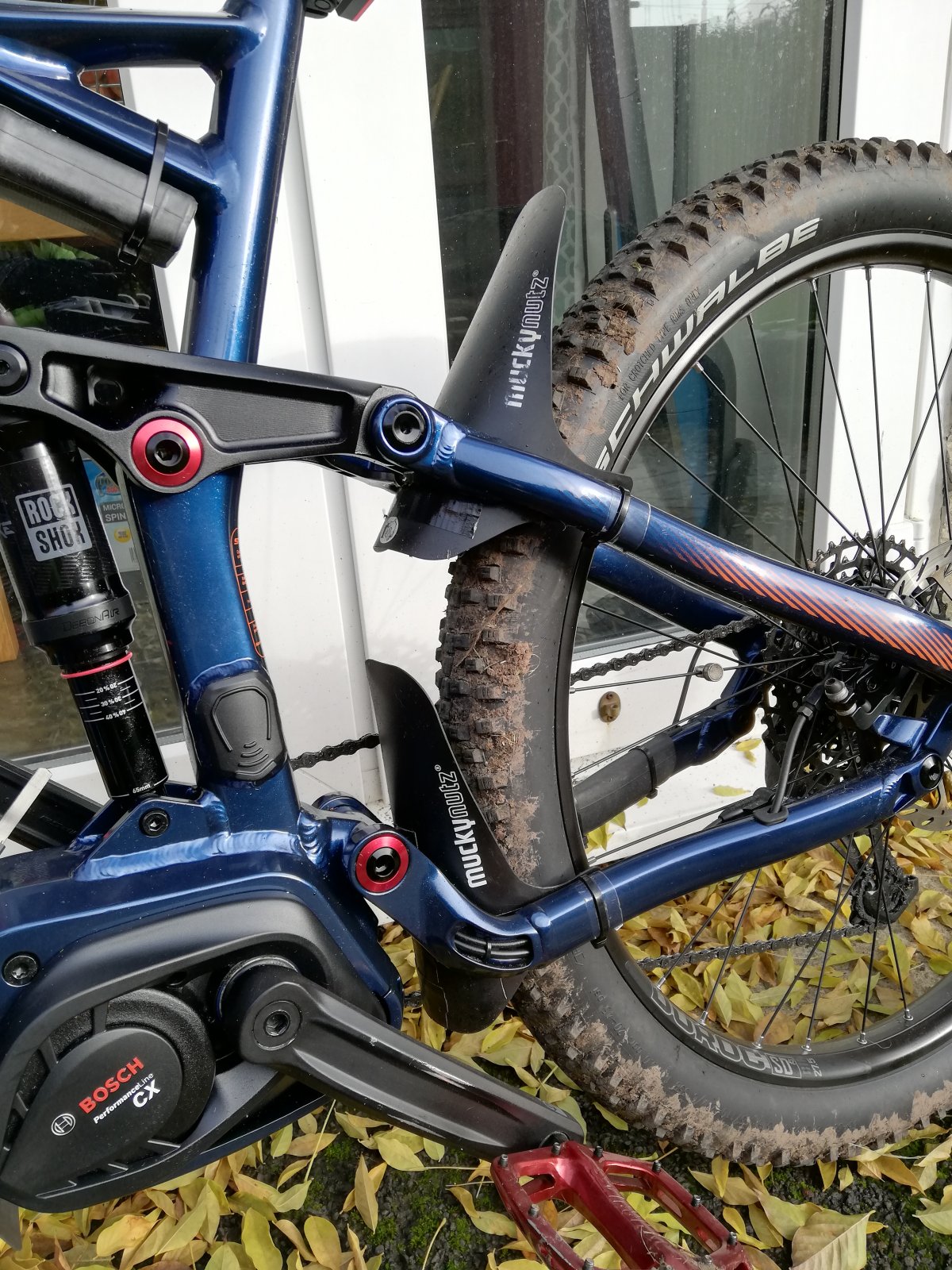

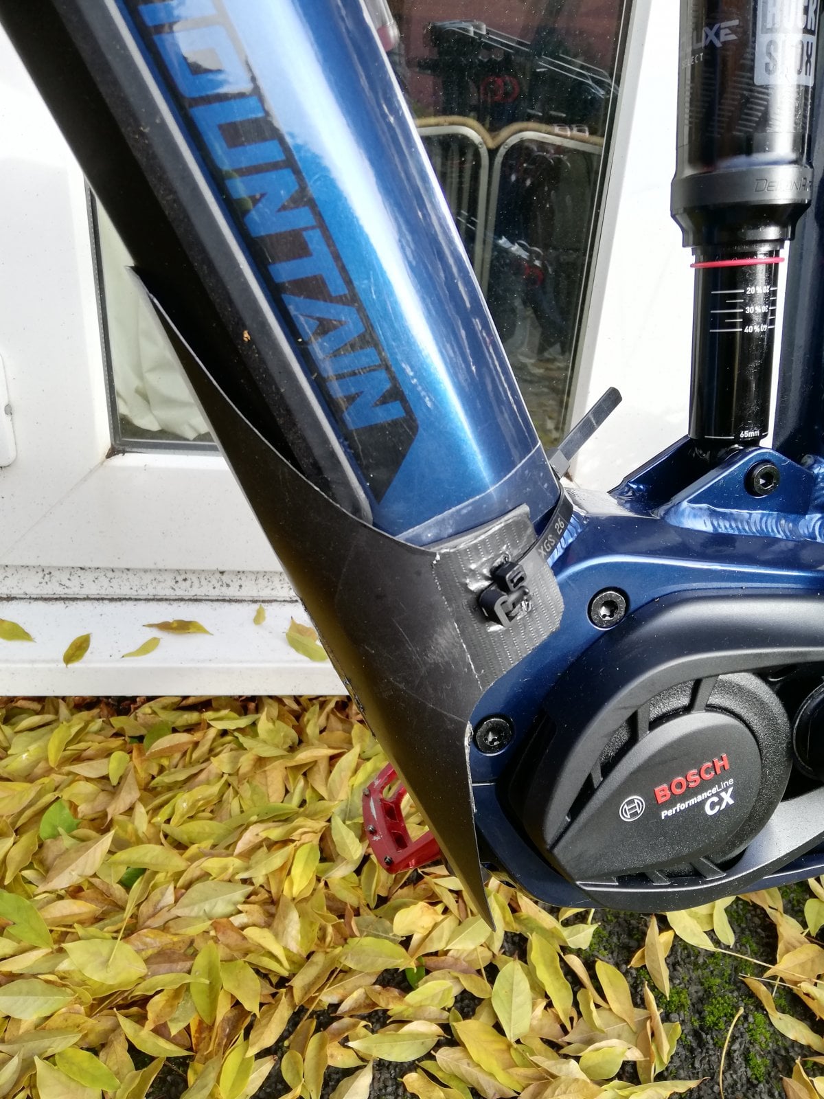

Just an update for keeping the mud off main parts. I have been fiddling about with odds and sods I had laying around and comparing them. I have attached lots of photos of the best mods for mudguards I have come up with and it shows the extent to which it saves the bike and motor. The photos are from a 25 miler in the damp
surfaces and all at between 0 and 20 mph.
I have used a pair of mucky nutz front fenders for rear linkage/motor protection (I don't care about my arse and back!). I didn't like the way others sometimes run ed paintwork and jammed up.

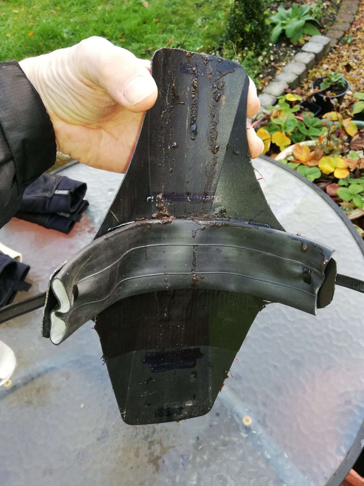

I have the crud catcher XL as stated previously, but the biggest surprise is the adapted £3 Halfords mudguard I have used to protect the lower portion of the batt cover and the front of the motor/bash guard (which used to fill up with crap after being in the direct firing line from the front wheel)
I used inner tube to protect the paintwork and reusable zip ties for removal.
I think all the add ons still don't make the bike ugly as with some mudguards and also the knowledge that the battery and connections are safe and dry is very reassuring. Btw, the guard does not make the motor overheat as its not close fitting to the vents and is only used in lower temps anyway.
View attachment 45963 View attachment 45965 View attachment 45966 View attachment 45967 View attachment 45969 View attachment 45970 View attachment 45971 View attachment 45972 View attachment 45963 y

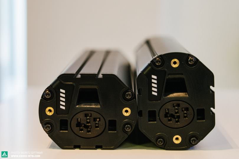

I fancy the 625 battery for the extra range as i am empty after 20-22 miles on my normal terrain around home.
i will probably sell the 500 as i cant see me ever carrying a spare with me.
Just to double check ours is the horizontal ?
and its just a quick job to move the spacer down to fit the 500 ?
and tips on where to find one at a good price ?
thanks
Roger
PhilBaker
May 6, 2020
333
411
East London/Kent
Hey Roger,
I brought one on here 2 days ago :D.
So o they do come up on here. There is one selling on Amazon for a really good price. I was looking at one on Amazon Wednesday for £560 which was a great price but can't find it now so must have been sold although there is one for £667 still on there.
Yes you need the Horizontal version, the product code needs to end in "543" for it to be the Horizontal one ;). They are really easy to tell apart when you know what your looking for, you want the one pictured on the left:
To fit to the Stilus, you take the old battery out and then one of the brackets that holds the battery can be loosened and turned around the other way so it allows the extra room required to fit the 625W battery.
I've not fitted it yet, but its an easy job apparently, and then you should get around 25% more capacity.

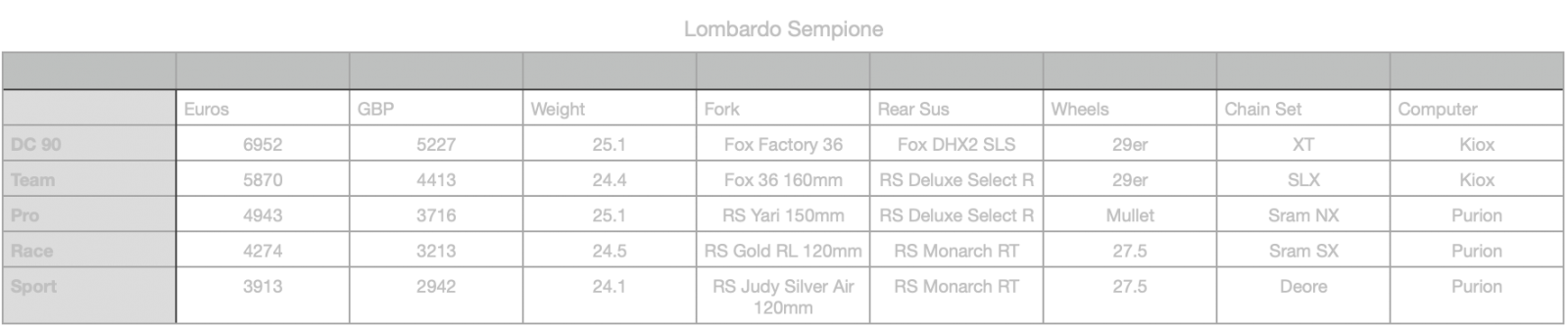

Having a bit of time on my hands I decided to have a look at what the next iteration of the magnificent Stylus might be.
We know that they are made by Lombardo and with a bit of tinterwebery I have come up with the following info. I used a conversion of £1:33 to the euro but who knows where we will be in a few weeks time and I have also used a average retail price. As we all know there can be a larger variance in just how much profit a shop wants / needs to make.
All the bikes run a Bosch Gen 4 in a frame that looks the same as the current model but some of the listed weights do vary. All bar the Sport use a 625 battery which weigh heavier that the current 500 so there has been some weight saving somewhere as they are still alloy construction. Here are just the headlines:
so is it could be like this ? Or are these old models ...
