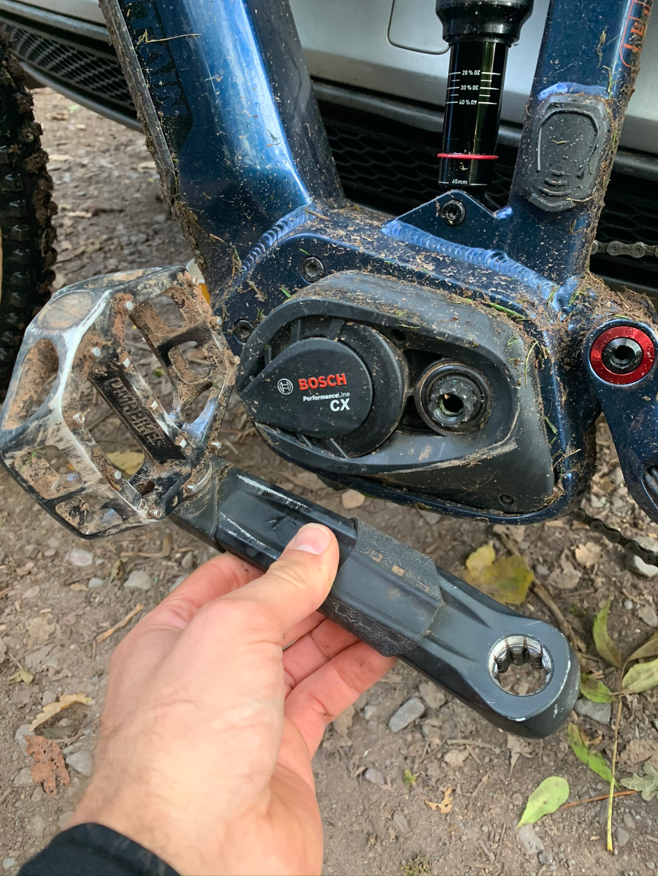

A quick message to say it might be worth checking the torque on your Stilus crank-arm bolts. My left-hand one fell out 10 miles into a ride on the Quantock hills on Sunday and I had to walk back to the car without a crank arm fitted. I took a more direct route back and rolled down the hills, but it still wasn't fun. I've bought a couple of bolts now and will keep one on me as a spare, but it's worth 30 seconds of your time to check the bolts before your next ride to save a grumpy trudge back to the car/home :LOL:

Yes we had the same issue on a ride. Do check them before riding out of the box, as well as all other bolts.
It's an 8mm Bolt. Same as pedals.

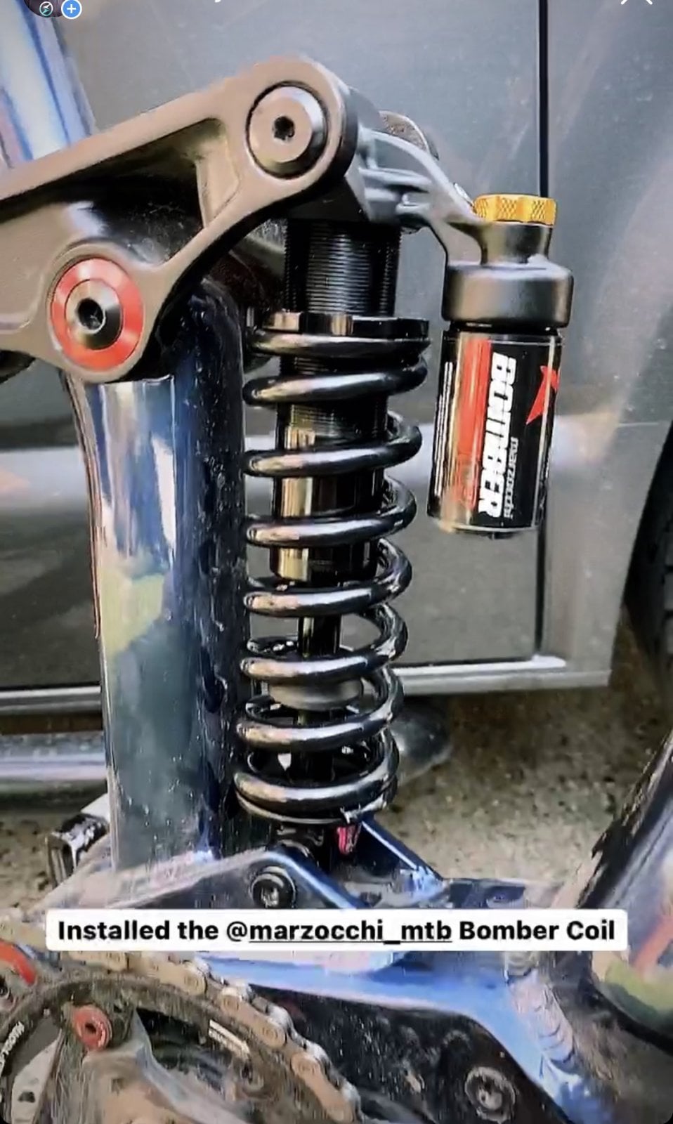

Might try a coil on it if I can find one!
Hi Rob, if you ever change your shock could you let me know how the alignment is? I fitted a new Fox shock today and the fixings don’t totally line up I have to pull the trunnion end over one side by around 1.5 -2mm to get it to fit in the Horst link..not ideal obviously...just wondered if I’m the unlucky one with badly aligned mounts.

Sure. Will do.
which shock did you get?

Just so you know, the way I found out my figment was out was to leave the eyelet bolt tight but remove the trunnion fixing bolts, swing the shock out obviously forwards and see if it sits in the middle of the link ?
I got round to checking my crank bolts last night & sure enough, both were loose. The non drive side not even finger tight. Seems to be a common thing with these from the factory.
