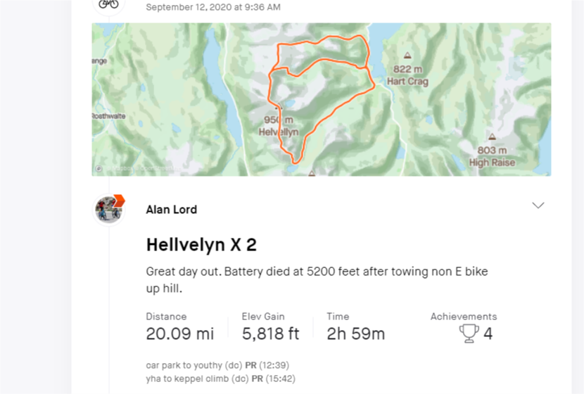

Tested battery to empty on Saturday about 17 miles and 5200 ft of climbing and towing a non e bike up lower slopes of hellvelyn twice, it was a hard push to reach the summit with no battery, but the rest of ride was manageable from summit back to Glenridding. battery would probably have completed full loop without the Towing.

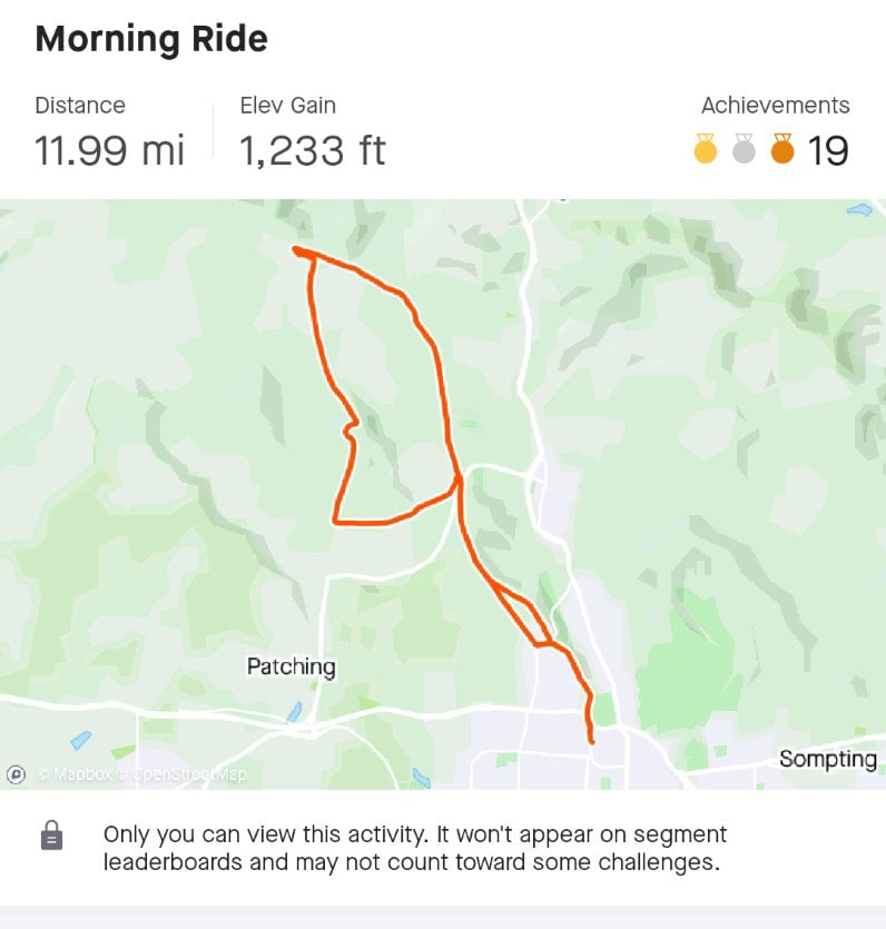

Anyone else getting iffy range? This burnt three bars this morning in emtb which seems on the low side?
Checked mine this morning after a full charge, my range usually starts off around these figures:
Eco: 51miles
Tour: 38miles
eMTB: 32miles
Turbo: 24miles
They’re only estimates as it goes off how hard you were pedalling at the end of your last ride.
I’d say yours does look a bit low for 12 miles in eMTB but because eMTB is dynamic I think it depends how hard you were pushing. If I put mine in Turbo when going up a steep incline the range immediately drops quite significantly but then slowly starts to go back up a bit again when you’re back on the flat and back into Eco.
I generally get about 30 miles out of mine with a mix of all modes and about 2,000ft elevation but again it depends how much effort you’re putting in.
I think people have got about 60miles out of theirs using a mixture of Eco and Tour but mainly Eco. I also saw someone said they got 30miles out of theirs mainly in Turbo but I think that’s unlikely.
I’ve done 12 miles so far today with about 1,000ft elevation mainly in Eco with a bit of eMTB/Turbo thrown in for good measure and my current estimates range is:
Eco: 30miles
Tour: 19miles
eMTB: 16miles
Turbo: 14miles
The battery indicator is still on 4 bars.
I’m expecting them to go back up a bit because I’ve just been up a couple of hills in eMTB mode.
I’ve started to take the range with a pinch of salt and using the bars as more of an indicator.
I’d say yours does look low but if you were pushing hard in eMTB it would be possible. If you still had two bars left then you could probably get another 10 miles out of it which would make the 22 miles in Turbo mode about right.
I was concerned that I wasn’t getting as much range as some people but I’ve just put it down to terrain and effort now.

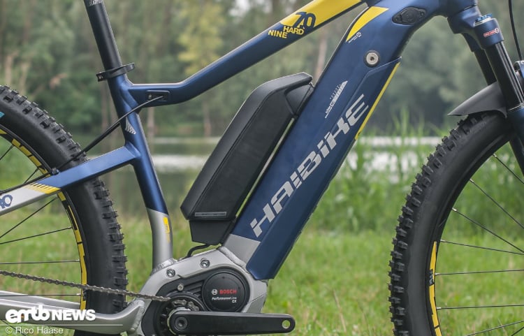

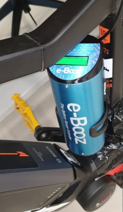

Has any one tried bolting a range extender battery on a Stilus yet??Is it just a case of fixing an extra battery to water mounting bolts and plugging in through charging port. Or is that far to simple and we need to have pages and pages of electrical language to explain why it will not work..LOL
McNasty
Jul 17, 2020
37
69
Manchester
I’m not sure the Bosch range extender will fit because of the rear shock, it’s hard to tell from the picture, would be a very tight squeeze and some extra weight. The bottle cage is also mounted quite high on the Stilus which might cause a problem for other brand range extenders.
edit: In fact looking again (albeit with a few beers and some sunshine inside me ?) I think it would fit. Would be a bit daft if it didn’t and it’s got the Bosch motor. I’ll have to look for a price and the weight. I didn’t even think about a range extender so thanks for the heads up. ??

Recharged & did 15 with 1100 in emtb & used two bars tonight, so I reckon unscientifically yesterday's ride started off with just over three bars & I'm flapping over nothing much. Nice evening though.
That’s pretty much the conclusion I came to when I thought I didn’t have as much range as everyone else. It’s unnerving when it starts dropping and you’re pretty far from home, then you start heading home and the range slowly starts climbing again and you get home and there’s still 10 miles in the tank. I need to run in completely flat sometime and really see how far it will go.
That e Booz should fit in easily enough..They go up 372 wh but currently out of stock..
