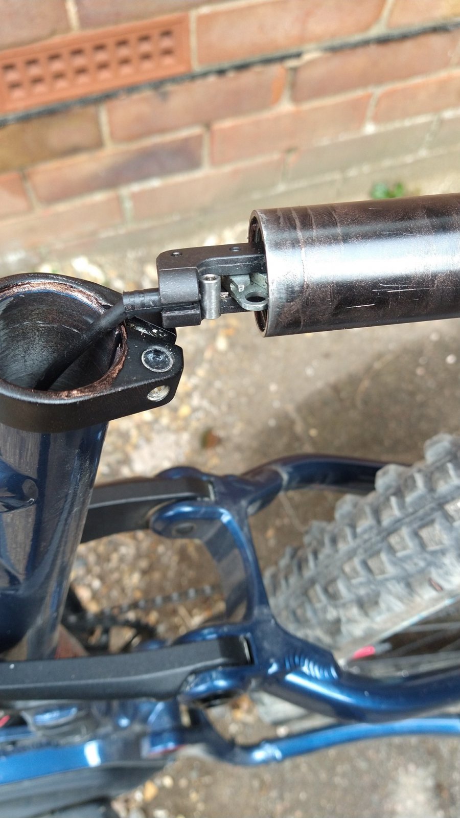

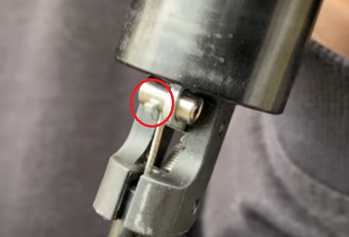

Got to the bottom of my dropper problem. The post is a cable actuated KS Rage. The actual cartridge actuation depends on a tiny steel ferrule whch is cradled in the actuator on the post. A small bit of the cradle has broken off so the cable ferrule pings off the cradle when you pull the lever.
Anyone know the best way to get hold of Decathlon? This is deffo a warranty defect thing.

Not in the UK it's not. Anyway, for anyone curious, this is the damaged coupler. it's literally a couple of mm of metal that has broken off & is causing the clamp bolt to disconnect. Obvs it's not a Decathlon issue, it's a KS post. Arguably, since the whole kit & caboodle is a rebadged Lombardo & a bunch of 3rd party components, Decathlon can claim 100% reliability. ?

Mine broke at same point around 5 months ago, luckily LBS had the part in stock and replaced same day, but after a further month of use the actual mounting for cable broke. So i just replaced with brand X..

I retrofitted a Brand x to another bike & agree it's a decent dropper. I'll see what Jungle say before jumping one way or another. Fwiw, I also have a KS Lev on my third bike & it's been faultless for years. The end of the coupler is clearly a stress point on a thin piece of metal. My guess is it's a relatively common issue & newer posts have a redesigned part addressing it.
