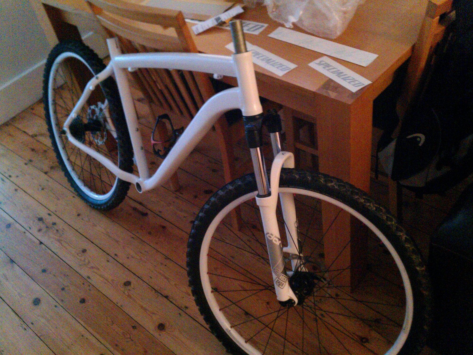

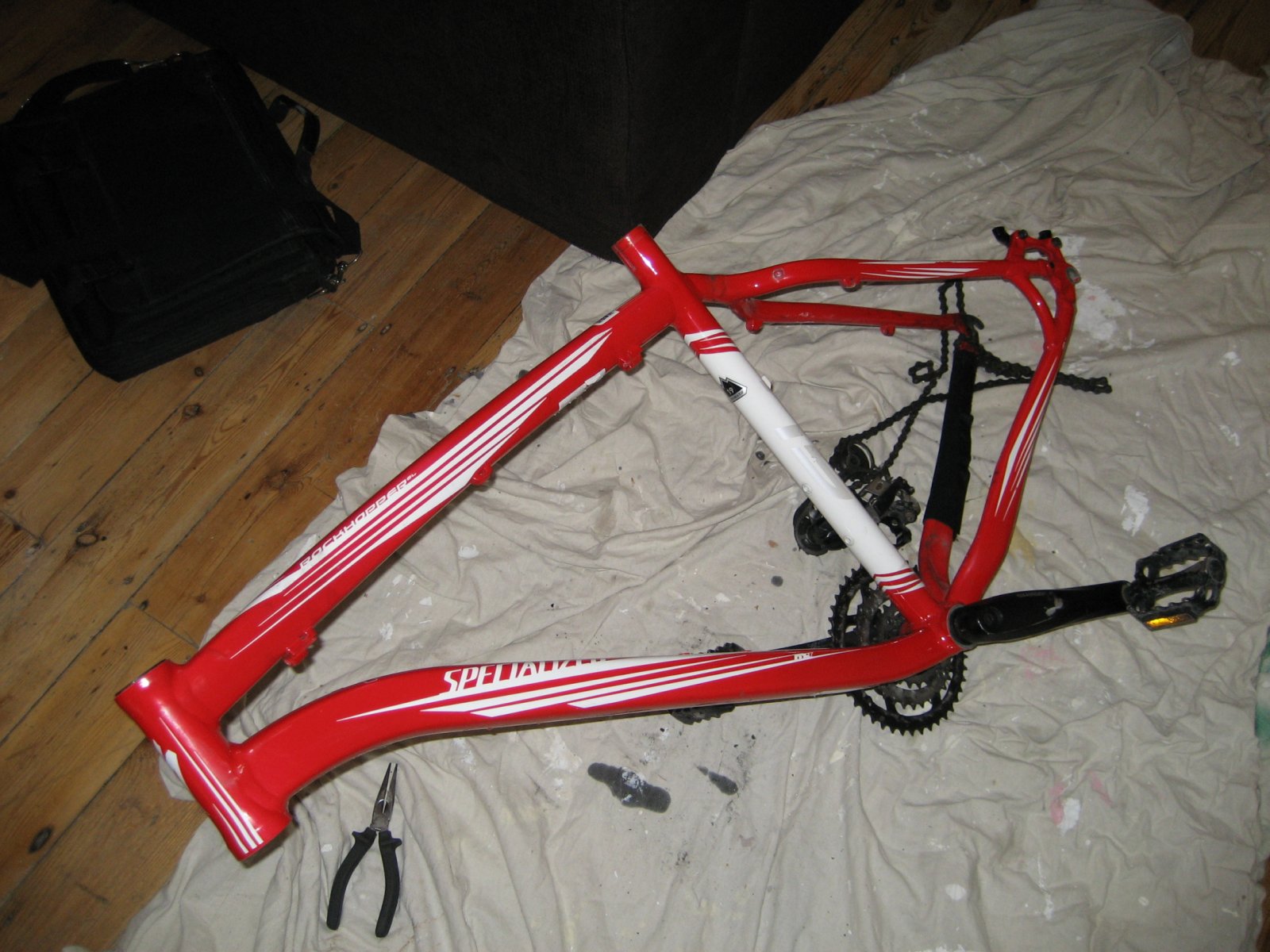

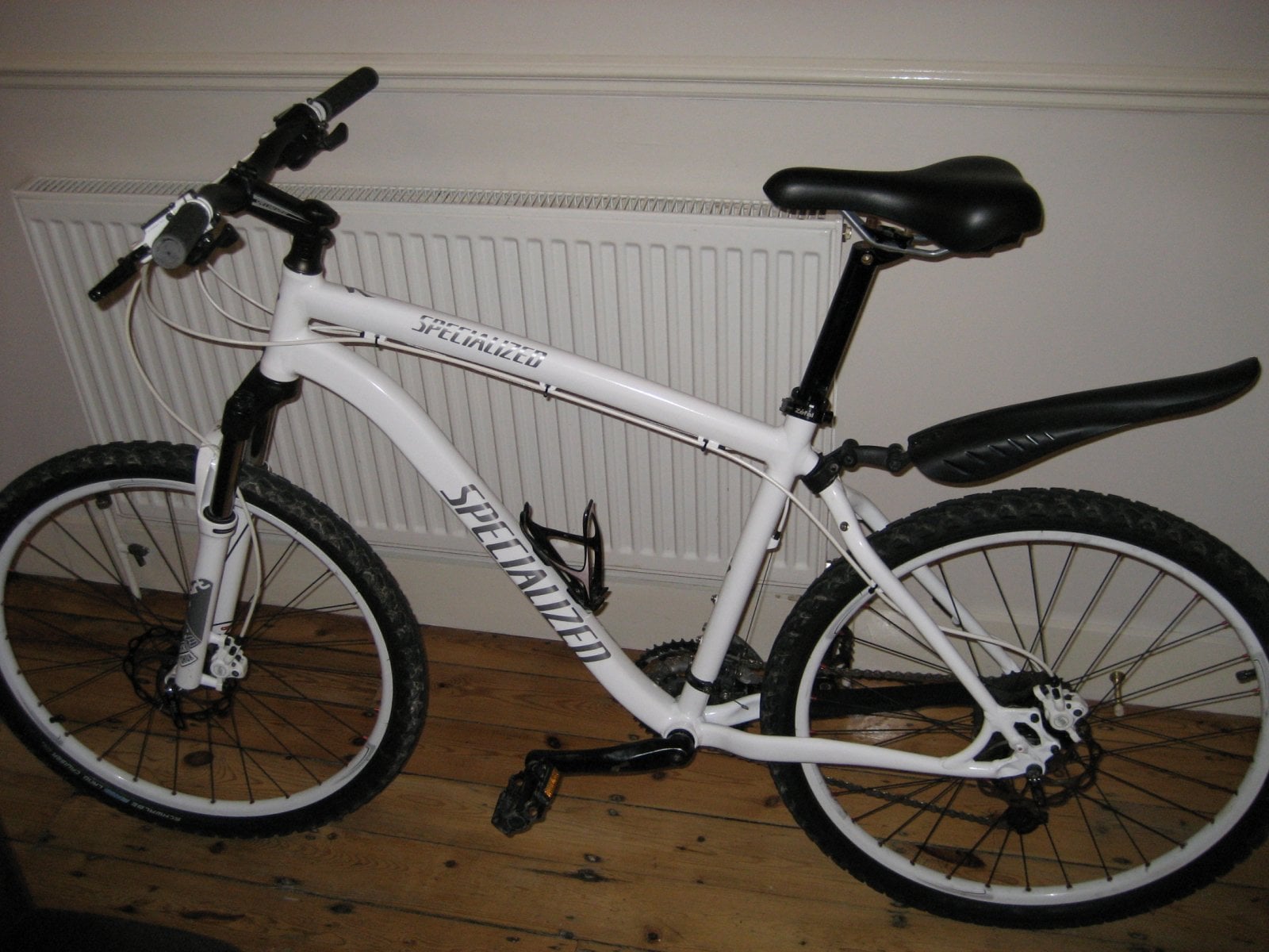

I had a Spesh hardtail powder coated a few years back & it was £50. Not much is the answer, plenty of little places on industrial estates will do this for you, have a ring round.

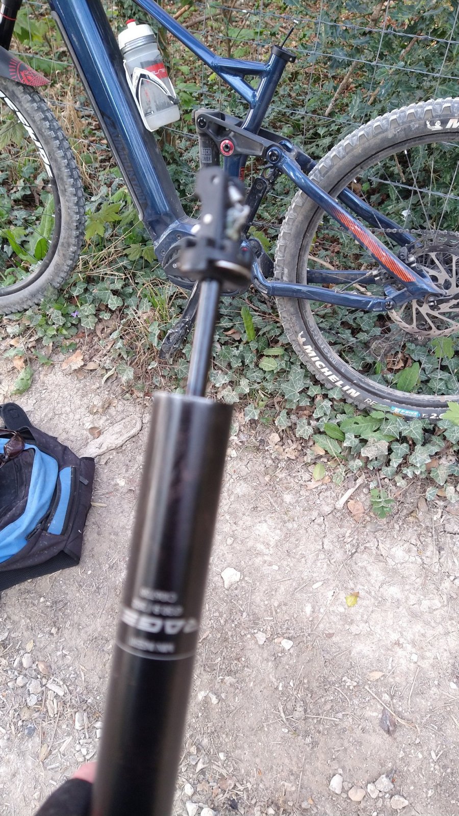

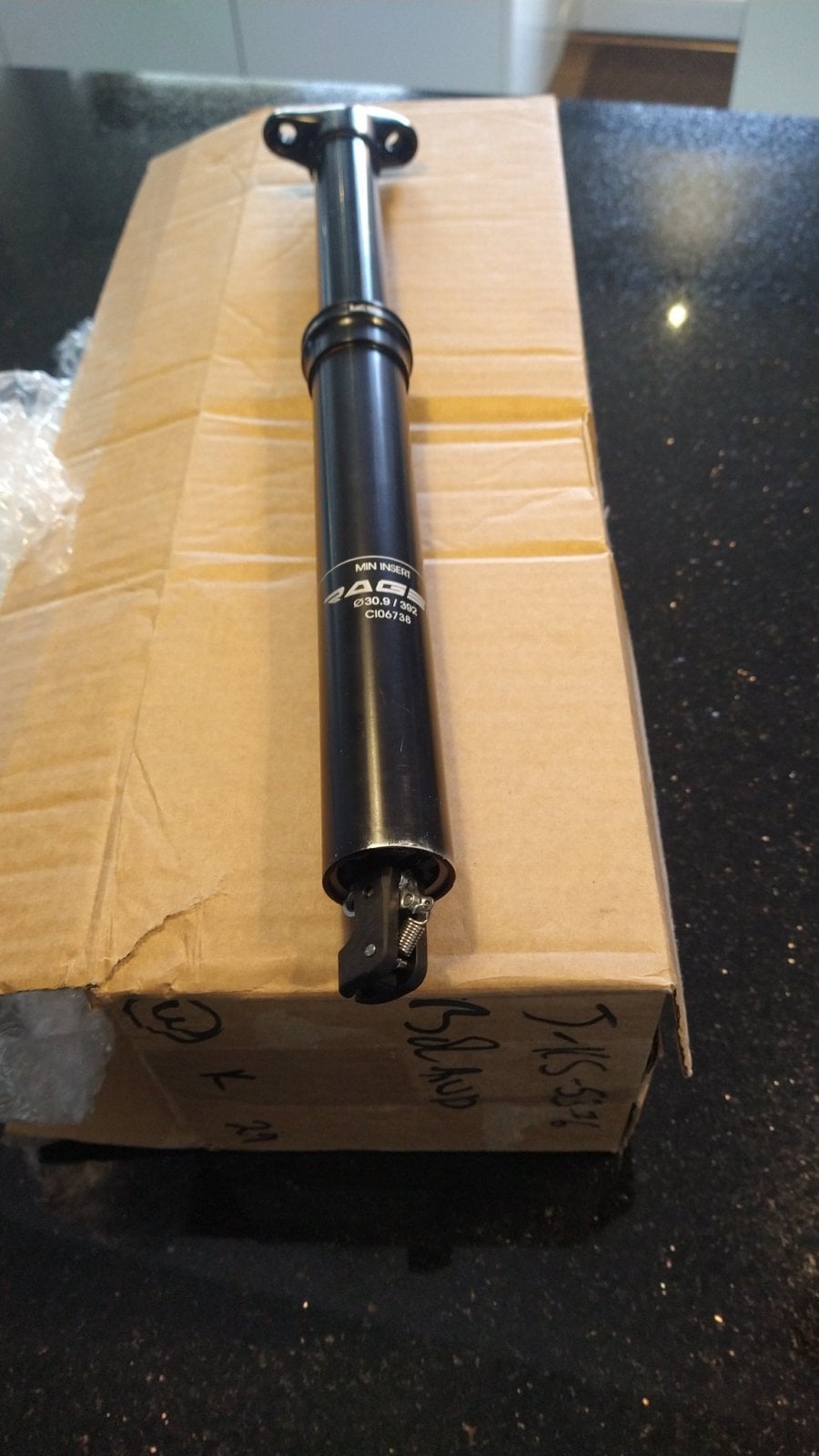

Four or five rides since receiving the post back from Jungle & the circlip that holds the internal assembly to the seat post failed trail side, leaving me with a gangsta BMX style ride home. This ******* seat post.

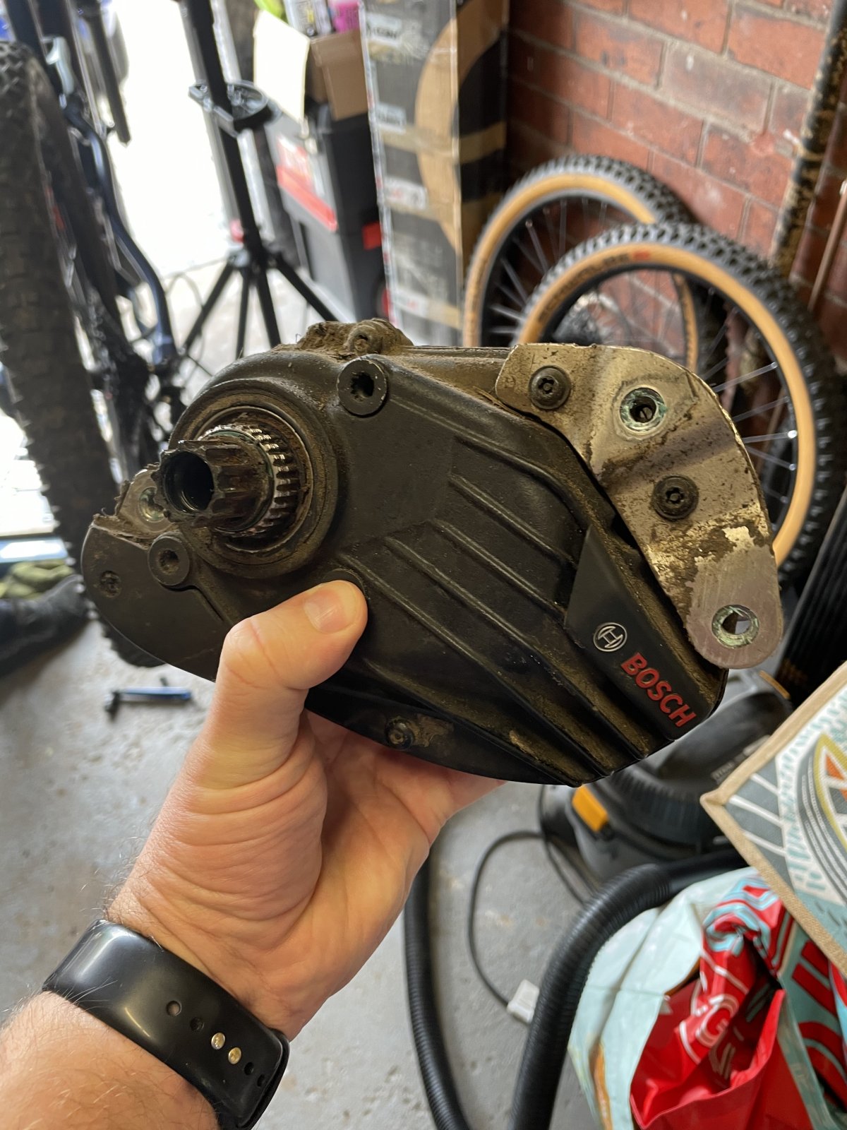

Anybody had to replace the motor via warranty as yet? My Stilus died on Thursday eve, Purion just stopped working and won’t fire up. Changed the display batteries and nothing, got the bash guard and plastic housing off the motor to check for loose wires but all looks fine. Possibly just a Purion failure but my local decathlon haven’t got their Bosch laptops/dongles as yet so still cannot diagnose.

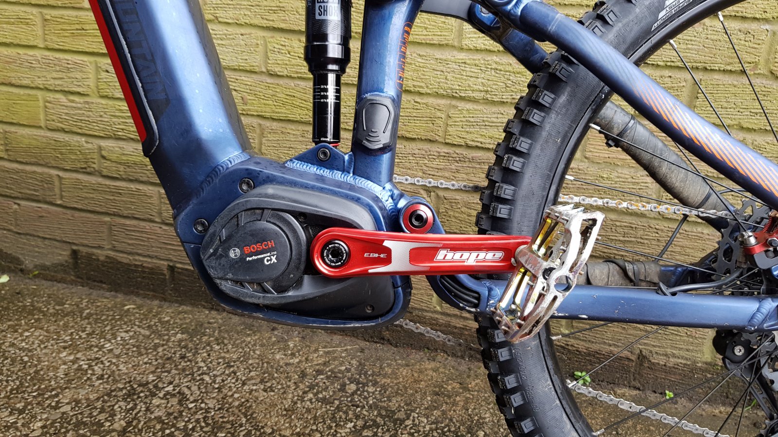

left hand pedal came of last week on downhill section, the thread in crank came out with the pedal!! Replaced with more shiny Hope bling at great expense. PS i got a replacement back wheel of decathlon for £59 see attached pics, first one rim was cracked in various places.wheel was cheaper than the tyre. But i have just noticed the dint in rim looking at the picture:cry::cry: .
As it stands the only original parts on bike are frame, motor, battery, rear shock and stem after 2200 miles.
after 2200 miles.

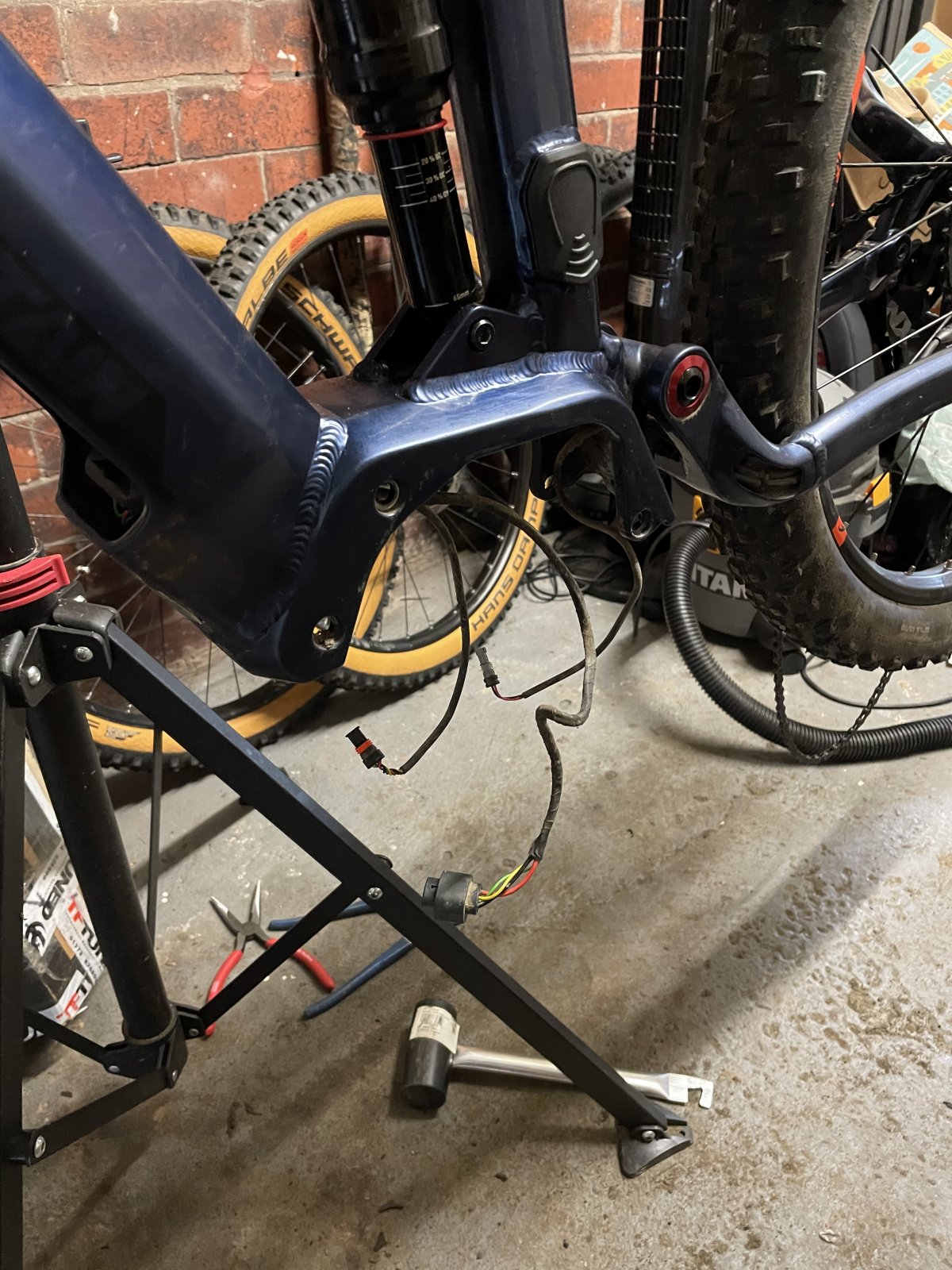

Replacement motor inbound from Bosch and the old one is off back to the service centre. Used a mobile Bosch mechanic to sort in the absence of my local Decathlon having the capability.
update! Replacement motor installed tonight so the old girl is back ??. Bike was down for around 3 weeks in total which isn’t too bad I suppose... We had a bit of faff with the old motor needing to be sent off first before a replacement was dispatched. After couriers (TNT) failed to collect the motor on multiple occasions the mechanic I used kicked off and they sent out the new motor as a priority. A fresh 2 year warranty kicks in as of now, as far as I’m aware.
yet to bill decathlon so will see how that pans out!

yes, motor replaced under warranty. Local decathlon store wasn’t Bosch certified at the time so I used a mobile mechanic to carry out the works.Took around 3 weeks to get sorted but lost a bit of time with couriers not collecting the motor etc. It then took the mechanic a couple of weeks to get paid from decathlon which needed a bit of chasing. Otherwise all fine.

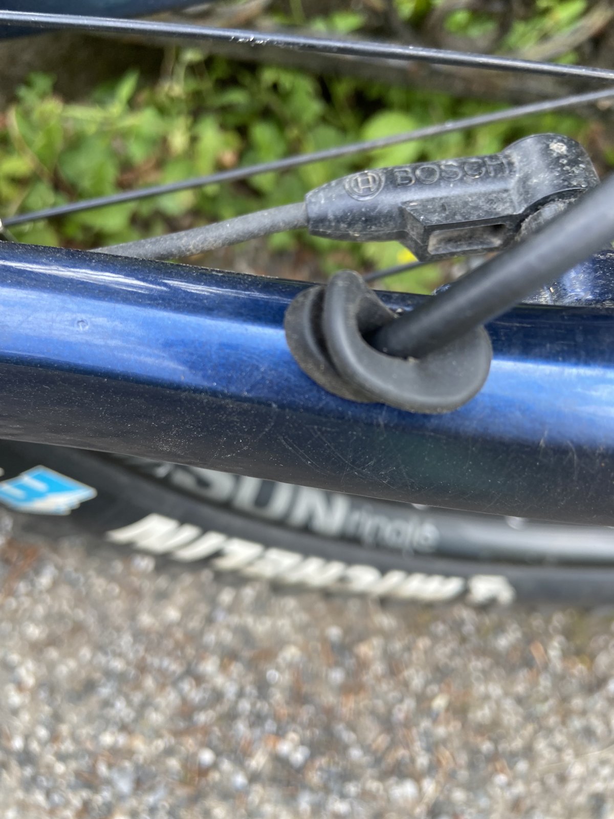

Have you checked your frame bearings out ? Would it be worth swapping them out for better ones ? I’m wondering if ordering a few spares via decathlon is worth while , things like those red bearing covers and the frame rubber cable bung things…
