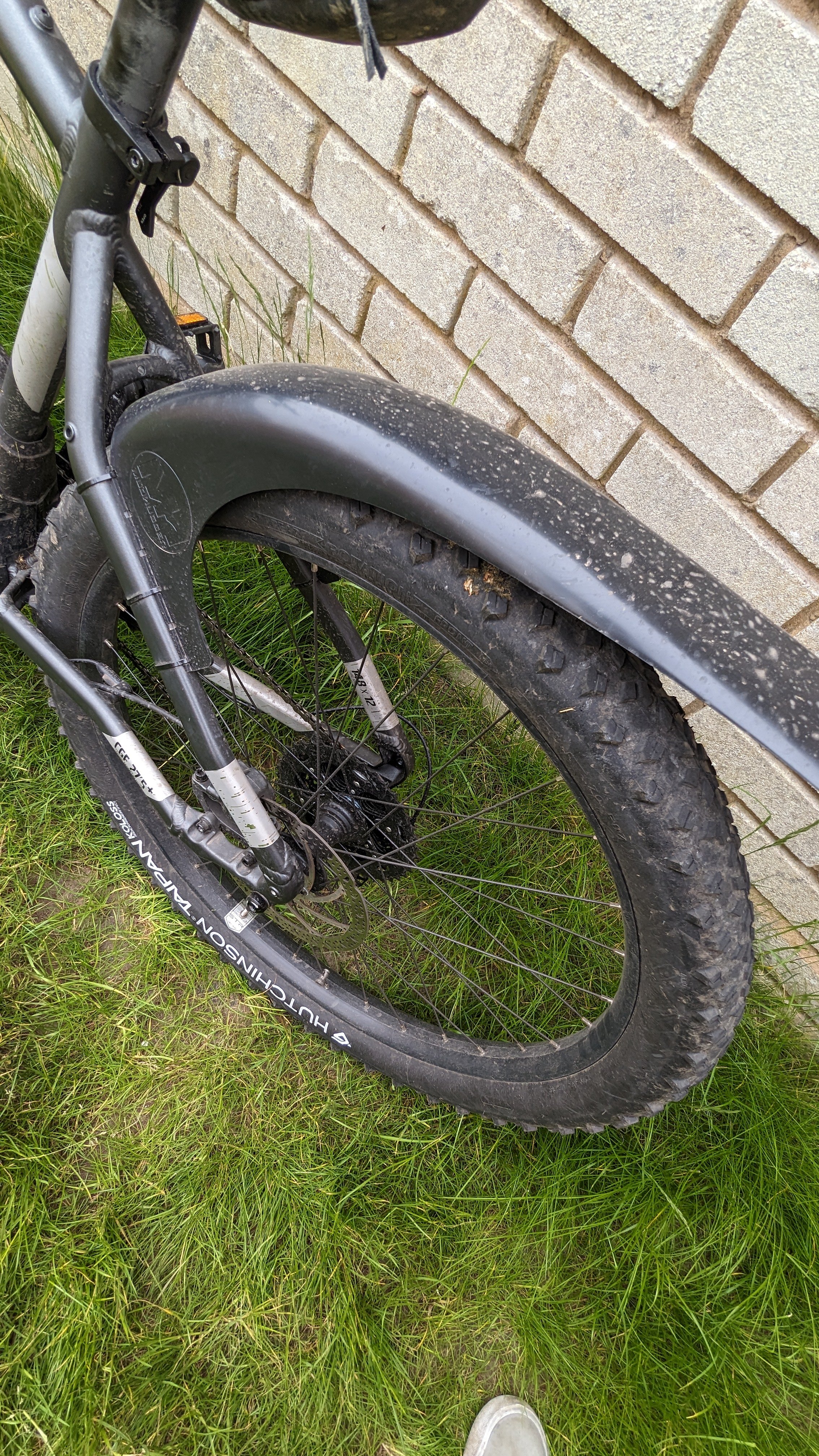

I've seen a few photos here of front mudguards on this bike. How/where do you attach them? The strut between the two suspension tubes which would be the obvious place to mount it, has no mounting holes. I'm very wary to drill holes in there in order to bolt on a mudguard incase it structually weakens a part which I imagine has quite a lot of load placed on it.
RonnieX
Jul 3, 2020
90
77
Northwest
All the ones shown are usually attached with rubber bands hooked around the forks.
I drilled the hole, cut a m6 tread, and mounted the mudguard.
2 years after, it is proven that there was no structurally weakening, the structurally weakening didn't affect the safety margin, or the structurally weakening was not relevant to the applied load.

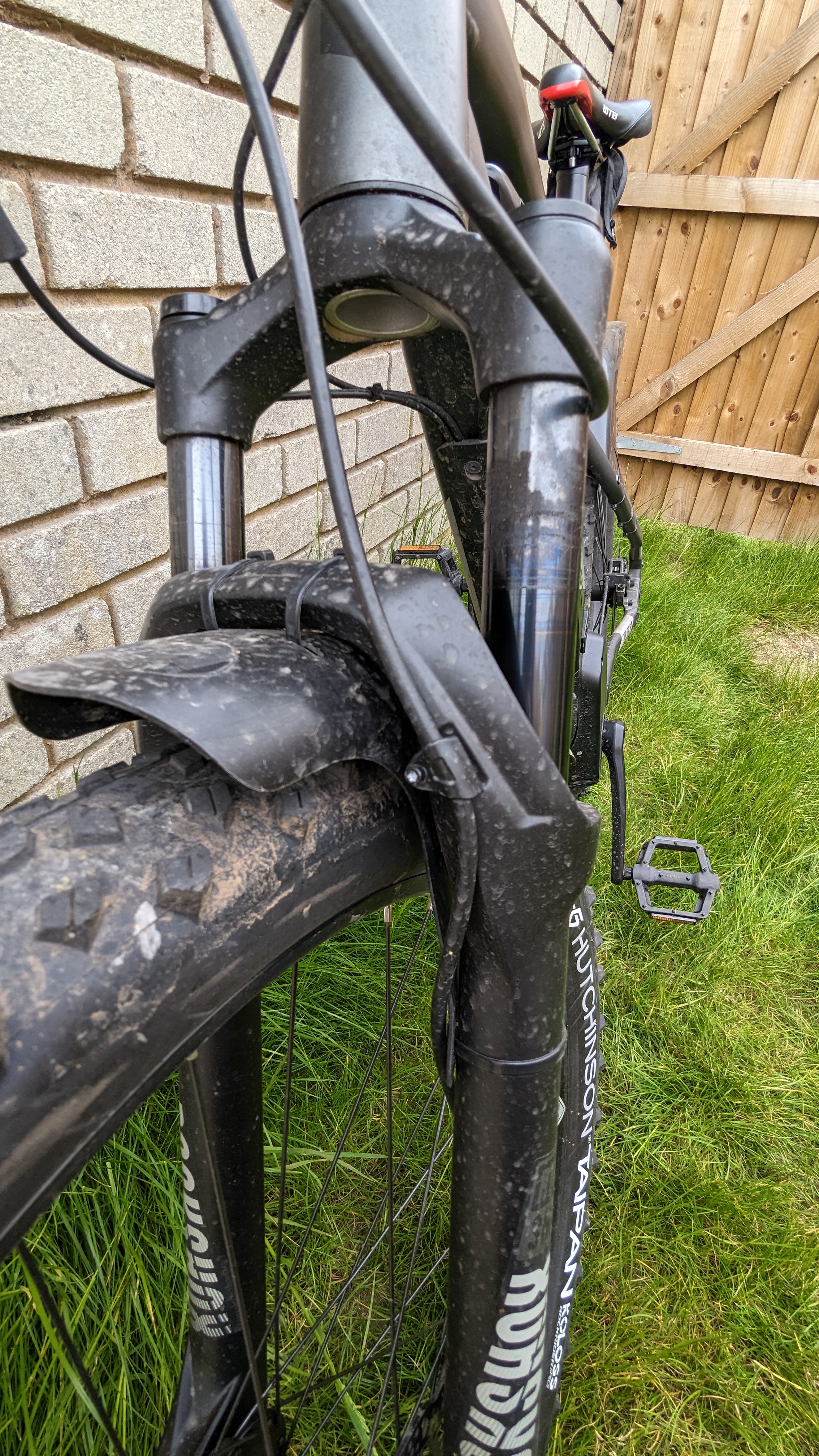

I've got a Mudhugger on the front of mine. Attaches with just black cable ties.
It was originally on my ancient 2012 GT Avalanche. When I got it was the only front guard Mudhugger did so not sure of the equivalent one today. But definitely recommend them.
I also have the standard rear one as well. This also attaches with just cable ties.
Both fit over the stock tyres just fine.
