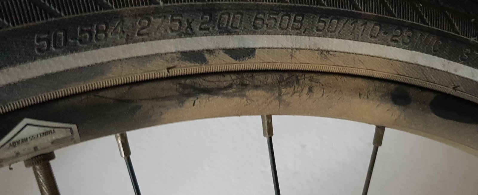

Decathlon Rockrider E-ST900
RonnieX
Jul 3, 2020
90
77
Northwest
BeBiker
Aug 26, 2020
703
426
Belgium
Thanks for the warning !
I will have a look immediately this evening.
On mine it's the least washed spot of the whole bike.
A wipe on both sides of the wheel, but too lazy to clean between the spokes.

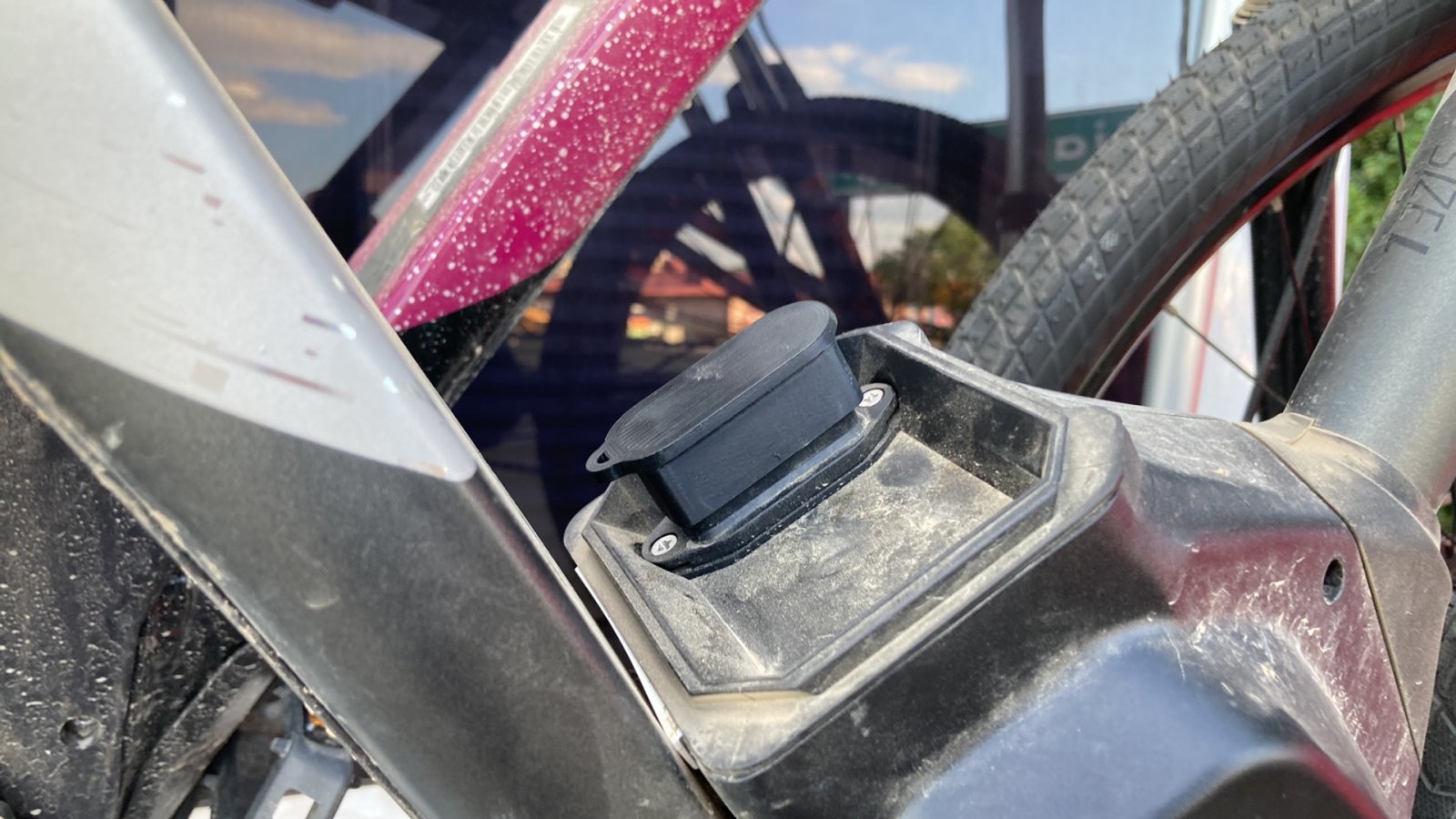

What car mounts are people using for this bike? Thinking of getting a Thule fastride.
hoping it would be OK if the battery is removed. concern is will it fit the axel and how to protect the battery contacts when removed.

I think yes. He can print many this plugs, I Don’t know how much you will spend for delivery (I’m from Poland )
If you are interested I can organise this.

For UK people I've found 3dprint direct will do 2 (min order) for £18 delivered using Carbon SLS

Is this a public STL or one he'd be willing to share? I'd like to print myself a couple. I was only saying to my wife I was going to have design a plug the other day to protect the contacts!

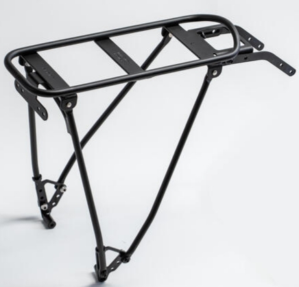

I also added a luggage carrier ( I have seen better looking solutions here in the forum, but that's all I could find ). Despite the Decathlon expert saying it would not fit the e-st900, it does. :)

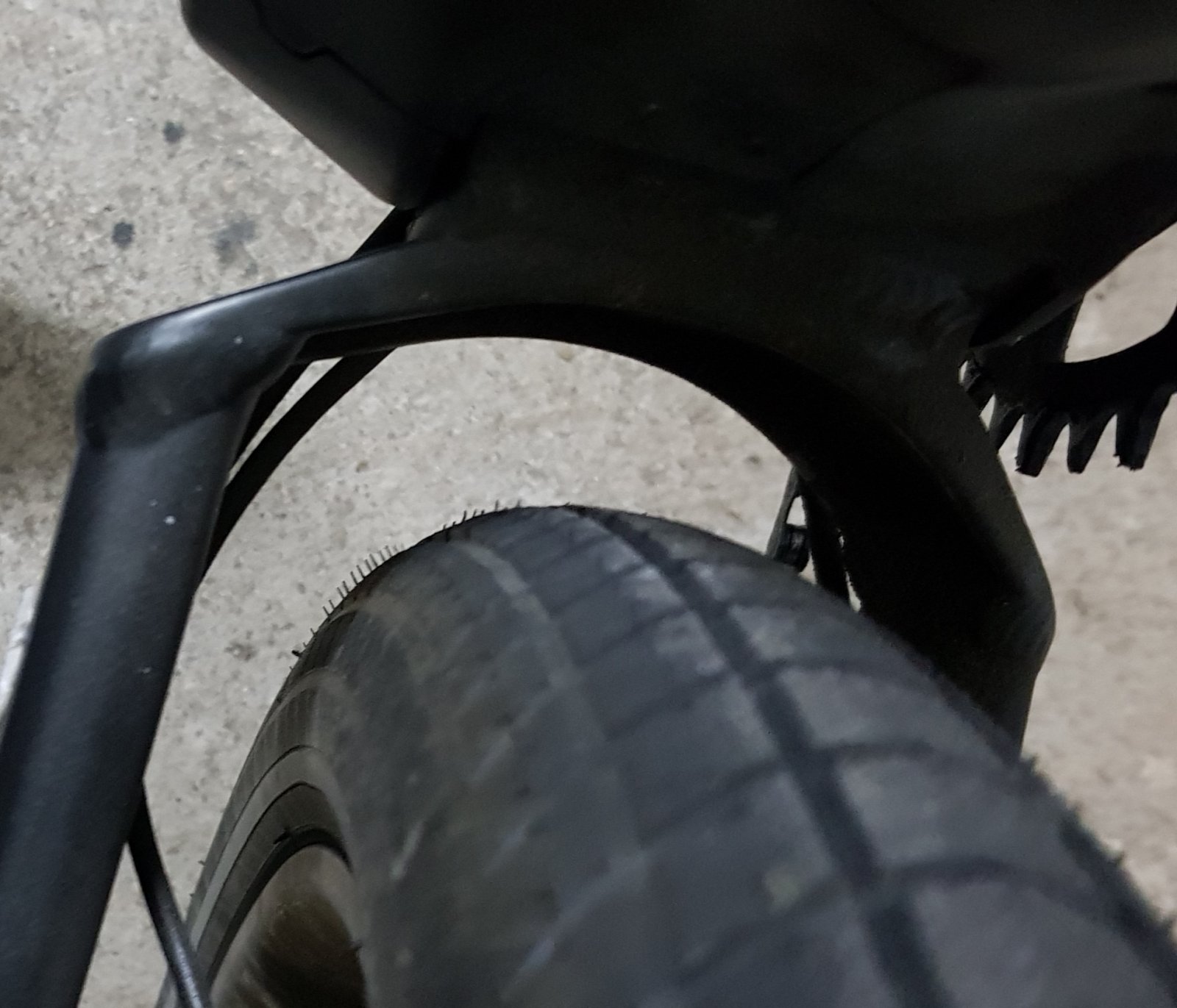

I have a 29" wheel at the front, but in the end the 29x2.25 has roughly the same outer diameter as a 27.5*2.8
A 29x2.4 won't fit (I suppose), the space between tyre and bridge is limited.

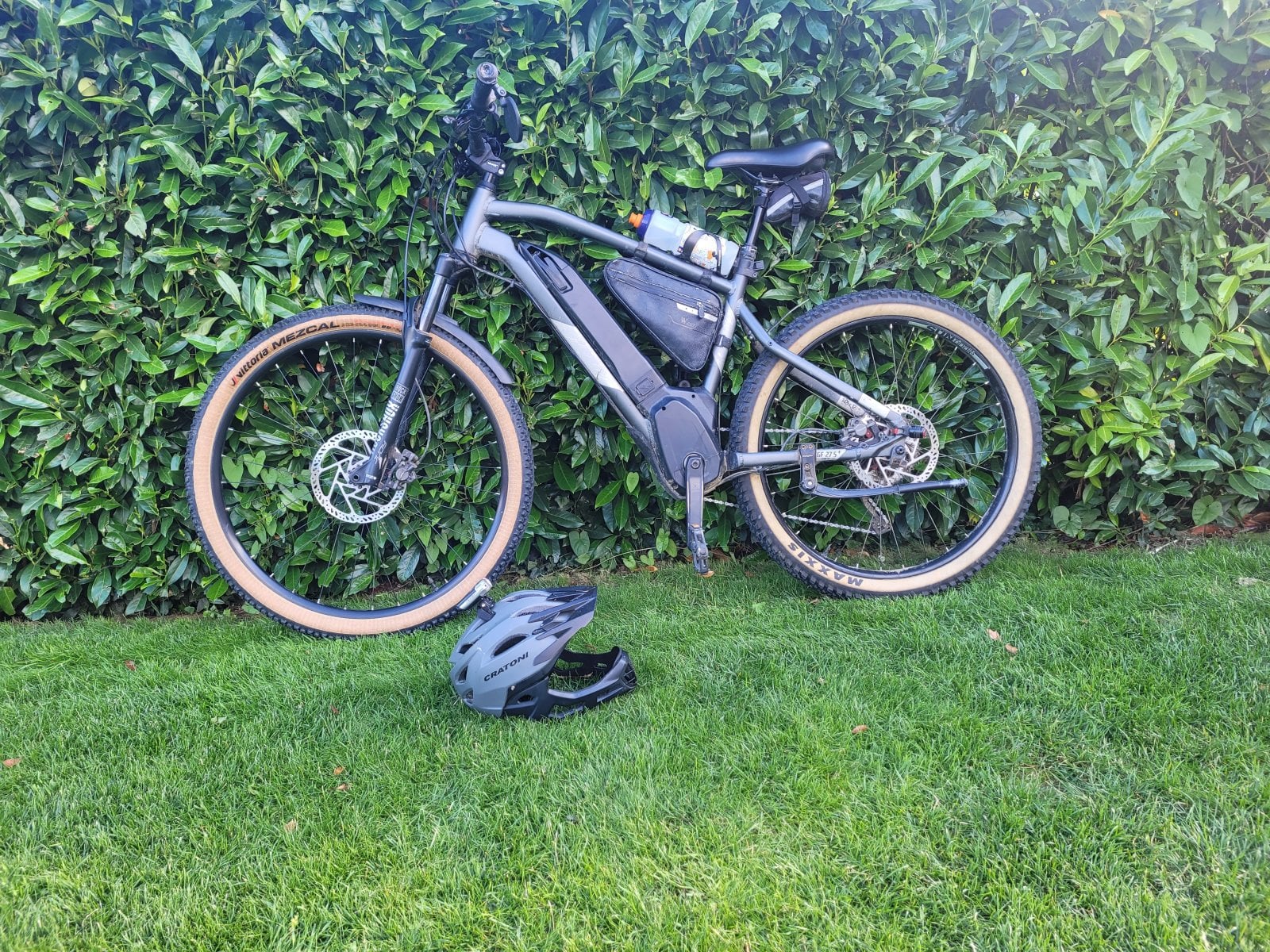

Are those 29 wheels? :)
I am asking because I am running a pair of 27.5 x 2.00 and I am wondering how far more could I go...
29" x 2.25 Vittoria Mezcal front
27.5" x 2.8 Maxxis Rekon+ back
You see, at the front the mudfender even fits between bridge and tyre, so there's still room for experiments :)
Looks great, but I would need some gravel bike style tyres... :cry: I guess I am still going for the 42T after all.
