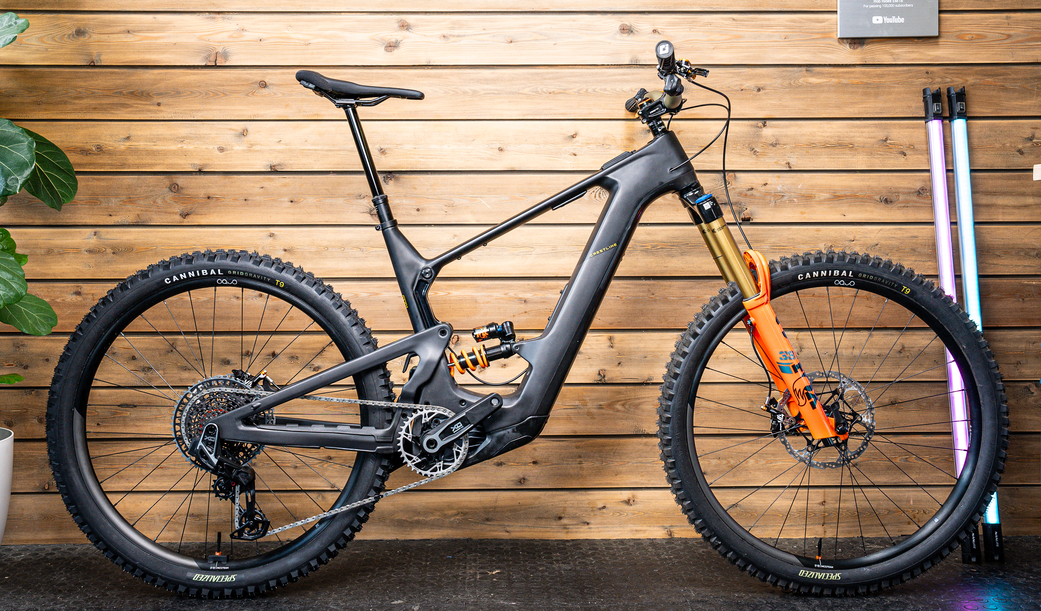

Had a very quick ride today. Basically a hyperbike, it’s crazy good, fast, on rails, race mode is addictive, has controlled travel but loads in reserve. Coil works very well on this suspension curve.
Early days but first impression is it’s pretty superb.
Need to run it for a good couple of days on some enduro / DH tracks really to try and find some stuff wrong with it 😆

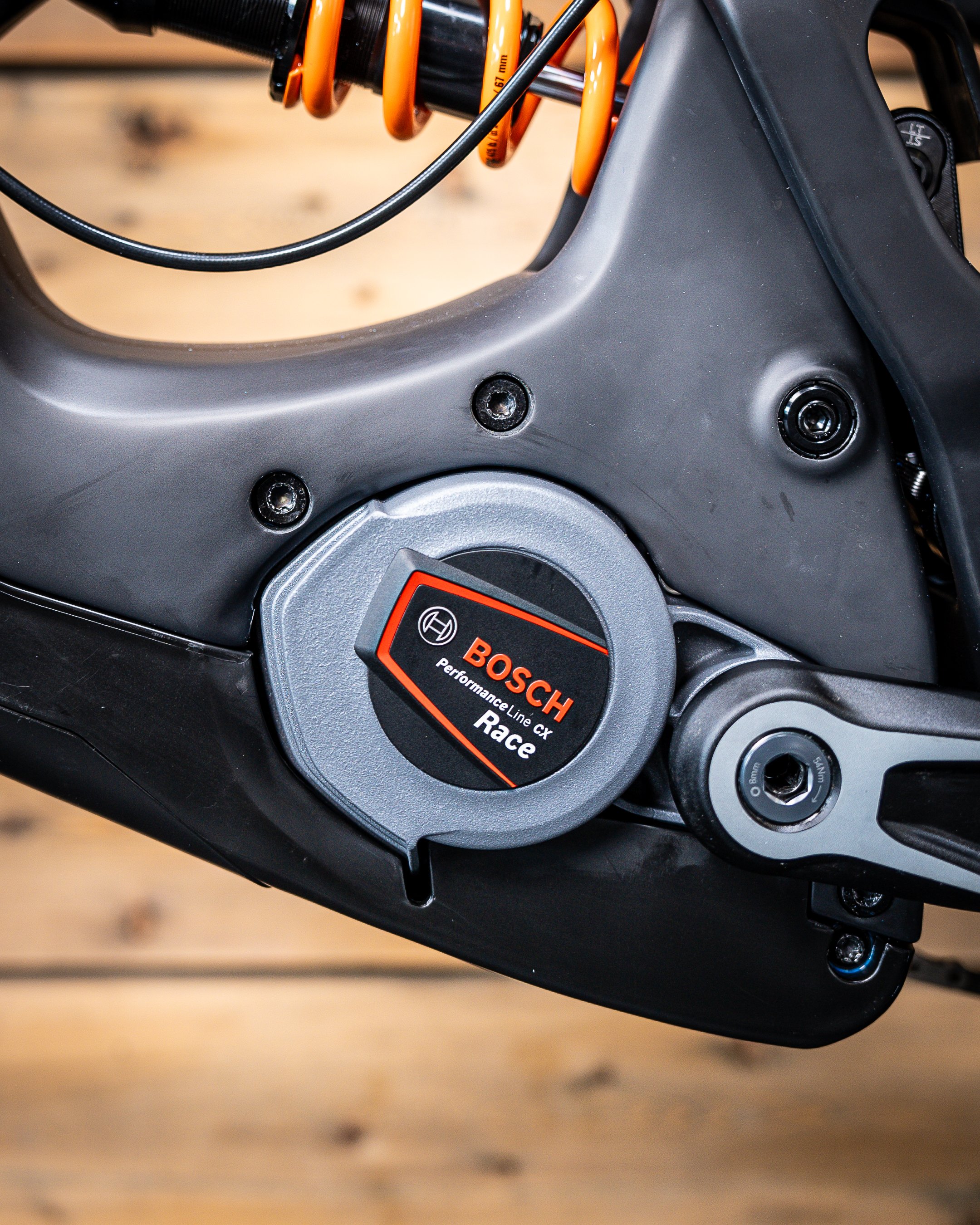

How's the motor rattle? Similar to other Bosch CX motors? I can definitely hear a rattle on mine, which bugged me at first but which I've gotten used to (or else it's gotten quieter).

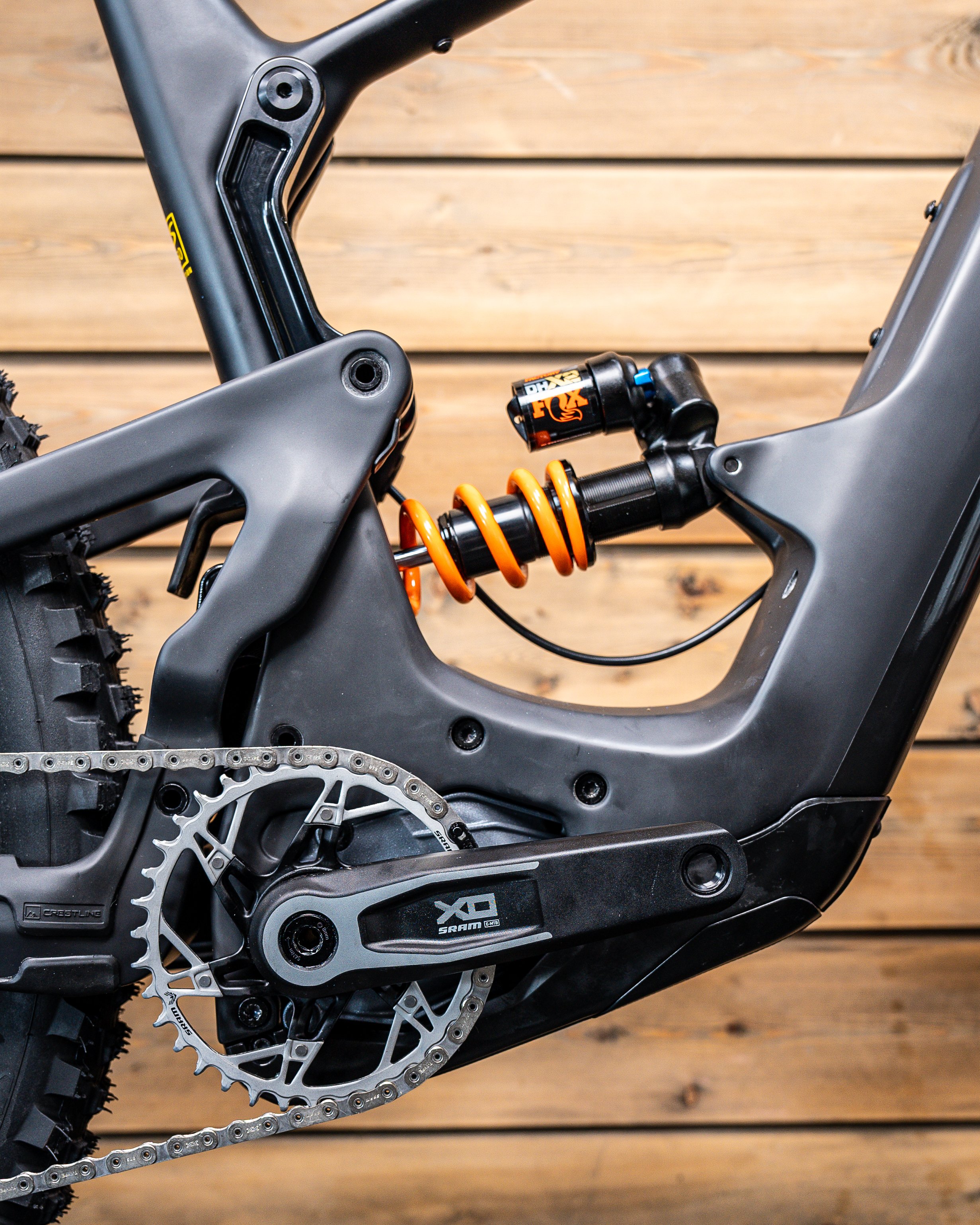

I just got the Ohlins suspension sorted on mine (it took a while). It’s an amazing bike. So balanced and sensitive yet poppy. Setting all my best times on it while having the most fun.
The fact that Troydon nailed this after such a short iteration period is phenomenal.

I know you didn't ask me but I'll chime in anyway. It seems like the general consensus (including from Troydon) is that the second chamber in the fork should be at least 20psi higher than what Ohlins recommends. And in most reviews of the RXF38 I read, folks seemed to add 5-15psi higher than what Ohlins recommends in the main chamber. Ohlins recommends 95psi for my weight and I'm currently running ~102psi. I went all the way up to 110psi and worked my way back down. 110psi actually felt good on a lot of trails but 102psi seemed to be the best compromise for now. The shock I'm less sure about but, at about 165lbs, I'm running ~175psi. It feels a little soft some times, but it balances out the front better for me and I've recently started using the lever (set to the middle position) more regularly. I found the shock surprisingly sensitive to relatively minor changes (<5psi). Also, Ohlins states that all of their adjustments are usable, meaning that it's okay if you're totally open/closed on rebound or compression damping if that feels right to you.

My advice for fork in general and it's a must on ohlins stuff is you have to get the air spring right first then add compression damping as required.
Here's my settings I'm 103kg
Ohlins rxf 38
20% sag 36mm
Main chamber psi 140
Ramp up psi 245
Hsc open
Lsc 9
Rebound 10 16 available
TTX 2 air
Sag 19.5mm 30%
Main chamber 235psi
Hsc open
Lsc 7 10 available
Rebound 9 11 available

Yes! One question about this though. If you've already filled the ramp up chamber, then the main chamber, and then you want to add a little more ramp up, do you have to empty the main chamber? I'm assuming not but wasn't sure.
It's ok doing little changes
