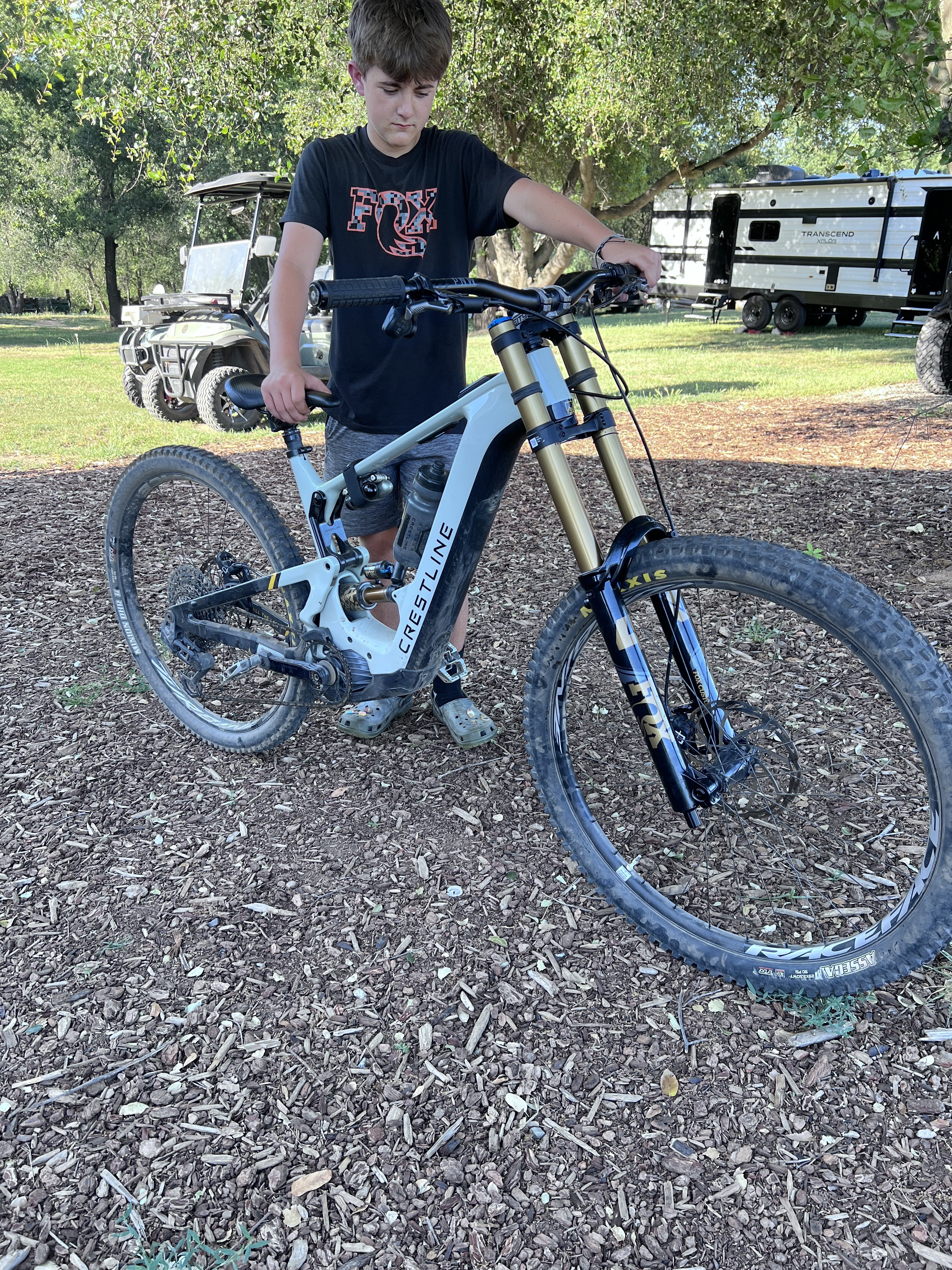

i'v honestly not got a clue re all the numbers, Alls i know is after -5 install the bike felt high and lost grip at speed in the front, This led me to check the HA, it measured 61,62 with -5 cup, 63,64 without. But Forget all the Numbers the Main thing is The bike Steers well. Holds a line when its rough. Attached is her sat high on the cup...

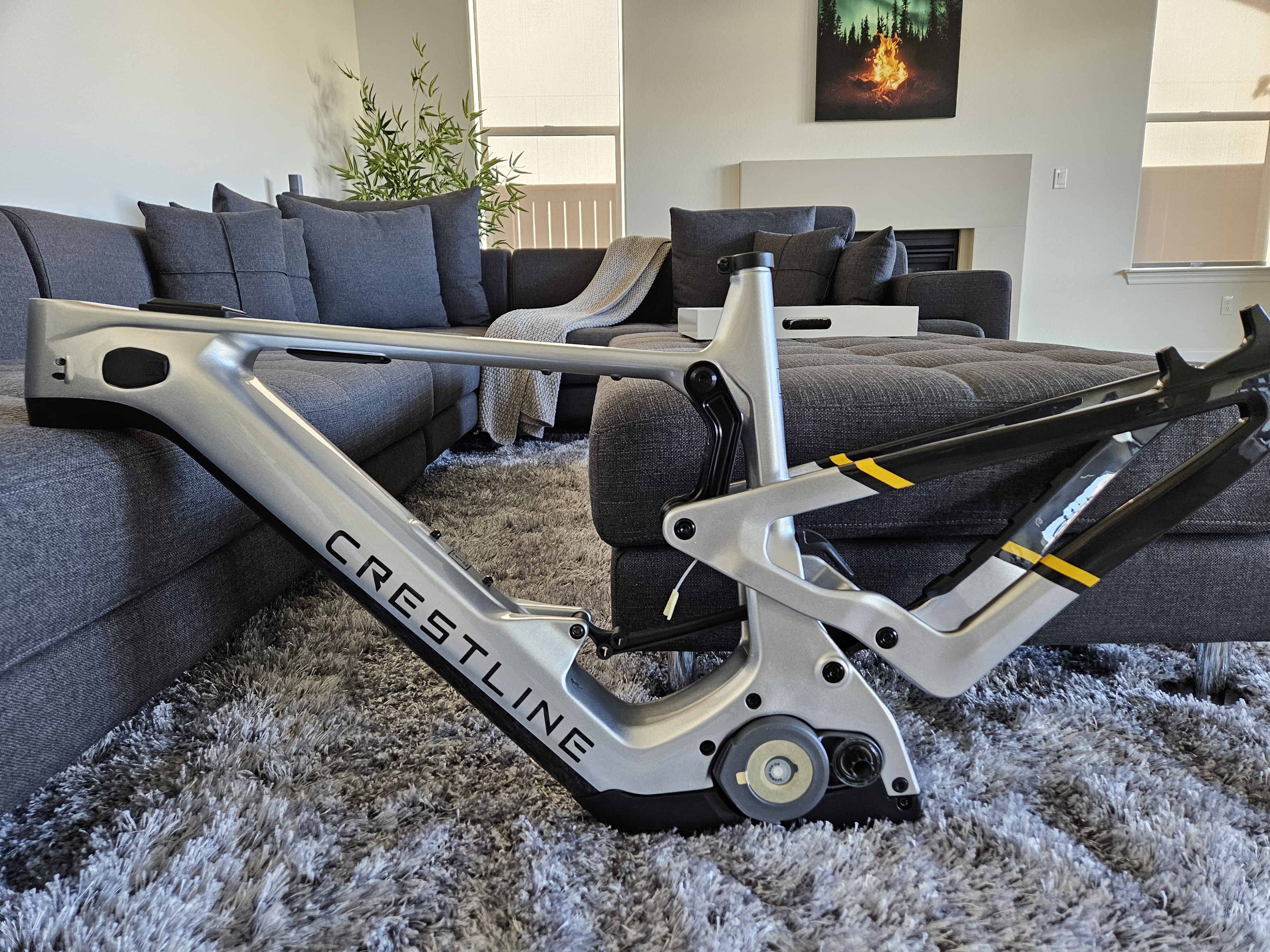

Can't wait to build up my new Crestline RS 180! Going with Ohlins air suspension, SRAM GX AXS Transmission drivetrain, SRAM AXS dropper post, Hayes Dominion A4 brake/rotors, NOBL wheels, Onyx Classic hubs, One Up bar, stem and pedals. Hoping to have it completed in the next 2 weeks.

Solid build George. Ohlins will look great with that colour scheme too 👍

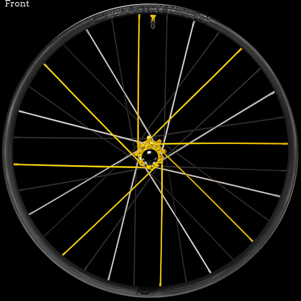

Sadly, my RS180 arrived 2-weeks ago and hasn’t been out of the box yet as I’m still waiting on I9 to build a EN350 wheelset that seemed like a good idea after a few scotch’s…hopefully the color choices/lacing pattern for the spokes doesn’t end up looking silly 🤪🤦🏻‍♂️

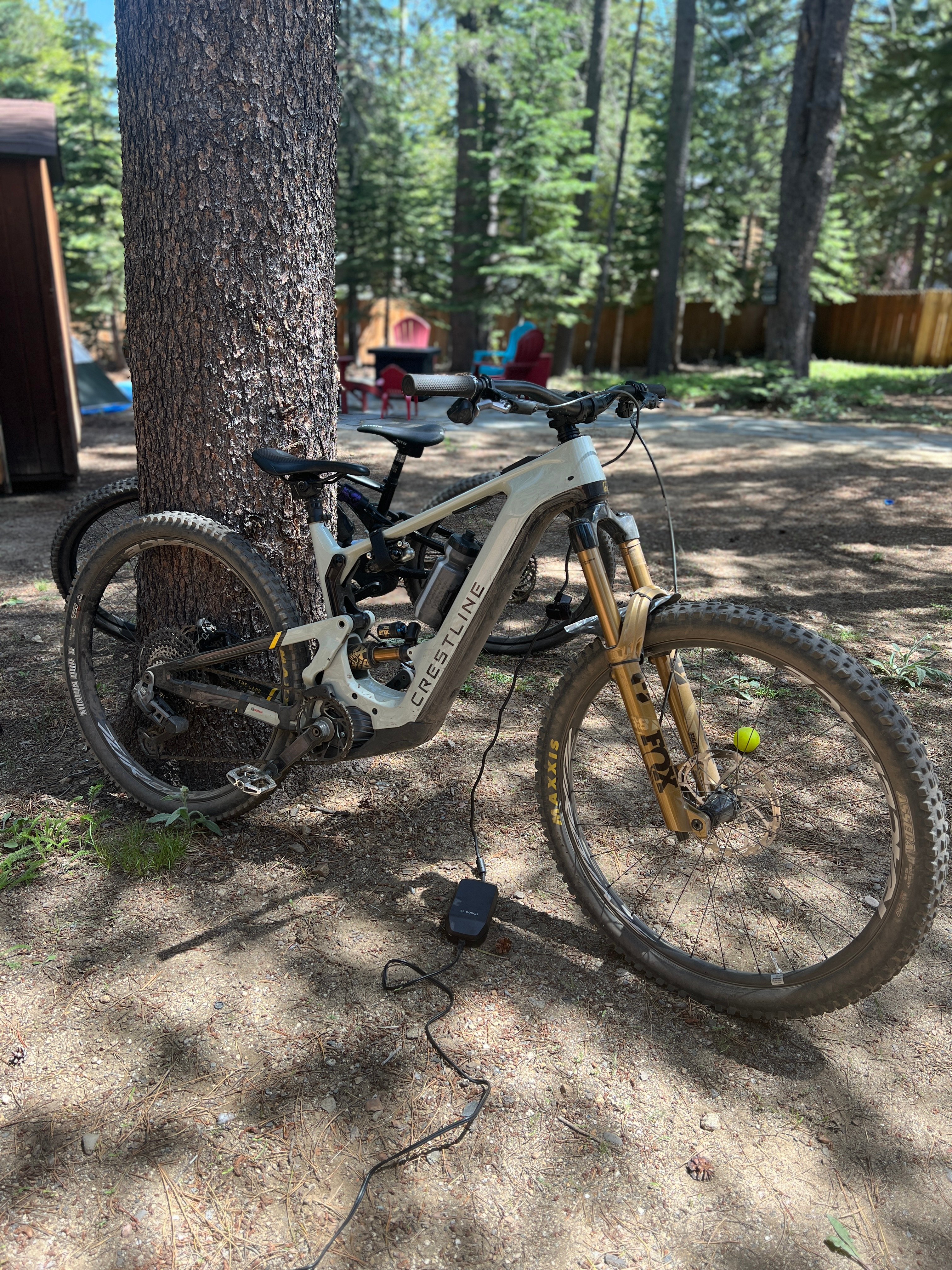

Anyone running a fox 40? I put one on and immediately felt weird. Went back to the 38. Just curious if anyone is loving the big squish life? To me the bike feels alive with the 38. I have a kenevo on 29ers and fox 40 and it feels good. This bike is amazing though!

That 200mm/40 should only be 10mm higher front end than a 180/38 so .4⁰ slacker head and seat angle and 3mm higher crank axle. Id take the added stiffness and 20mm as long as the turning radius wasnt messing with me

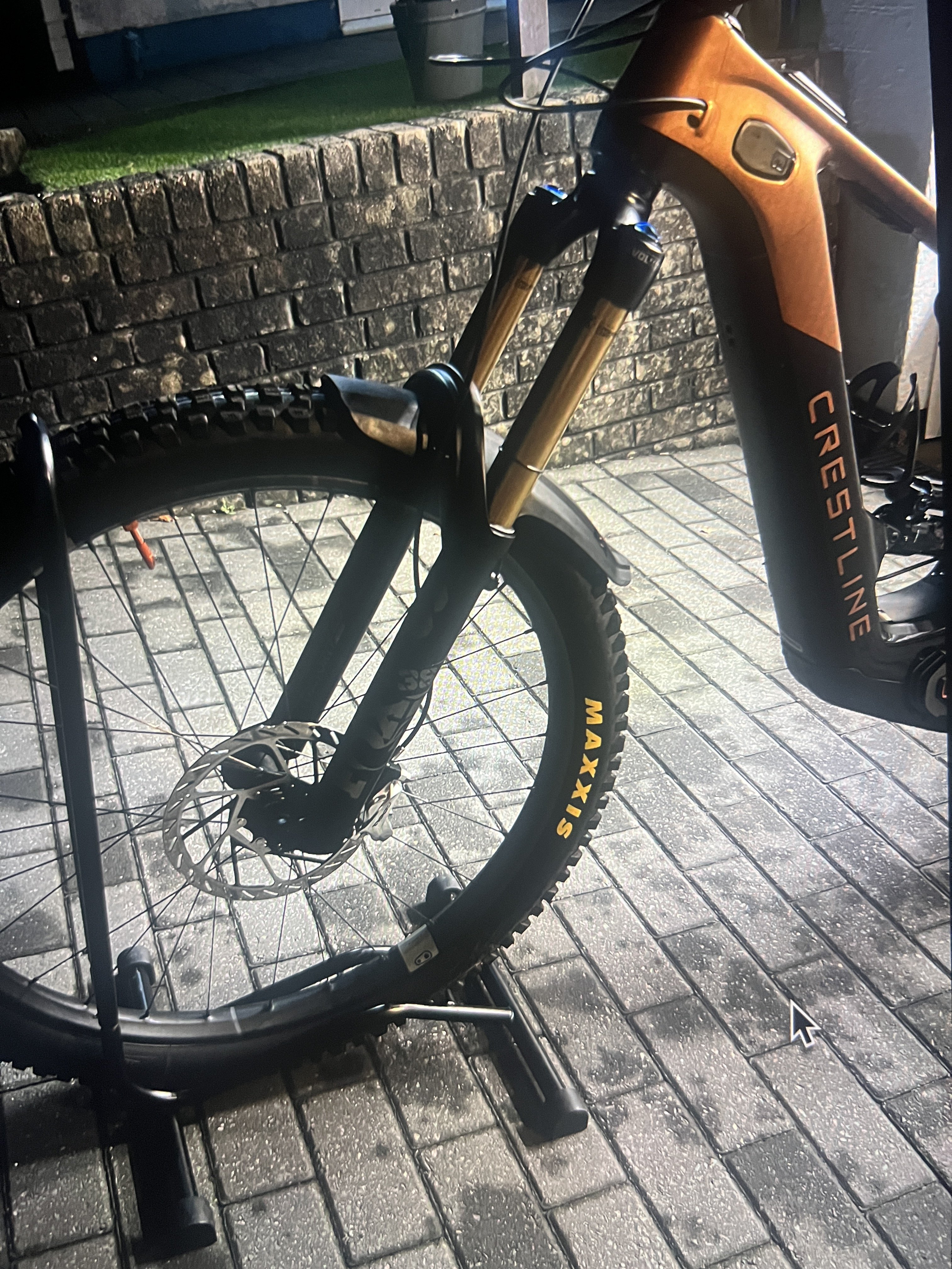

Running 200mm 38mm Boxxers on mine. Absolutely epic, best suspension performance and tracking ever. Steering restriction has made me a much better rider as I'm looking for high lines on entry. Now I never hit the steering lock.
You can count on one hand the number of dual crown certified eBikes, so don't miss out on this superpower 😁
New Boxxer is also a lot better than old one, it has great mid stroke support.
As for playfulness, it is no surprise that running a lot of sag on a heavy hitting well damped 200mm fork will make the bike planted. I would suggest trying a reach reduction at the same time, then you have more authority to move your weight around on the bike to trade stability for playfulness.
