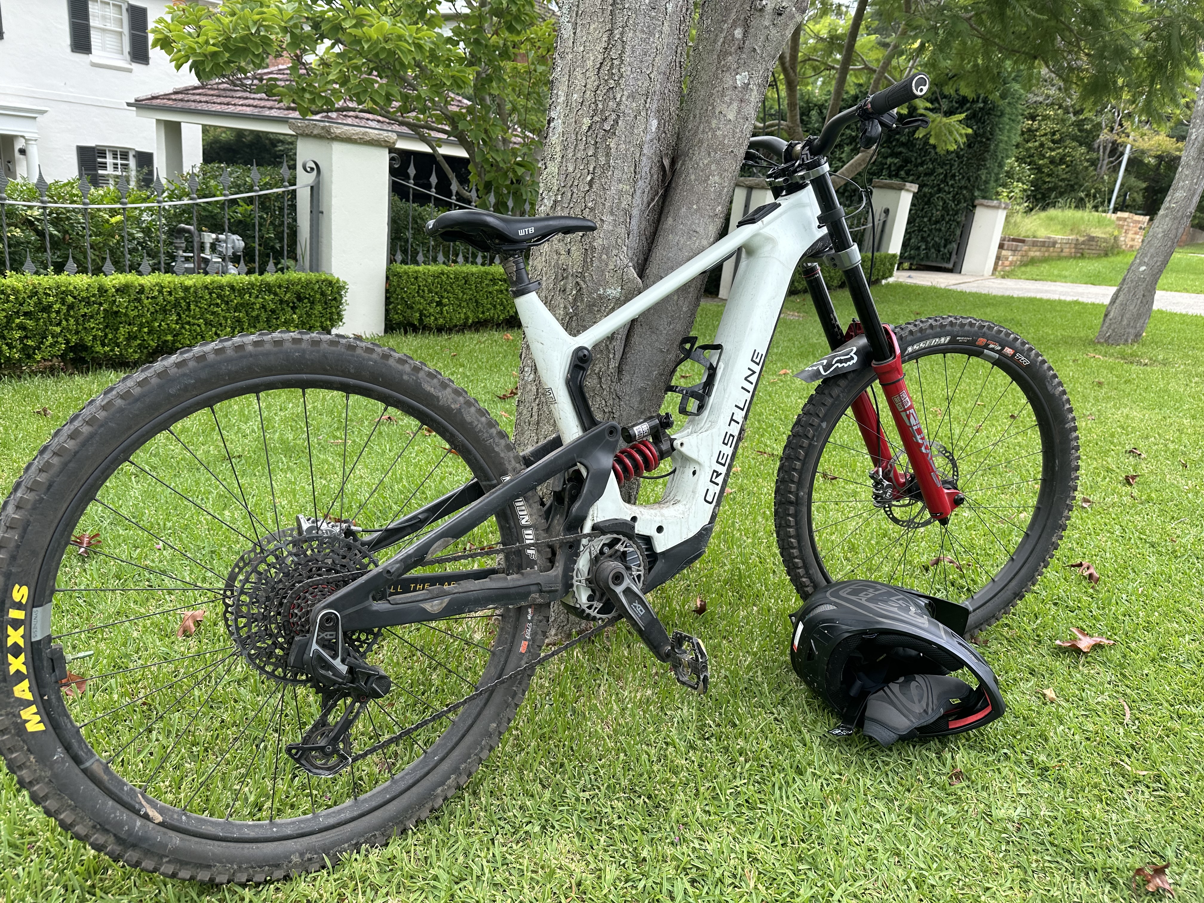

So I had some user induced issues with my dh bike yesterday. See attached pic 🤦‍♂️
So I did downhill laps with eebb all day, a dh fork makes a heap of sense on this 🤔 The difference in fore/aft stiffness between a single crown and dual is noticeable.
Bike is a genuine do it all machine!

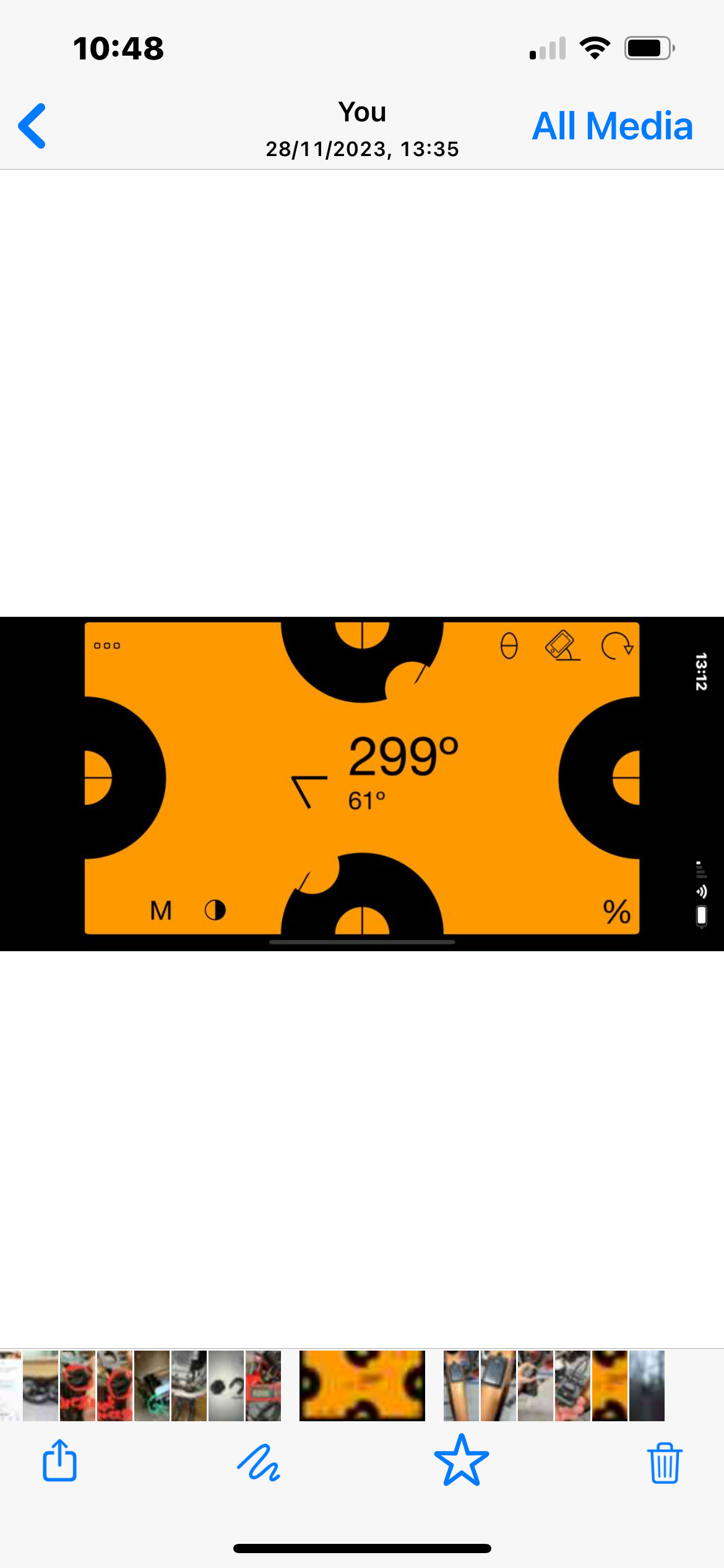

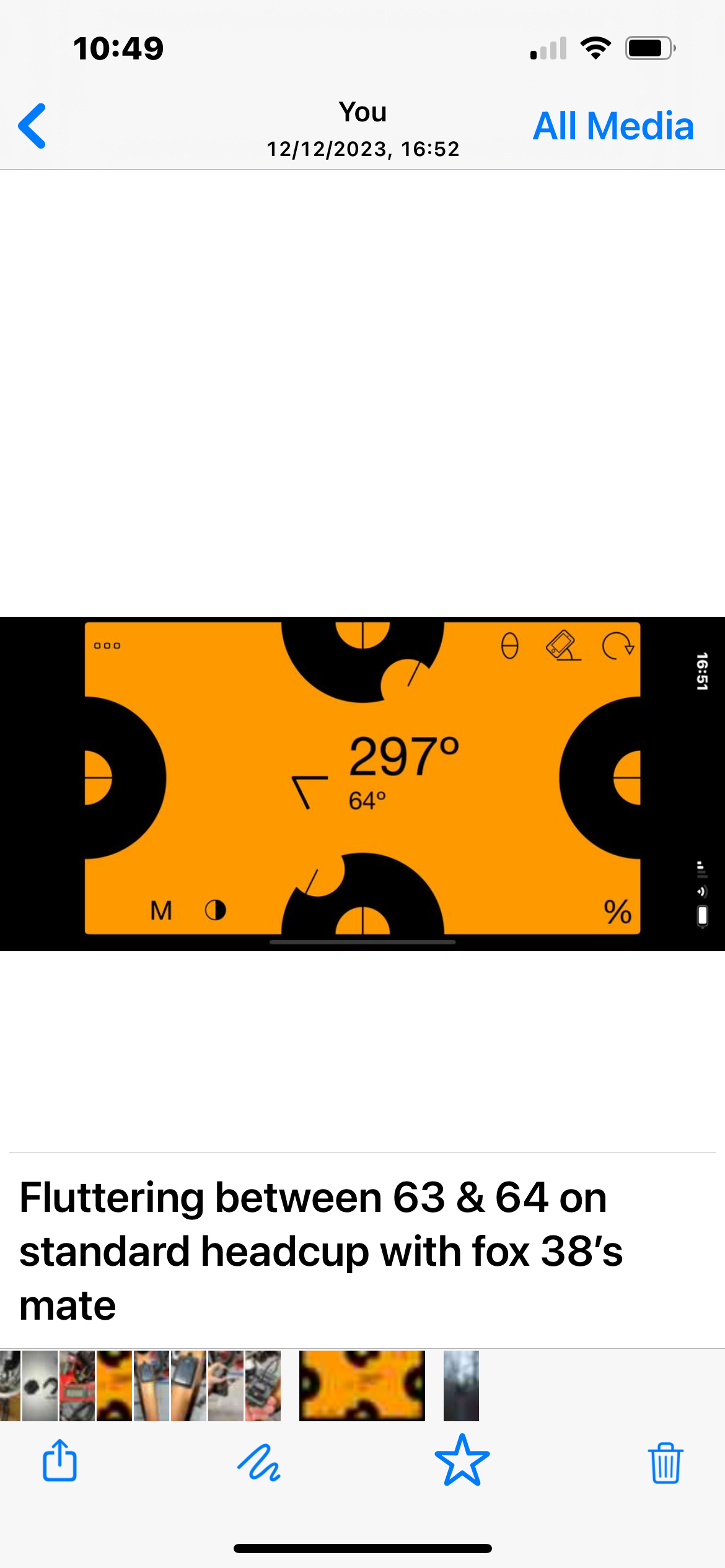

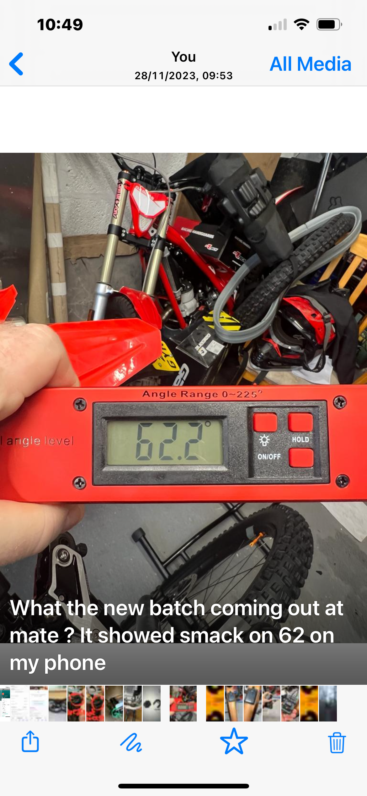

Bare in mind The -5 reach adjust slackens the bike, It lifts front 15mm ish, slackens to 61,62. Which imo is too slack for the full travel crestline, For me The front got washy, im a short ass 5.8 hents been told go -5, but im a top heavy bloke that likes to ride beyond my skill set every minute im on a bike, i Get over the front fine and prefer a bigger bike, The standard cup back to 63,64 HA was sweet. Theres going to be Different sag on different forks, spring rates. But not massive.

Ah,
Ah, is it an external cup that goes under. It would only slacken it by around 0.6deg.

Yes there external, im talking from experience, not guessing, i measured both, im not normally a measurer but after riding and noticing id lost front grip with the cup installed, i could also feel it sitting higher. excuse the mess...
i got 61,62 with the cup, 63,64 without, so its more like 2 deg. IMG_7614.png

The -5 for shorter riders, the +5 for taller, The +5 will lift the front end but not as much as the -5.

Also your HA will steepen as your fork Sags. So i wouldn't worry about it to much, you can run less travel as well to steepen it back up.
