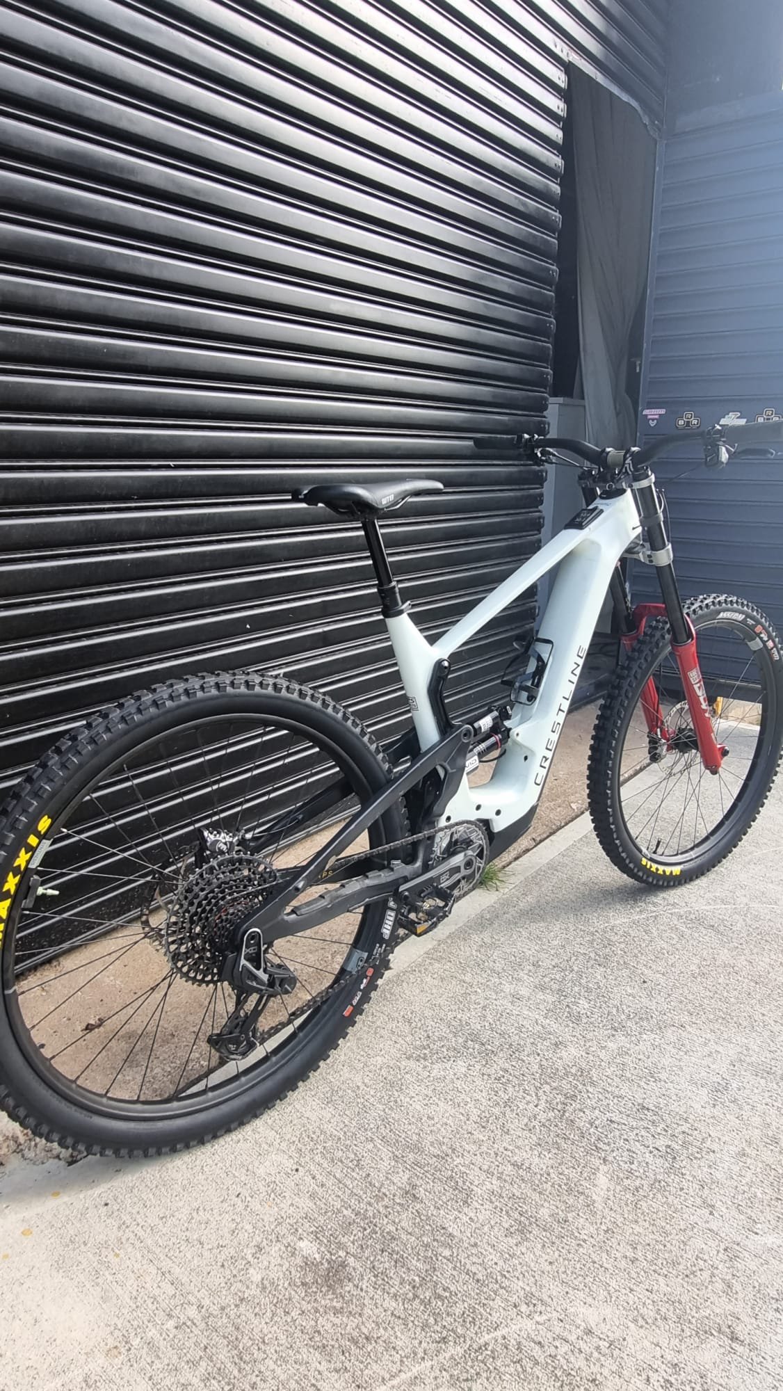

I’ve been running a 2.6 Specialized rear on my Race CX 29er. Juuuust fits. The next tyre will be a 2.5.

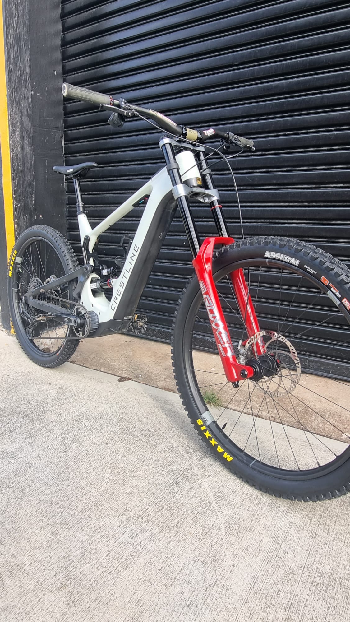

Couple of mods - trying Rockshox over the stock Ohlins. New tyres too.

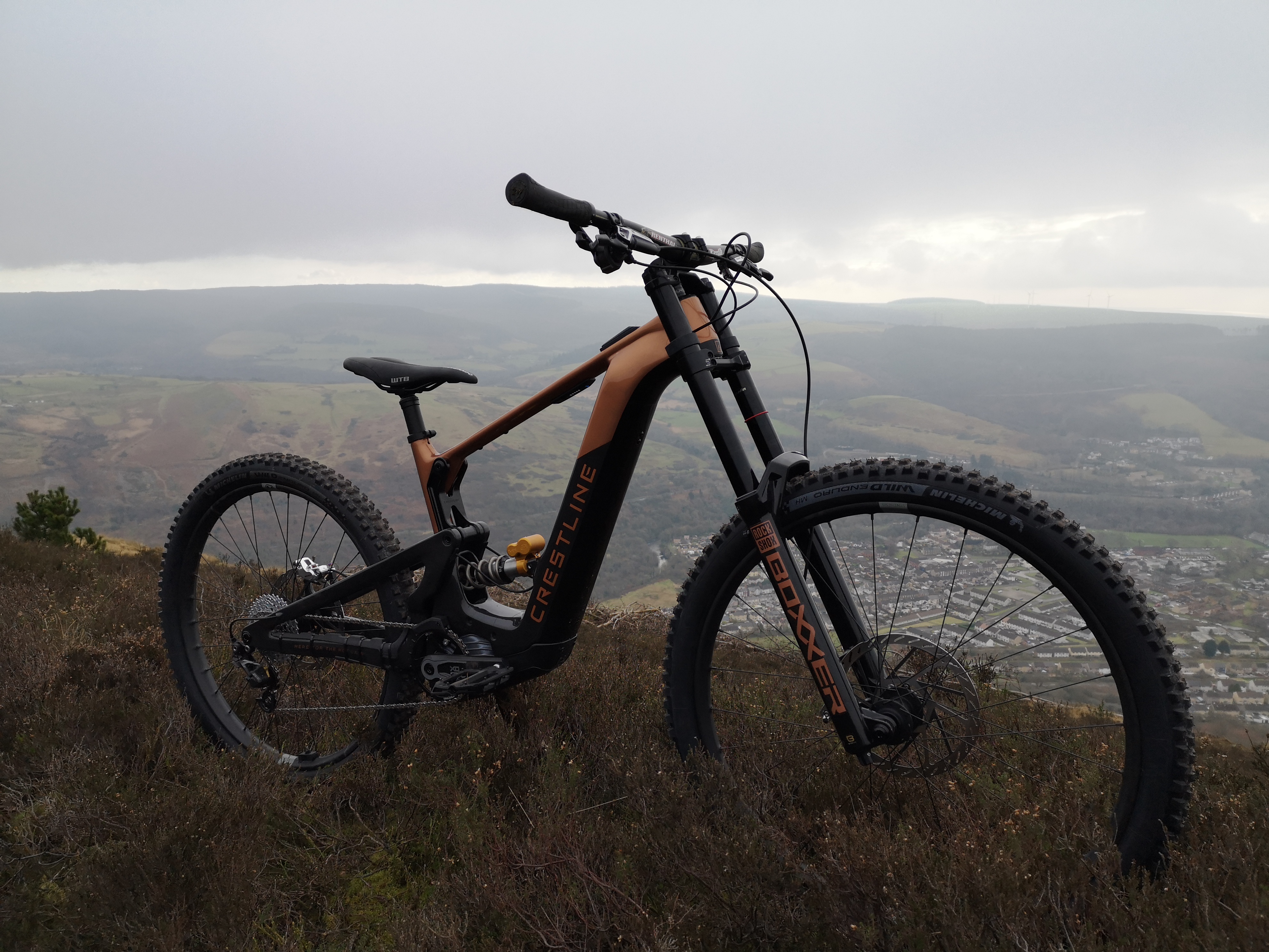

Got to be the best looking fork iv seen... Does the front end sit higher now ?
It's fairly high but I'm happy with it (running 10mm rise bar). Have a flat crown as well so can drop it plenty if I need to for flatter terrain.

Used this to fit the 15mm front hub:
Cane Creek Fourty headset.
