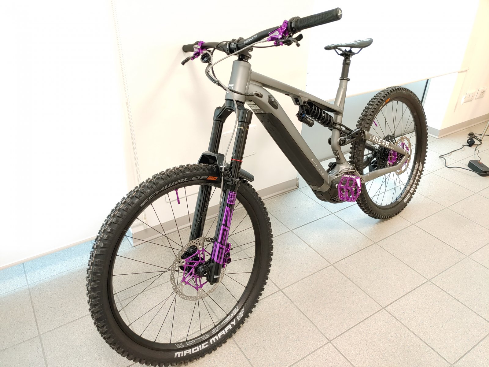

Perfect! Killer spec and look. Only thing I would change are the white decals. Black would do better. Also on the website the Zeb's decals on the Race are white and the chain is silver. Pitty there's no Meta SX priced between the Ride and Race and on better components than SRAM SX and Guide RE + some cheaper coil. 5699€ for such a machine and it will be mine. Race too expensive, Ride requires too much upgrades.
Thanks! I looked into new decals to cover the white ones but nobody makes them yet... Perhaps a project further down the line. I swapped out the Zeb decals for gold from SLIKgraphics and the chain was upgraded to a gold Sram xx1. Gold pins on the DMR vaults and gold collars on the deathgrips. As i said, must've added about 20hp with the upgrades ? ??

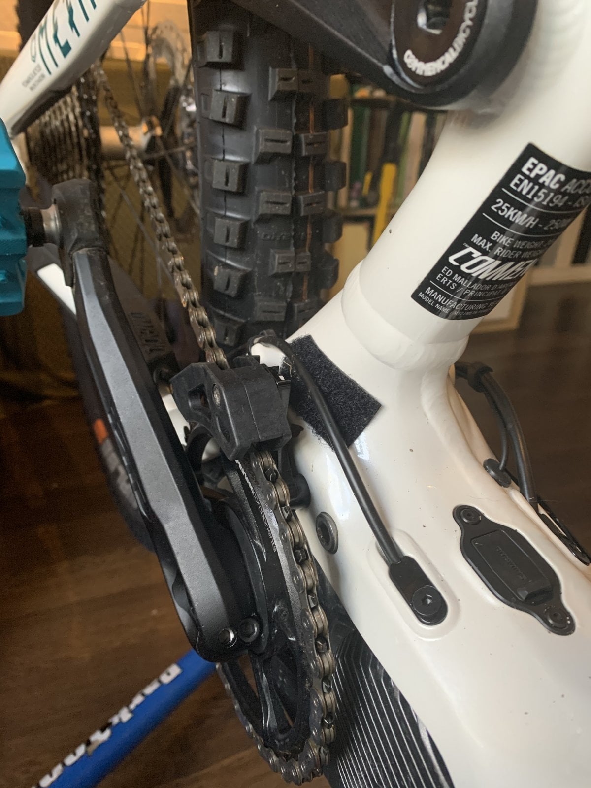

You also should be aware, that commencal uses a special 20mm adapter (the speed sensor is mount to it). You can buy it on their website.

can anyone with one of the brake adapters with built in mount for the speed sensor, tell me the following:-
1. What size brake rotor you have (200mm or 220mm)
2. The length of the bit that sticks out underneath the adapter that the speed sensor mounts to - the dimension marked by the red arrow below- need to check whether it will fit.

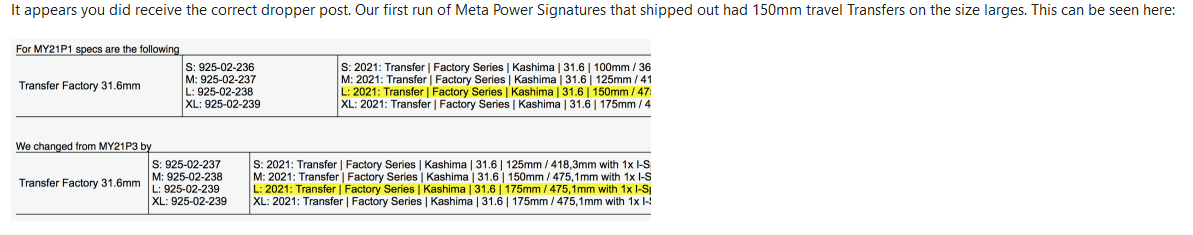

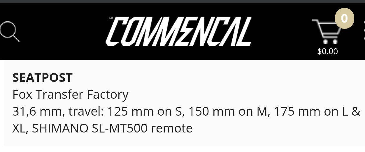

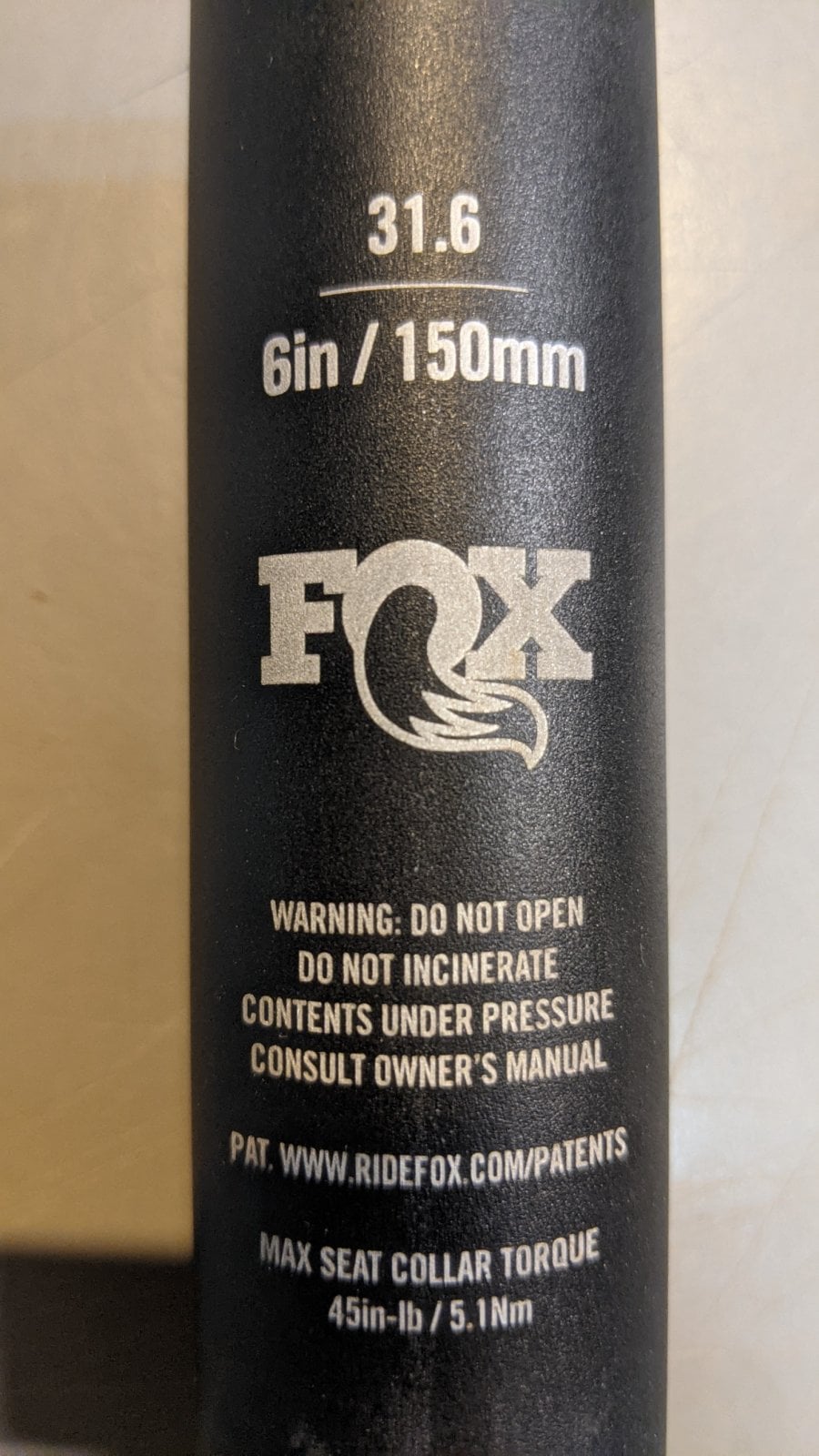

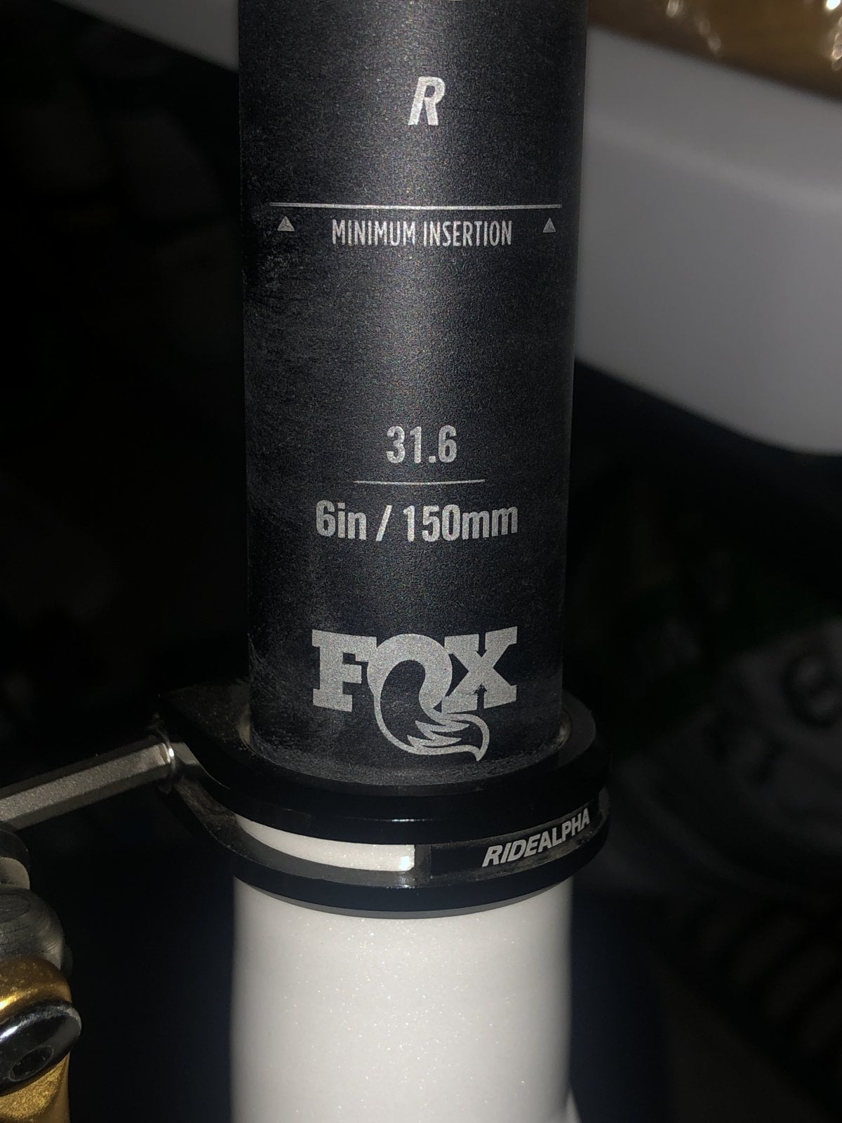

heads up, check your actual oem installed dropper post length vs spec: i just discovered my size L meta power 29 signature came with a 150mm dropper installed when it should have been a 175mm!
9,190
There is a shortage of parts worldwide which is holding up assembly of many bikes - we are seeing quite a few bikes from various brands coming with slightly different components than advertised as brands are having to fit what they can get hold of to get the bikes out to customers

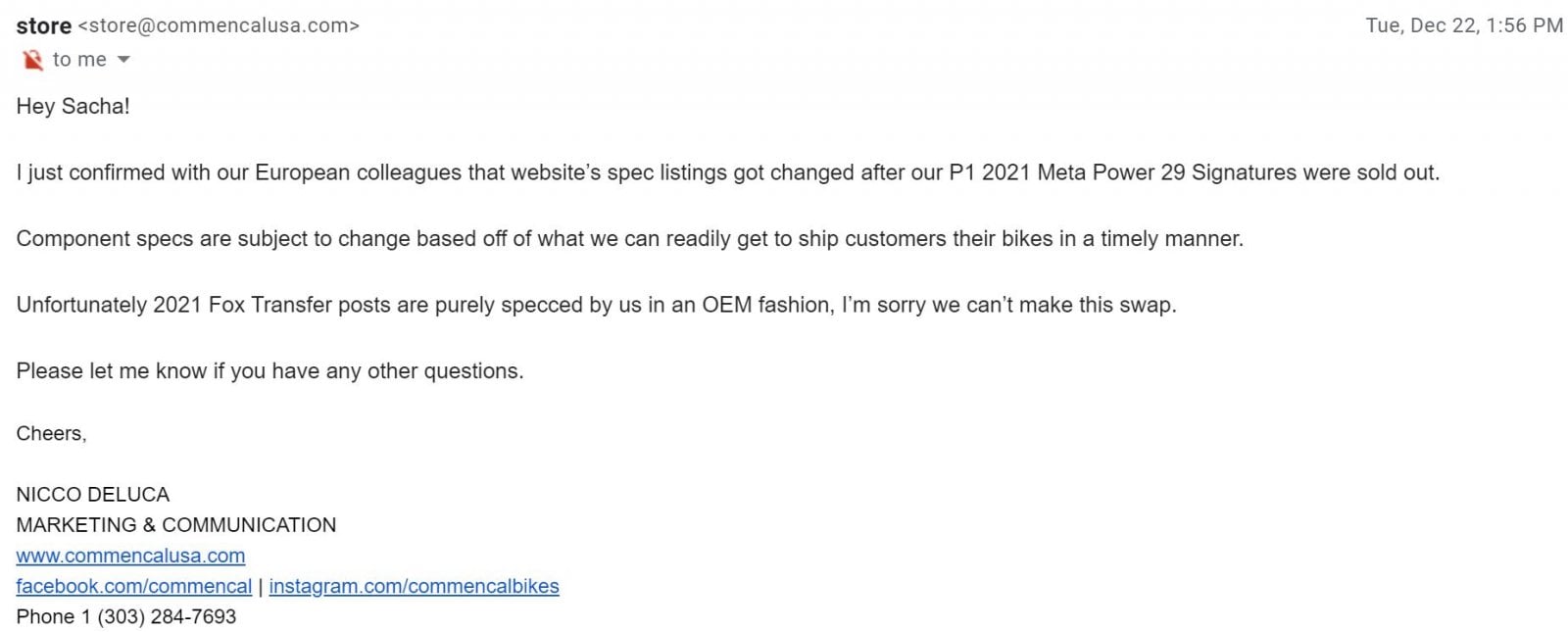

The answer for the "droppergate" mystery: it depends when you ordered the bike
i'm quite sure the spec was listed as 175mm on the size L signature at least when i ordered it 8/31/2020; this link with the original signature color scheme & specs has been static since august as far as i know:
JW9
Sep 5, 2020
31
37
I just checked mine, it’s a 150mm.
The L and XL Signature were and still are listed as 175mm.
