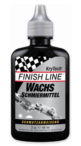

Once your chain was cleaned, the easiest way to keep the chain clean is to use wax instead of grease. You have to use it (nearly) before every ride, but your chain and cassette keep clean!
Is that to replace the usual wet lube ?
Can you put it on at the end of every ride rather than at the start ?

Can you apply wax to a chain that has been conventionally lubed? I read somewhere once it's needs to be fully clear of all previous lube but that might have been the dubious wax bath people have mentioned.

Never use solvent cleaners myself, have learnt by many years of experience that doing so just washes all the lube out of the internals of the chain and you cant put it back, not with any lube. just hose it off to shift the grit, run it through a rag to dry then apply a good quality wax based lube such as white lightning Epic Ride, your chain will stay nice and clean and last ages.

I have never had any luck with wax chains in the wet season, it is just not robust enough. Great when it's dry though. But in the UK, you can never tell whether it's going to be dry or wet; it might be dry today, but it was wet yesterday! Eventually, I decided to use wet lube all year round. I get good chain life so it seems to be working for me.

White lightning Epic Ride is great all year round latest chain is 1500k and still ok

Guys, you're making it unnecessarily difficult. I myself wipe the chains clean with an old bath towel piece and add good chain oil. Such as Dry Finishline or Muc-Off Dry. Shift gears up and down a few times. Then wait a moment and wipe off any excess oils
Has done so for 30 years and the current chains have lasted more than 1000 km
