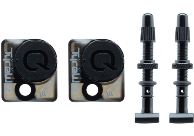

But this would not work with TyreWiz installed on a 9.9 right? My 9.9 XX1 is planned for delivery in a week or two.
Edit: what´s the deal with walk assist issues anyway? It works smooth on my 2021 Rail 9.7 today.
14,166
21,072
Depending on the version of Tyrewiz you have, I believe it gets its pressure reading from the small secondary holes in the valve stem shaft. So you wouldn't be able to mount the magnet beneath it.
It might .... work if it was mounted on top of the tyre wiz - either straight on top or with a secondary valve nut. But as it wouldn't be supported by the rim, it may spin around - or even be too far away from the motor sensor.
You'd probably have to attach the rim magnet to the opposite side of the wheel - with - creativity ... Unless you can find a nice twin valve rim ... ;-)

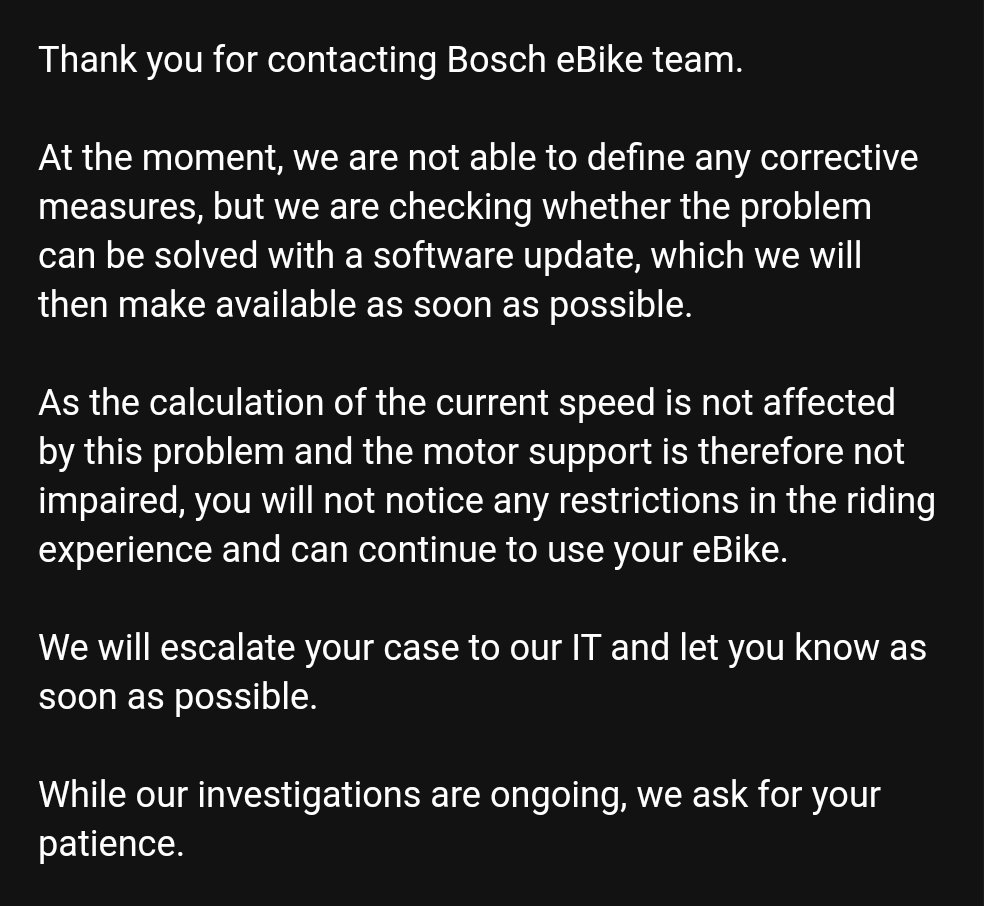

No new information to add, only that I just took delivery of my Trek Rail 9.8 this weekend, and I am having the same issue. Got a response from Bosch this morning stating they are aware of the issue..
We are already aware of the problem and are investigating it. First results indicate that the signal transmission of the speed sensor is not correctly recorded, so that the distance calculation is carried out incorrectly. This probably depends on the speed sensor configuration or on how the sensor is installed on the eBike. At the moment, we are not able to define any corrective measures, but we are checking whether the problem can be solved with a software update, which we will then make available as soon as possible. As the calculation of the current speed is not affected by this problem and the motor support is therefore not impaired, you will not notice any restrictions in the riding experience and you can continue using your eBike. While our investigations are ongoing, we kindly ask for your patience.
Of course saying its fine to carry on using whilst your odometer moves up at twice the standard rate and nothing from them on how they will fix that issue.
