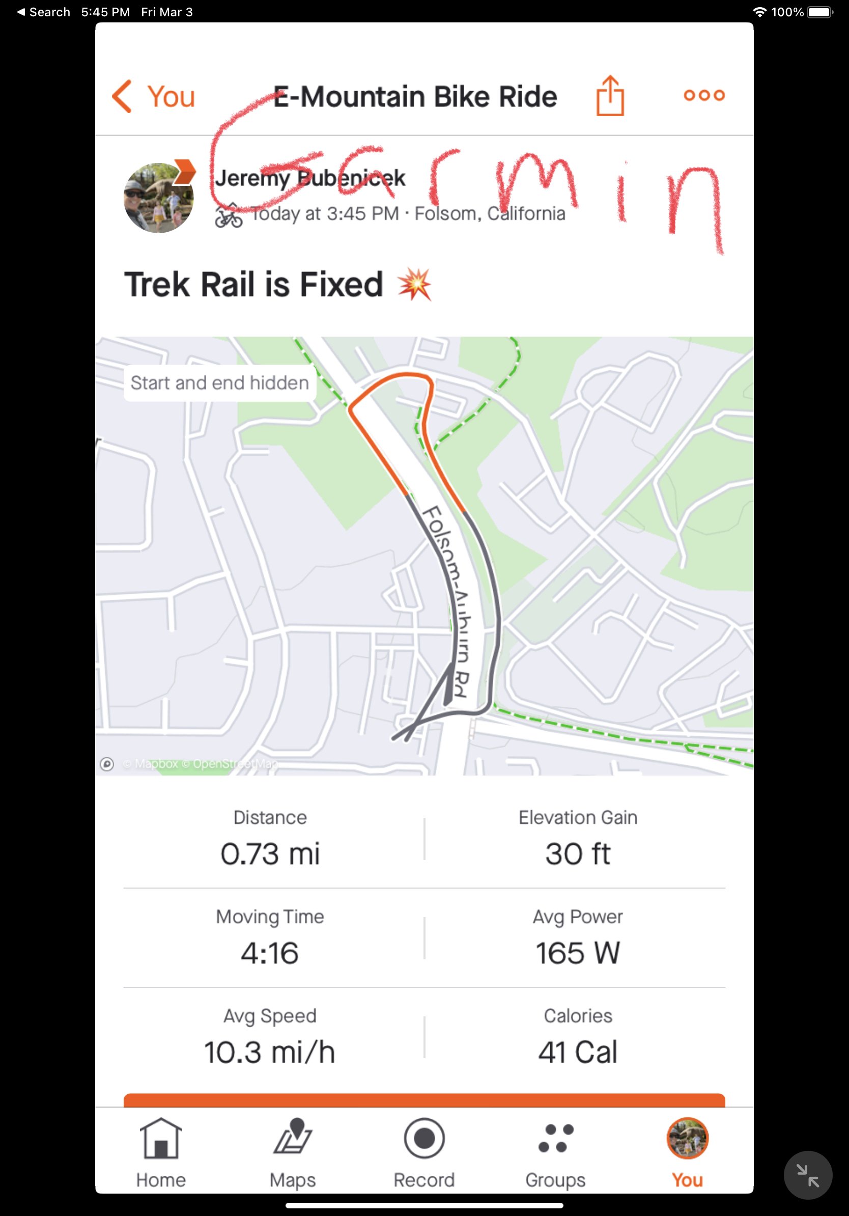

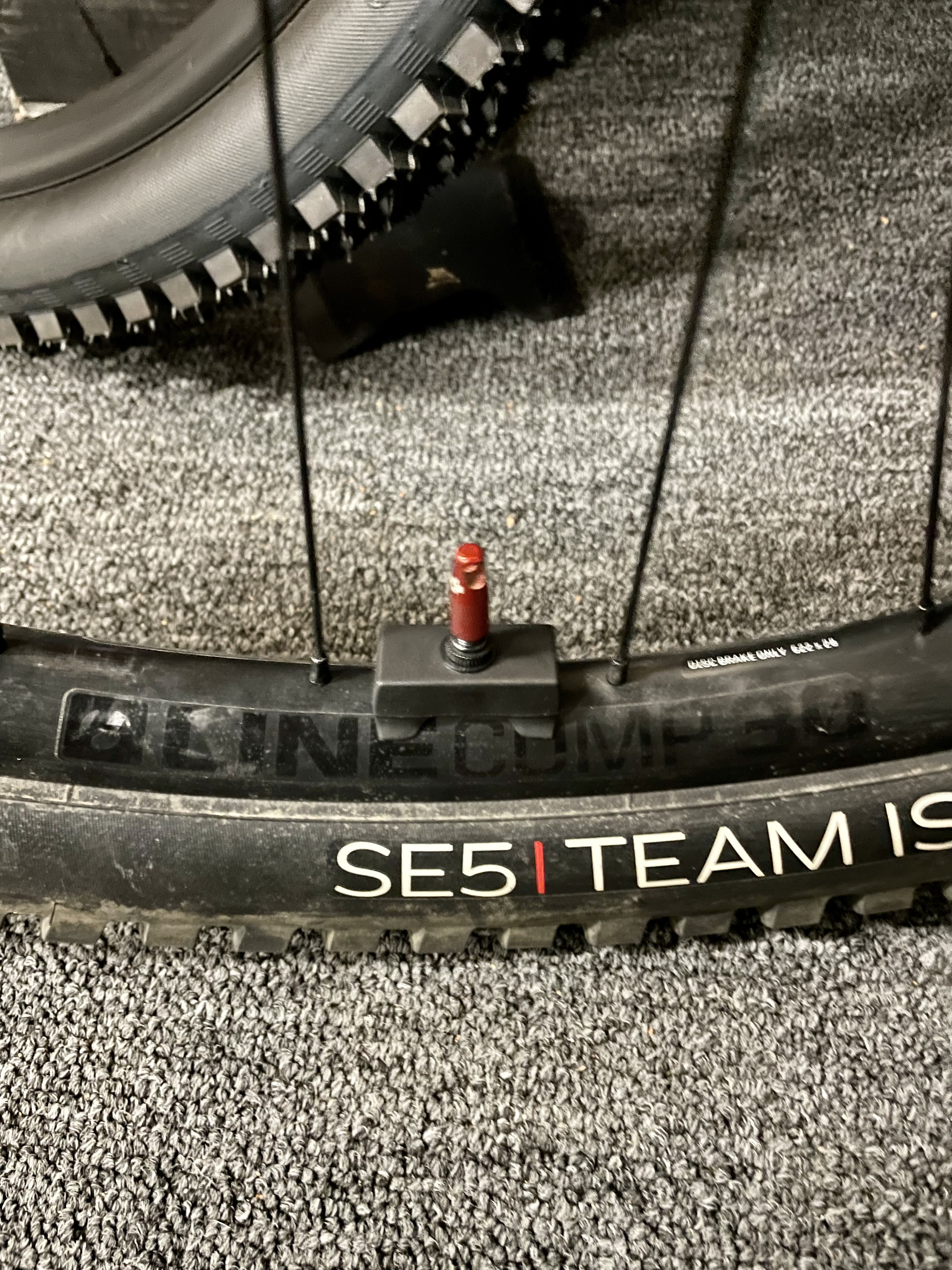

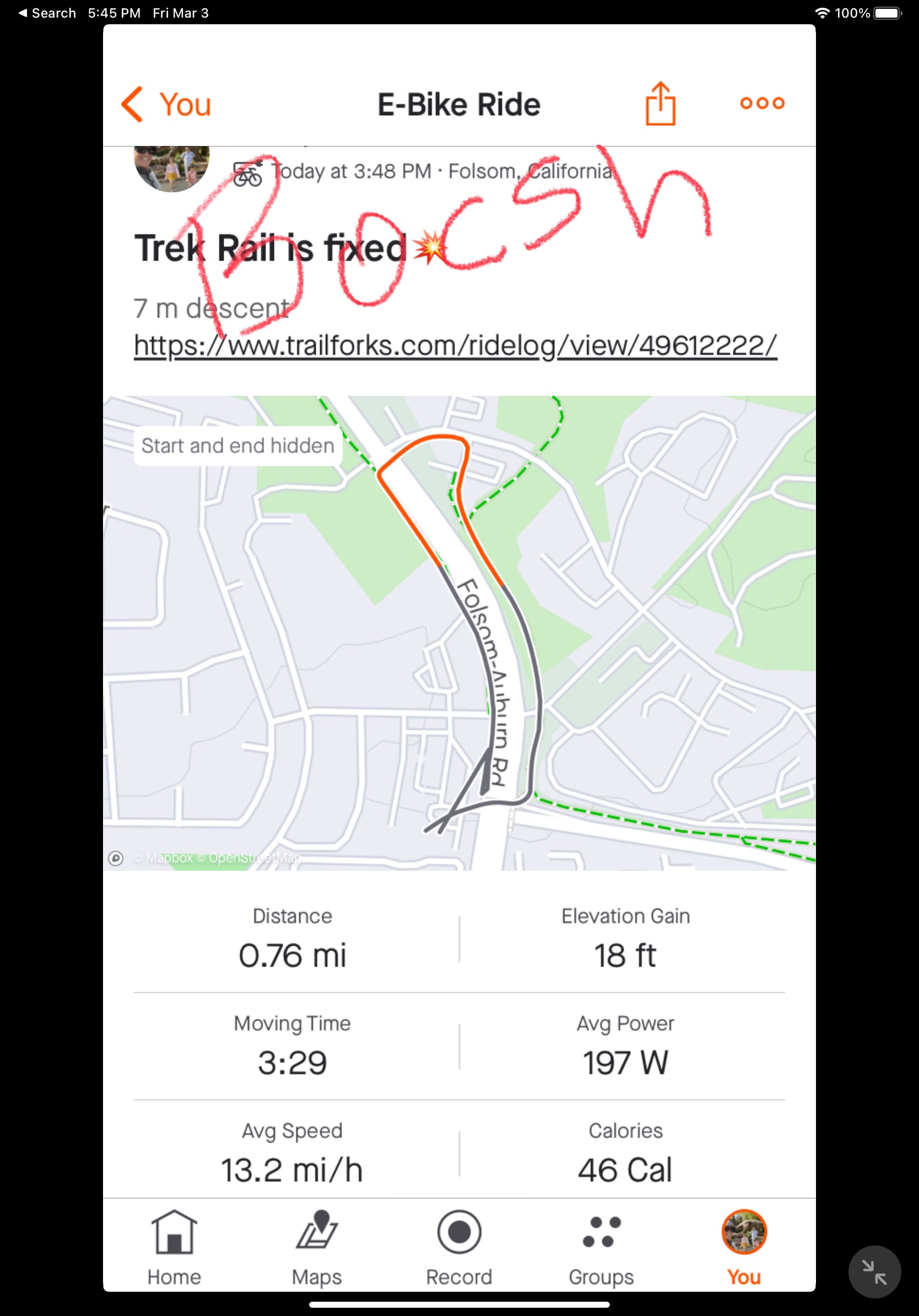

FIXED, however not perfect but not doubling the miles anymore!
Bocsh and Trek enabled the internal motor magnet senso, installed the wheel magne And presto
see image,
The Folsom Trek Factory shop offered to work with any USA Trek dealer to solve the issue, contact number below. have them ask for the service manager Mike
9168363890

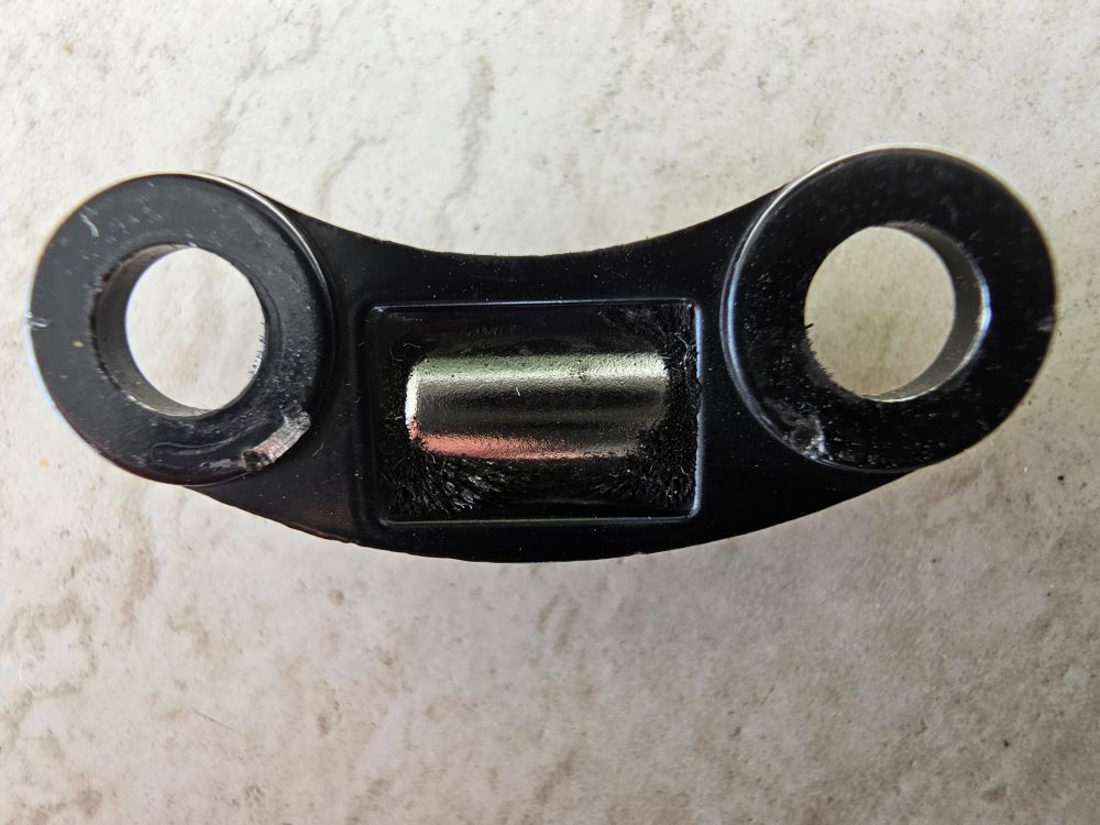

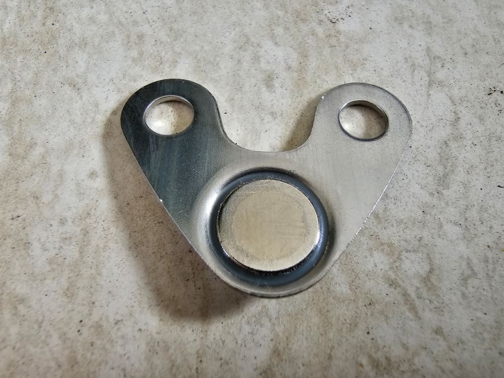

On a German emtb forum someone complained about double mileage on his bike after the last Bosch motor update.
When I saw this thread here I had asked him whether he owned a Trek bike. No he said it’s a Cube from 2022 but came back later to report that he had mounted his second wheel set for the winter and checking that found a Trek magnet on the disk. All he needed to do to fix the issue was remove the Trek magnet and put an original Cube magnet in its place. Problem solved - mileage back to normal and all else working as supposed.
AFAIK Cube uses stock Bosch components for magnets and speed sensors. You might want to try this.
The user provided some measurements for the magnet and the Cube and Trek ones differ significantly.
Bosch (Cube) magnet is flat and round, mounted with 10mm more distance (32mm) to the axle. Trek magnet is cylindrical and sits only 22mm from the axle.

the difference being the Bosch magnet has North pole magnetic field facing the sensor only. The Trek magnet has both North and South pole magnetic field visible to the sensor. The Trek sensor therefore sends two signals per revolution whilst the Bosch magnet sends one?
Makes sense since 'bad' readings should be both fewer(slower) And variable ( not a precise multiple)
If you are correct then the fix could be as simple as two lines of code with no need for Heath Robinson magnet!

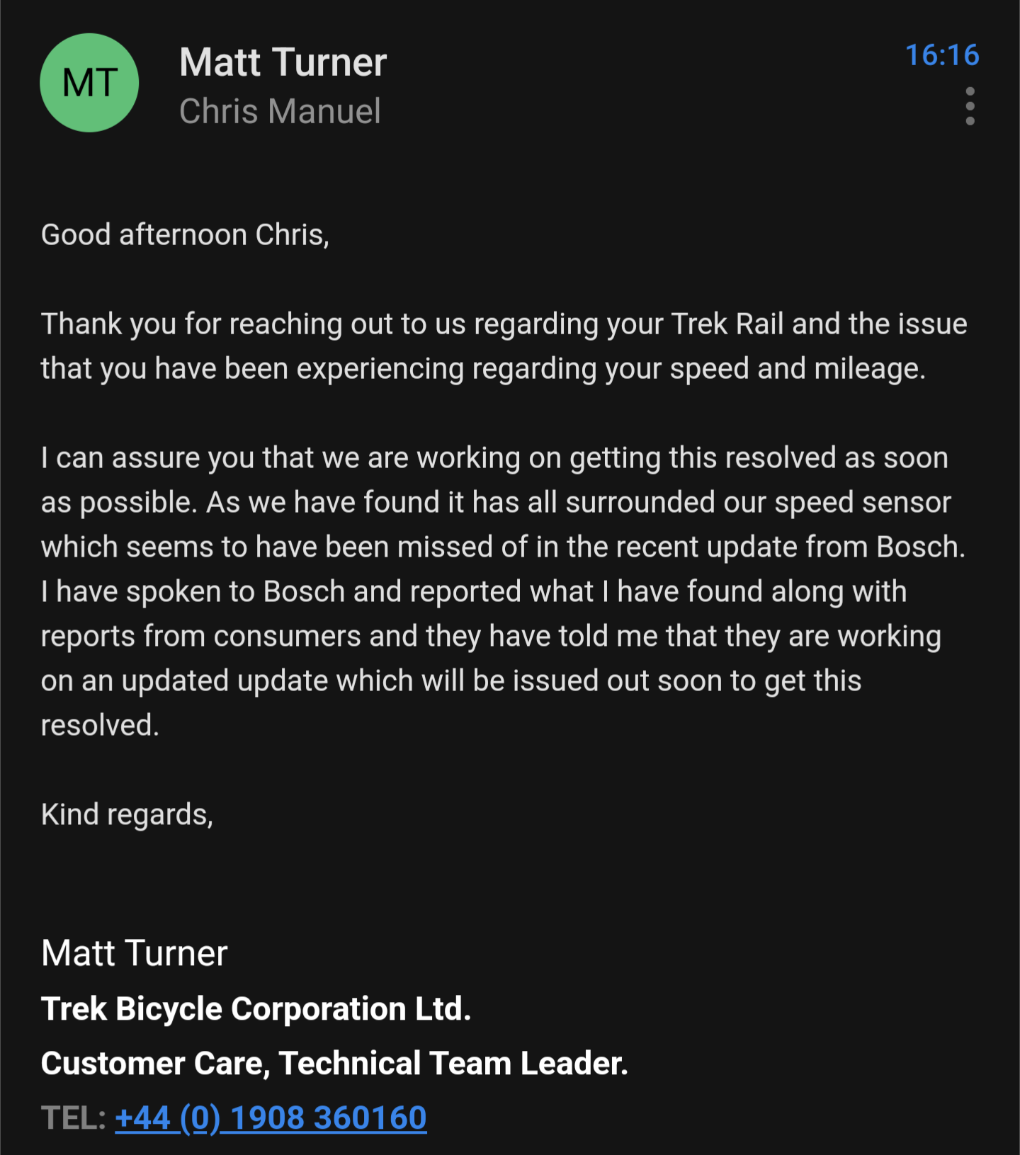

Chris Manuel
Mar 6, 2023
Leeds, UK
I've just had a reply back from Trek customer services regarding this issue who say that Bosch are working on an updated update to resolve the problem.

As I mentioned in #192 just remove the Trek magnet and mount an original Bosch Magnet. That should fix the issue. No need to wait for an imminent solution from Trek.
