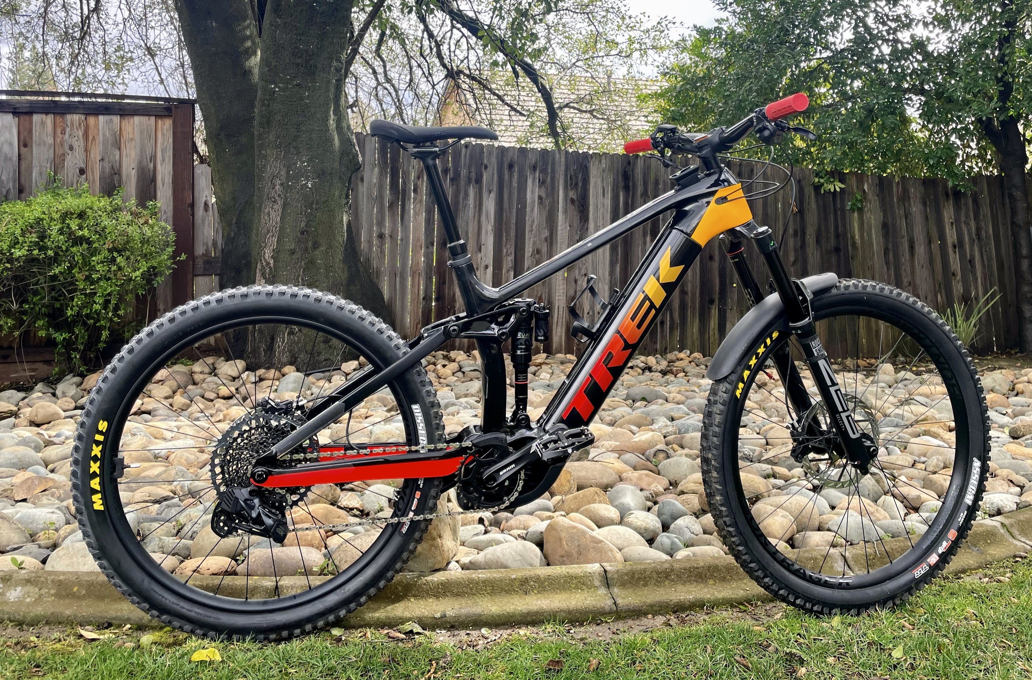

Hey y’all, yeah I have tons of post on my journey to solve the F up by Trek and Bosch related to the firmware update, you can see my past post to see what I went through.
My final test was the Mullet the 2022 Rail, so this past weekend I converted my 9.8, flipped the minolink into the high setting and completed my first ride yesterday, good news the Bosch sensor in the motor and magnet combo worked, I was concerned initially since the rotation would be a little further away for the 29er however I did notice any lag at this point, more rides to come.

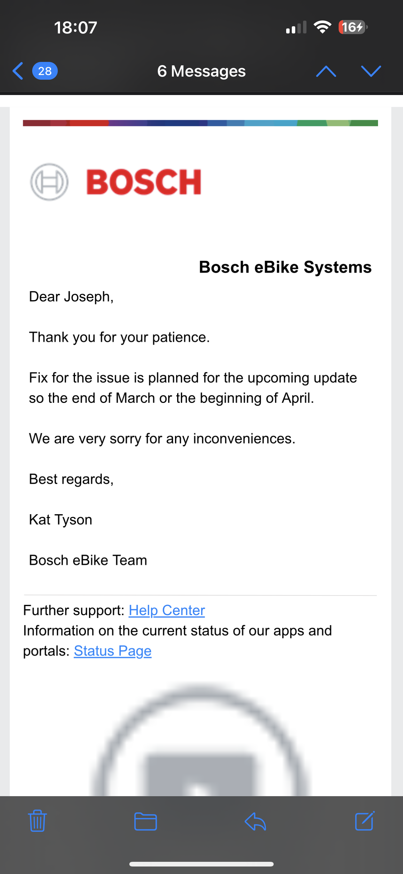

While I wait patiently (nervously) for my Rail 9.8 XT Gen 4 to ship today, I was provided this info that helped put me slightly at ease about the new bike:
Solution: New software with a fix is currently being developed and tested. Target Date for this new release is March 28, 2023
Action Taken:
• Update is no longer available for all Bosch end customers via “Bosch’s “eBike Flow” app” (effective February 27, 2023)
• Current series production is not affected as this software was not yet introduced into production”
The retailers were told “While it is possible to perform updates with the diagnostic tool, please do not update Smart System bikes to the latest software.

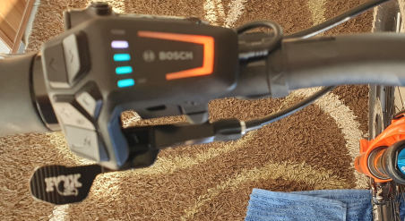

Ufffff. Got my new MY23 Rail 7 last week here in Finland. It's been giving random errors with the led remote showing orange. While googling for that I stumbled upon this thread. And figured out that my bike also has this mileage (km) problem. Not sure whether the error has anything to do with that.
Anyone have any idea how to figure out what the actual error code behind the orange led is? Rail 7 has only the remote, so no screens except for the app.
From the Bosch help site:
  • If all support level LEDs flash orange, there is an error. You can find information about the error on the
    home-bike.svg
    home screen of the app. You can find more information by searching for the error code here in the Help Center.

It's been around -4 celsius / 24F here lately. Just enough that when the error comes, I've just checked the app quick, seen that it says to restart the led remote, done that and that also clears the error message. And then quickly put my phone away and gloves back on 😅
I somehow remembered that it would not show any error codes but good to know it does. Next time I will take my time with the app before clearing it. Too bad there is no log available in the app.
While the orange led is on, the motor assists but I'm unable to change the mode. Can't figure out which mode it is on then, probably the one it was before the error.
Apparently the orange led first blinks a few times and then turns solid. I hadn't noticed the blinking during the first few times this happened but yesterday I tried to turn the bike on in the storage just to see what happens. Blinked and turned solid, but did not give any errors in the app.

I suspect it is temperature related. The main battery is obviously still delivering but the battery in the LED Remote includes a thermistor which controls the charging of that battery by the main battery. Your LED Remote may be signalling that charging of its battery has been interrupted because the temperature has exceeded the limits. You could try some insulation bodge for the LED Remote.

Hi,
Did your remote look like this?
If yes, it might be related with error 132000, interal clock / pressing pairing button to long.
Had the same and it did not charge battery in bike. Tried charging battery external and it worked. Also when trying again in bike charging.
Couple of people reported it on German forum and seems to go away. Might be related to latest update, might be not.

This colour change also happens if connected to your phone and then the connection is lost.

Just has this back from Trek UK
Good afternoon Justin,
I have had another chat with the service team at Bosch and they have given me the ETA of the end of this month for the new software update to be released.
Kind regards,
Matt Turner
Trek Bicycle Corporation Ltd.
Customer Care, Technical Team Leader.
